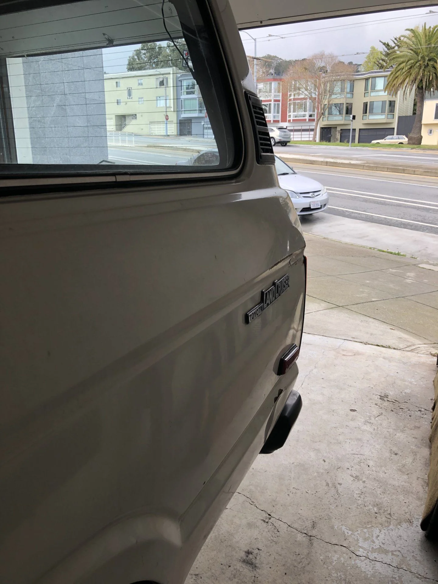

  • Installed new side markers! One was cracked, the other missing.

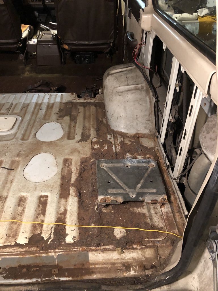

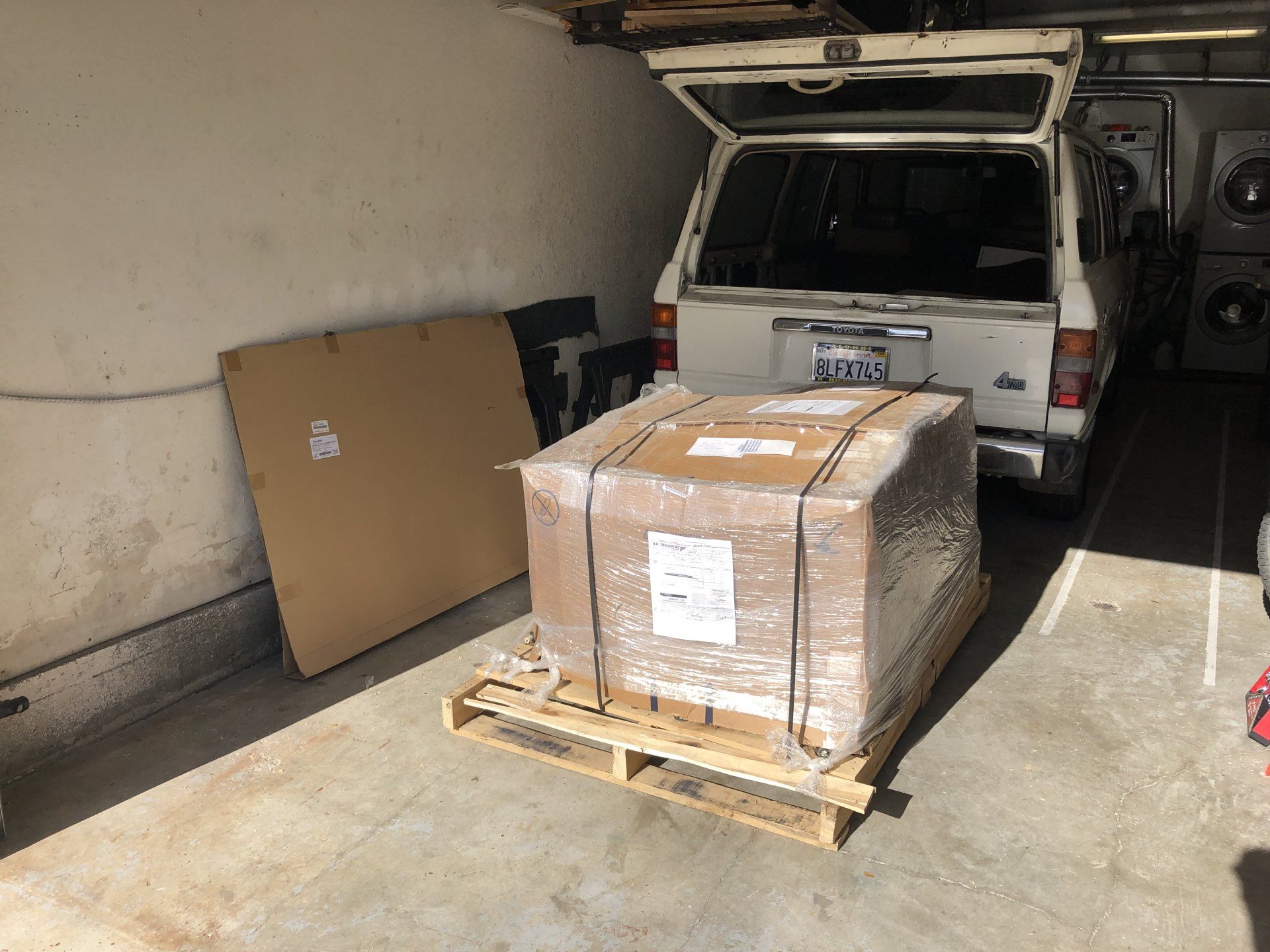

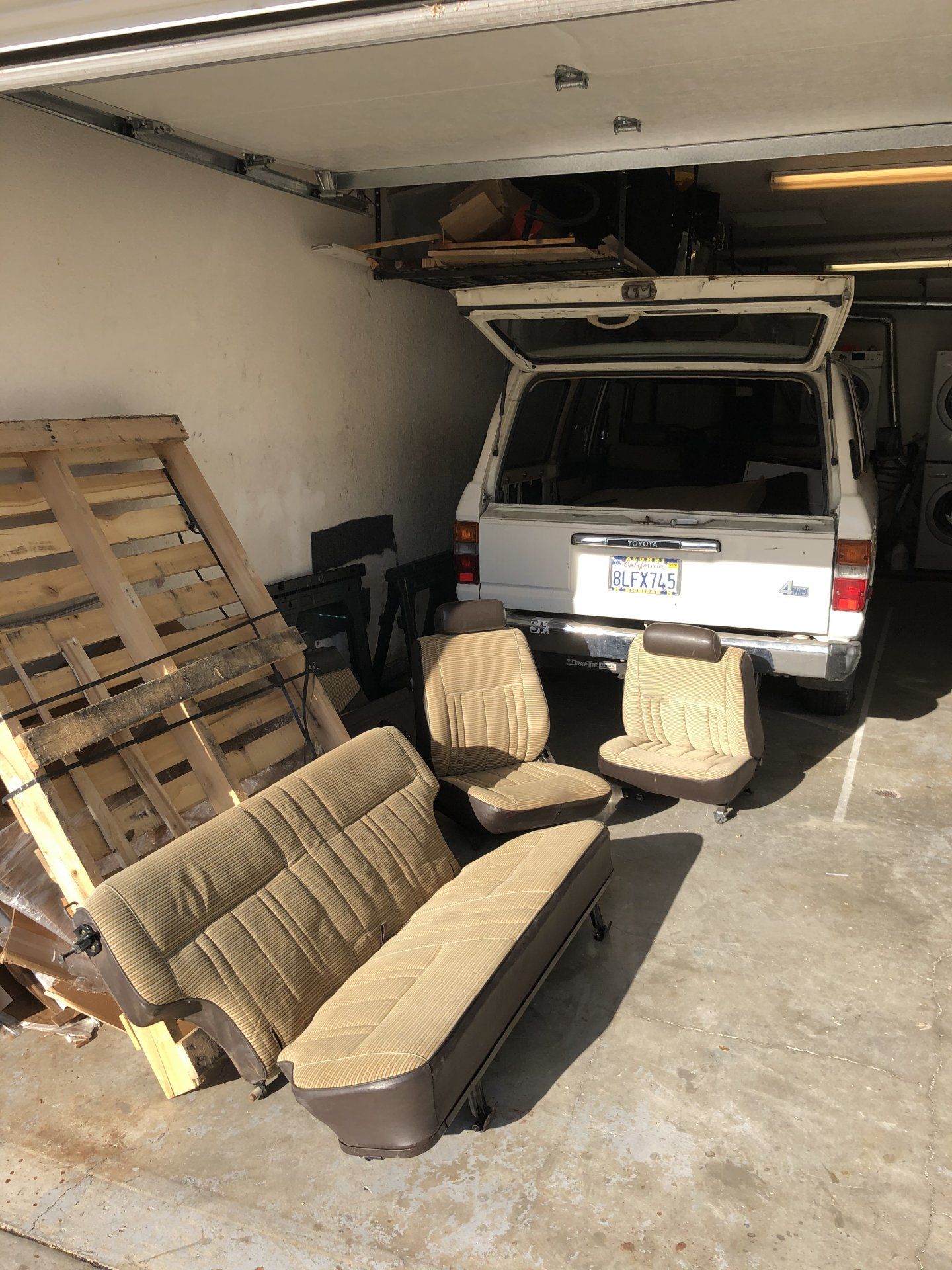

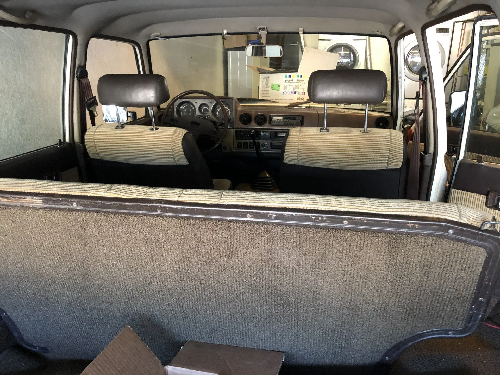

The big project, however: I started stripping out the interior to install new carpets from DNP (after they had been sitting in my apt for three months). That includes removing everything in the interior, cleaning everything, throwing away what's moldy, and then installing new carpet. So far, I've removed and replaced the rear carpet, and decided to throw away a lot. The old speakers (nonfunctional) and gross, somewhat mildly old rear interior panels that the speakers were mounted in are gone; the center console will be gone; the rear belts will be gone as soon as I can figure out how to install the Seatbelt Planet rear shoulder belt kit. The rear interior panels be replaced with nice plywood ones that my roommate and I are already working on - pretty excited for those!

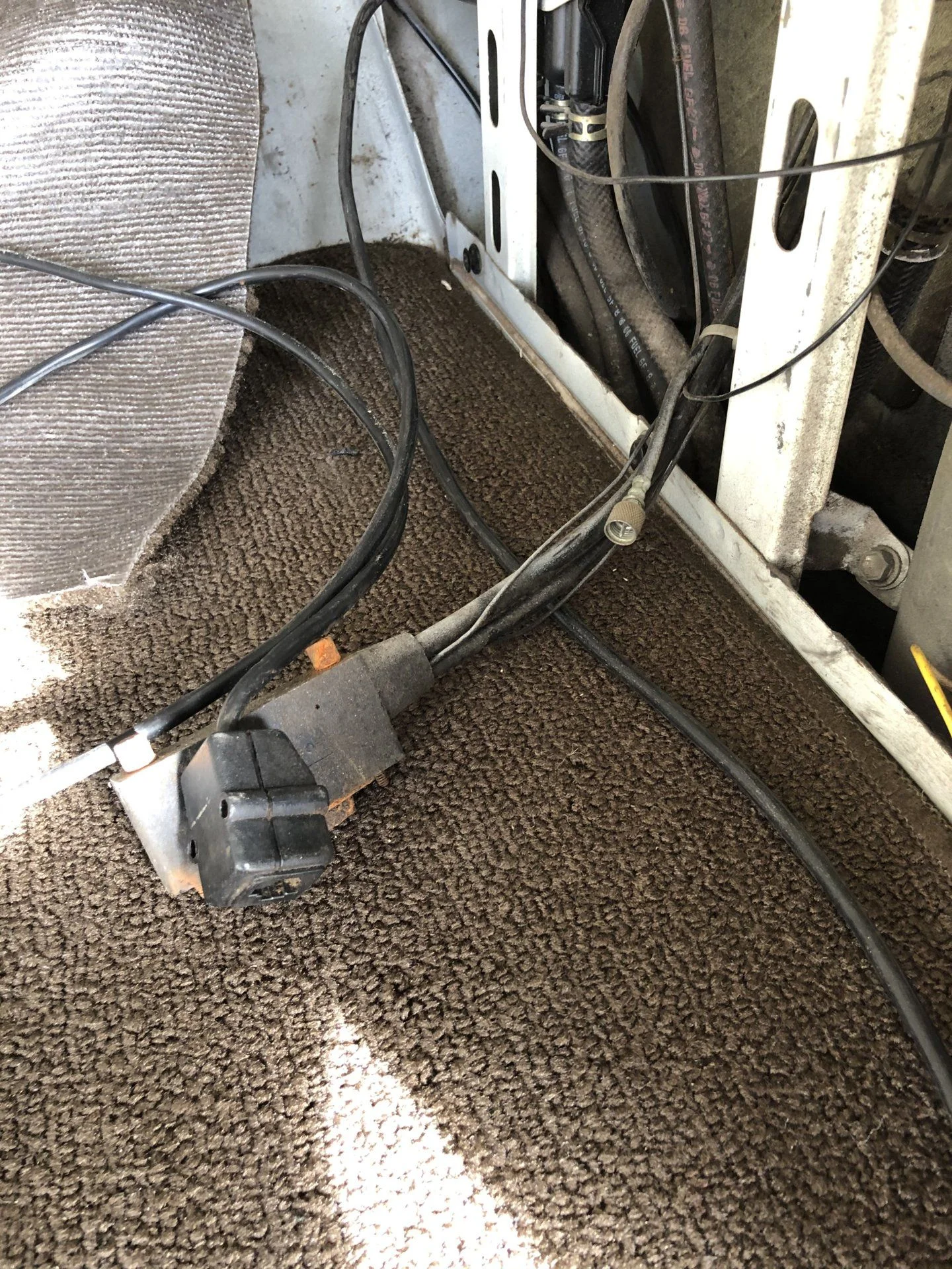

I stumbled across a couple random things while stripping the interior - does anyone know what these are? The first one is this plate that was bolted into the frame under the carpet... no idea why.
This second one, if I had to guess, was the radio hookups for the NMO mount on the roof, and includes a thick cable running from the front of the car that I haven't investigated yet. Pretty sweet.

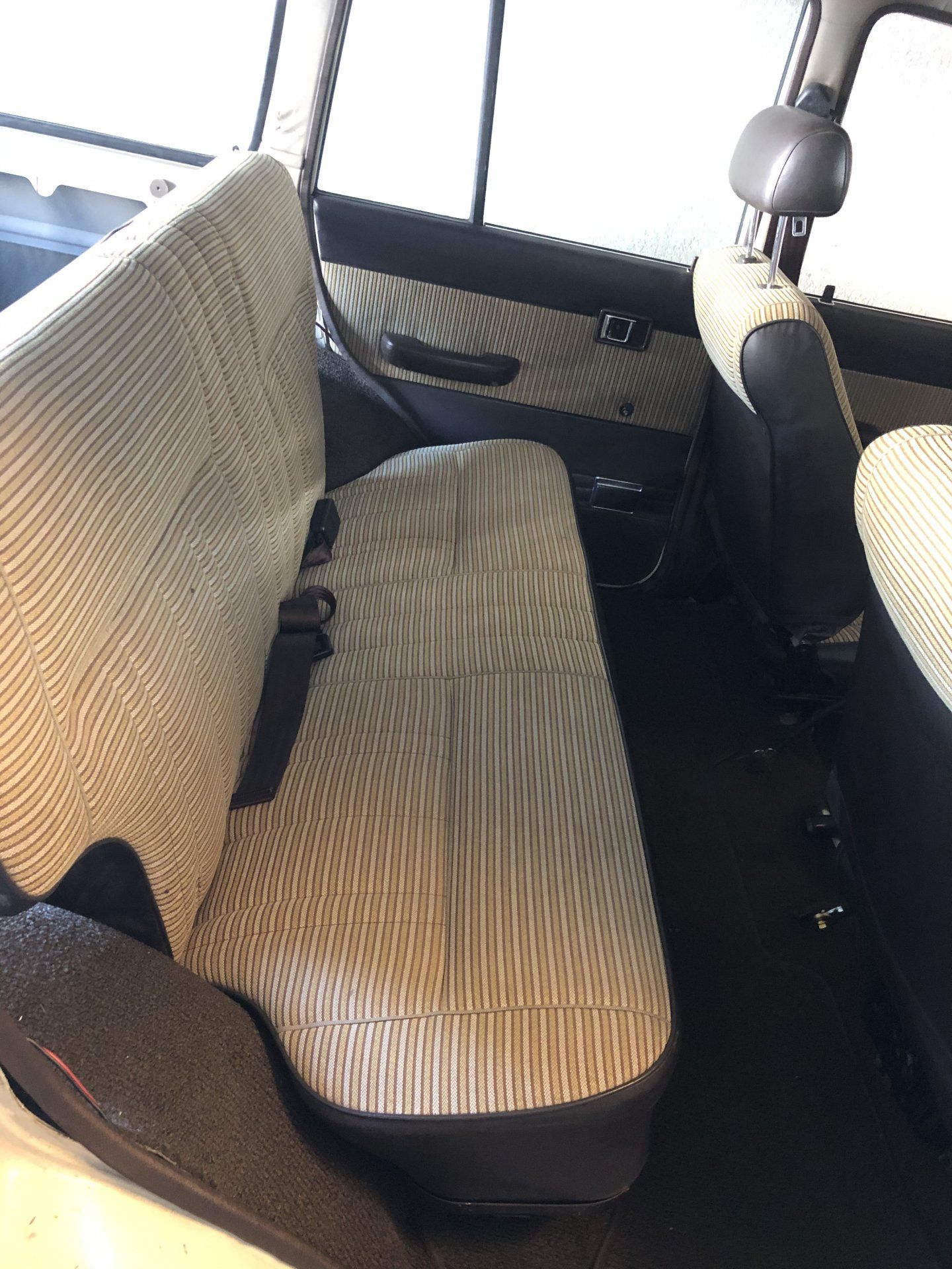

I also finished installing the new carpet from @dnp and it looks fantastic and made a huge difference with the smell! Also put OEM plastic pads on the clutch and brake pedals from CityRacer (somehow they had disappeared, thanks PO). Just now time to make something happen with the seats.

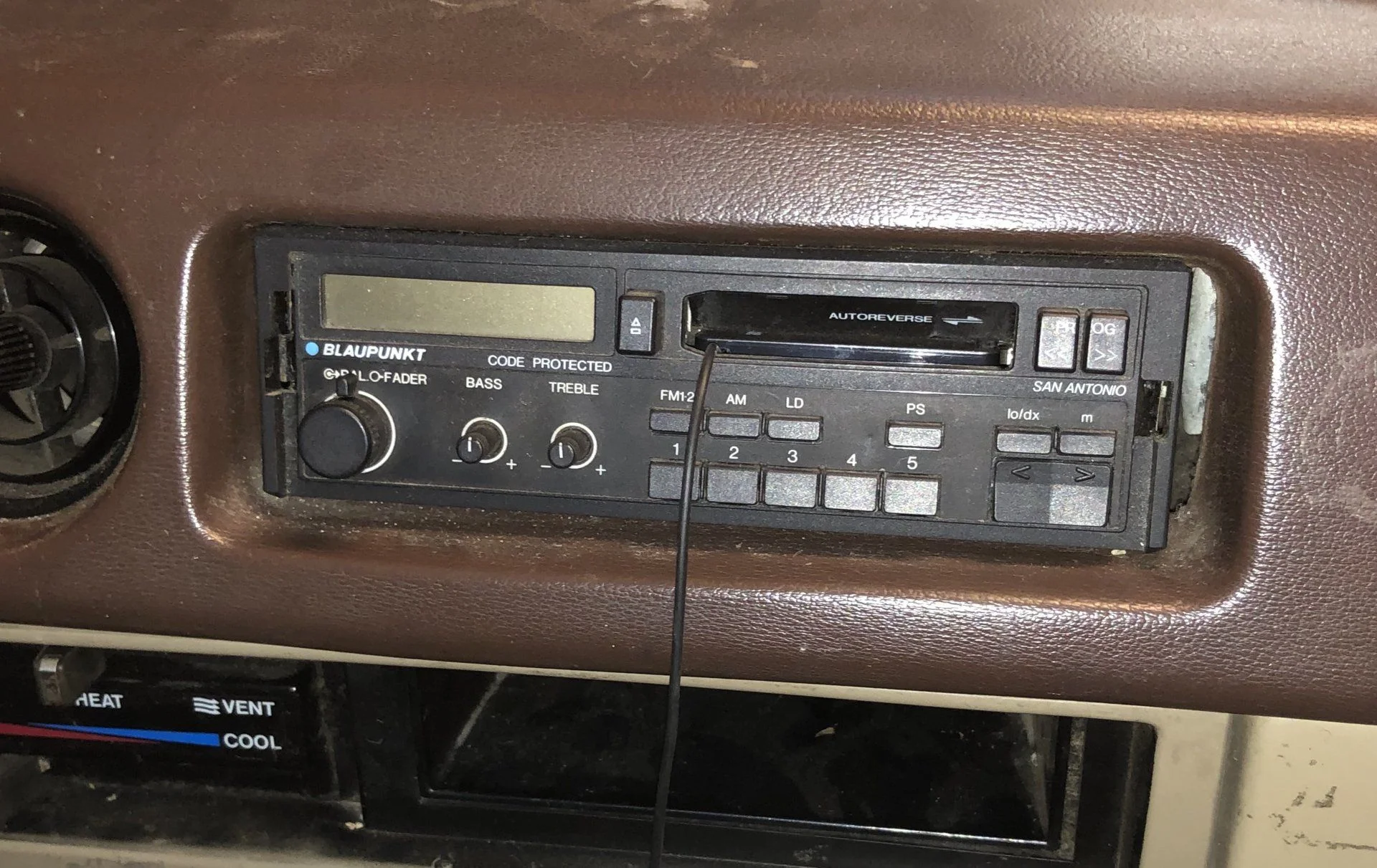

Lastly, I found the radio code and got the radio working playing. Apparently from Googling around, this Blaupunkt is a close cousin if not the same radio that was an optional upgrade on contemporary Porsche 911s, which is pretty cool! I'm going to try and keep it, don't see any reason to ditch it - it plays music using the headphone jack cassette tape adapter just fine.

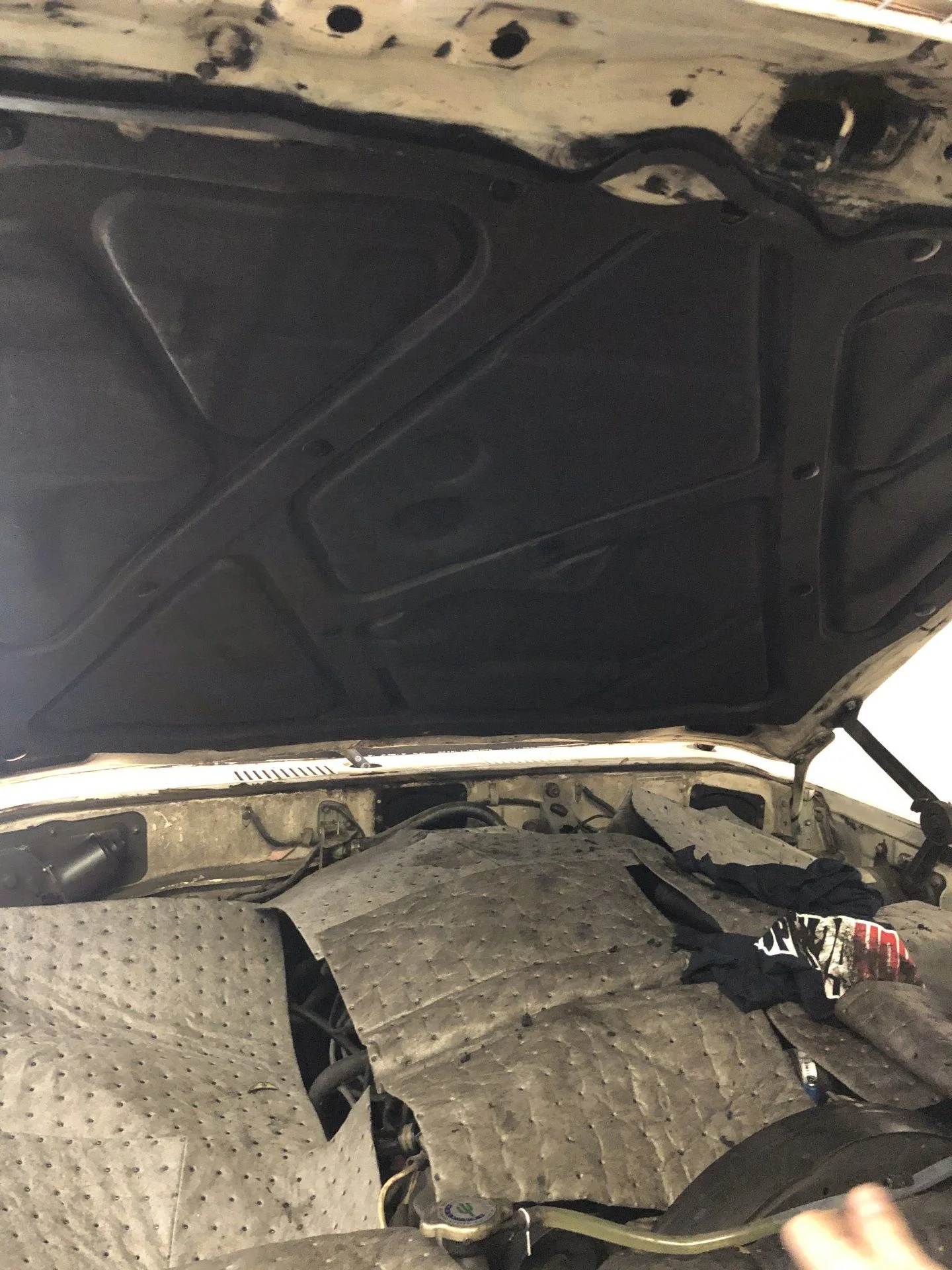

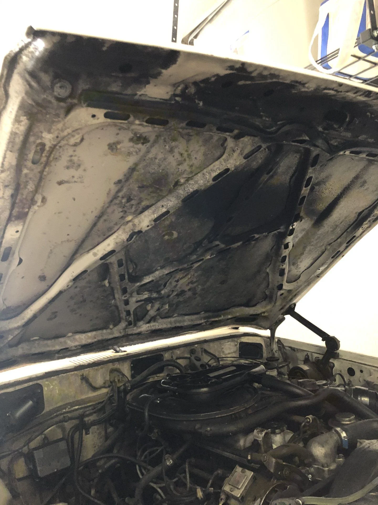

  • Replaced the hood insulator with OEM part 53341-90A00, looks awesome! Clips were OEM part 90467-09014 but were able to re-use most of the old ones. The old one was literally torn and ratty, stained with oil and grease... my roommate cleaned the underside of the hood and we popped the new one on:

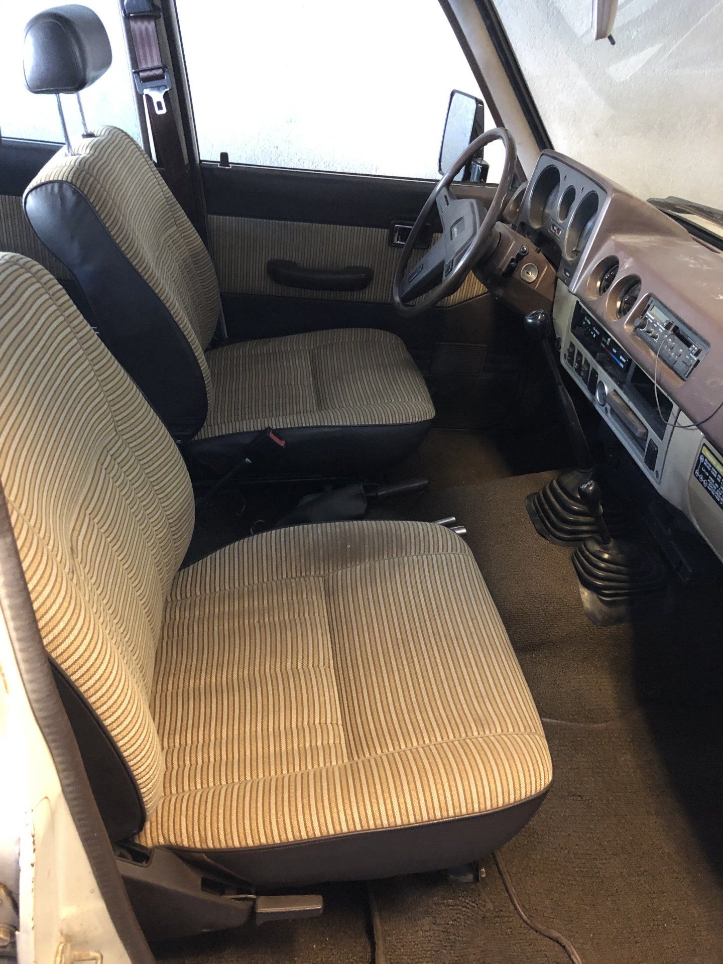

  • But by far the biggest thing, the best for last... Brandon from Classic Cruisers in Poncha Springs happened to have a set of good-condition seats and door cards from his truck that they're parting out. Took about two months of back-and-forth (especially around shipping with the pandemic), but a pallet arrived in my garage the Friday before Memorial Day!
    • My roommates helped me install them over the holiday weekend (due to a recent elbow sprain) and now the interior positively glows. Looks original, no weird smell... the GF is pretty happy.
    • I still have a couple of small custom projects to do for the interior, but with the new carpets, seats, and door cards I'm pretty much there! More/better pics to come.
More pictures next post:
My new-to-me interior! The garage is poor lighting... need to go on a long drive soon and take pictures:

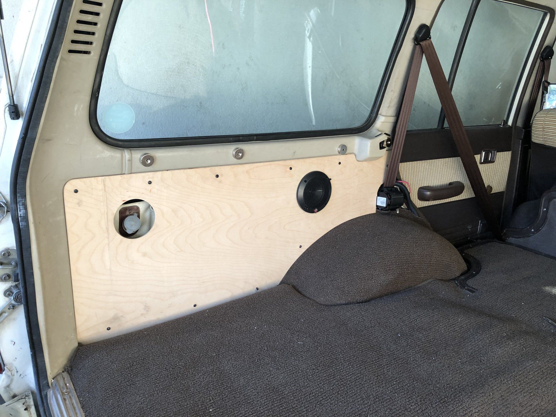

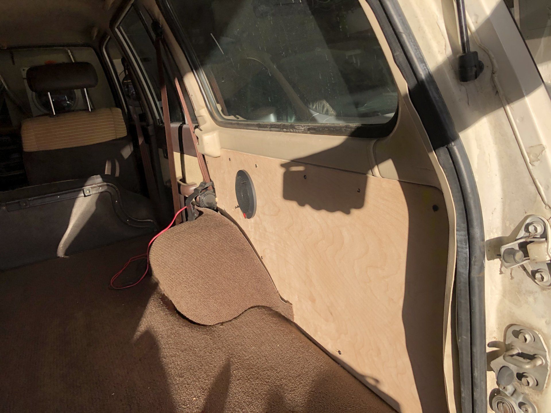

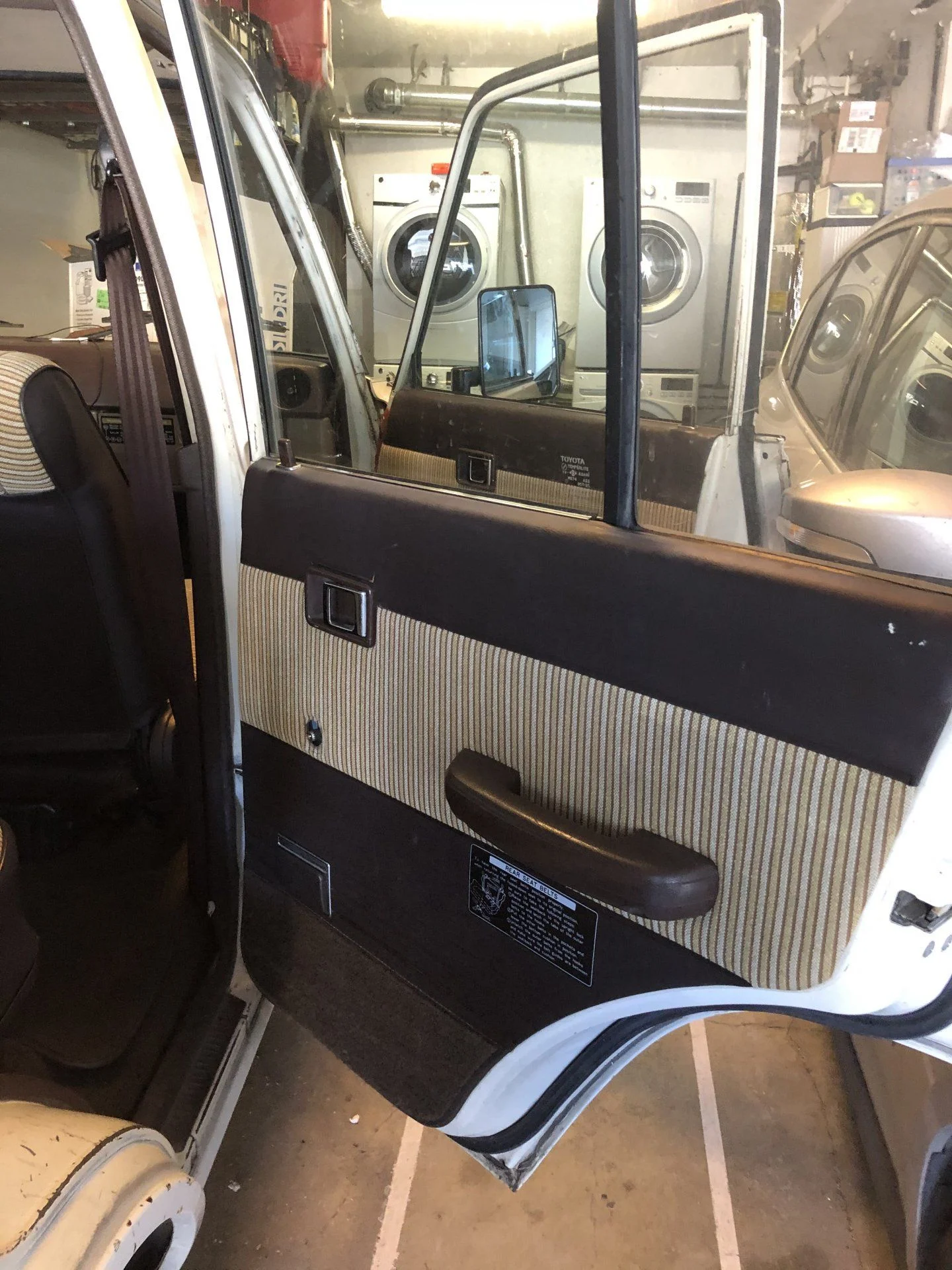

  • I almost have these new interior panels done to replace the old ratty ones! It's plywood from Home Depot, jigsaw'd to match the shape of the old one, then given a polycrylic finish. I spent a while trying to find attachment methods (tried buying new plastic rivets and gluing them to the plywood, tried magnets) but just ended up drilling holes and putting in "U-style" nuts where the plastic rivets were, to have the plywood bolt in. They currently aren't in the truck because I'm finishing burning in a really fun pattern to them.
    • Also bought Rockford Fosgate R14X2s to bolt into the panels. There were Sony speakers wired into the old panels before that were blown out and didn't work.
Ill-fated attempt to glue in the plastic rivets... the glue would fail after 1-2 cycles.
Rear panels put in! Also probably the best view I have of the new rear shoulder seatbelts until I get close-ups.

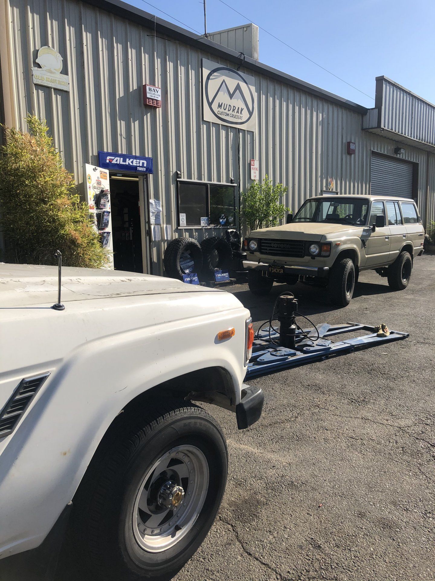

Also the GF and I spent some time drooling over this beige FJ60 that Mudrak had just finished building up... Gary said it had over $40k in it with a E-ROD conversion. It has the 2" OME lift and black rims that I want to get some day!

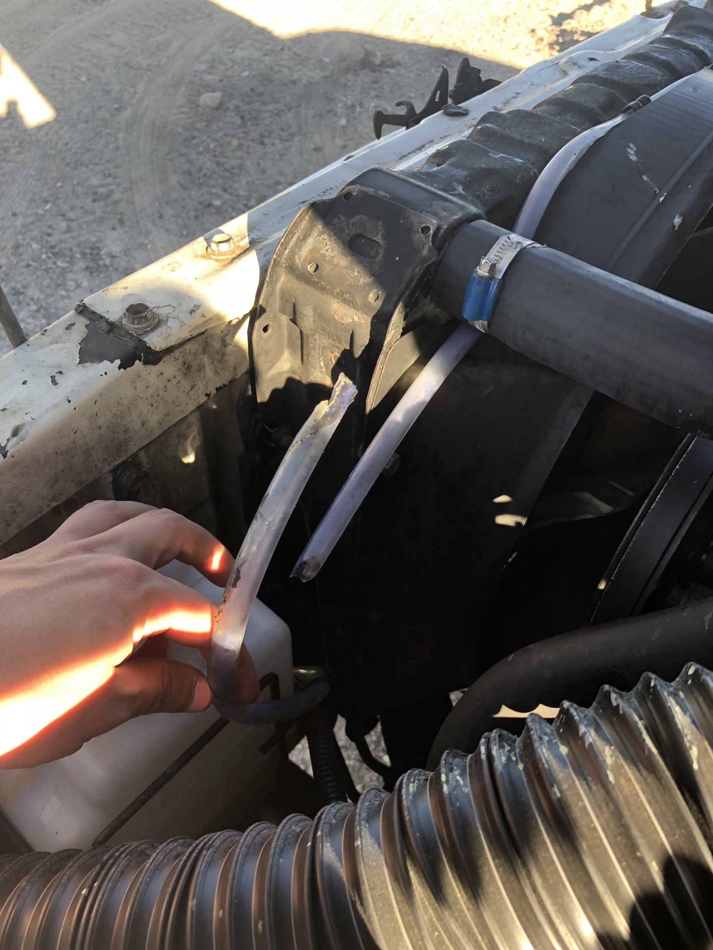

Only problem I ran into the whole trip was during a bit of forest road driving for the Friday night. Got to the dispersed campsite I wanted, only to find out... my hose from the radiator to the coolant reservoir had sheared (it had a lot of slack, so I think it had swung around) and I had lost some coolant. I limped the ten miles back to Mammoth the next morning, got new vinyl tubing from the NAPA store, and was on my way.
It was an absolute blast of a trip and the truck seemed to run really well! The only real problem was that one hose, and then my personal comfort sweating through all my clothing driving hours through 100-degree Central Valley heat ... at some point I'm going to pay a shop (probably Mudrak) to add AC.
Going through Sonora Pass on the first day!
My Friday night campsite:
The hose that sheared... was very anxious the whole night and very careful to just limp the truck back to civilization the next morning without dropping too much more coolant.

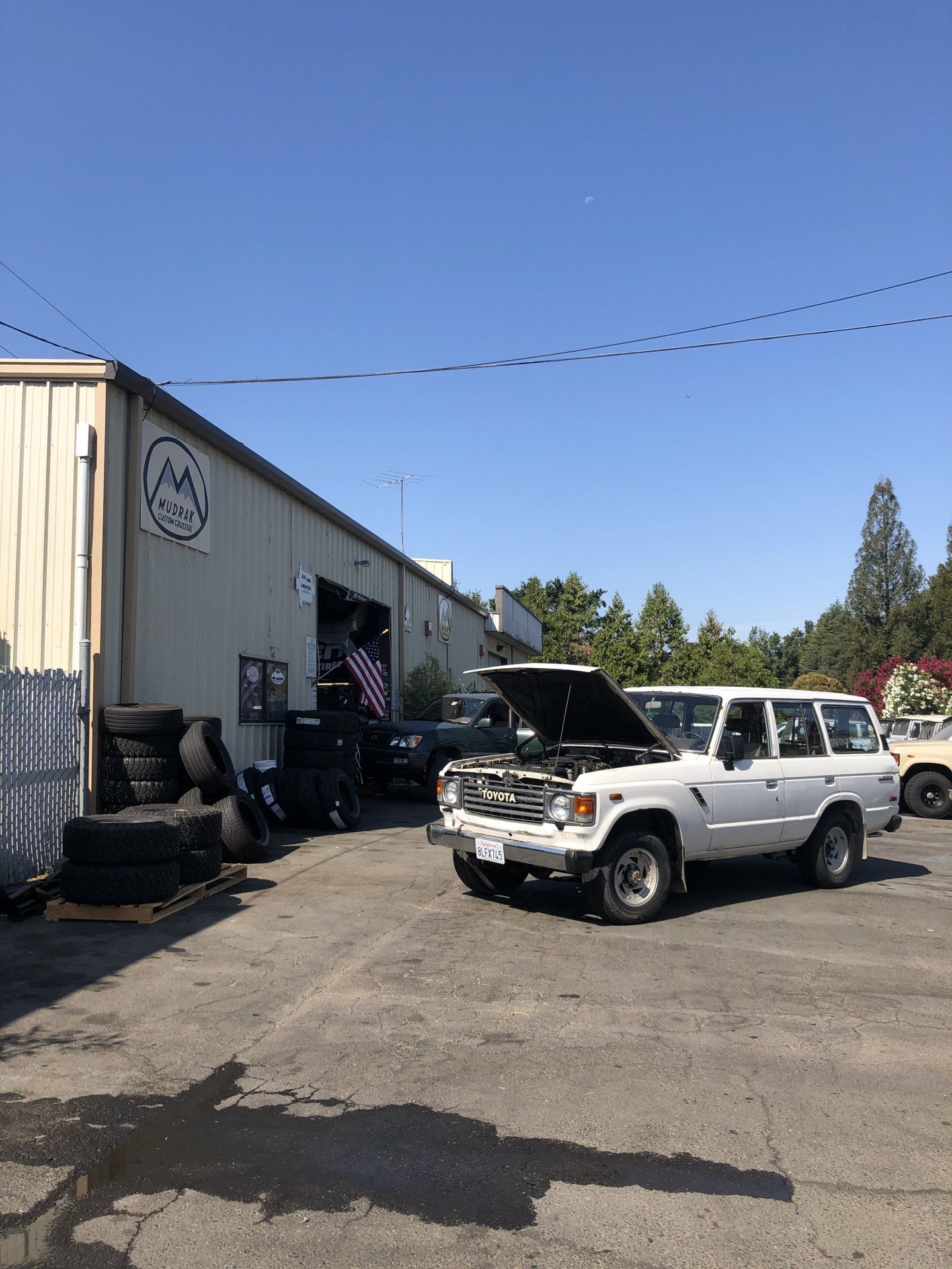

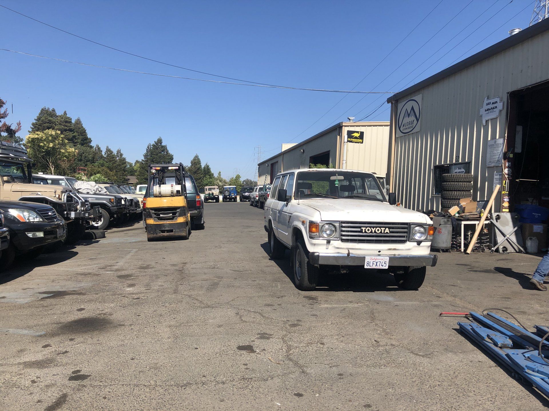

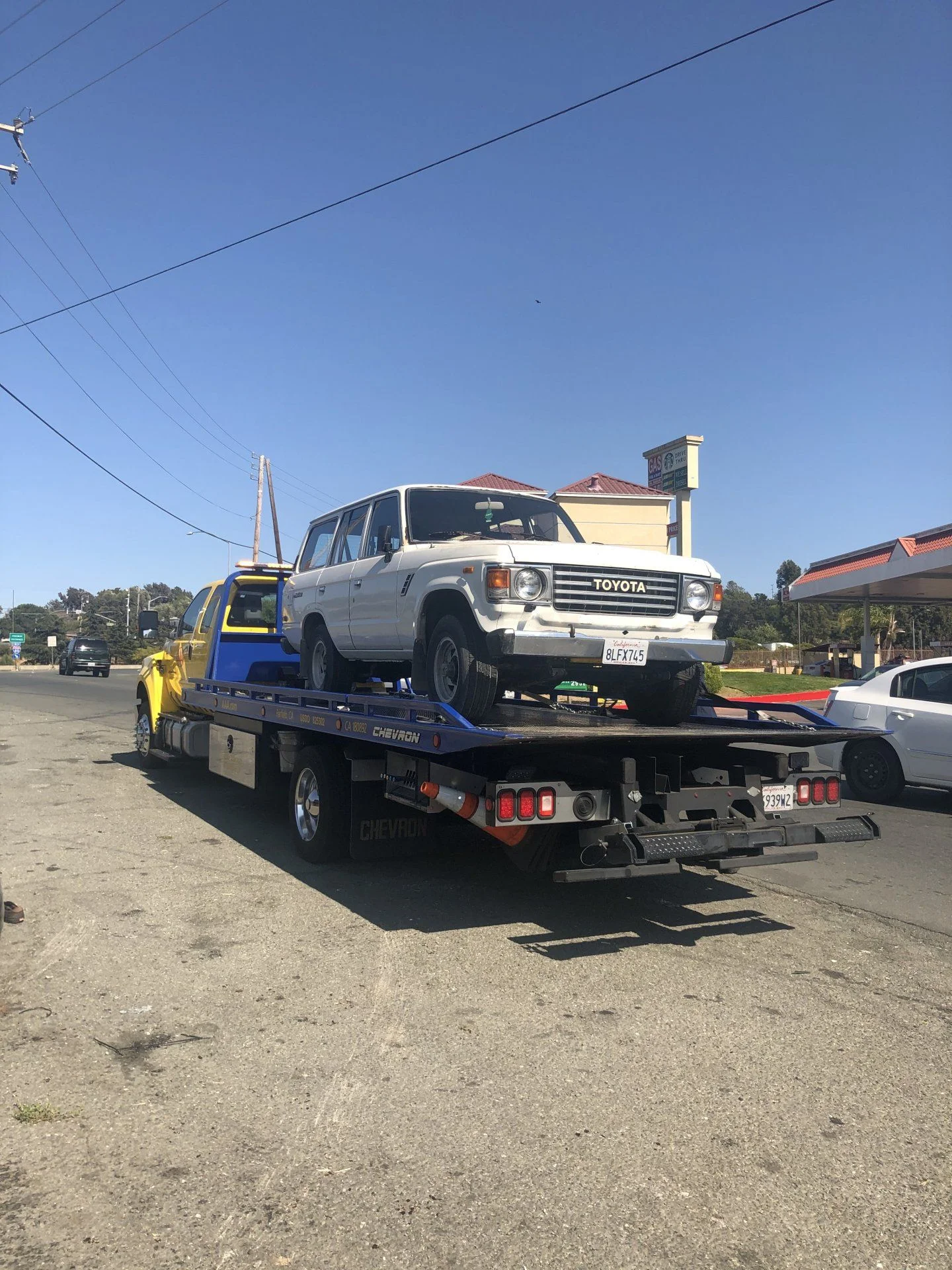

Mudrak was closed that Sunday, so showed up first thing next morning and talked to Gary. He said the compression was shot, he suspected it was the piston rings at a minimum, and that they wouldn't rebuild the engine but swap a new one in (and they have a huge backlog right now for that). I need to find a place to put the truck in storage by the end of the week, and then figure out what to do next.
I'm really not sure what I'm going to do next. From how long the engine had been down on power (losing cylinders?) and spewing things, I'm not even sure it's worth trying to do a rebuild (Mudrak/Gary definitely didn't think so). The obvious choice I think is to put in a new 2F (or sell), but I'm also considering maybe doing a diesel (like a 1HZ or 12HT) for extra power and fuel economy (and also put in a H55F while I'm at it, to make highway cruising easier). I would really like a 3F to move to fuel injection, but I don't think that's possible under our dear overlords CARB. Don't have a place to work on the truck, but I might be moving soon and have a chance. Open to any opinions and thoughts on what to do... first thing to find a place to store it where I can think and make plans.
