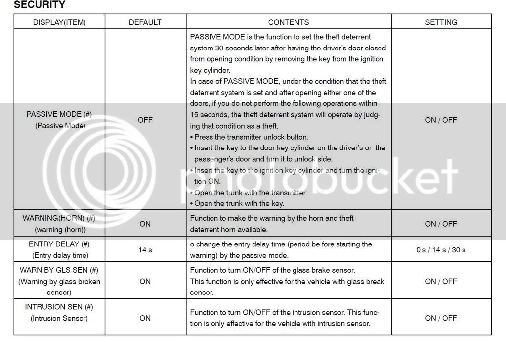

Does anyone know if this alarm feature is something that can be changed/adjusted via one of the customize menus in techstream?
Are you waiting in the truck till the red alarm immobilizer light starts flashing?
