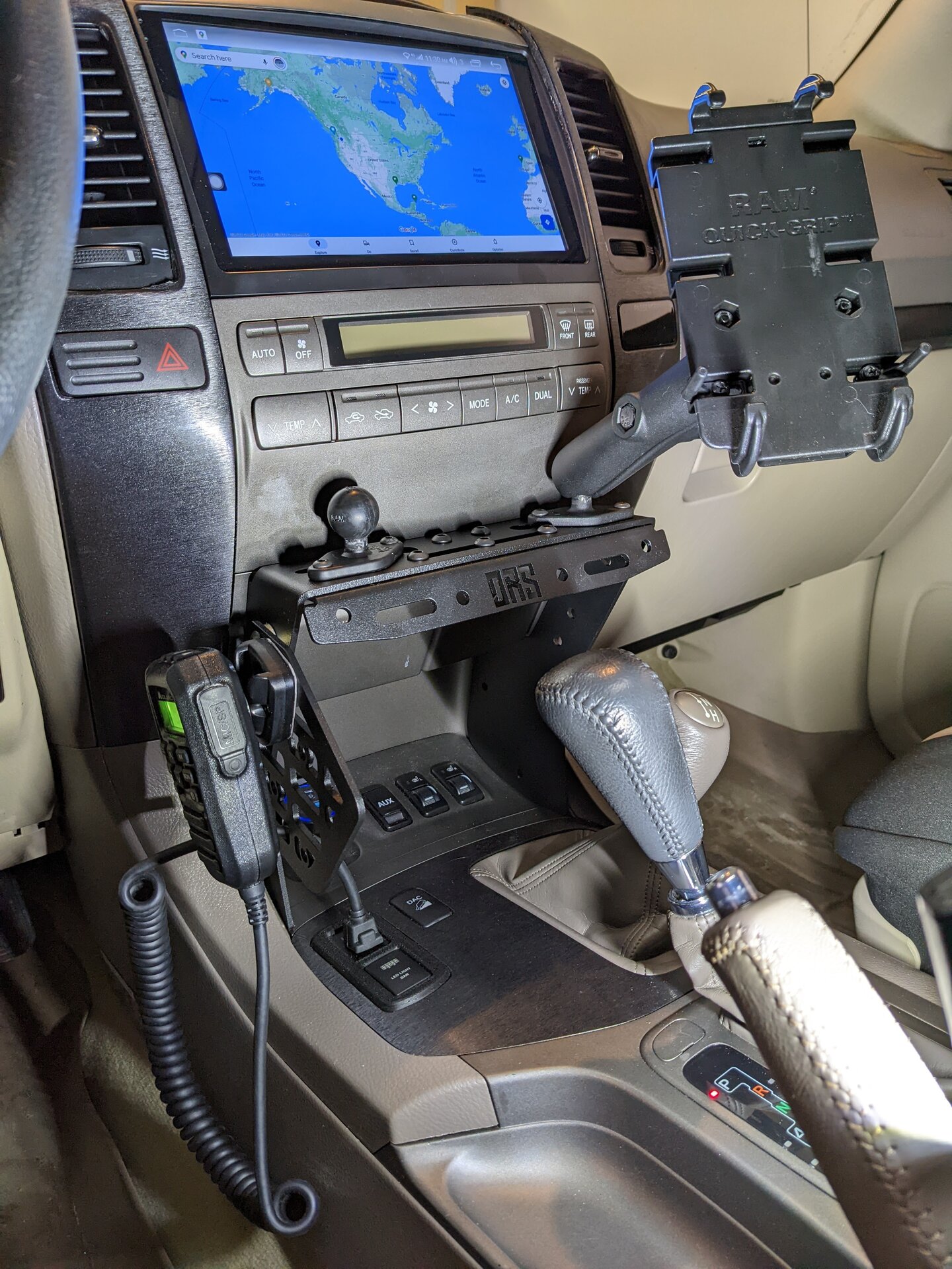

I have the insert for two Toyota style small switches. One is for the relocated gmrs radio and the other is for a light bar. The phone mounts shown aren't what I'm using currently, but I am using 67 designs phone mounts on the ORS bracket now.
An alternative is to replace the shifter console with a double cup holder, or single cup, or switch panel.
Take a look at www.BlueDogDesignwerks.com
It gives you more options if they fit your needs.
Great setup!! What are you using for your mic plug?
I don't remember where I bought it from, but it's referred to as an RJ45 UHF socket or passthrough. Just make sure you get the smaller Toyota style switch size.
