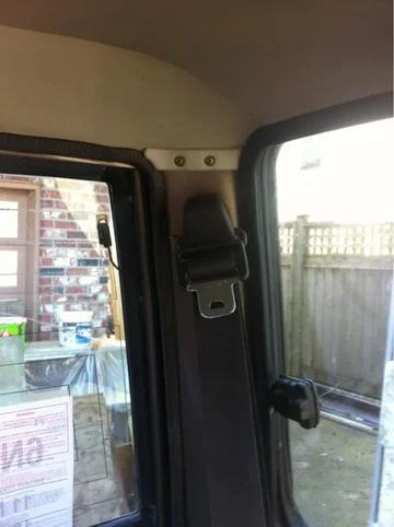

What I have is a LHD LJ70 from the netherlands.. The back seat has the 3 female recievers and the single center male...but missing the outer males...which Im understanding now should be shoulder belts....now Im trying to get an idea where to look for the mounting points
Somebody...anybody.....can I please get a picture?
Looking for location of shoulder and floor mounting positions...

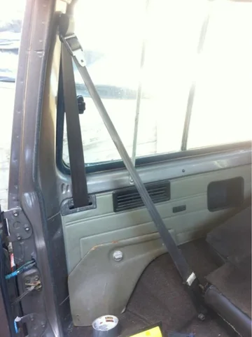

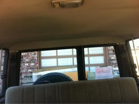

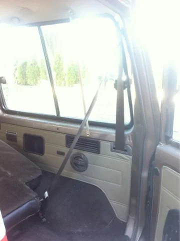

1985 BJ70 Canadian
RHS upper
LHS upper

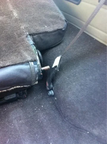

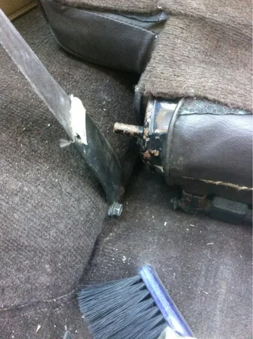

RHS lower
LHS lower

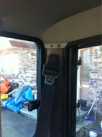

RHS (sorry it's super sunny)
LHS
much thanks guys.............. :-)
Looks like im going lap belts...there is no hole in C pillar
