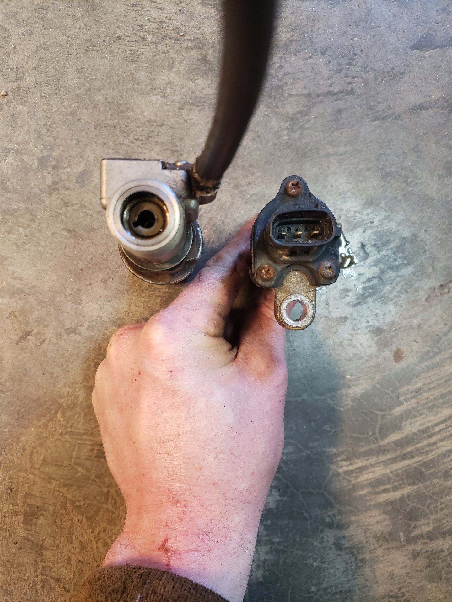

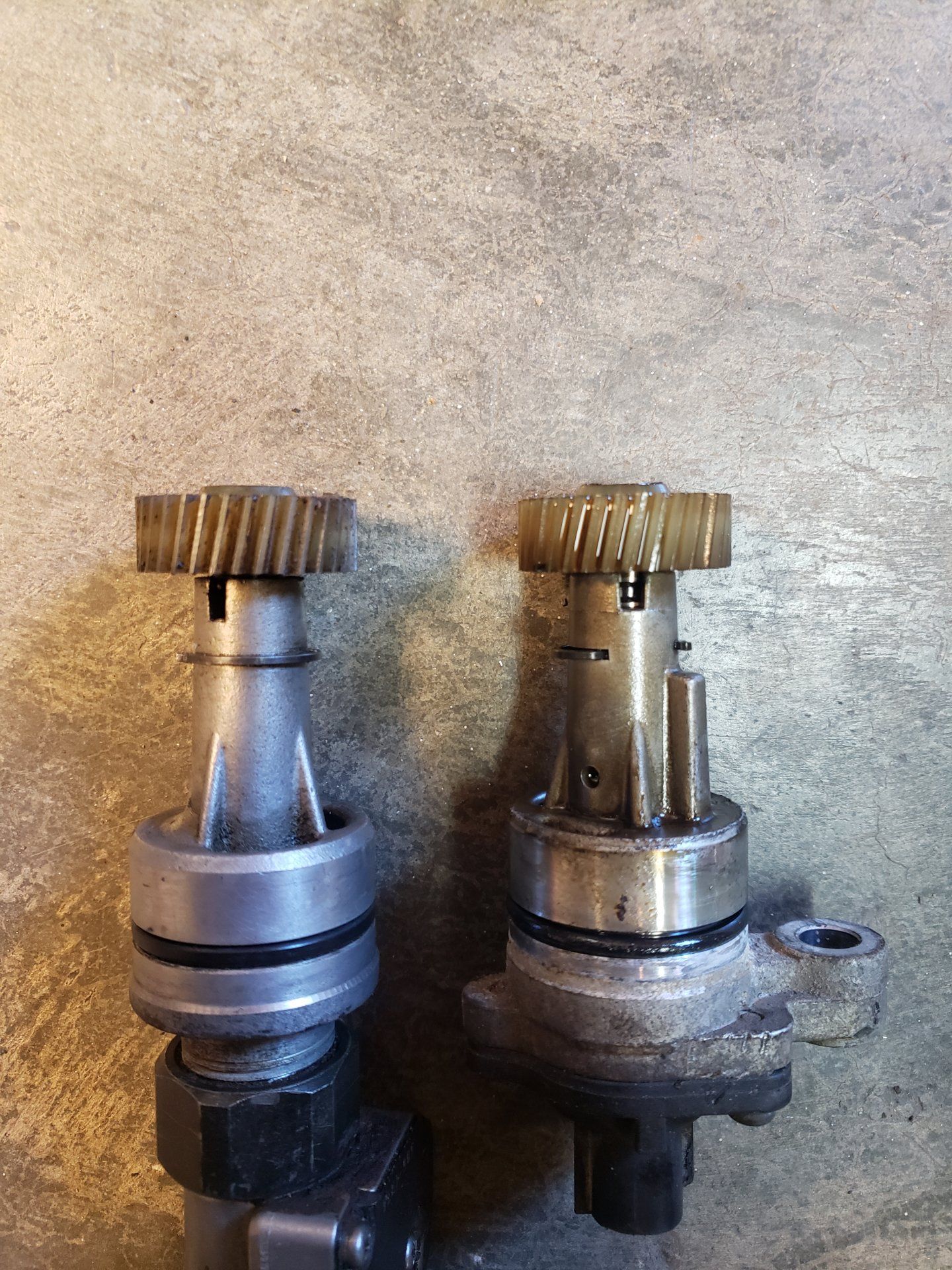

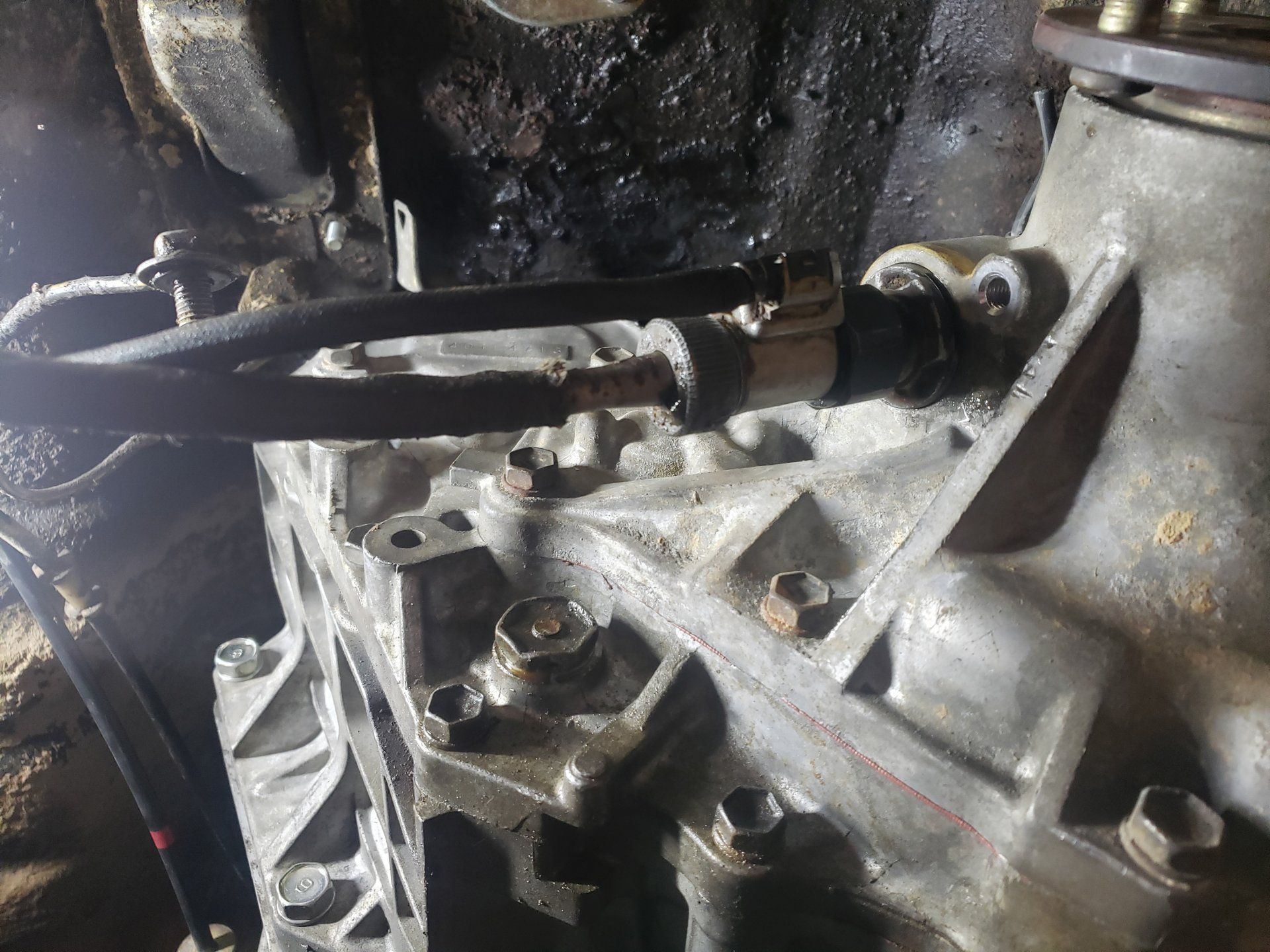

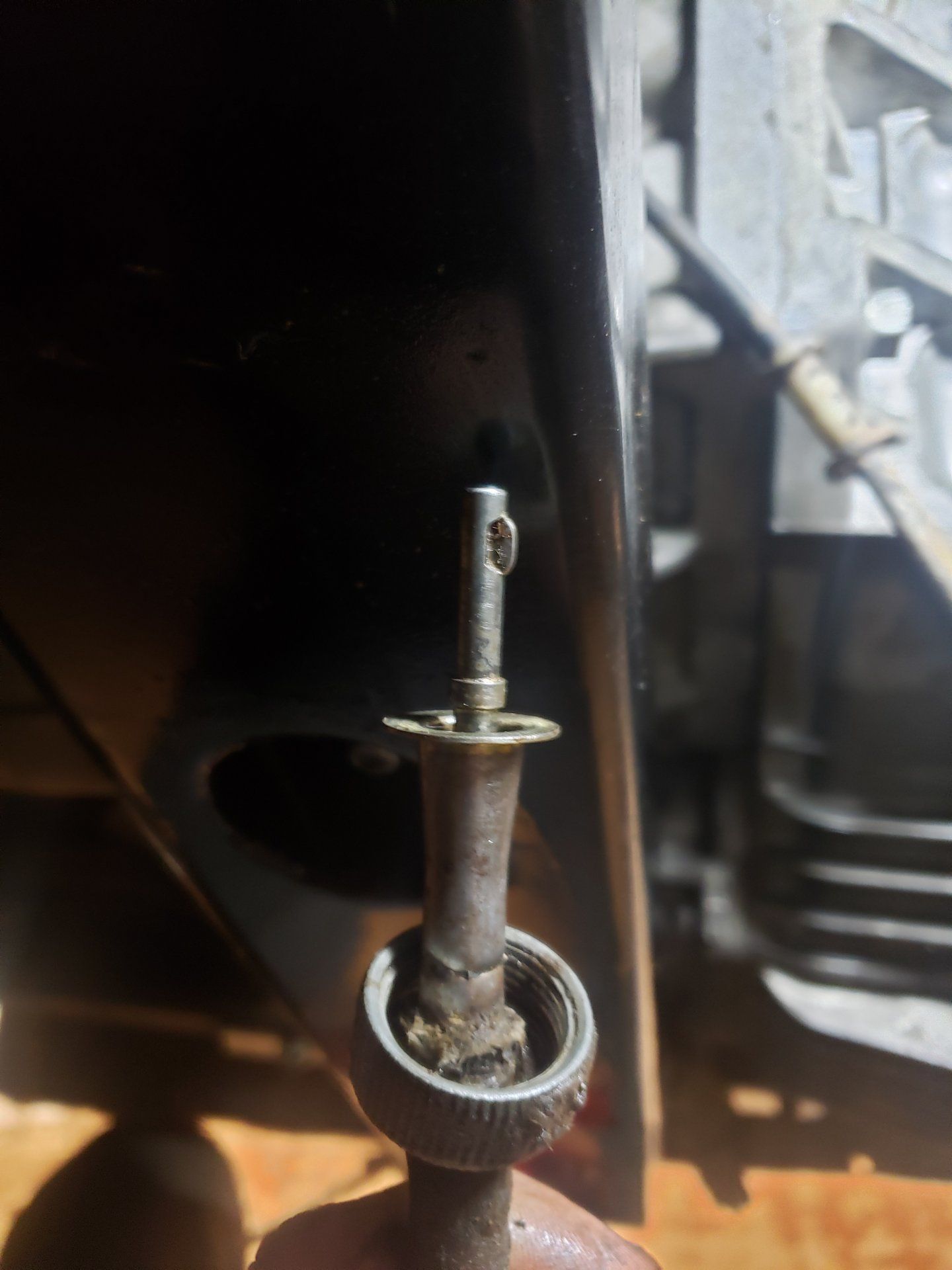

Another bit of info I forgot to post:
There is a slight difference in the LC and 4Runner 750 shifter systems that needs to be noted.
Using the 4runner shifter and associated bell crank from the A750E on the A750F will lead to very high shift effort - so high that I'm worried about durability of some of the plastic pieces in the shifter mechanism. This is due to a difference in the mechanical detent arm in the respective units. These detent arms are mounted by a couple M6 screws, so just swap them out. I'll try and bring some pics to this once I pull the pans.
**Edited to add a bit of comparative info in response to a question - 4runner uses a cable shifter, while LC/LX uses a traditional rod linkage. The cable shifter is plenty durable when used with the rest of its intended components and the 4runner set up allows you to put it wherever you like (HUGE help - see previous posts). The LC/LX shifter linkage is substantially stiffer, and has the mechanical advantage to allow smooth operation with the stiff shift detent in the trans.

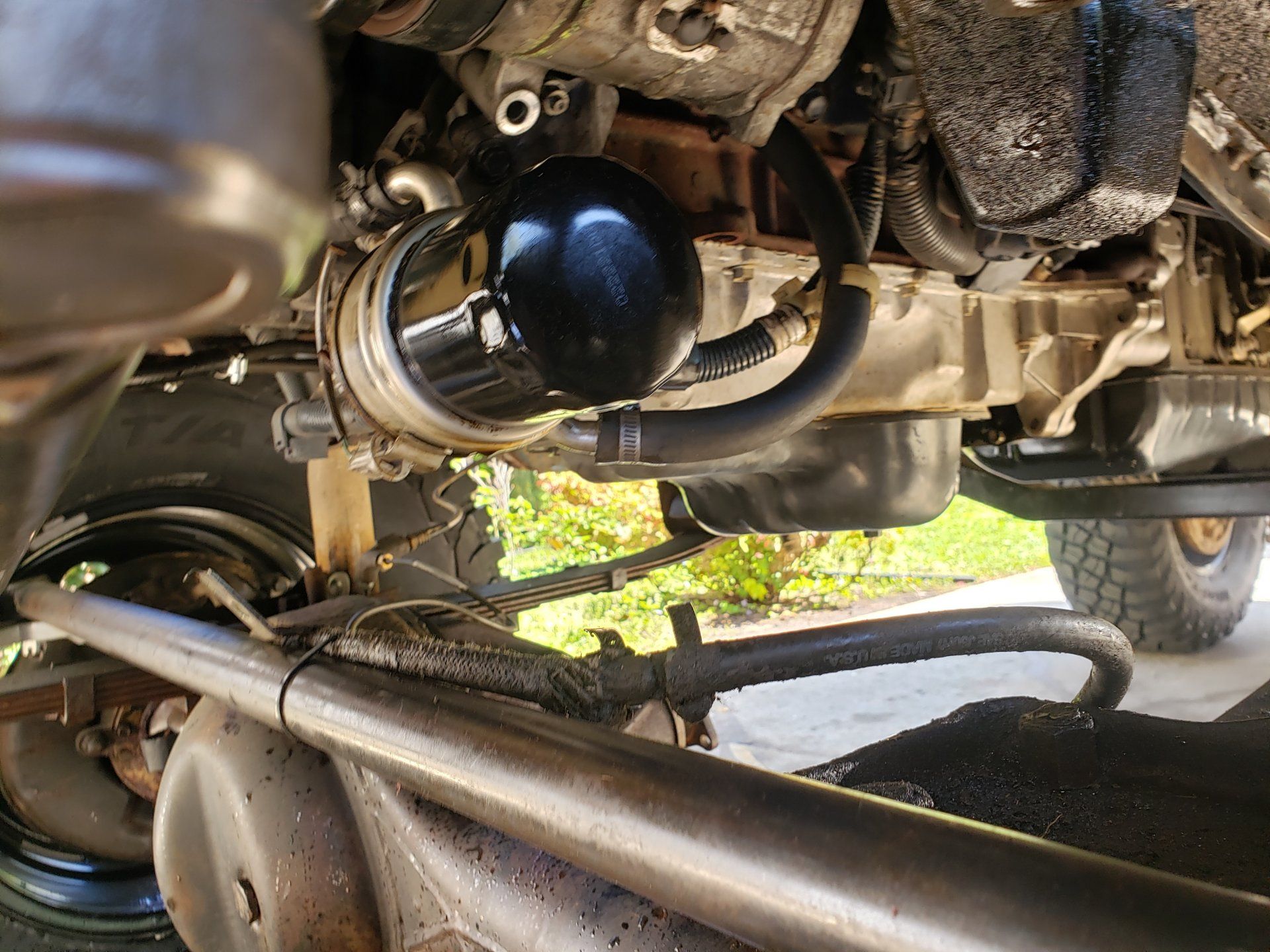

Moved to an LS430 oil filter mount. Gains 1/2" of oil filter clearance. Not as much as I'd hoped for, but it should do the trick.
Before:
After:
Bolts right up. Had to change one cooler hose and find a shorter bolt for the AC compressor.
Loving this UZ lego drawer.
Its a tough life, having to burp a cooling system. I got a really patient helper this time.
Looking at the after pic I would recommend making some bump stop lowering brackets. I accidentally hit an unseen berm with an old jeep I had, and the suspension compressed so much the front diff hit the balancer on the engine.
It's definitely getting bump stop extensions. With enough force, the axle could get into the engine in a couple spots.

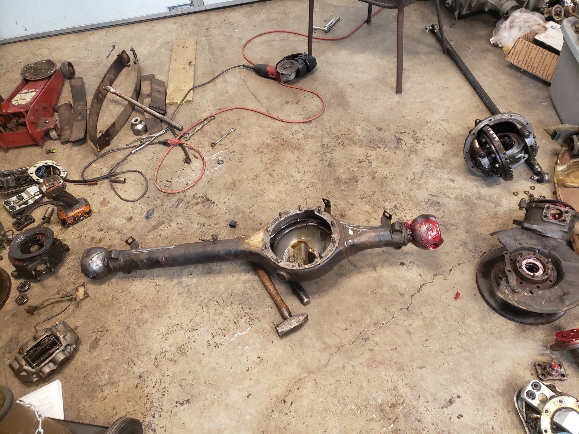

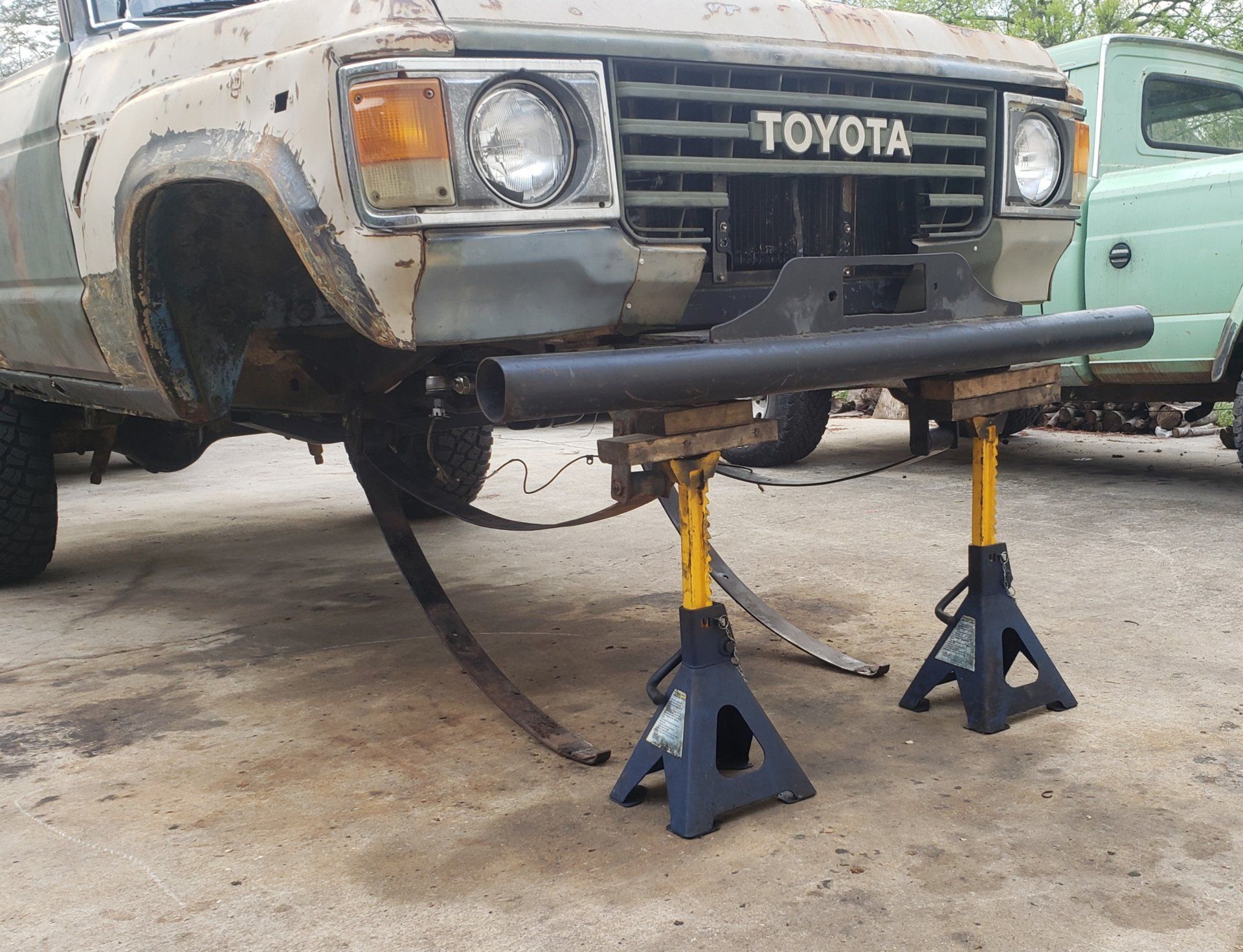

Big step. She looks pretty weird like this:
Had to hit pause for a friend's wedding this past weekend, but I'm back at it.
Cutting and turning tomorrow.
