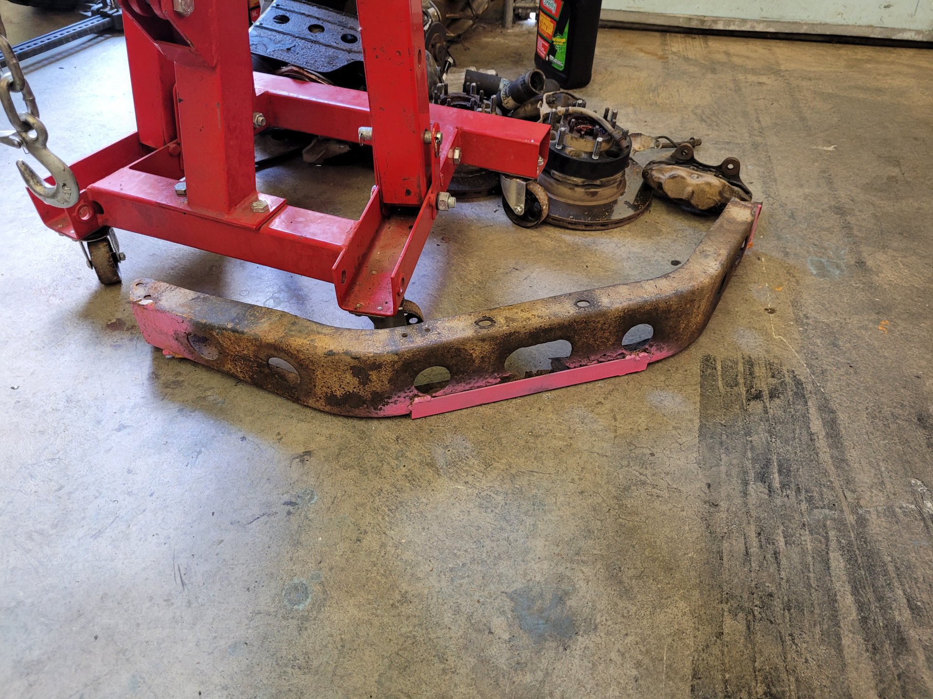

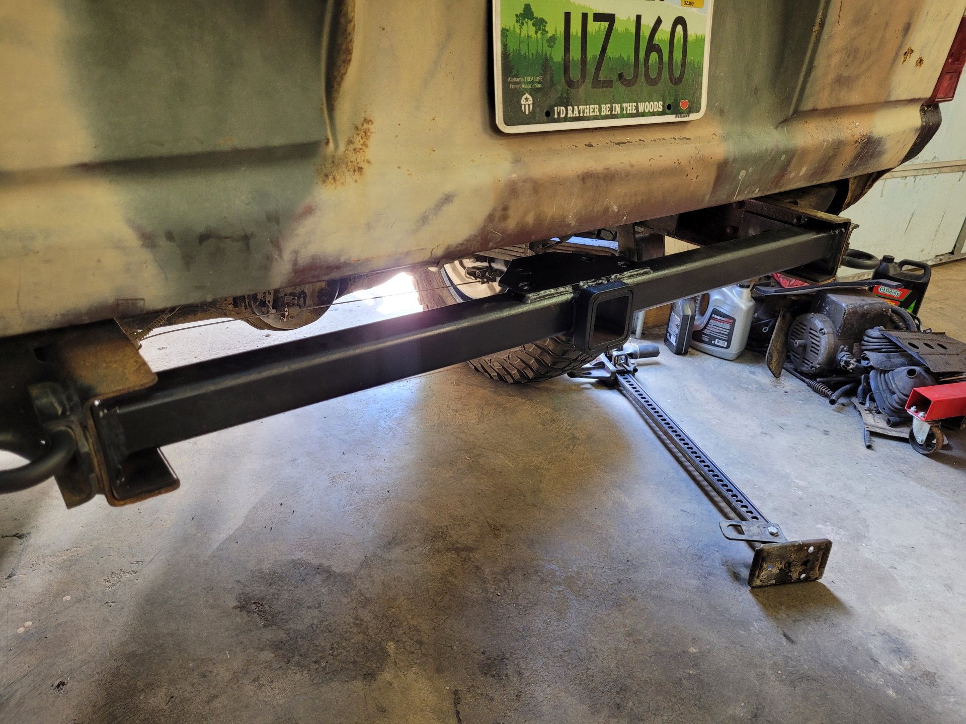

The rear crossmember took a beating these last couple years. GSMTR tried its best to kill it, but we patched it up.
But...I've needed a trailer hitch for a long time. So the artwork got replaced. The stitched-up crossmember will live on in other projects.

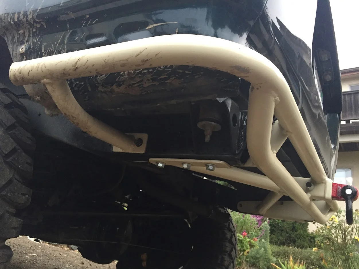

Looks good Zack, nice recovery points on the out side !!
I would consider some lateral bracing to mimic the removed crossmember or something simulator to these I built into my rear bumper.

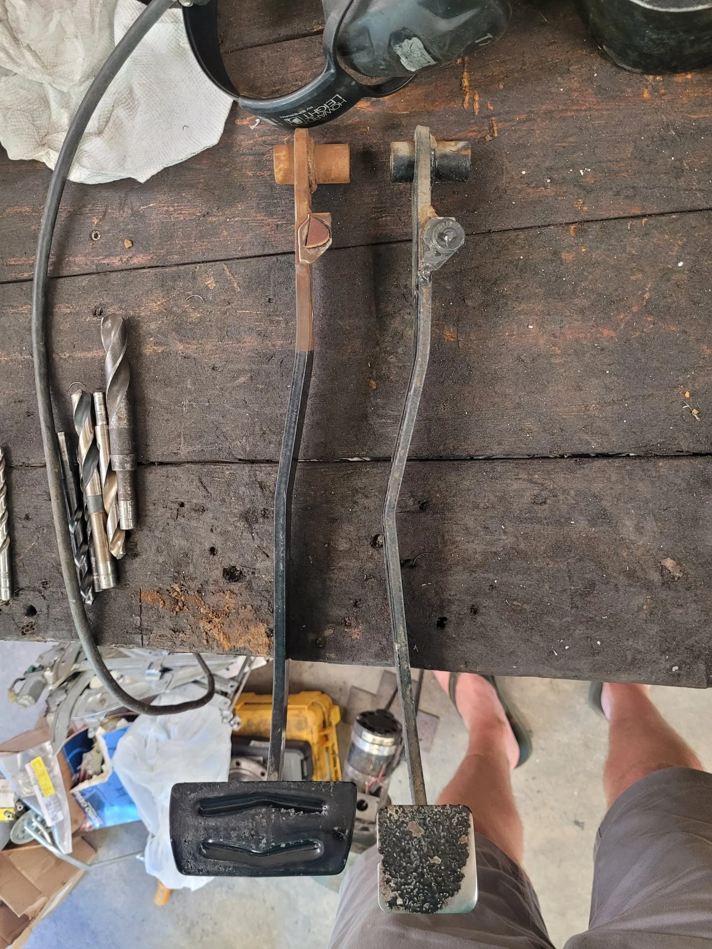

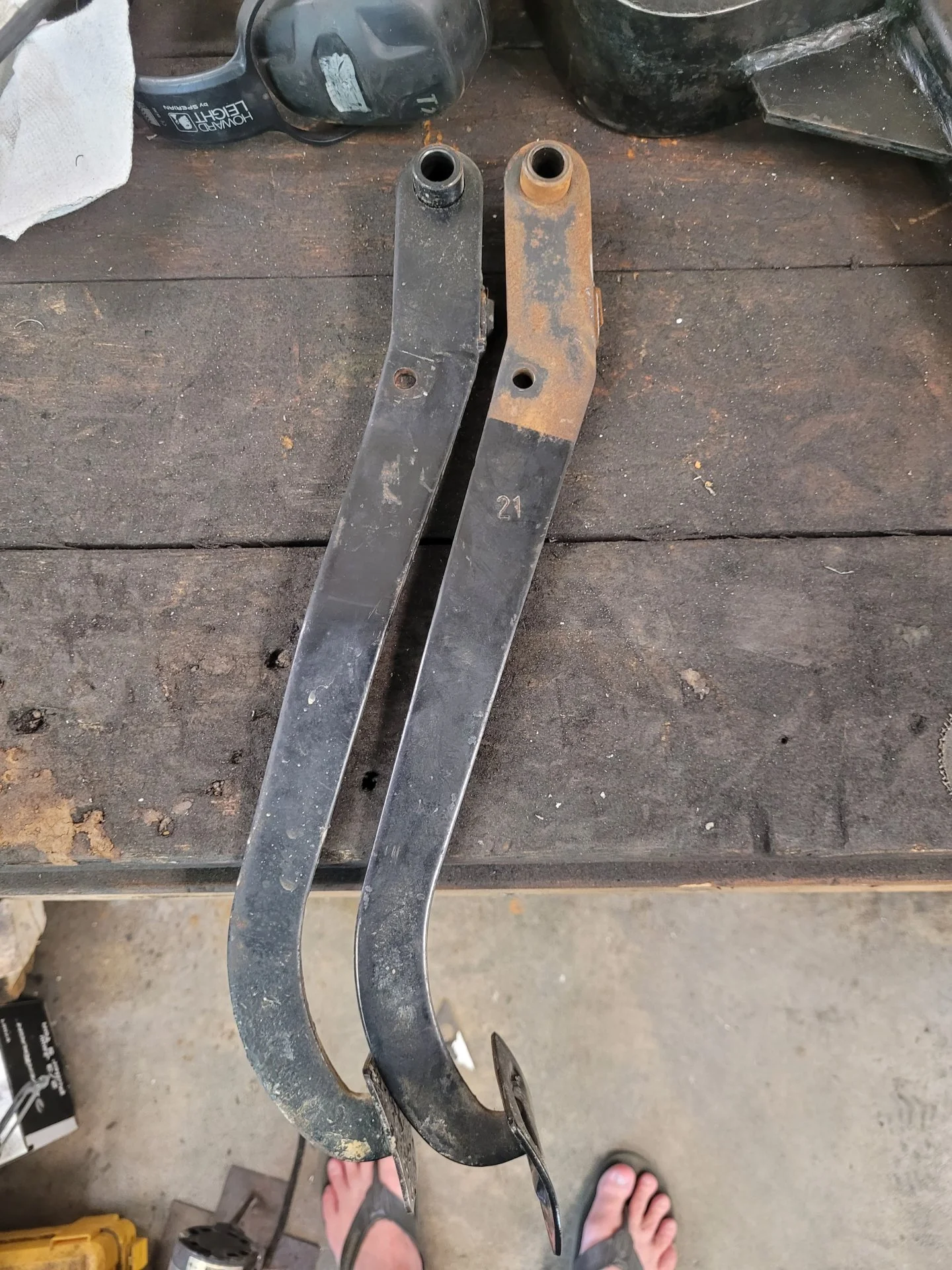

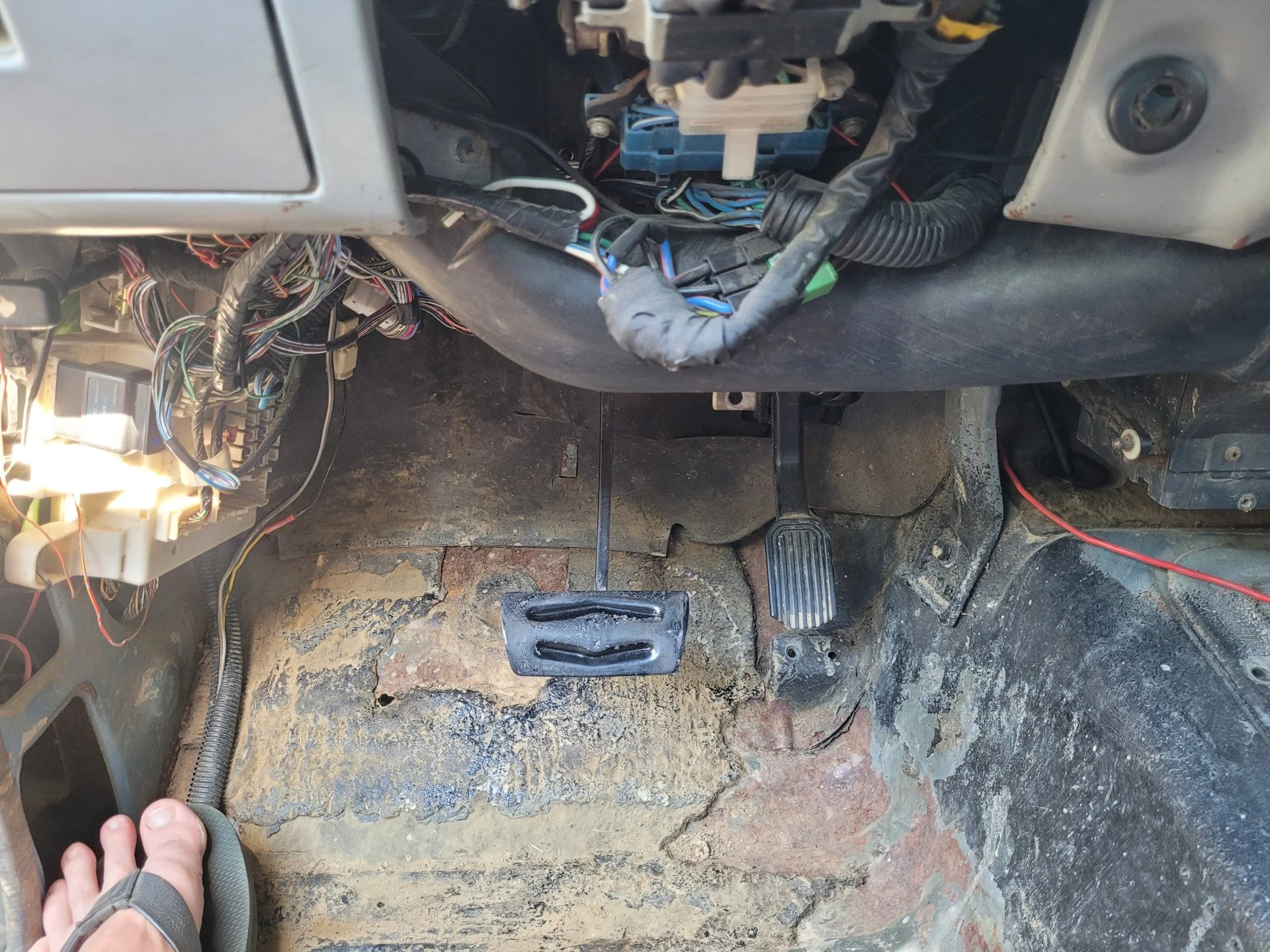

Did you swap the pedals yet?
Yup. Thanks for the update reminder.
Surely this is elsewhere in Mudverse, but here's the comparison between 60 and 62 pedals:
Direct swap in. Zero fuss.
Slippery boots involved with switching the braking foot for a power brake and nearly getting in big trouble because of the (missed) foot swap drove this change. The 60 pedal will work fine for most folks.

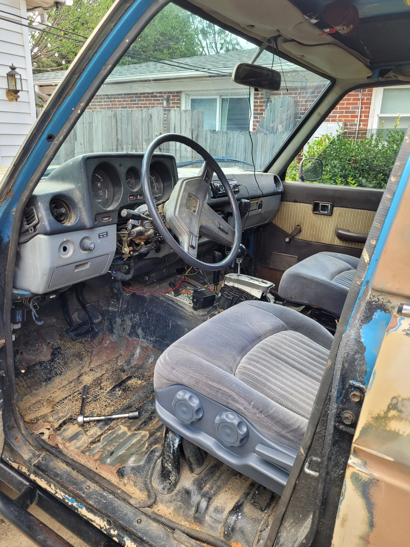

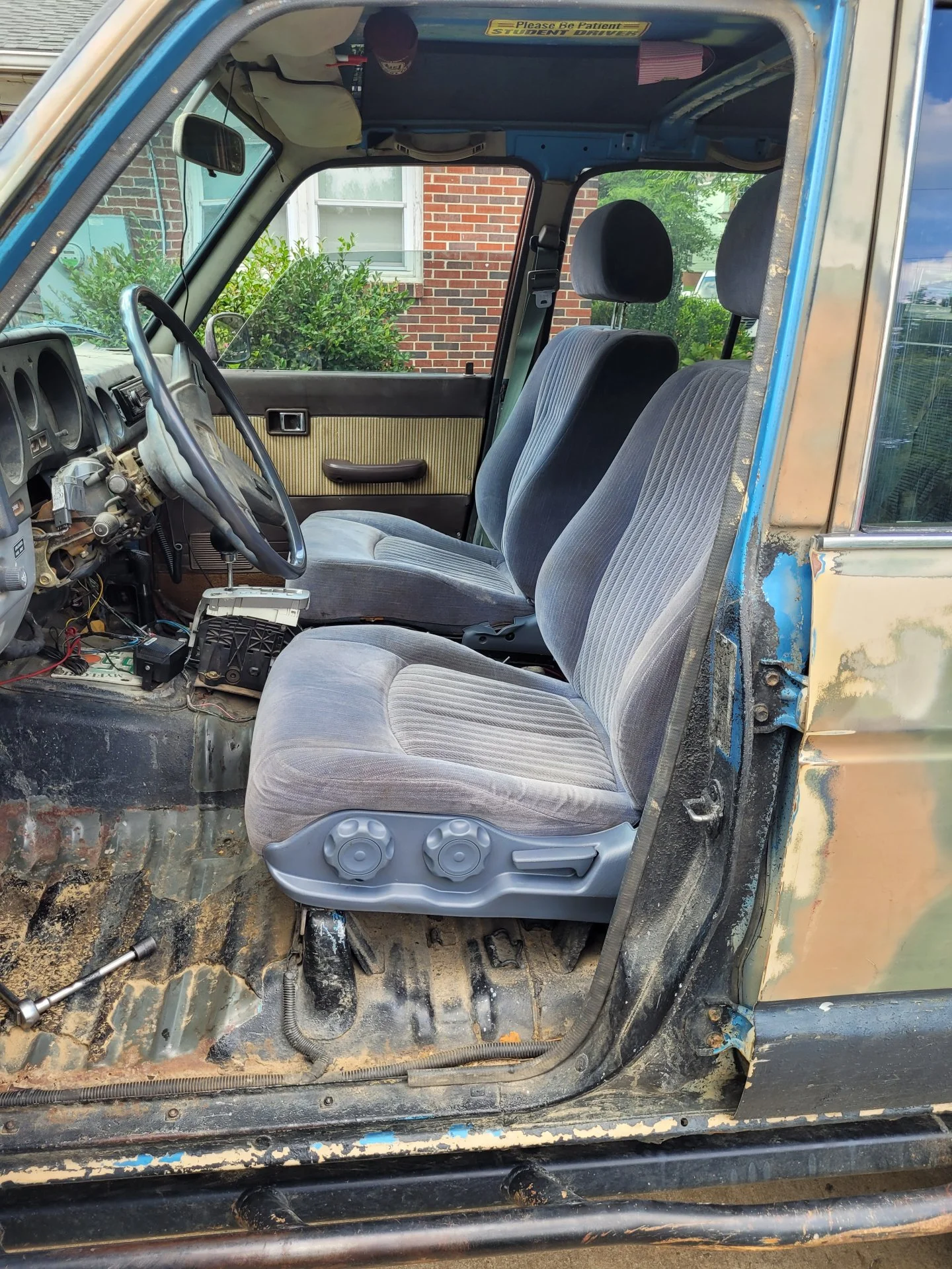

Ditched the 4RNR seats. They were a literal PITA.
Moved to what my experience had shown to be affordable and cheap...late '90s/early '00s Honda Accord.
Both are manual. Driver is 8 way adjustable. Fabric is even a close color match.

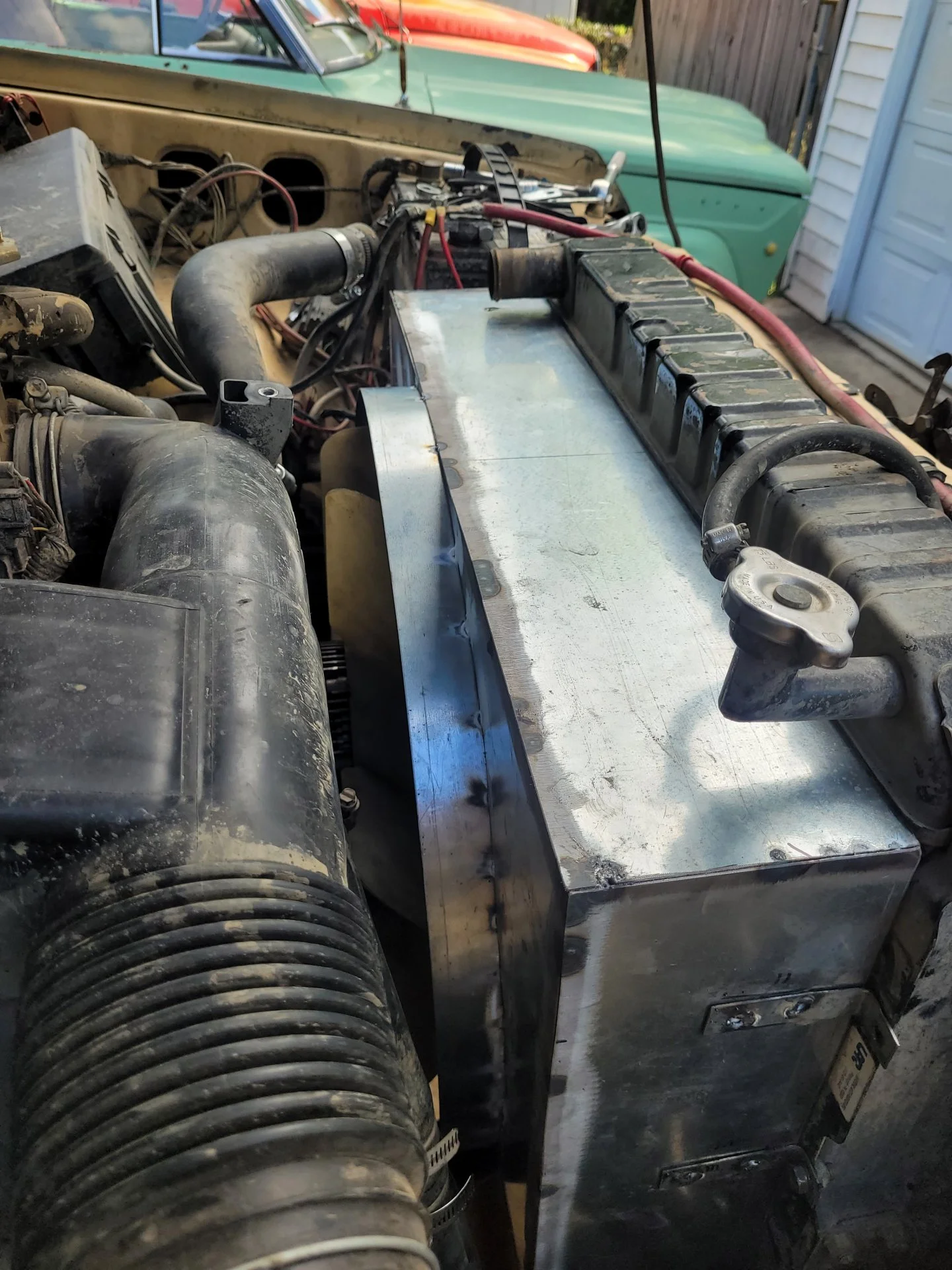

Ditched the electric fans and went to OE mechanical. New shroud/fan set-up requires a new hose arrangement. So, documenting for posterity:
Lower half of lower radiator hose is Gates PN 20230. Upper half is trimmed down section of 60/80/100 upper rad hose. Upper hose is same as upper half of lower.
It got many more spot welds, some flapper wheel, and a touch of rattle can to polish things up, but here's what it ended up with:
Zach, looks great! You may picked this up already, but is you shroud touching metal on metal with radiator? Can’t see from pics. Thought I would ask. I used some welting all around the sides facing the radiator to mitigate this.
