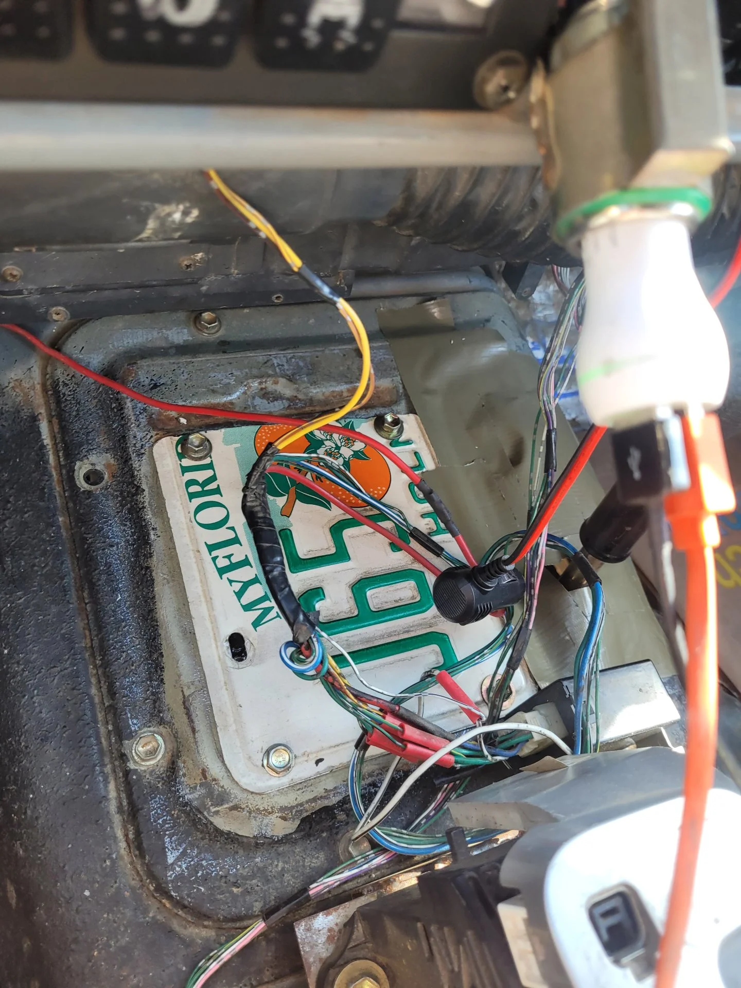

@thatcabledude donated an old license plate to fix one of my permanent temporary fixes. Much appreciated! Digging the look, too.
The other shifter hole wasn't as easy to patch up. A little more work there and itll get a similar plate solution.

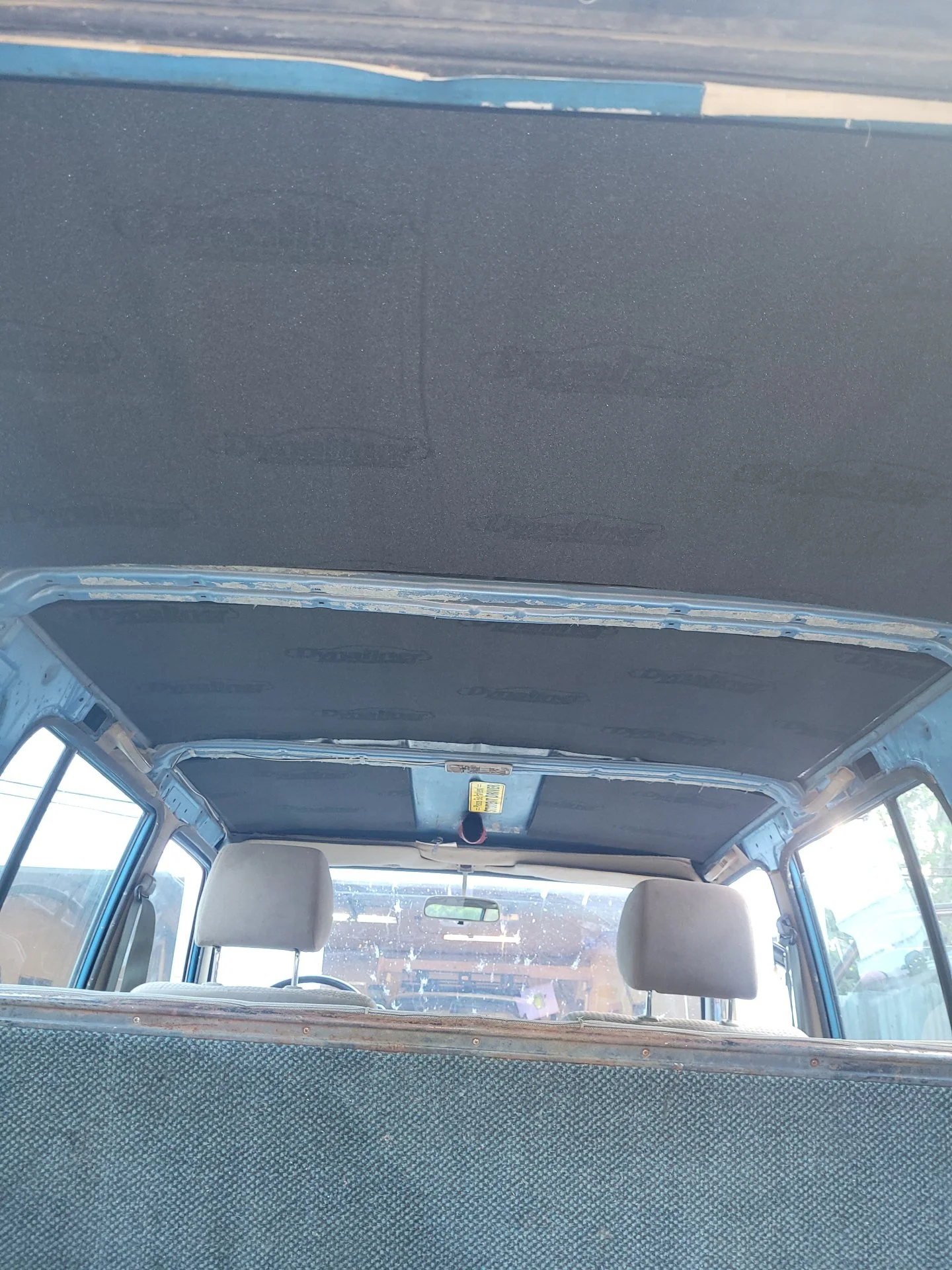

Pinion seal packed it in for good (3rd one to fail), so I'm knocking off other projects as I tear into the diff to see what's killing 'em. Got the dynaliner in this afternoon. Looking forward to see the thermal result.
Kept my magnetic storage bin 😉
Sure looks clean:

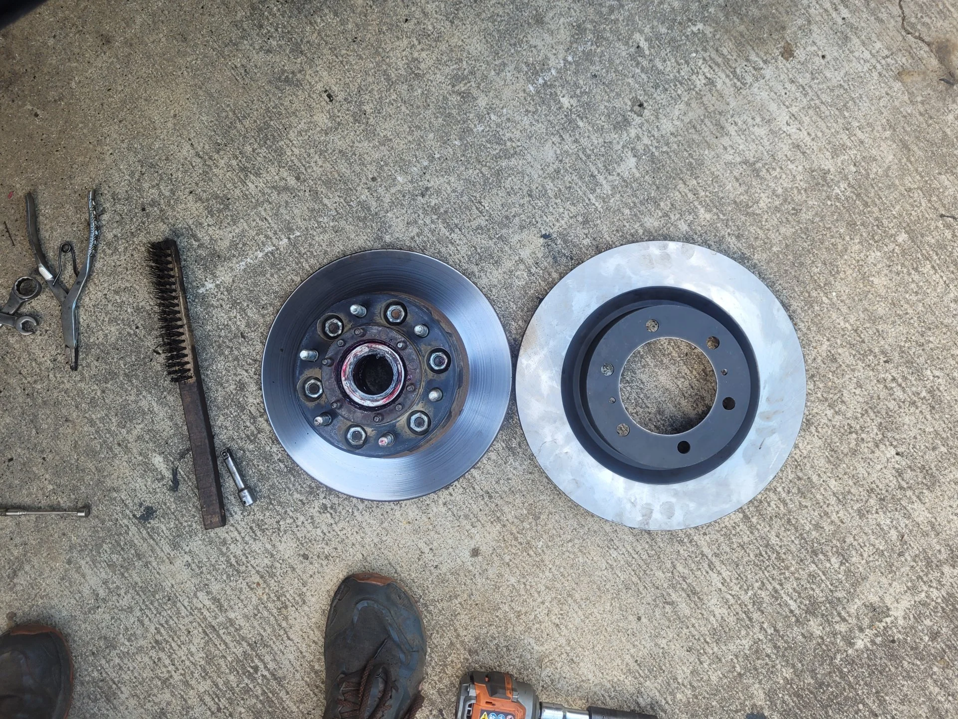

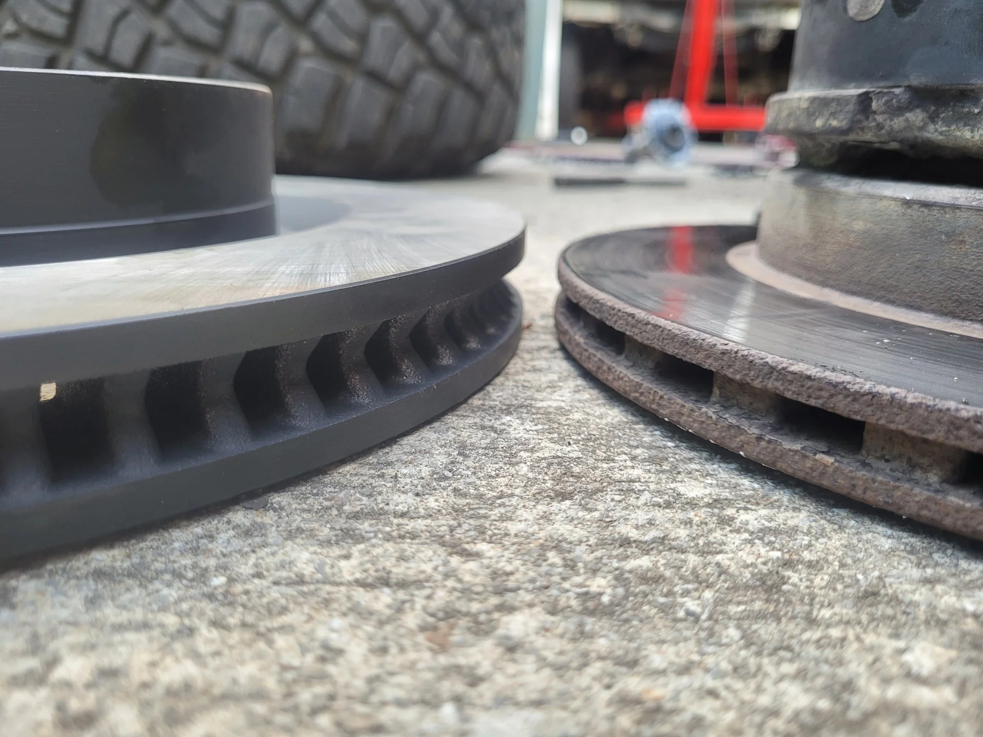

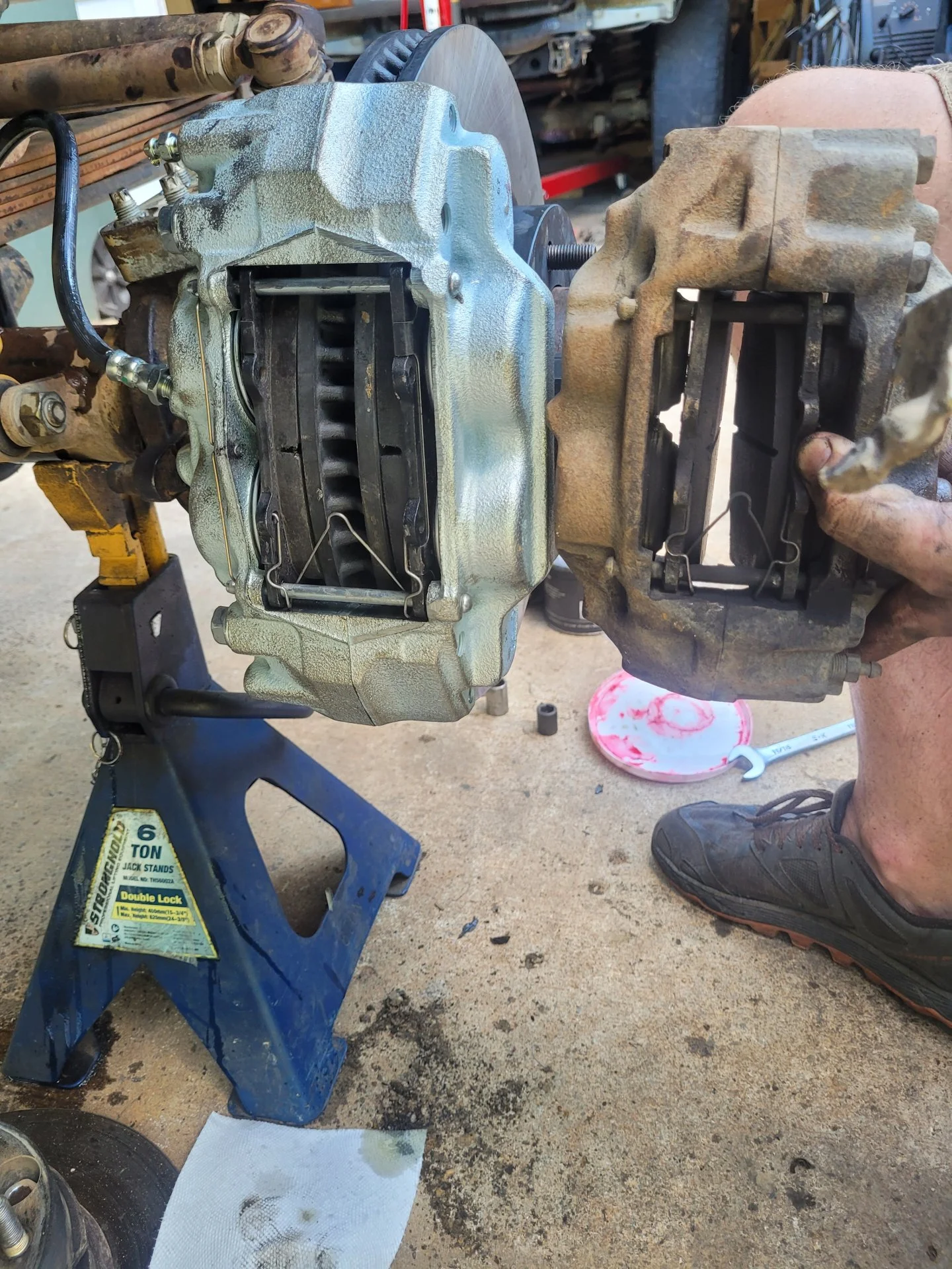

Productive Saturday. Ditched the 60 front brakes for a set from 5th gen 4runner.
These things are huge comparatively.

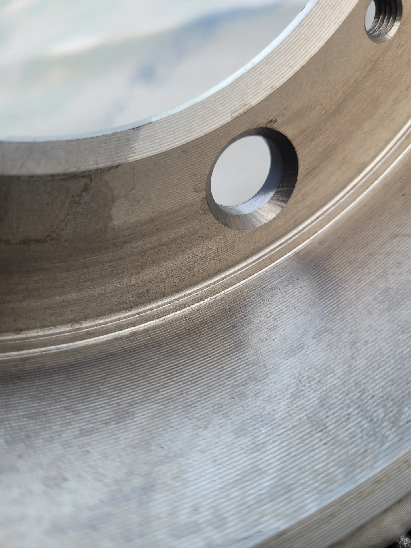

IFS hubs need one more machining op to fit 5th gen compared to 4th gen. The hub needs about a .060 chamfer to provide relief for the step shown below on the inside of the rotor. 4th gen doesn't need that.
^^^ did this recently for a friends 60. He drives a Mercedes AMG55. It stopped better than it!!!! Great upgrade.
Biggest improvements I've seen with it so far is the feel and the resistance to brake fade. Definitely recommend the swap.

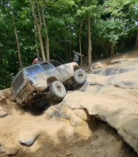

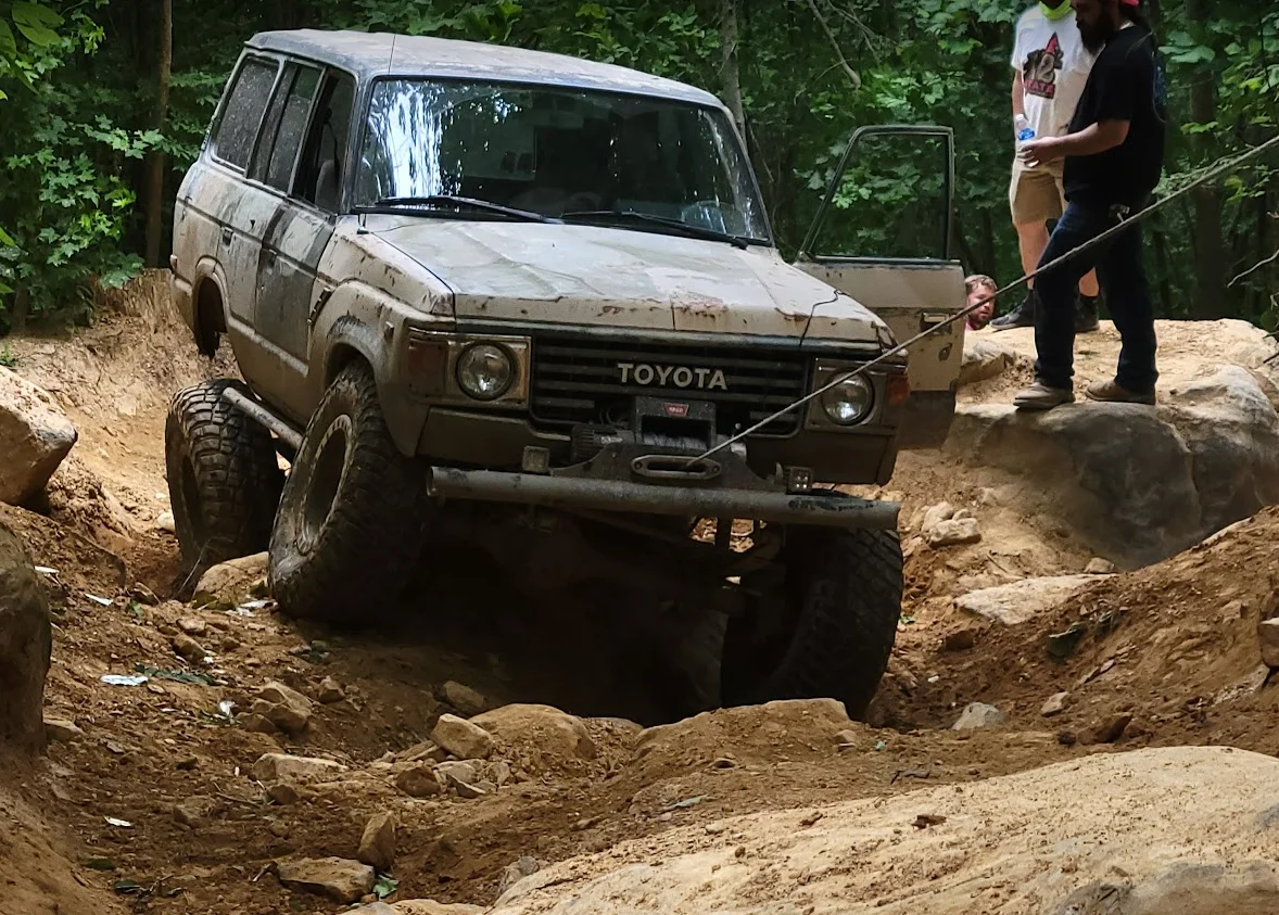

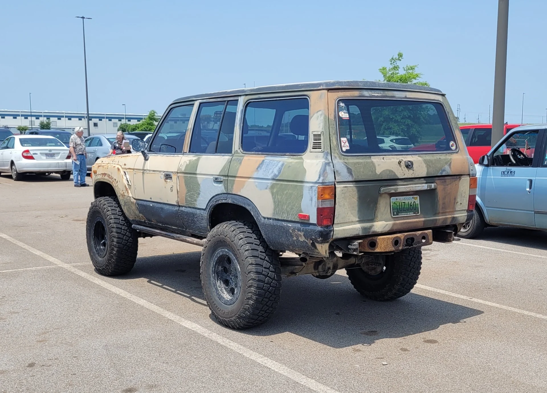

GMSTR 2022 was a blast! All the "bigger" stuff I had run before this trip was dress rehearsal.
@bush and I ran some reds and had a riot of a day. Smashed a qtr panel, but it was worth it! Was fun running some of this buggy stuff and then driving it home. Thanks go to some seriously good spotting and some patience from the boys at Budbuilt and 12th State Offroad.

GMSTR 2022 was a blast! Finally got Camo into some trails that all this work was done for, and she did well thanks to some seriously good spotting and some patience from the boys at Budbuilt and 12th State Offroad.
View attachment 3039644View attachment 3039645View attachment 3039646

Yeah we did have a blast that day. Really all week.
And you drove yours home. Mine only made it halfway...
What happened?
What happened?
Don't exactly know yet. Started grinding on coast. TCase oil was full of glitter and flakes. Going to get it Saturday and tear down.
