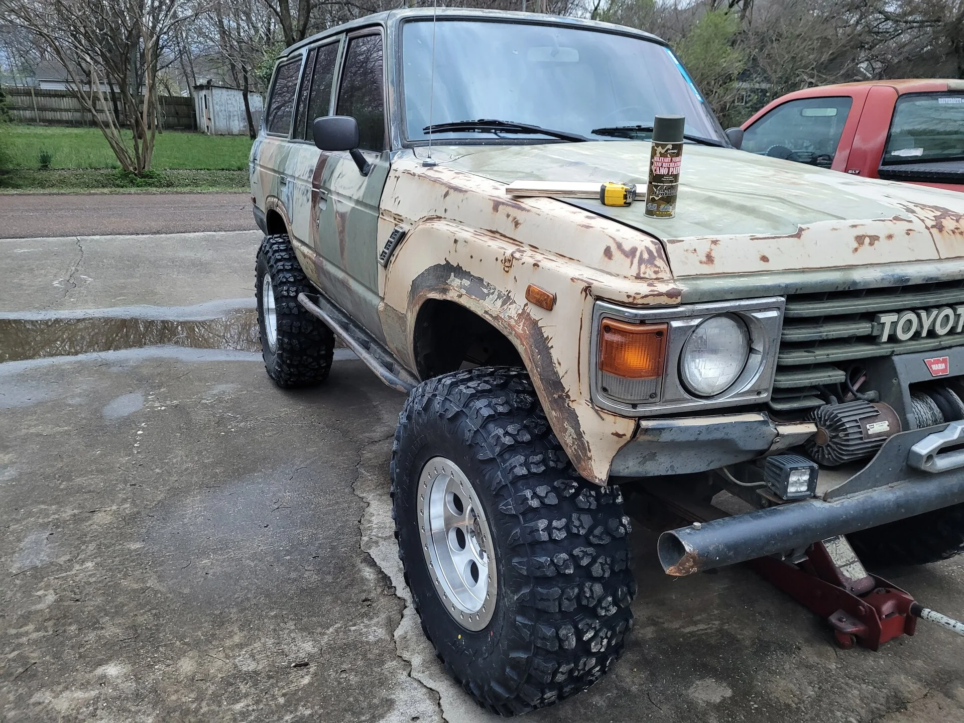

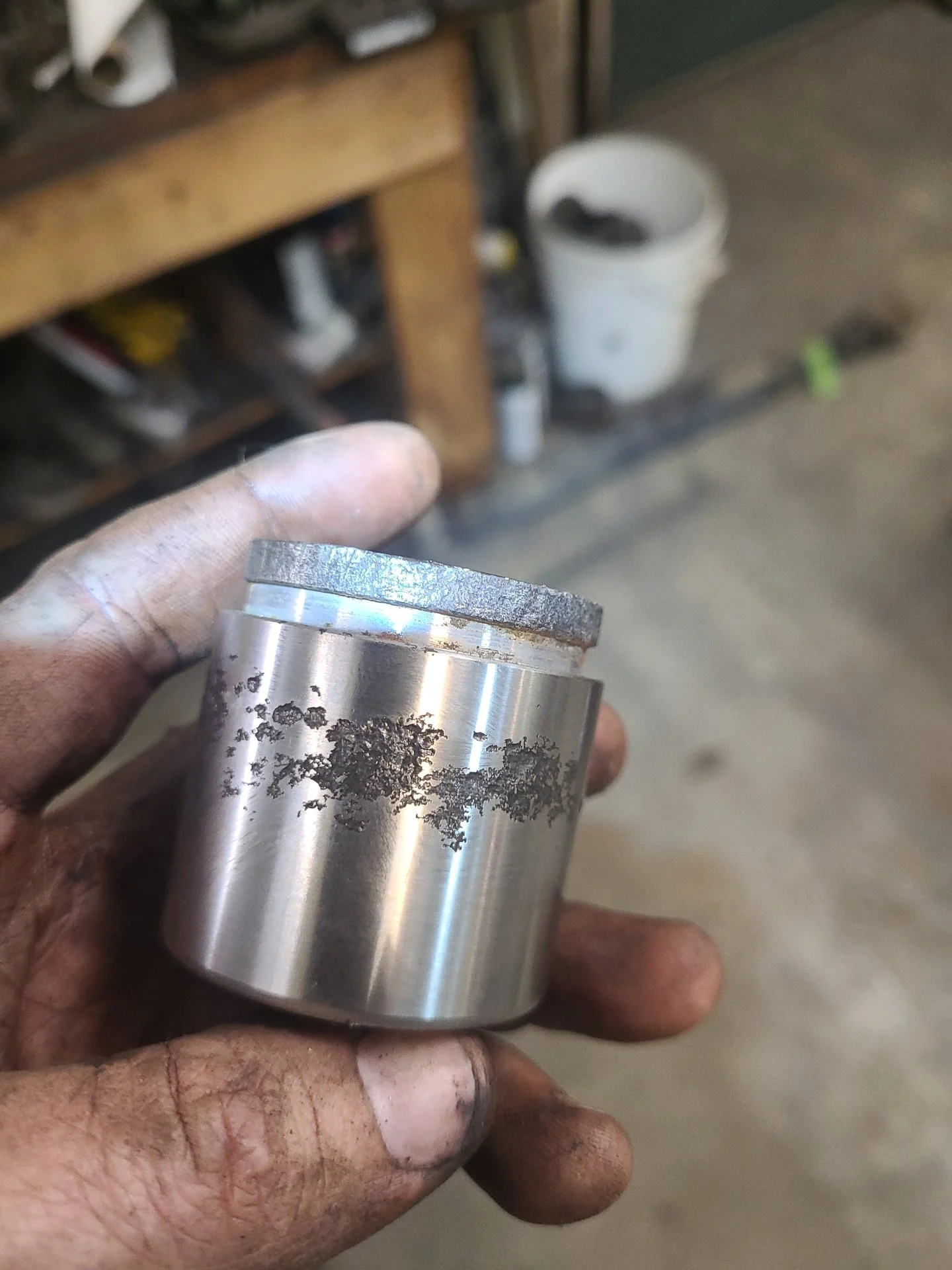

Rear brakes packed it up. Lots of warpage. Both pistons were stuck. Went for a $14 rebuild...
...and then went for the remans. Those pits were wicked deep. Brake fluid is a service item, people. Cmon.

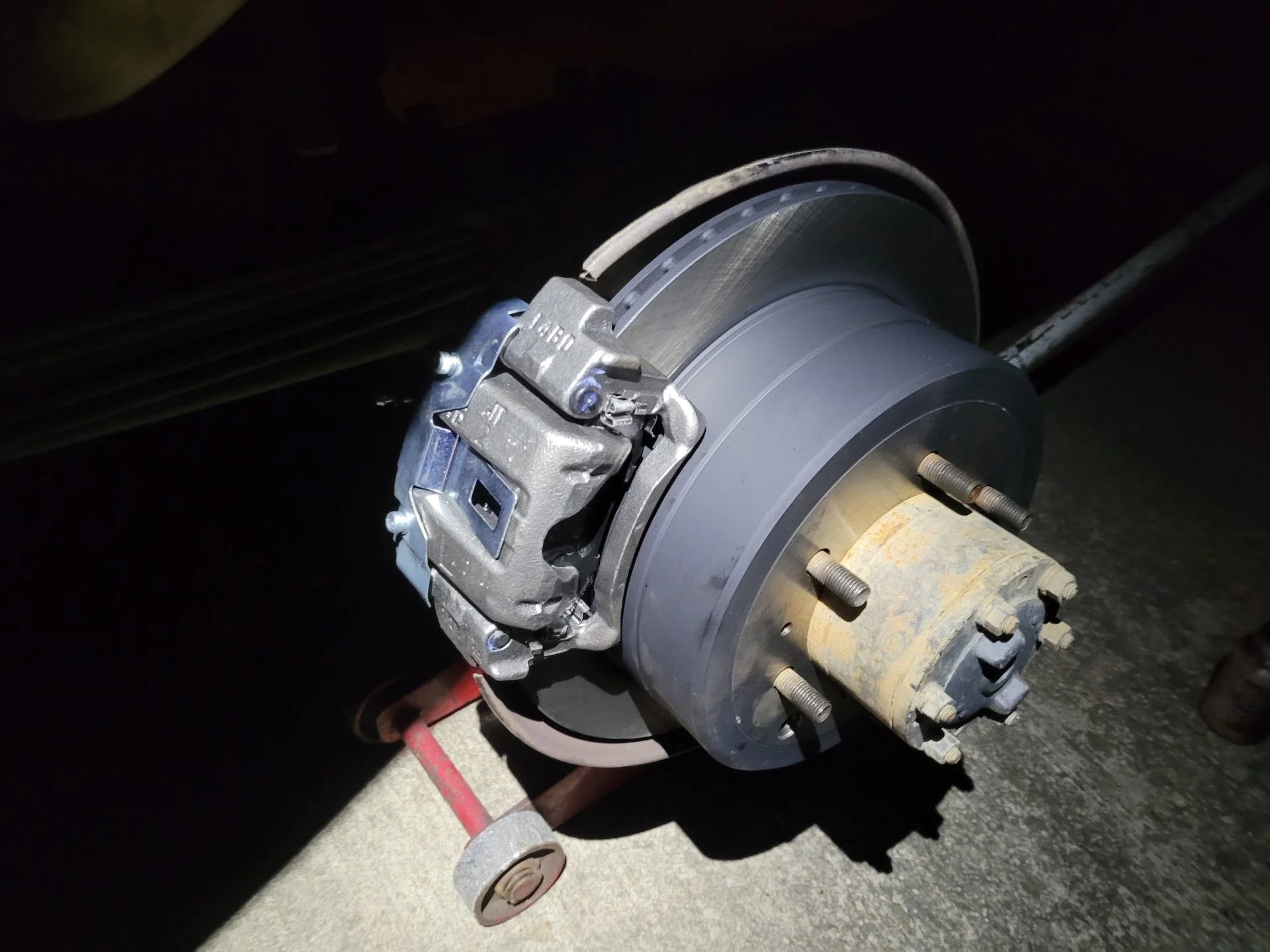

Big Box remans and pads around some OE rotors because they were cheaper (nuts). New shiny:

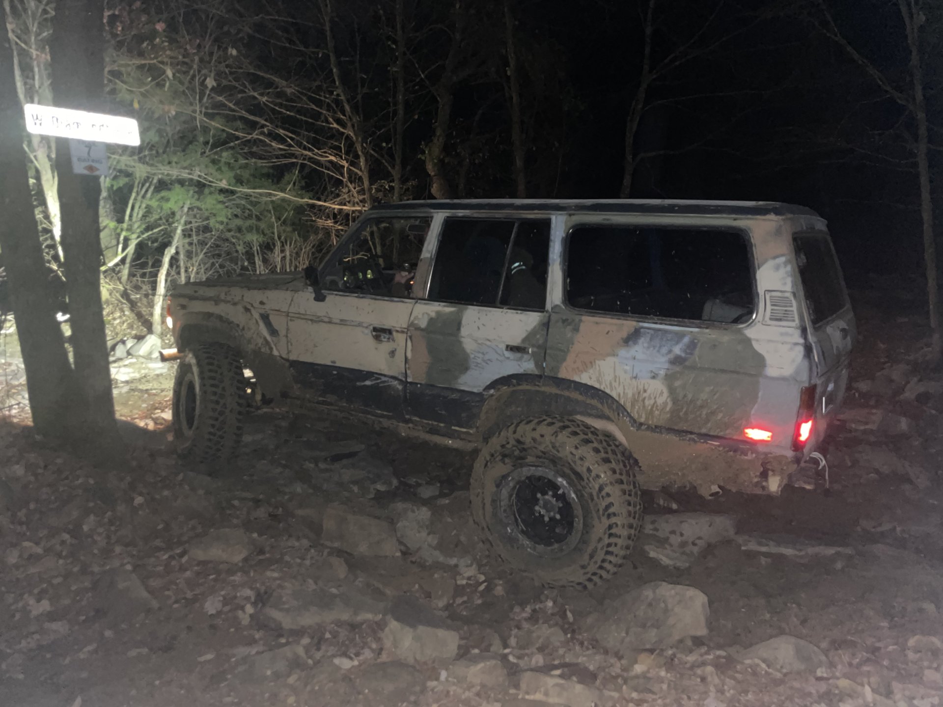

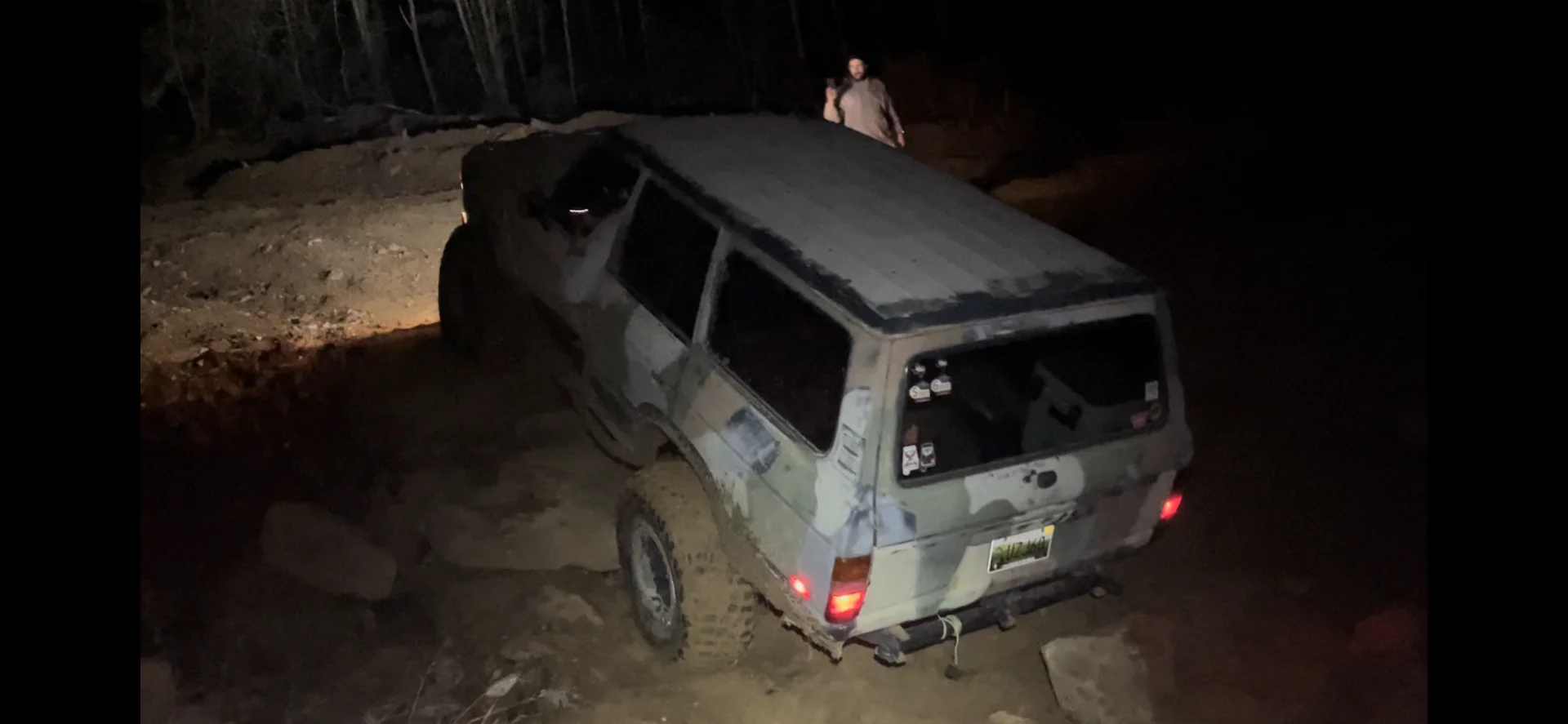

Veteran's Day Ride is behind us. Such a good time. Slept the afternoon away yesterday trying to catch up on zzzzs.
Camo needs a belly pan in a really bad way. This was the second time I rolled the dice, put the case up on a boulder, and got away with it. Those noises put me on tilt for a while and left me being more gentle than I needed to be. Nothing some steel can't fix.
On the other hand, he played tow truck and dead-pulled @bush up and out of the peanut-butter-coated bottom end of the park after Ginger's electrical pitched a fit. If anyone got that ride on film...I'm sure a few of would love to see it. Mel McDaniel's "Stand on it" would be a fitting soundtrack.
Straight body panels remaining: 1. Needs to get home: gas.

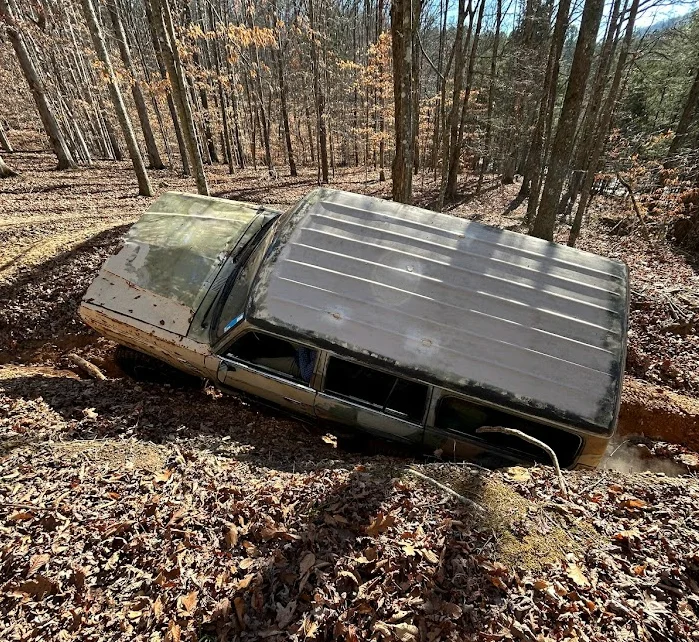

Can confirm. Dice was rolled.

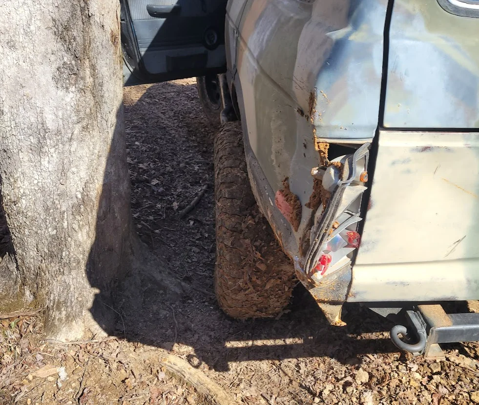

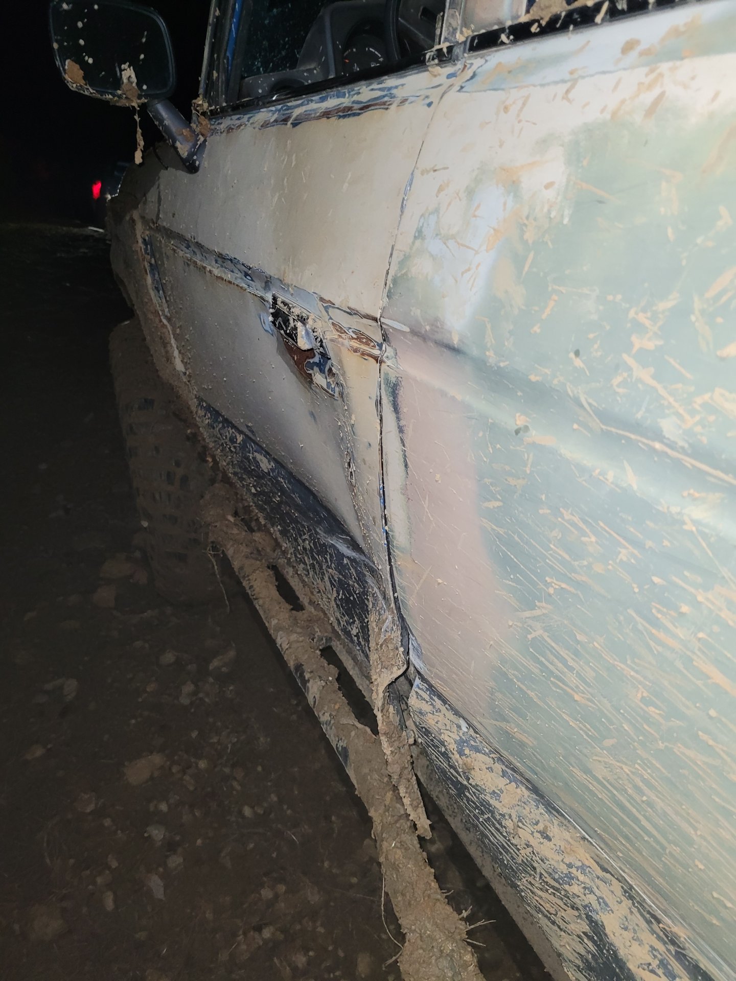

Wall gave way and....crunch. That one was just a few weeks old, too.

That's why I moved to the smaller tail lights, lol.
I've got some scamazon trailer lamps to try after I quasi-straighten the body. I almost feel bad crushing these lenses.

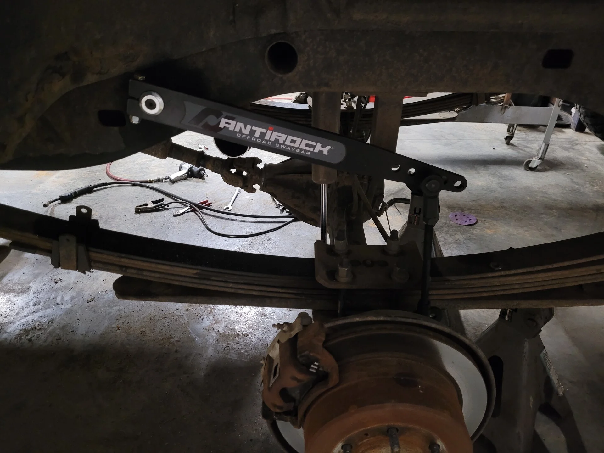

Finally got around to installing the sway bar. Packages very well. Helps enough on the road to notice a real improvement without feeling so firm to cause concern for the trails.
Currently set with arms parallel to the ground with perpendicular links.

which arm length and bar diameter?
45" bar, 0.8" OD, 20" arms set at mid position (5 holes), links have 5" cut out of them to make it all fit.
RJ kinda sticks it to you on that length. Only one bar OD to choose from.

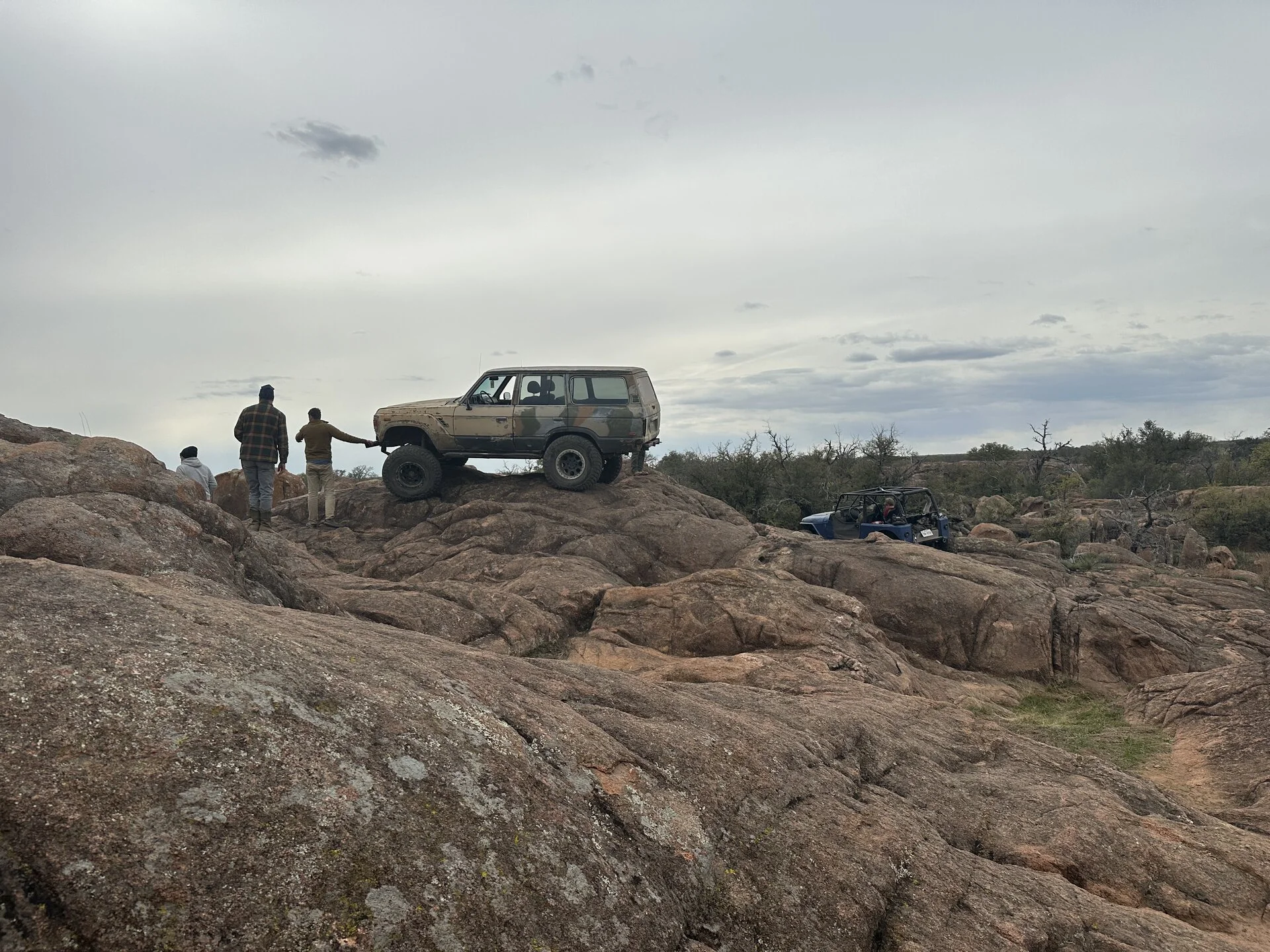

Took a little trip out to Lone Star Cruiser Round Up. Ate and drank well. Had a ball. Wheeling on those rocks is like driving on Velcro. TX's FM road speed limits are laughably high. Sway bar worked a treat. I'll move the links to give the rear axle a bit more leverage, but all in all it's a welcomed addition.

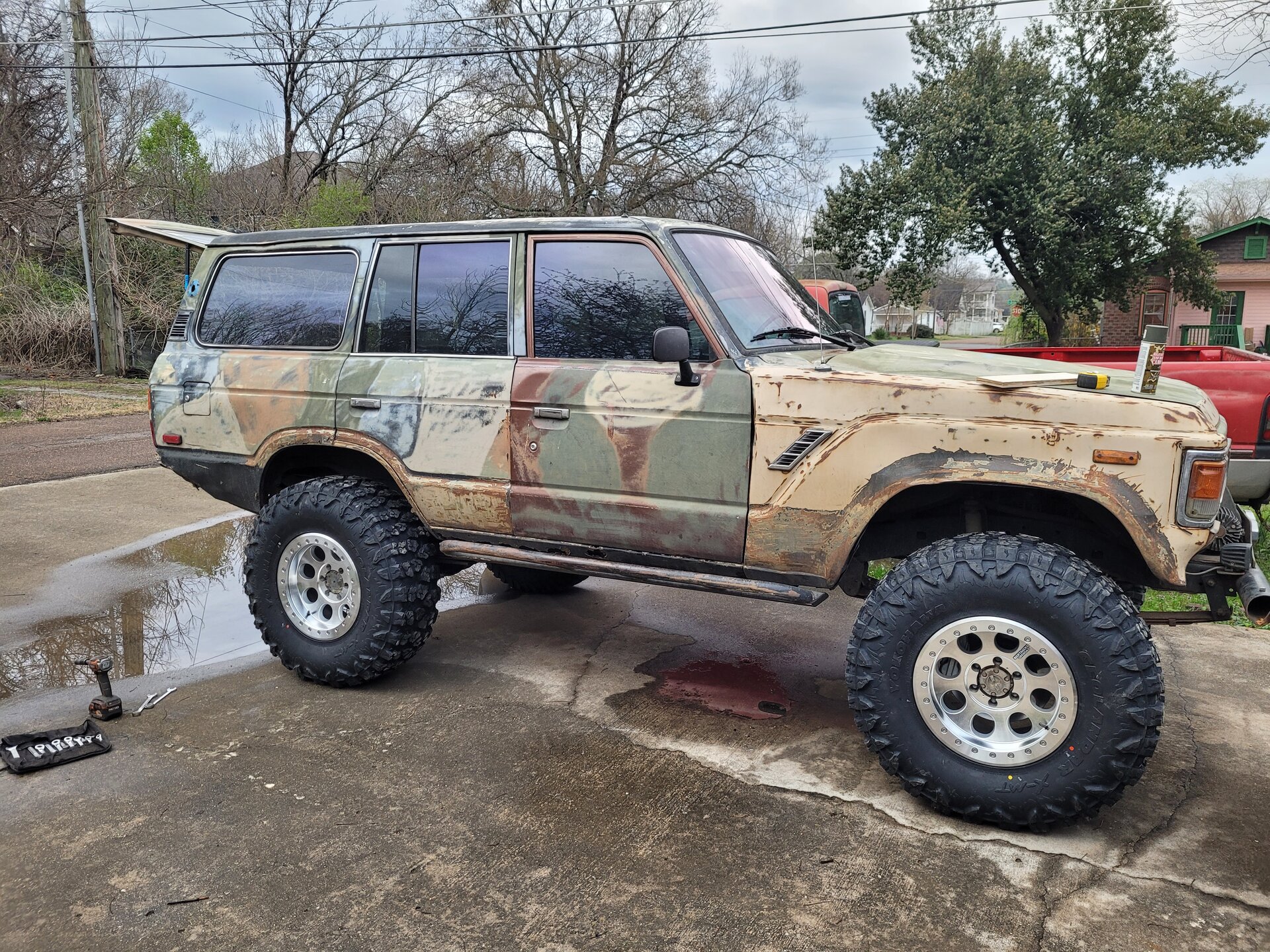

Texas was the end of the KM3s. They worked well there, but they suck here. So new shoes were in order for '23. Stayed with 37s, but switched tire manufacturers. Added another set of locks. The black ones are getting wrapped with reds from @Skitz.
