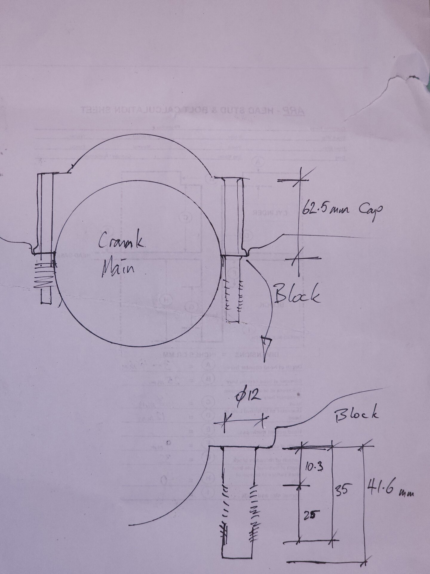

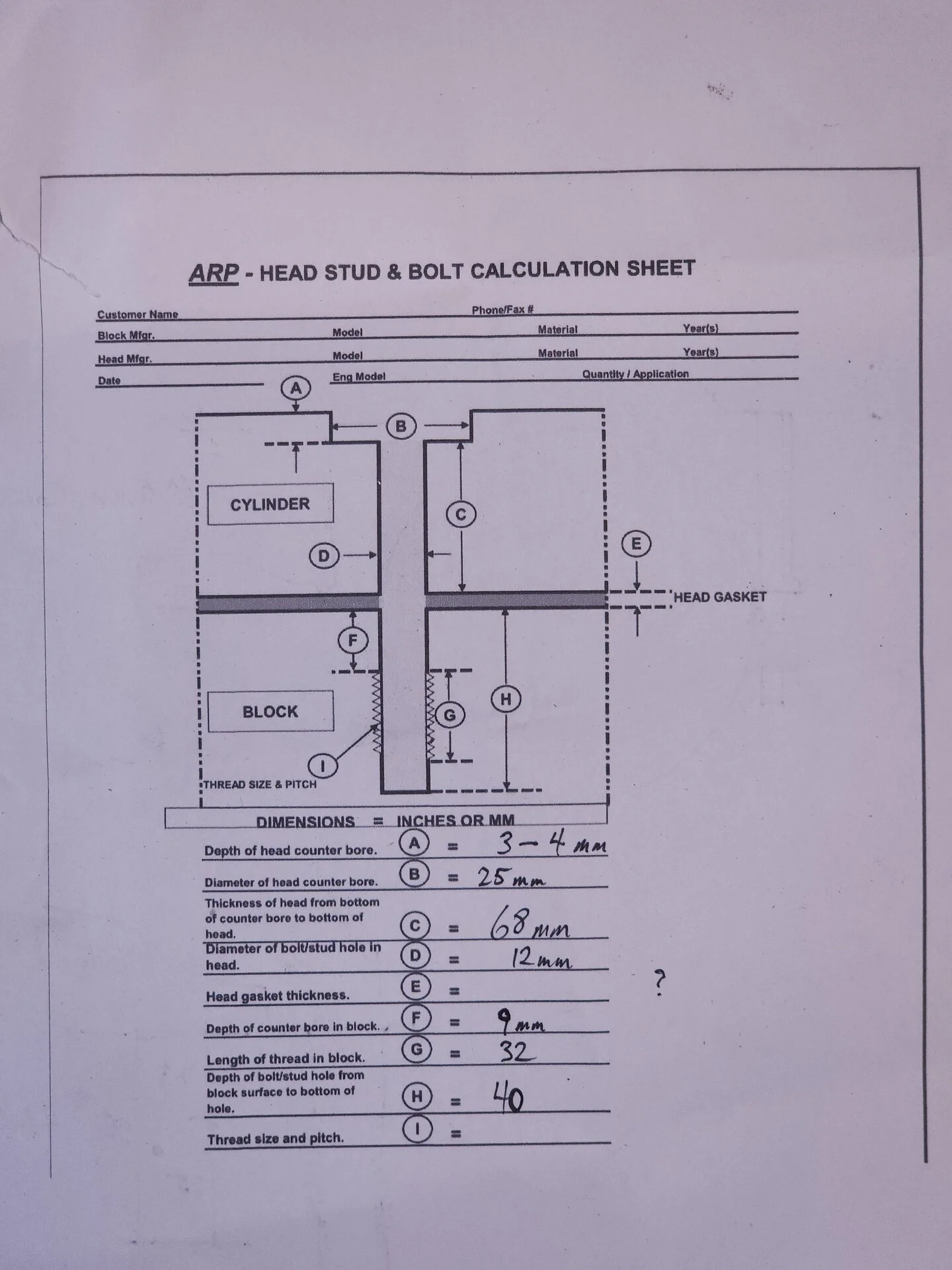

Couldn't find Toyota spec sheets for head bolts/washers or main bolts. @OGBeno says I never will. So I sent a new head bolt/washer to my ARP contact, hoping they might have an exact fit off-the-shelf so we don't have to mess around with Opel and Supra studs. I'm told they need more information; same deal with main studs. I do not have a disassembled engine to measure. Anyone here have the engine and the tools to do this on a 1FZ? Here's what they told me...
Do you have a fastener calc sheet for this engine? We cannot do any better than guessing without a calc sheet. The bolt you supplied will confirm the thread size/pitch, rough estimate of length and the clamp load requirement but matching a stud will require more info. This would apply to the main studs as well. I attached a calc sheet for reference.

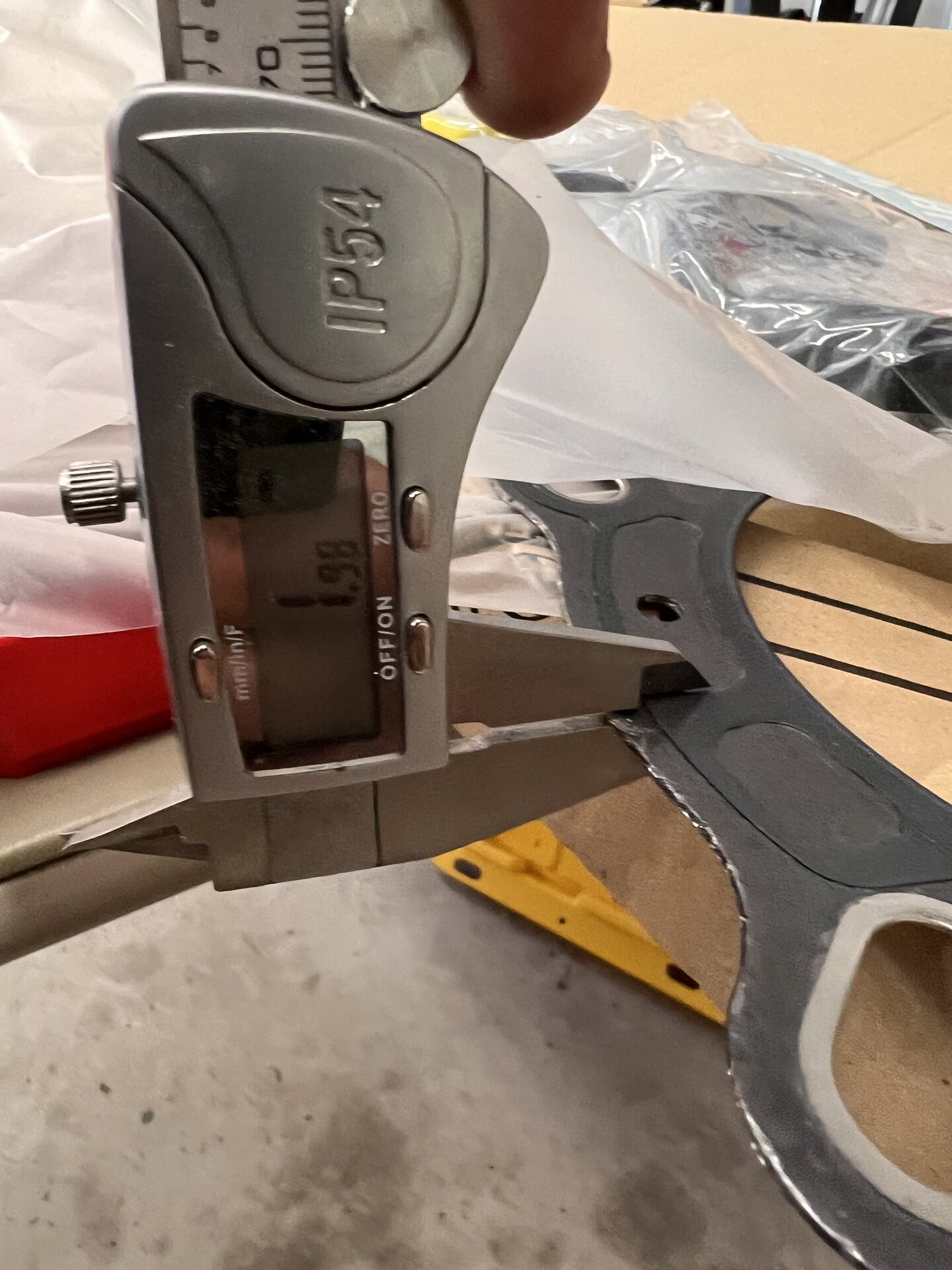

Stock gasket, yes sir. 1.98mm. I went to a Cometic when I did my rebuild after they shaved the deck in anticipation of installing a turbo…..
Can’t find the email but I believe the Cometic folks have the compressed thickness of the installed stock HG.
They range from .030 to .120; was just checking them out for ARP...
Read the short thread for what Cometic has in the system.
Question from ARP:
When people are using the 5.000" stud, how much are they having to trim off the top? Like .200"?
I've seen a few references on Mud to .25" -- can anyone confirm or deny?

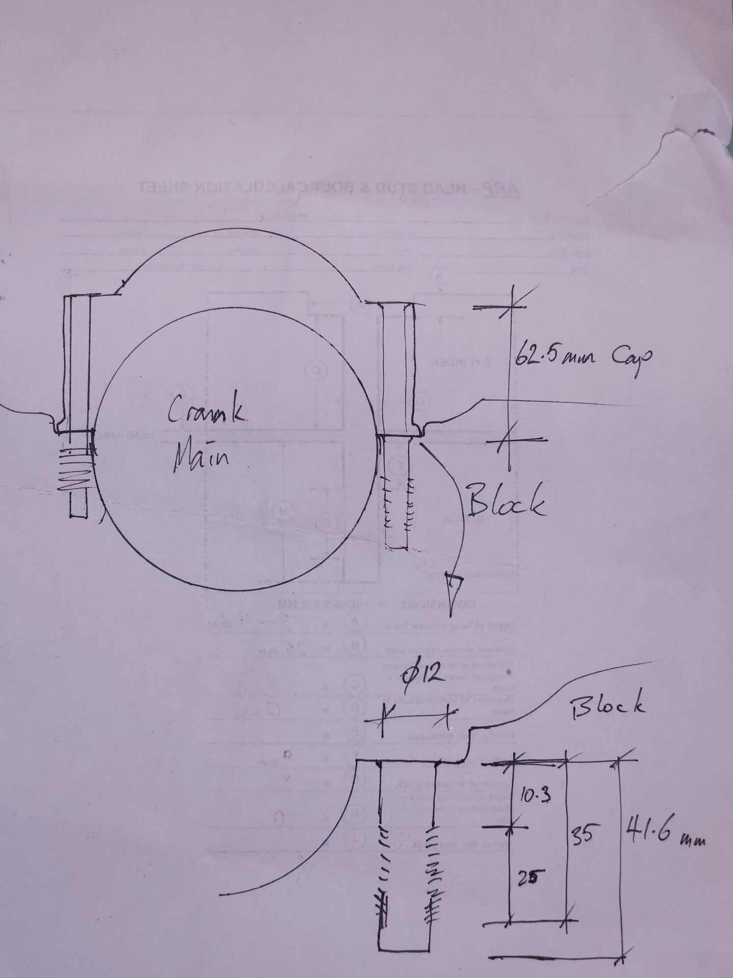

Because I didn't sent them a main bolt, they wanna know thread size and pitch, which are not shown on this sheet. Anyone...? And are there washers used here? Thanks!
It’s the same thread size and pitch you can use the same stud you just have to trim for oil pan clearance
You mean same as head bolt?
