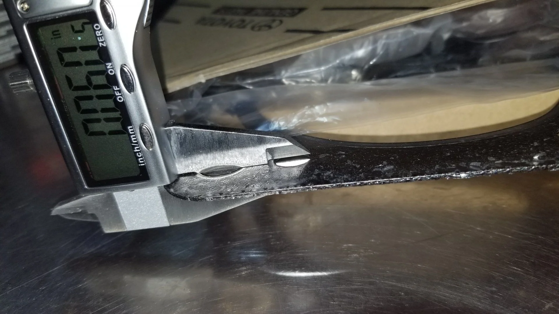

Brand new Toyota gasket for a 1FZ-FE. Just happened to catch me at the right time during install of mine so I thought I could help.
Very much appreciated! Good luck with your rebuild.
