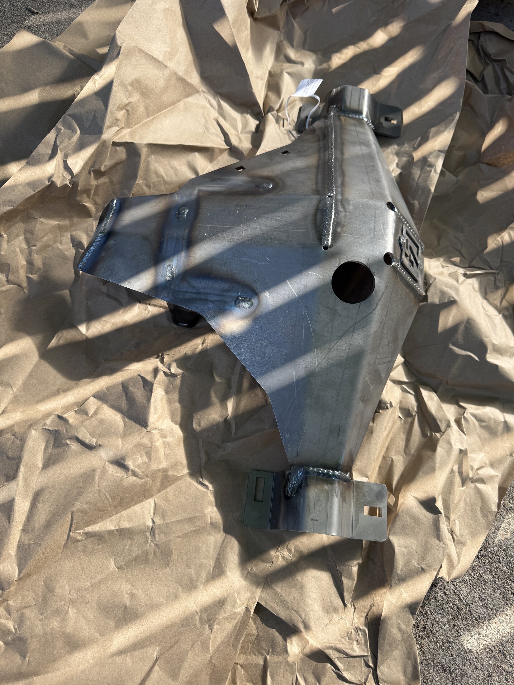

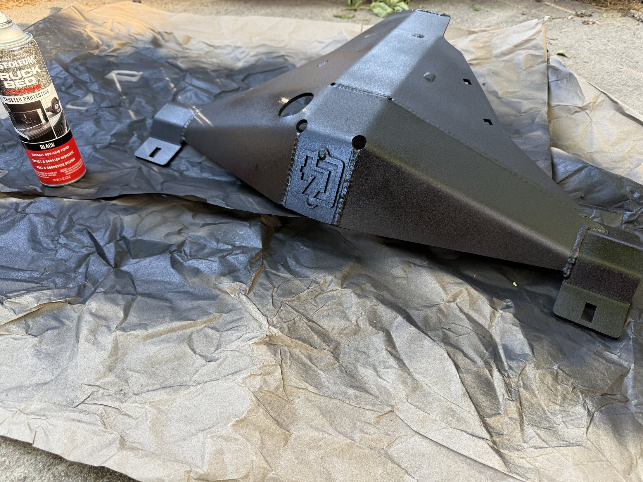

Scraped my pumpkin at Cruise Moab back in April. Looked around at different skid options and landed on C4 with the e-locker protection which just arrived after ~8 weeks. Got around to applying truck bed liner so far and will aim to install this weekend.

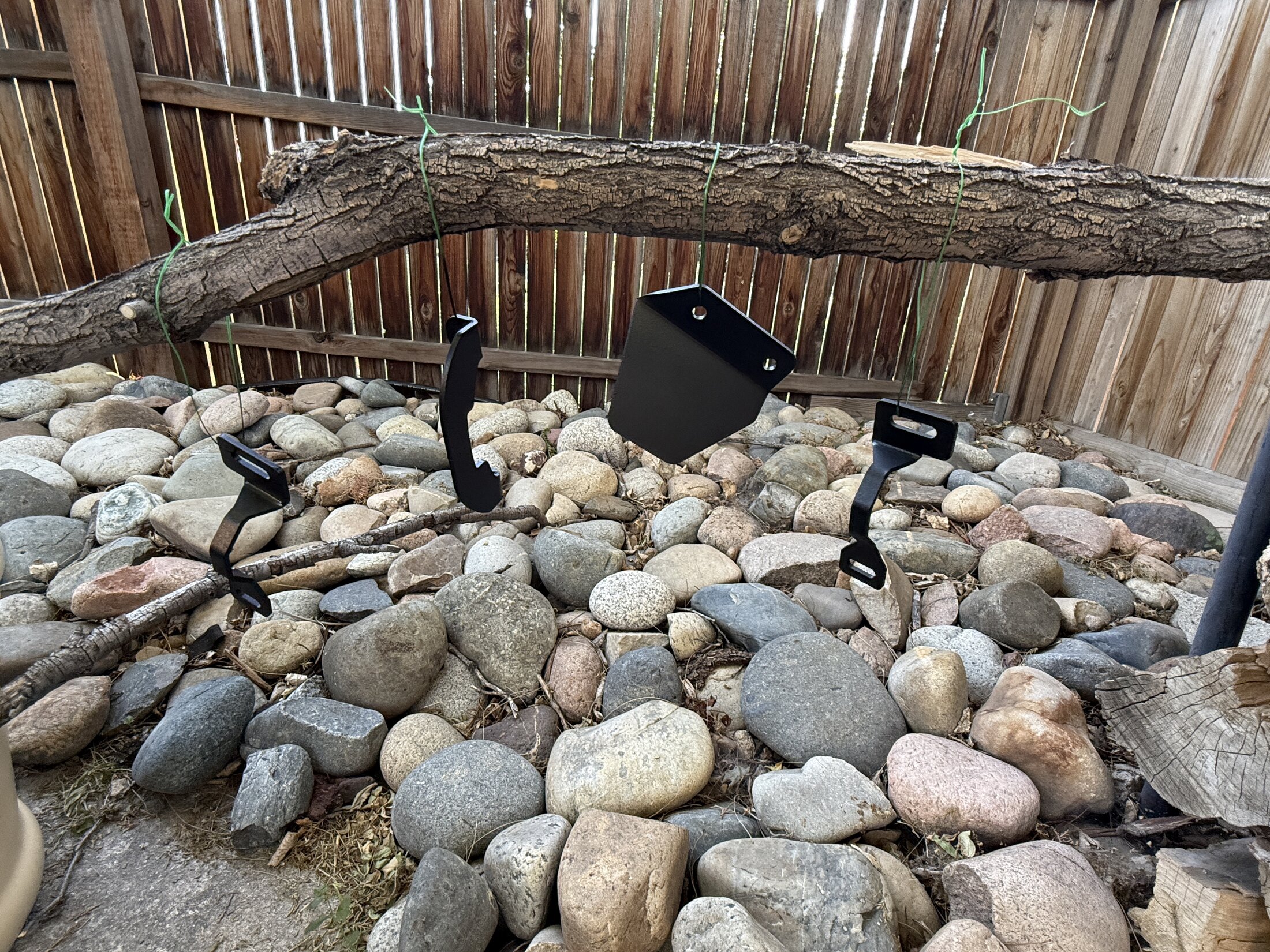

Got around to installing the C4 diff skid today. Took about 2 hrs all in (probably a 30 min job with a lift). Removed the spare and had to remove the factory e-locker guard (C4 indicated this might not be required).
Not too bad of an install other than the yoke clamp which was a bit finicky. I ended up grabbing a 1.5” 3/8 carriage bolt to get it seated.
