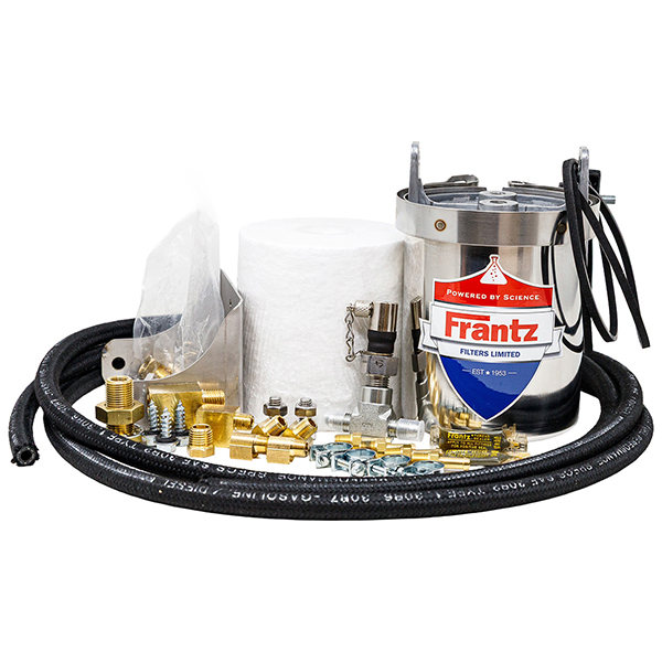

The Franz site has interesting information. Last trip I didn’t change oil just before I left. I’d being

After looking at that Franz site again, I’m trying to figure out how this thing would mount with the factory
set up. Is the secondary filter used inline factory and where in the system does it attach?

The Bypass systems I like are separate/stand alone.
The Bypass filter will never handle the volume of the higher micron OEM filter. One can tap into an oil pressured gallery (usually a BSP thread) and run a line to the bypass filter mounted remotely on the firewall or fender or what have you. Then the return line goes from the bypass filter into a tapped hole in the engine oil filler cap. I'd have welded a bung to the top of the valve cover and added a fitting for a cleaner look and left the filler cap alone (but that's just me).
