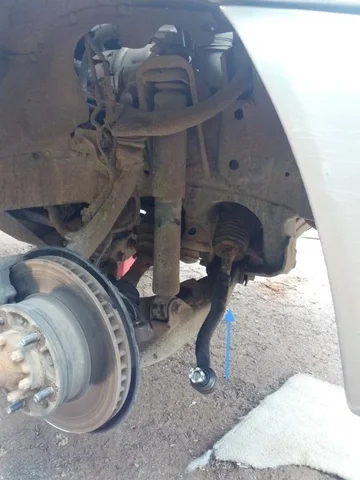

4. then rackends and t-rods (it being a 99, I think it is safe to assume that you need to change both the rack-ends and the t-rods -also, sometimes you may only discover the rack ends are gone by disconnecting the t-rods and feeling for any give) in the pic below -once disconnected -push it in and out with your hands as per arrow ... if it gives, it's gone -and I bet that yours will give a little given their age -mine were ...

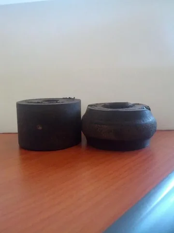

Good luck!! ... -on bushes ... I did mine some weeks ago and while they may appear visually ok they are well past their prime ... here are front shox bushes -new vs old ... although I must say that LC shox bushes hold up very very well ...
