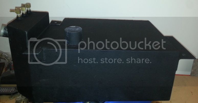

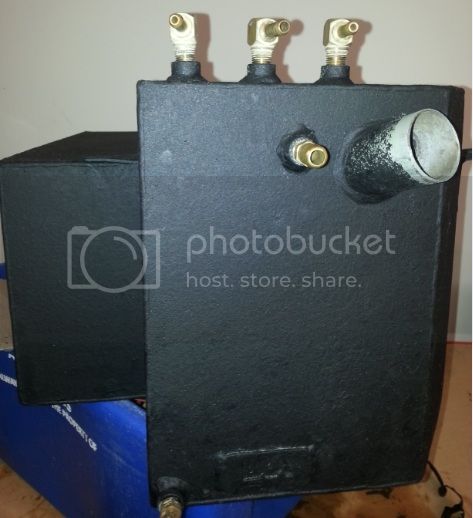

Hi guys just seeking some opinions here. Im putting a Fj40 body onto a Bundera RJ70 chassis. The Chassis came with a LRA ( long range automotive ( australian company) 50 Liter long range tank. It bolts in between the rear shock mount brace and gear box brace. Question i have is it worth keeping? or would i be better off selling it then buying an original 90 Liter Bundera tank? Ill already have to original FJ40 tank in the cabin. Is it worth keeping that space in the rear free for say a water tank or air tank?

If you put the body of the fj40 on the rj70 the frame and the original tank will be out of the body.
So will cut the end of the frame and you will never fixed again the original tank of the rj70.
The best thing is to keep the LRA tank and use it.

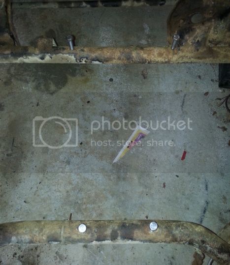

bundyred, Yes. Pic three with the stainless bolt denotes the mounting location
Yes the bundera frame is longer than the Fj frame and the original tank wont fit.
