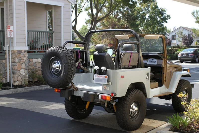

Bumps on my 78’s rear tub/fenders?
Believe the lower splash guard is factory... I have one on my rig as well. I don't think a lot of people have even seen them- I know I've had a couple guys ask me about mine at least.

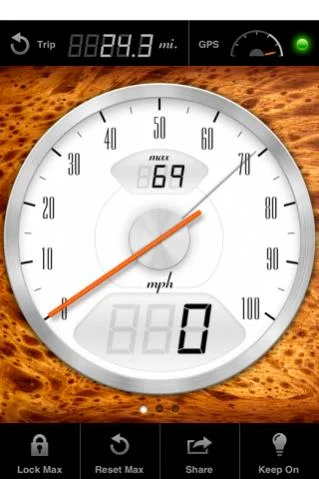

Drove 24 miles on 101 yesterday to get the engine hot. At 69 mph the speedo reads around 60 - I guess that's typical with the 33 tires? Anyone know a formula to figure how far off the odometer might be over a tank of gas? Want to get an accurate estimate of gas mileage at some point.

Multiple ways to do this, but the odometer will be off by the same percentage as the speedometer. To figure the percentage, it's speedometer reading divided by actual speed. In your case, thats 60/69=0.8696 or about 13% slower or fewer miles registered than actually traveled.
You could figure your MPG using your actual odometer reading and gallons used, then just divide by the factor which is .8696
for instance, if you went 100 miles and used 6.8 gallons of gas:
100/6.8=14.705
then the correction:
14.705/.8696=16.91 mpg

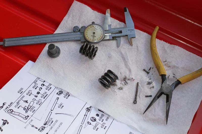

Got the new drag link spring from Toyota . . .
Old spring measures .920 overall - new spring is .960 in overall. Don't think the .040 will make much of a difference but I changed it anyway. Keeps the plug (cotter key) out a little anyway - so the plug is not as deep.

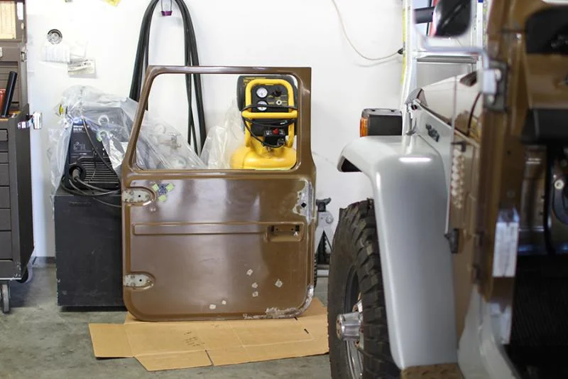

Back to the doors.

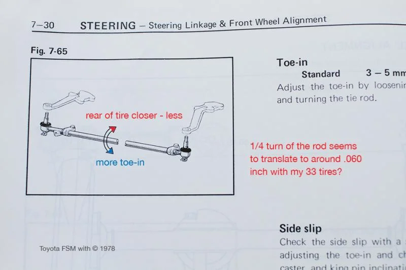

Took the 40 to Big O (where I bought the tires) for my "free" alignment check. The manager guy said they didn't have specs in the machine for a 78 Land Cruiser so he couldn't check it. I drove away thinking it was probably for the best anyway. My tie-rod was all frozen up and looks like the last adjustment was a long time ago, if ever. I started thinking about at least breaking the tie rod threads free myself to keep someone from applying a lot of force to the ball-ends down the road.
Made a bunch of measurements on the tires and came up with what looks like 1/8" of toe. Then I spent some time cleaning and oiling up the threads on the tie rod. Finally got tie rod threads free using a 16mm open end on the little flat on the ball ends to keep pressure off the joints. Then tried some static adjustments with the truck just setting on the ground. The only thing I could figure from the FSM [Standard 3~5 mm (0.12~0.20 in.), DR78-15B tire -1~1 mm (-0.04~0.04 in.] is toe is 1/8 inch but a radial tire gets less? Anyway got it to what looked like (tape measure so who knows) a 1/16 in. (.060) which seemed to be only 1/4 to 1/2 turn of the rod (at most) - does that sound right?
Put the clamps back on and did a 15 minute test drive and it seems to drive better than it ever has (no freeway yet). May try to remove some more and see how that goes.
1/16" toe-in with that size tire should be about correct , see if it tries to follow the washboards on the highway and also check it closely on highly crowned side roads . Up to around 33" on solid axles I've always ran 1/16" inward with no tire wear issues or bad tracking . 35"+ and they need a bit more...
Sarge
Thanks for the feedback. :)

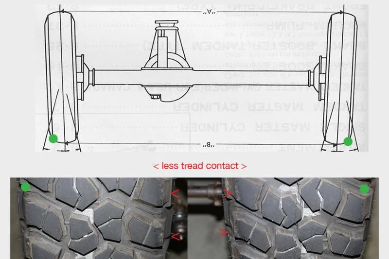

My new tires seemed to be making (before the adjustment) more contact on the outside edges. Not enough mileage to call it wear, but you can see less contact on the inside tread. This seemed to have improved with the toe-in adjustment (this photo - after the short test drive). Is that outside contact (less on the inside) consistent with too much toe-in? I think I can see less dirt on the inside tread now.
Because of the knuckle bearing centerlines, the tires will lean, top out or positive castor, as you steer left or right. This could be the cause of why you see tire tread contact more to the outside of the tread but not the inside.
However, large amounts of excess toe-in will case the inside of the tread to 'cup' or wear faster than the outside, at least that has been my experience. Perhaps too much toe out, might cause the opposite.
You might try to run the tires through dirt to get the thread dirty, then drive straight for a short distance on pavement and see what the contact pattern looks like. If you do not have contact across the entire tread inside to outside, then you could drop the pressure until you get near full contact. I think I see in your pictures that the outer most tread has less contact than the center.
