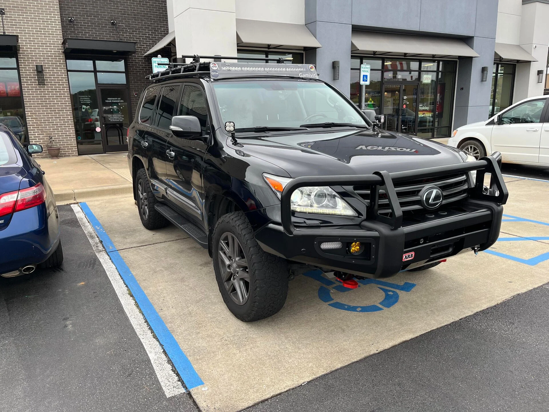

Bull Bar onto '13 LX 570: how hard?
Sorry for the late reply- took a mud sabbatical. My Lx is a 2015. Feel free to ask anything.
Been quite a while since this post. In hindsight…Would you still do the same bumper/configuration? Do you feel it was a good decision and it was it easy to live with and easy on the eyes? I’m thinking about having a ARB Deluxe add it to my Black 2015, LX 570.

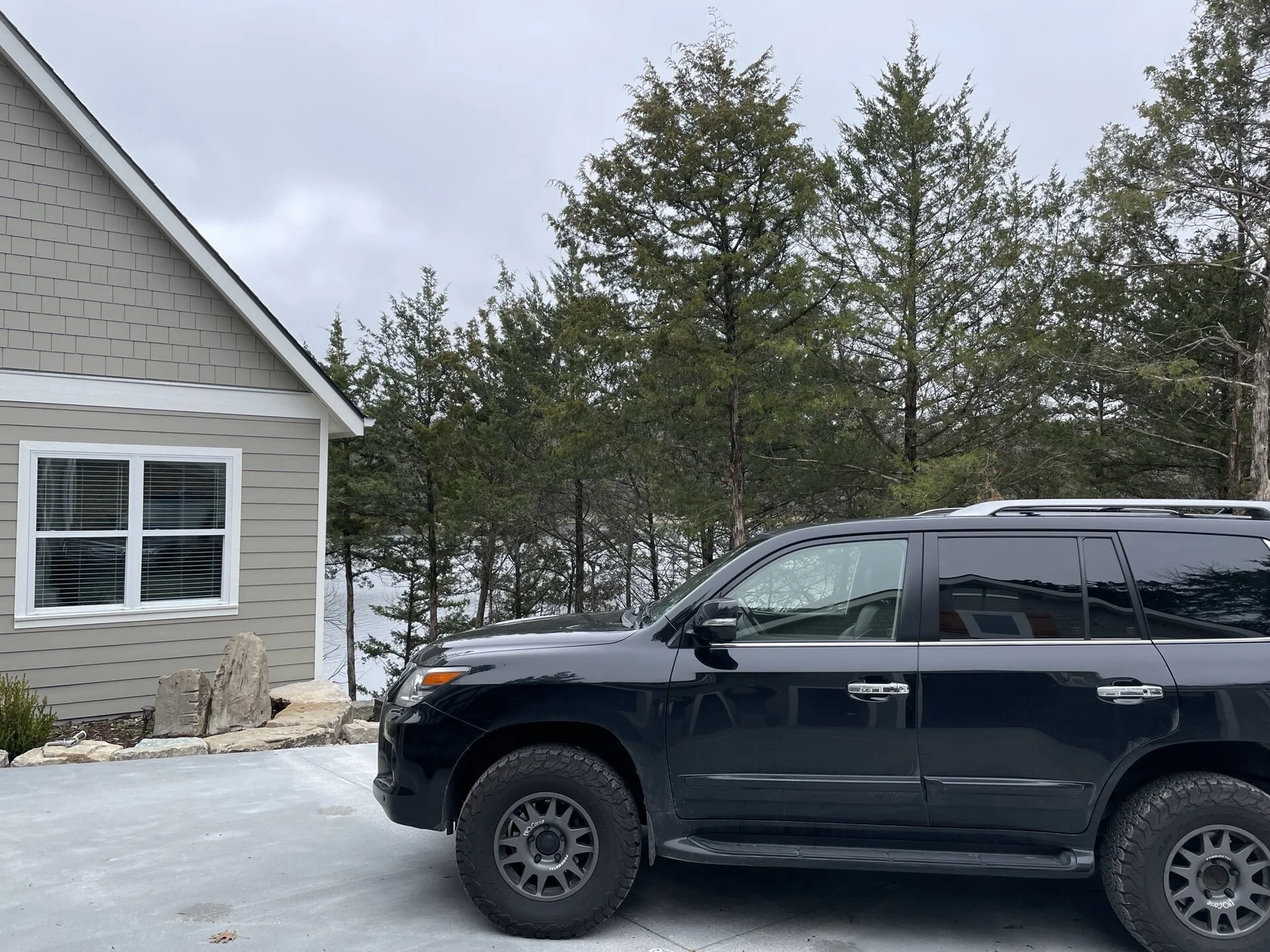

tbisaacs…thank you so much for the pic and for jumping in! I needed a little encouragement😎
What year is your LX? Looks great!
I would be having Adventure Motors here in Kansas City professionally install. ARB Deluxe part number 3425150 (2012-2015) 200 Series Land Cruiser. They are very good at it…and I am…well..not so much!😊
Any words of caution/advice? Things you might do differently etc if you had to do it again?

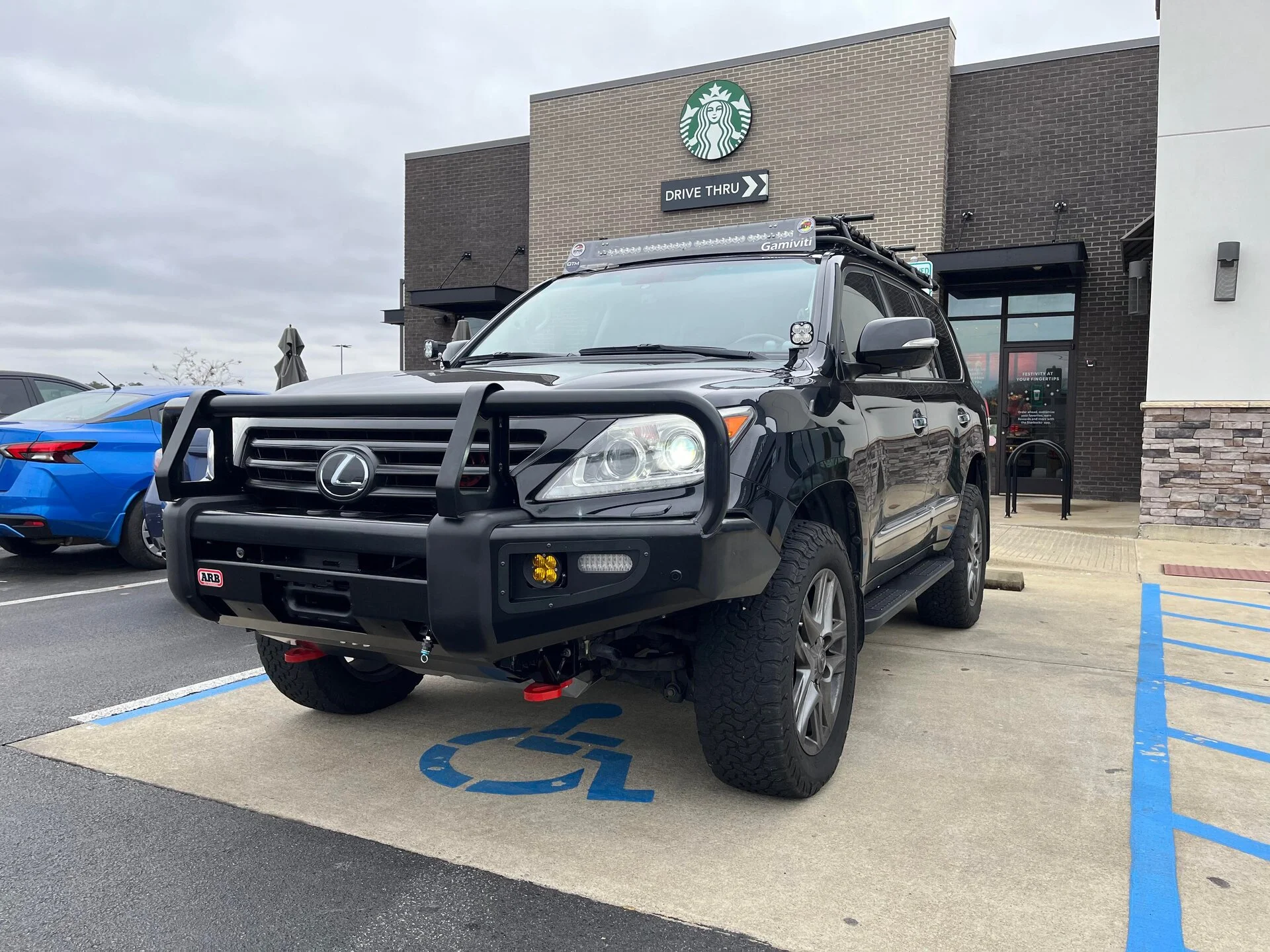

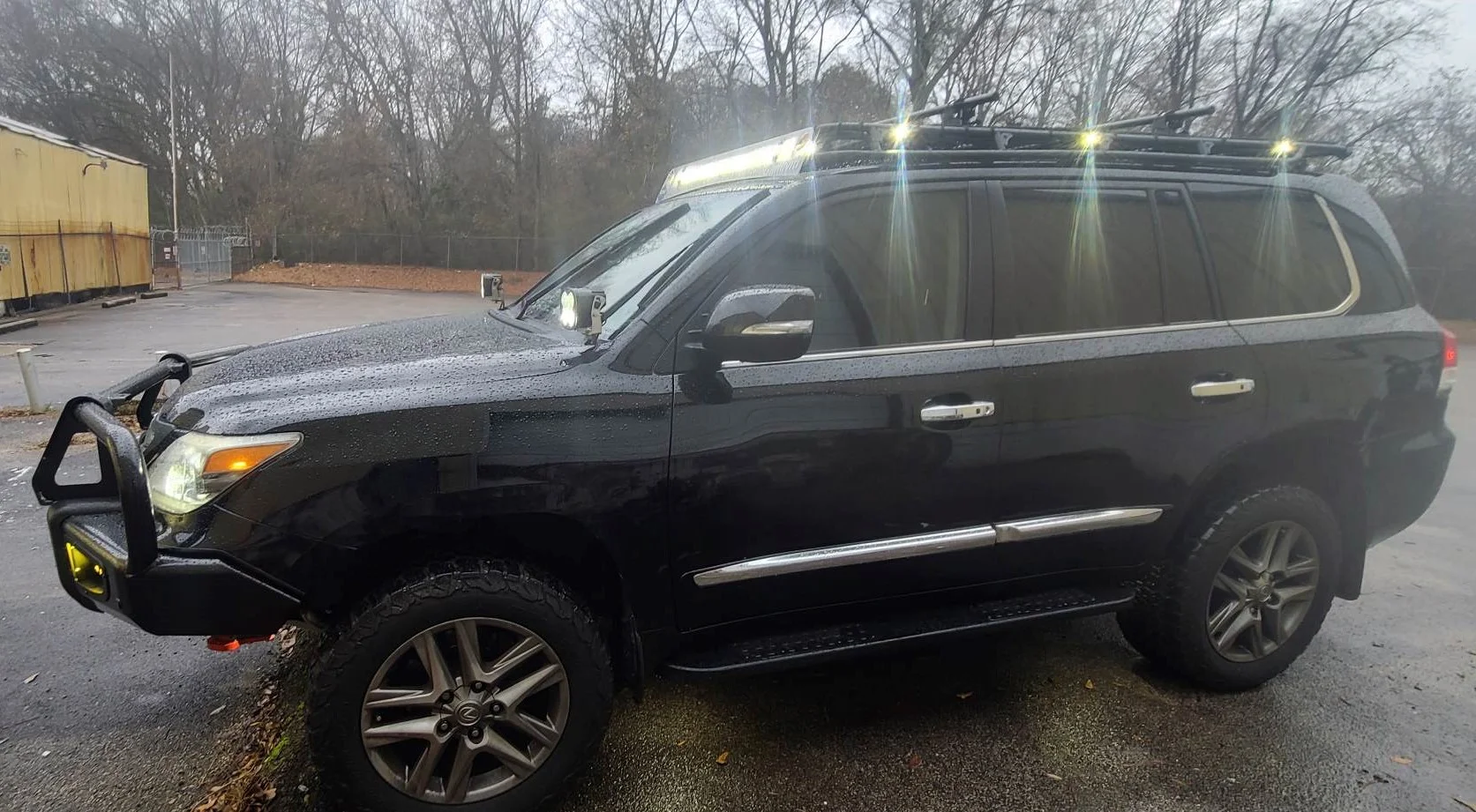

as it sits now
Looks like yours is the Ironman Brand…model?
Ironman classic

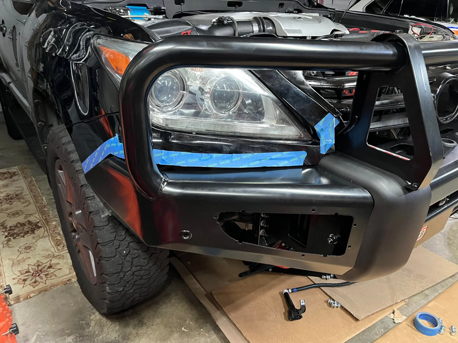

I just finished my bumper install. Started it a few weeks ago. Did it mostly by myself. I went really slow on trimming the bumper. I am now trying to figure out the wiring of the ARB LED turn signals. the LX570 wires are different than the LC 200 wire diagrams, so I have been playing with the wires trying to find the correct connections. Hopefully I figure the lights out tomorrow. : )
I just finished my bumper install. Started it a few weeks ago. Did it mostly by myself. I went really slow on trimming the bumper. I am now trying to figure out the wiring of the ARB LED turn signals. the LX570 wires are different than the LC 200 wire diagrams, so I have been playing with the wires trying to find the correct connections. Hopefully I figure the lights out tomorrow. : )View attachment 3206104View attachment 3206106View attachment 3206107
Your trim looks professional! Well done.

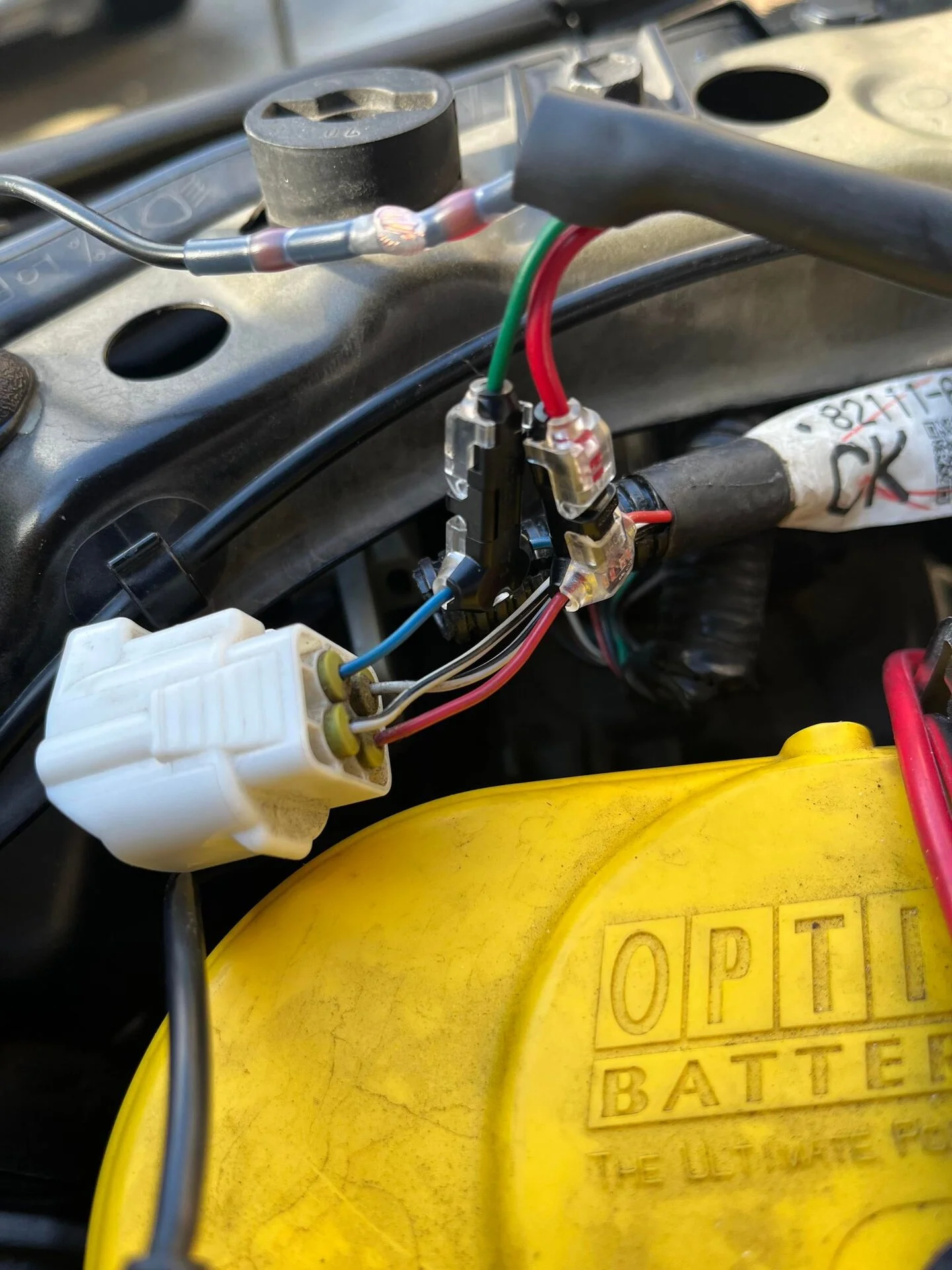

So... My biggest fear with the full bar... the cuts on fenders. There is NOTHING on the internet about cutting up a 2013 - 2015 LX570 bumper, maybe a few pics here and there that I could study, but no one had any real details. Google struck out. So i took a bunch of pics during the install. I pulled that bumper off and put it back on probably 15 times. Measuring, taping, cutting, measuring, taping, cutting... it took a week to make the cuts. Then I had to deal with the grill. The grill I ended up butchering, but you cant really tell. I had to cut the bottom off the grill and a good bit of the sides just to clear the bars.

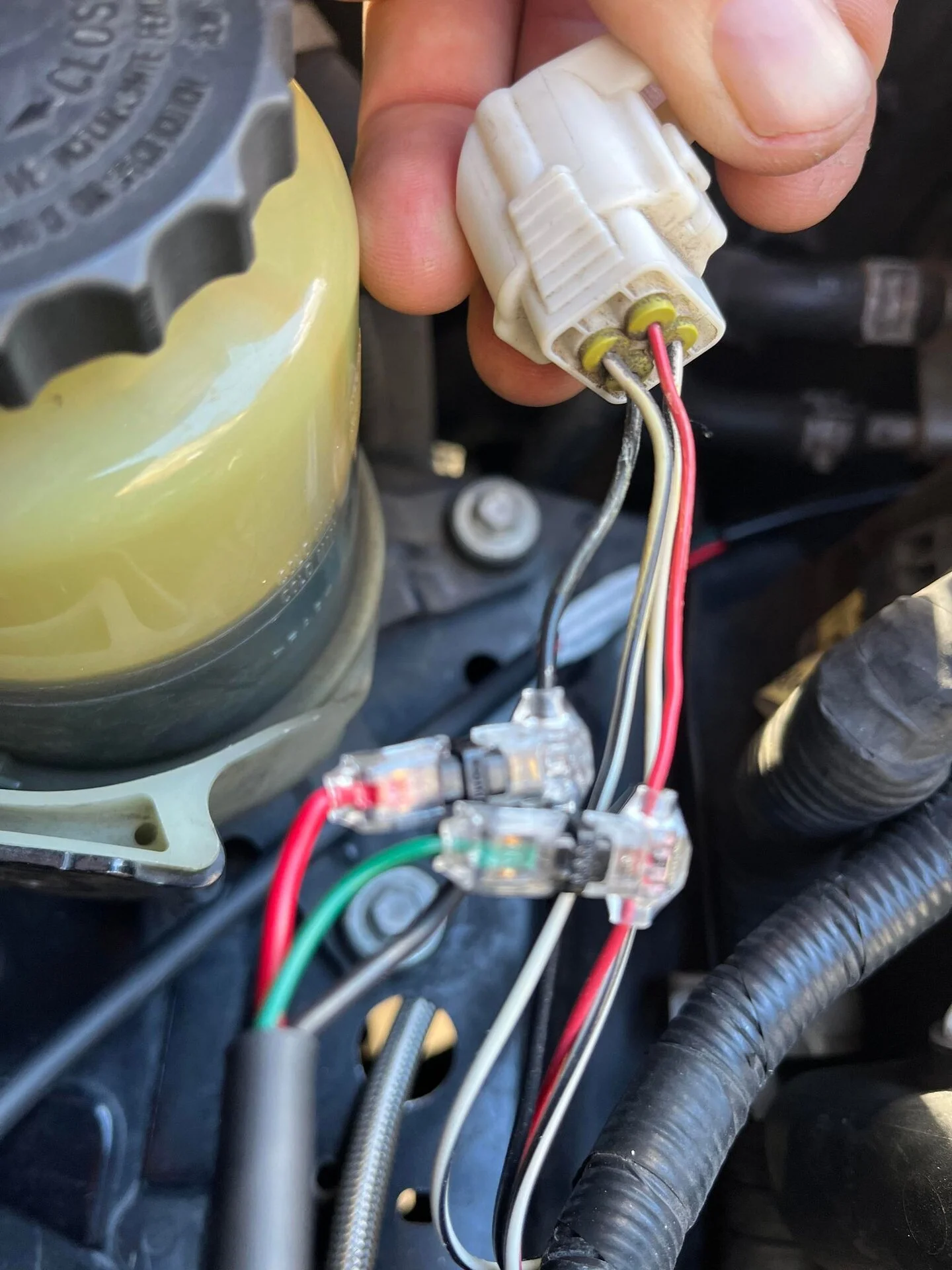

The lighting was not hard, but again, nothing on the internet to reference. I used the power looms for the blinkers, which also have the low beams... That was fun figuring out too, because if you look at the pics. the wires are not the same colors on the driver or passenger side. But the running lights work when you turn on the low beams and the blinkers work now and it looks really good. I am happy to help with my notes if anyone with a 2013 - 2015 wants to do this ARB bumper install.
The lighting was not hard, but again, nothing on the internet to reference. I used the power looms for the blinkers, which also have the low beams... That was fun figuring out too, because if you look at the pics. the wires are not the same colors on the driver or passenger side. But the running lights work when you turn on the low beams and the blinkers work now and it looks really good. I am happy to help with my notes if anyone with a 2013 - 2015 wants to do this ARB bumper install.View attachment 3209801View attachment 3209802View attachment 3209803View attachment 3209804
What connectors are those?

The main challenge is the LX nose/light protrusion is 1 to 2” longer from the frame horns. Oh and the light/grill crossmember is 1” lower. As long as you can work around these two things you’re pretty golden.
