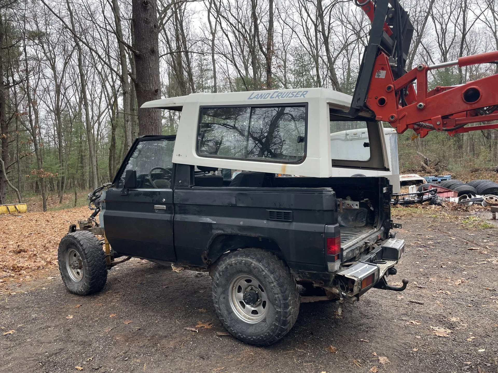

Here it is at Joe’s place

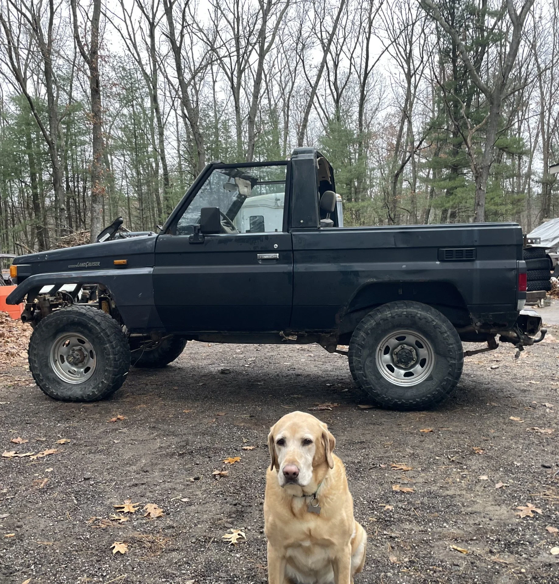

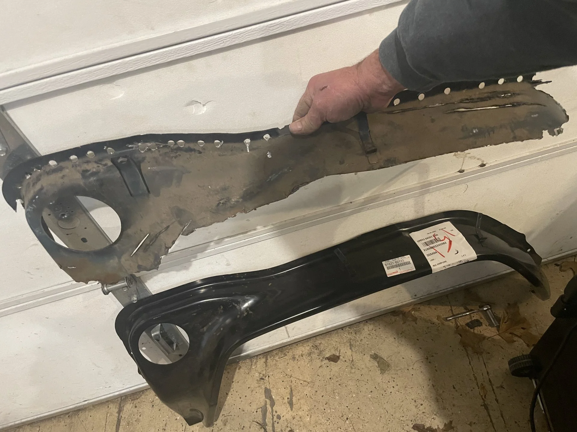

It needs quarter panels badly as well as an inner wheel house on the right side and patching on the left. The rest other than the windshield frame is solid. Here’s pics of pulling the body off. I set a fender on to see what it would look like roof-less. Pretty stoked

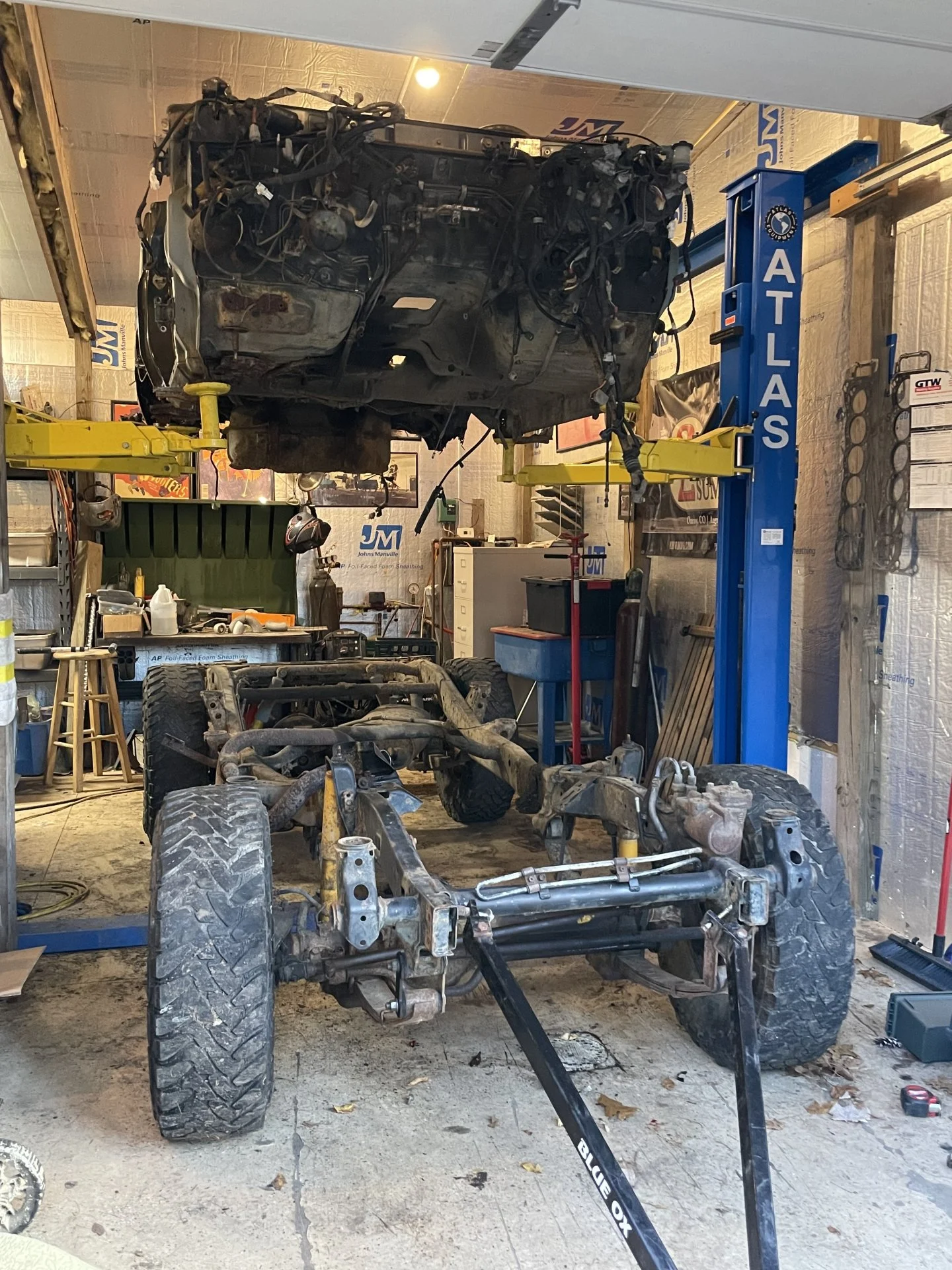

And now the body is off the chassis

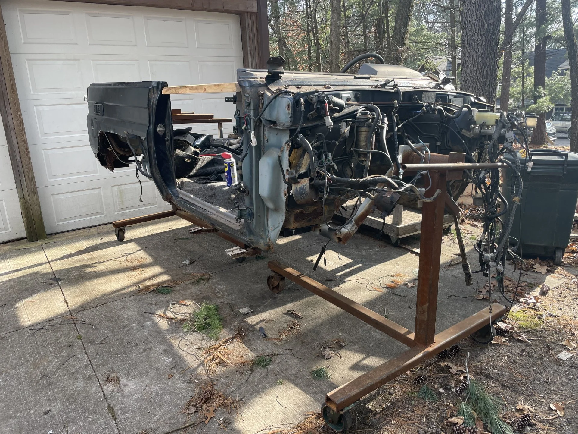

Body on the rotisserie today.

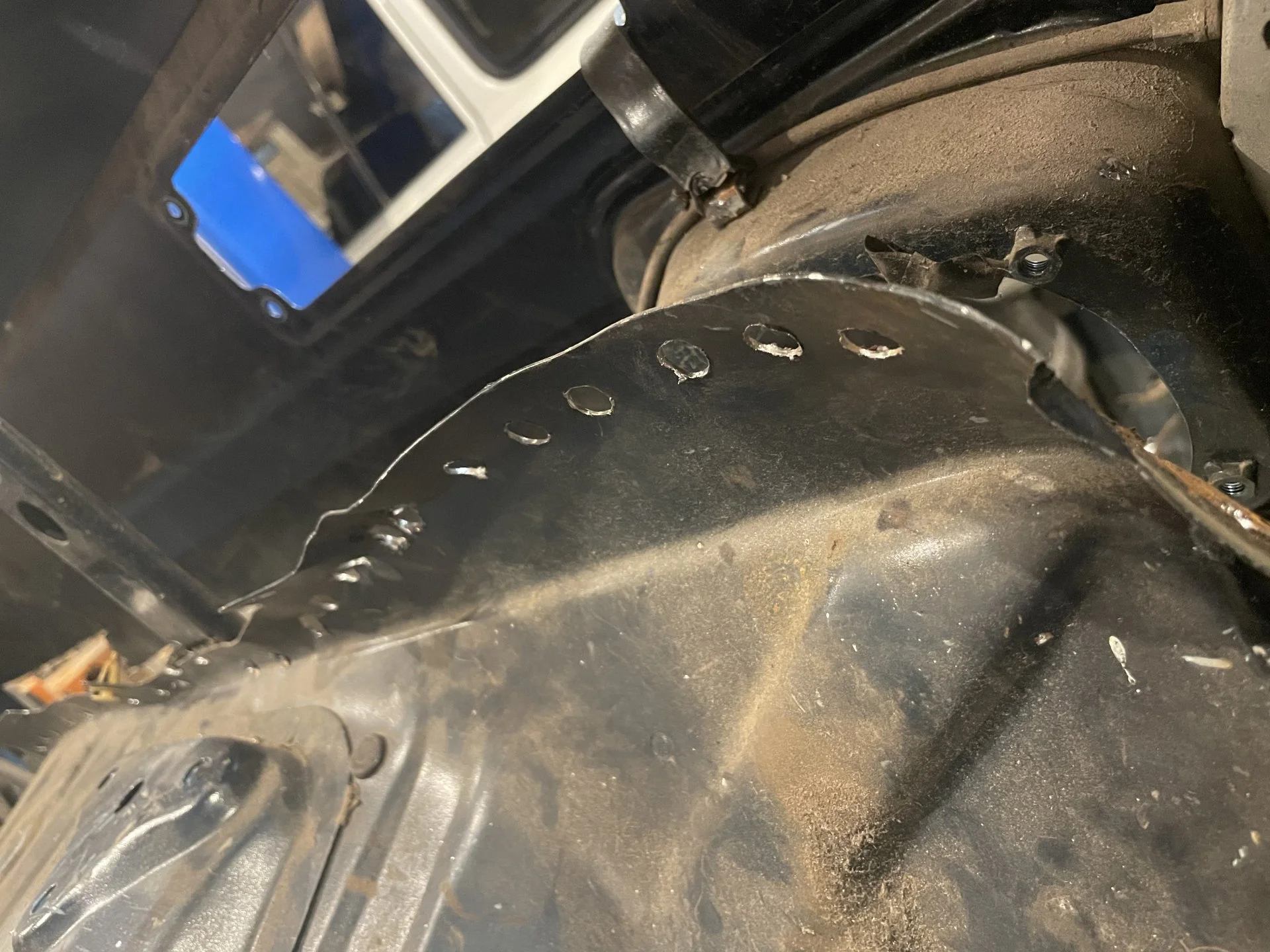

Been too long without getting anything done on this thing. Tonight I drilled spot welds and got the old RH wheelhouse out. New one VERY roughed in
