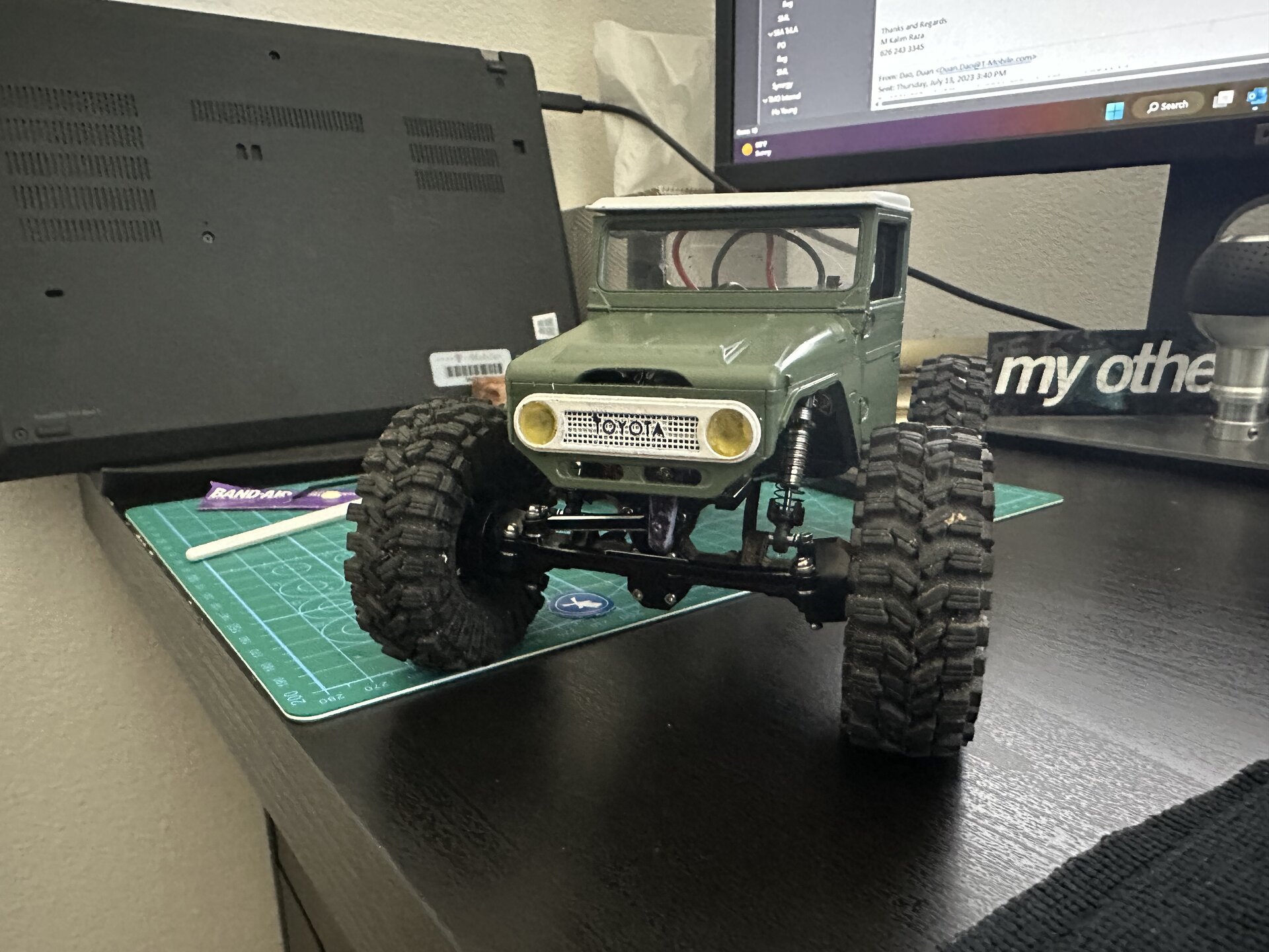

I recently picked up a used SCX24 with upgraded motor, servo and beadlock wheels.
Didn't take long for me to get the mod itch and installed:
- Hot Racing high clearance links
- Hot Racing 49mm oil filled shocks
- Hot Racing steering linkages
- Aluminum servo tray
- Hobby Park brass kit (diff cover/faux brass disc brakes)
- WTMicro 3D printed FJ45 cab only body, print quality on this body is really detailed.
- Injora LCG carbon chassis
- Injora 050 motor
- stock electronics
Painted the grille and roof white, still deciding on what the main body color will be.
Update. Painted the cab and cut out some acrylic for the front and rear “glass” with hot glue. Have to find some thinner lexan as this acrylic is a touch too thick for my liking.
Have to chrome the headlights buckets, install LED lights and put the lens cover on.
