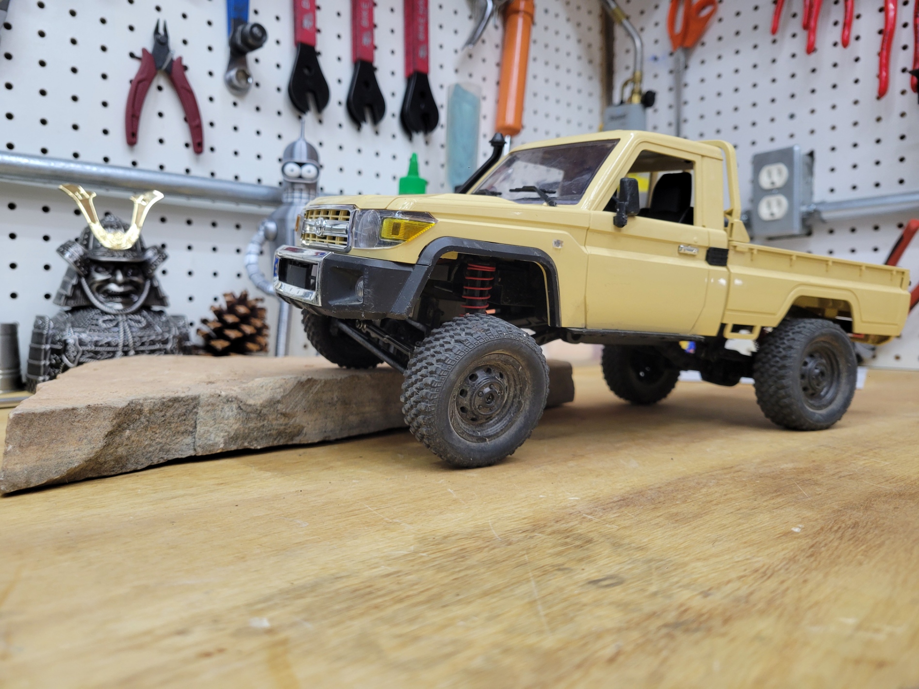

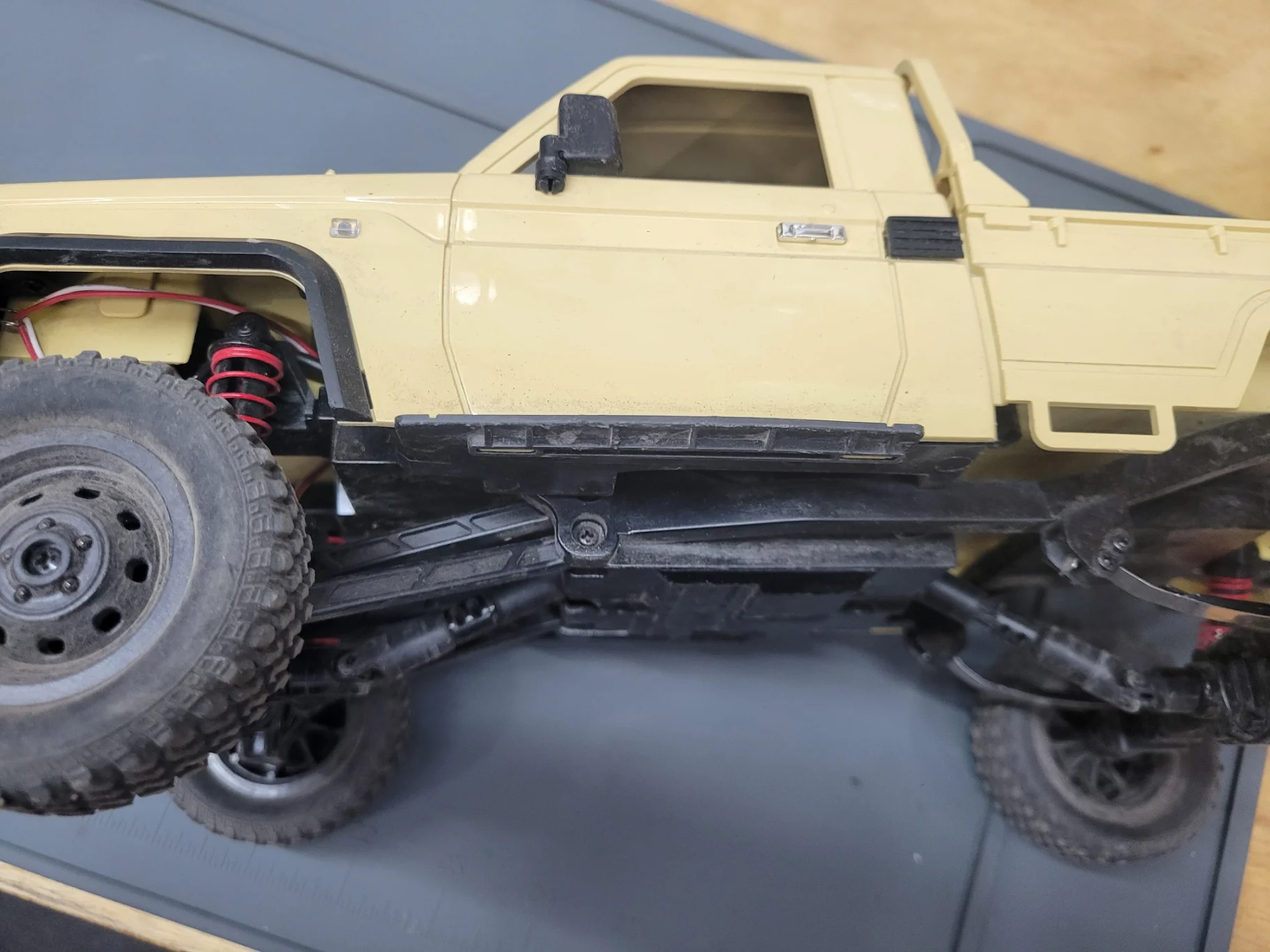

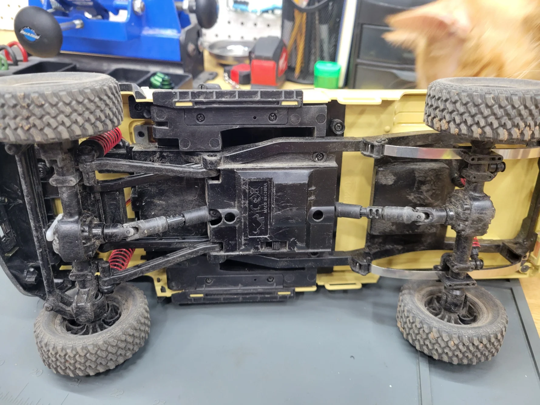

Got a photo of the underside? I've considered buying one of these if I can modify it to crawl fairly well for something that looks more realistic and isn't so much of a buggy.
The only experience I have with RC is building the snot out of a cheap WPL C24 - I think WPL and MN are both owned by the same parent company, so it's similar to this. I'm just wondering if any of the WPL upgrade parts would fit this. Mainly I'm thinking about whether or not the metal knuckle housing and metal suspension & steering links would drop into this truck. Early on those are the things that got wiped out first on my WPL. Plenty of room for extended shock towers, so that's good. Driveshafts appear to be the same, also good. Looks like either the WPL or some DIY shackles could be added to the rear leaf springs for better flex and height. Some of the longer Tamiya leaf springs might fit with a shackle. Same 5mm wheel hubs, so a ton of aftermarket options there (Injora makes some heavy ones for better COG) along with larger and/or grippier tires.

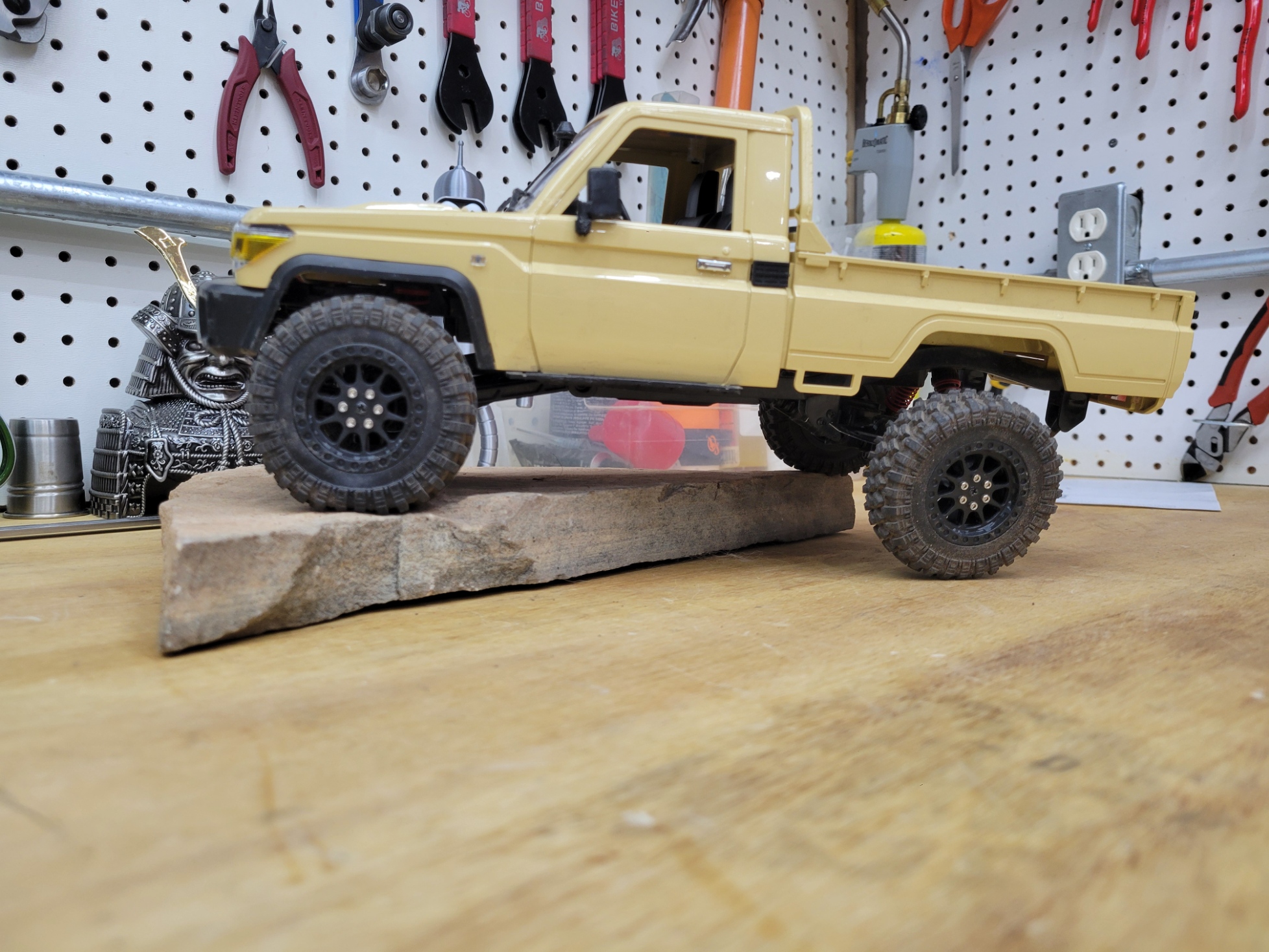

Finally brought some new wheels and tires. These have made a huge difference in useability. The soft rubber makes climbing up stuff easier and better ground clearance. The stock 59mm tires were nice for dirt. The new ones are 68mm. Now, I guess I'll need to splurge on some oil shocks. To calm the bouncy ness down a bit.
Looks so good!
FWIW, on my WPL I went to Injora wheels and tires. I think they’d fit on this with some hex adapters for the axle ends - Injora had those too. That widens your choices quite a bit.
