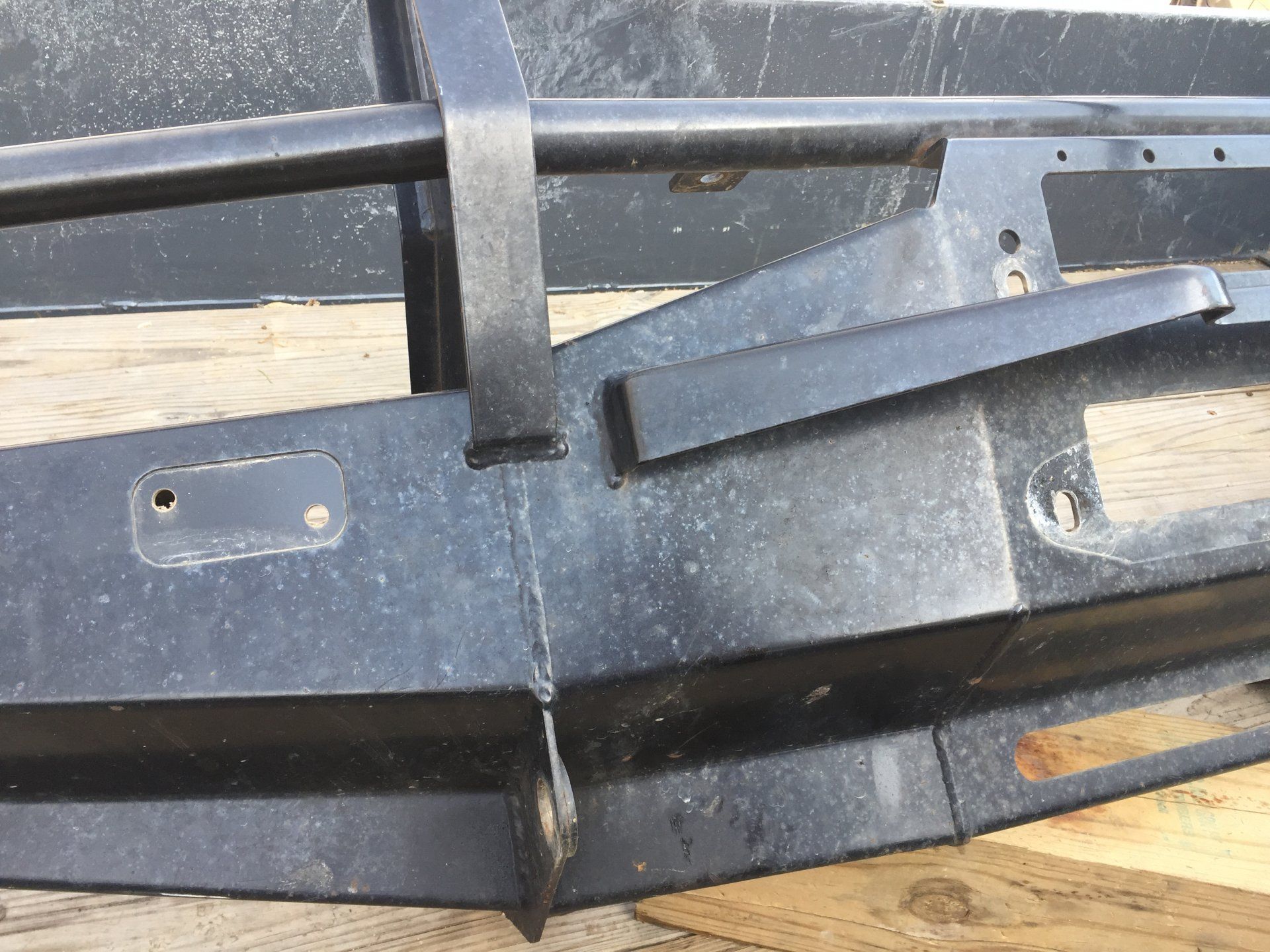

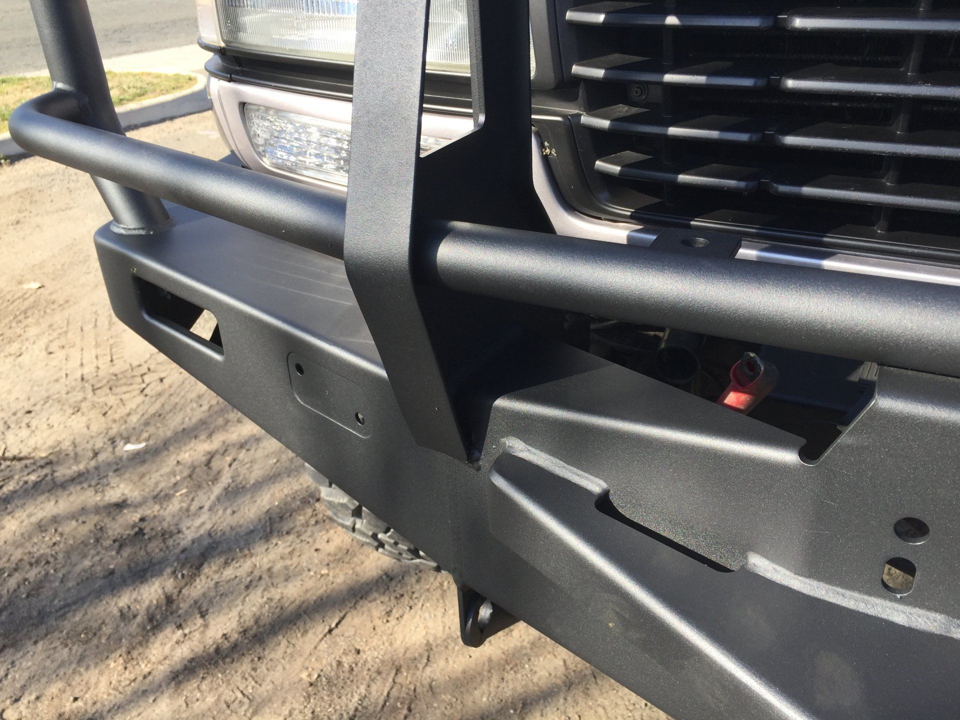

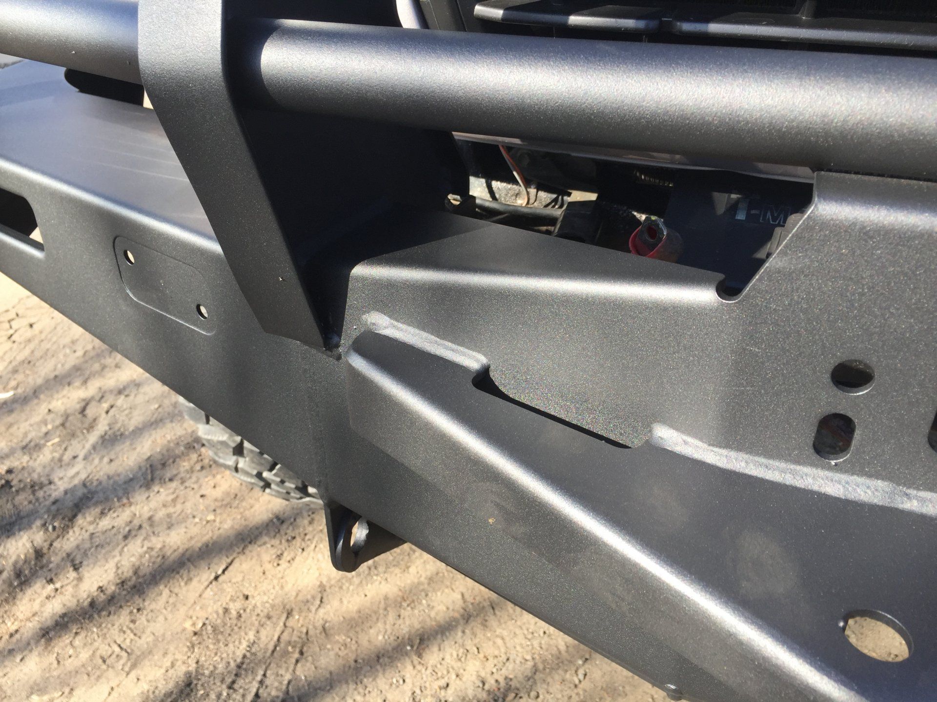

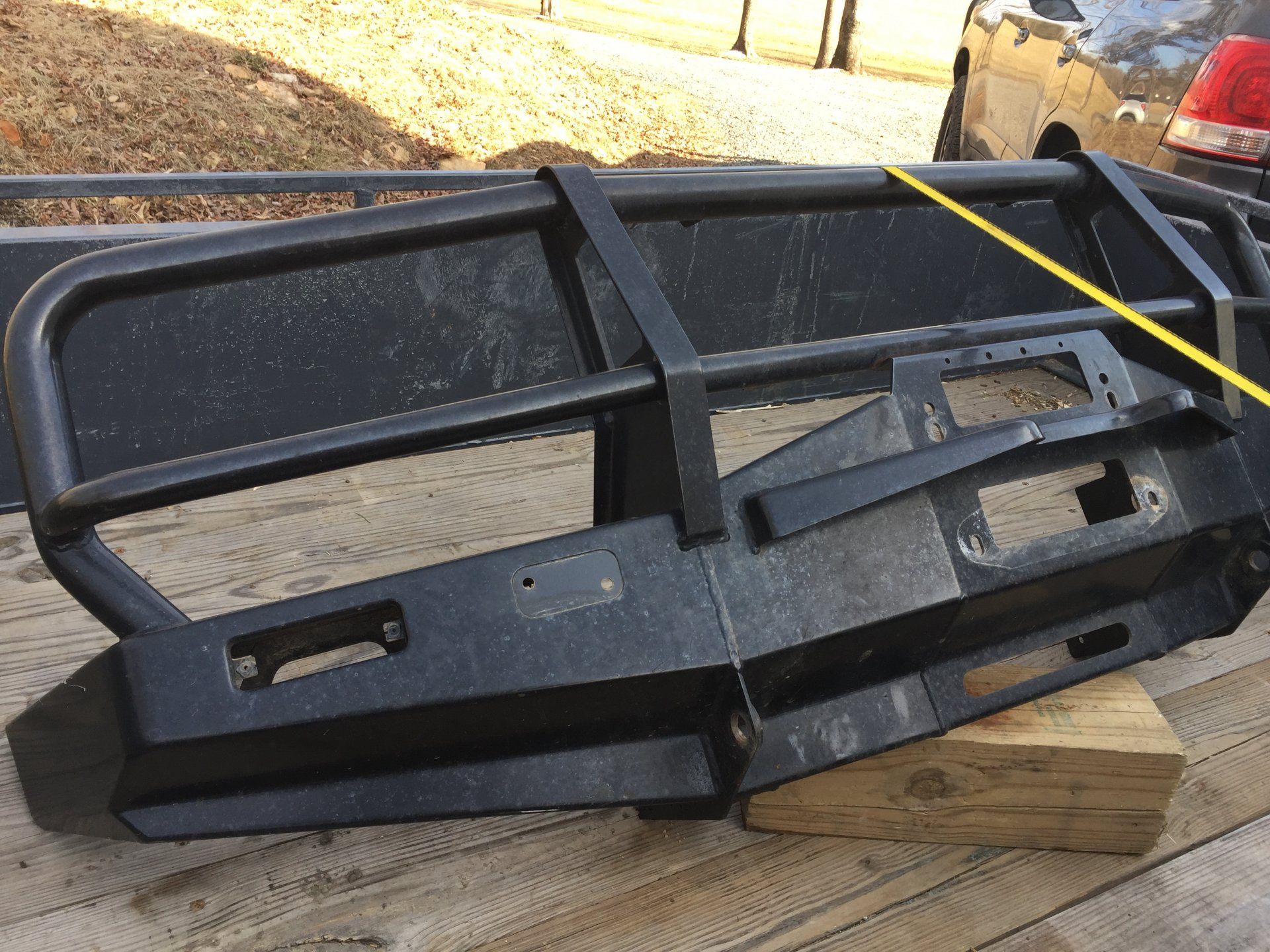

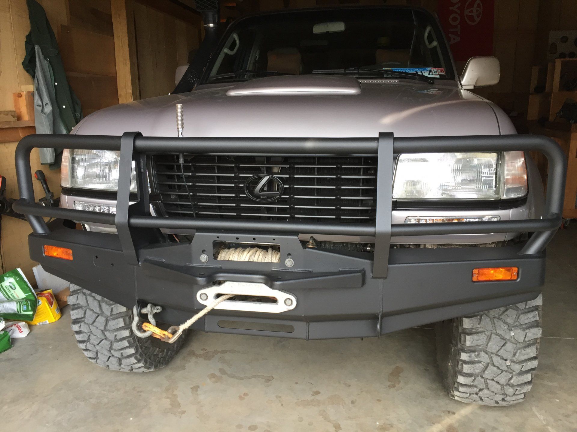

As they all eventually do, my ARB’s powder coat was showing its age and I didn’t have the heart to reinstall it after cleaning up the hood/fenders

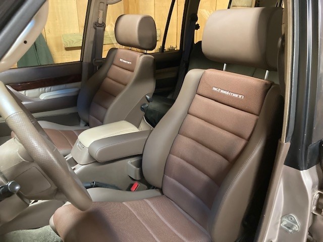

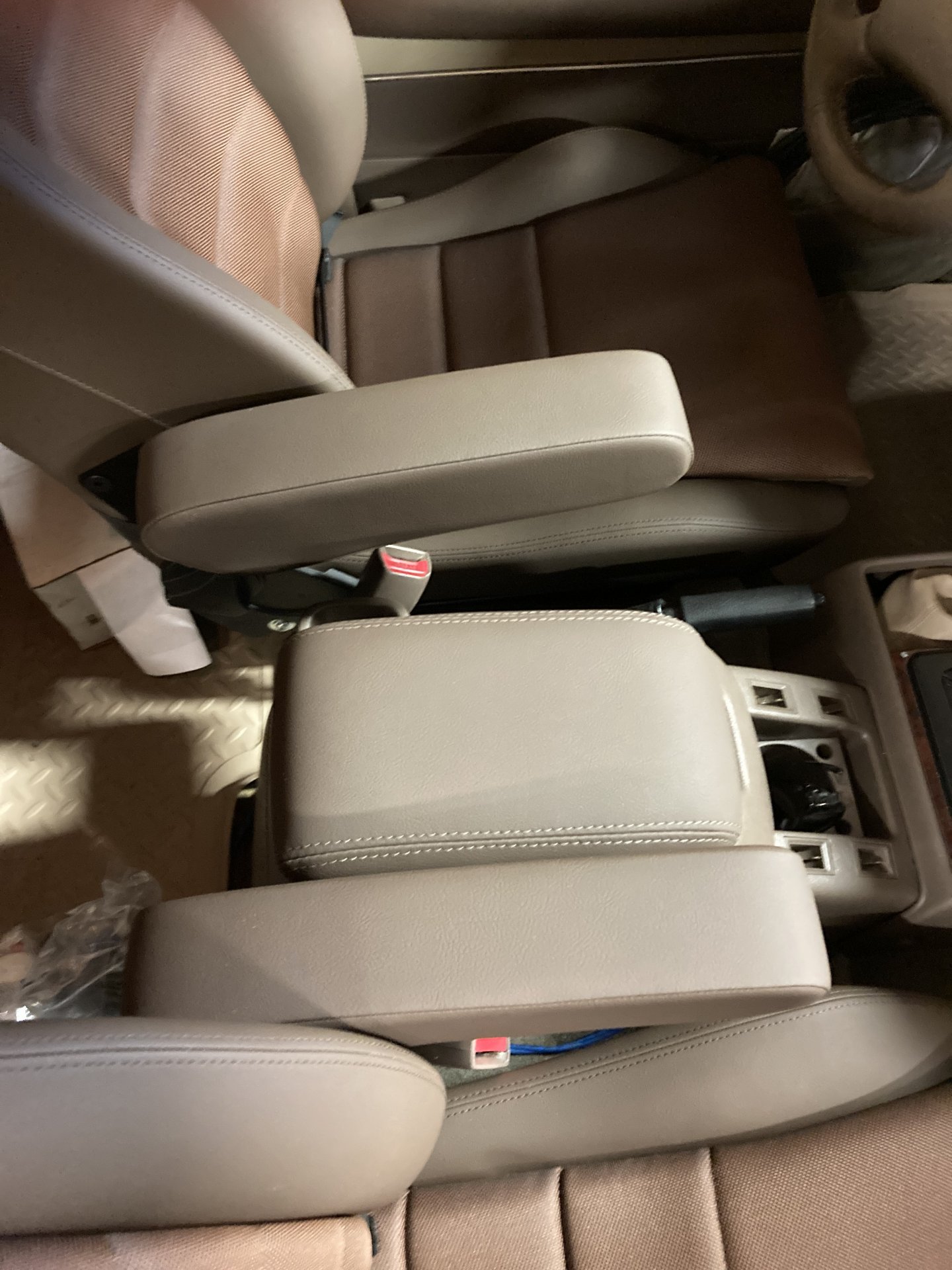

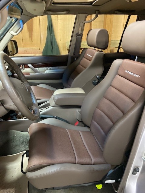

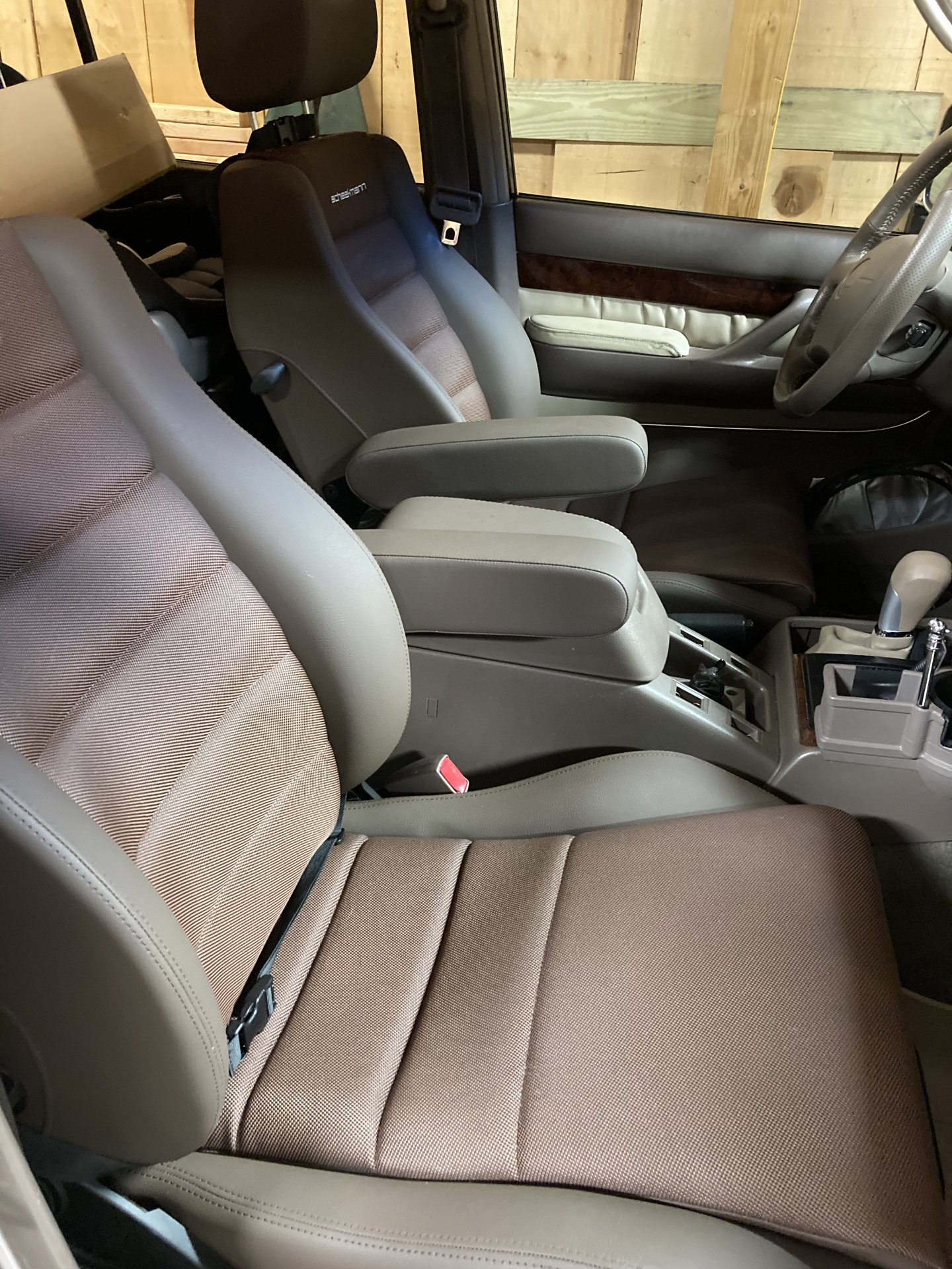

Next up was the seats. I would never say the Corbeau's were bad, but there are some small things I believe could have been done better. They served their purpose for several years and a very cost-effective solution to a tired 80 series seat that needs replacement.
I ended up with a pair of Vario F seats, with heaters and driver's armrest.
Assembly is fairly well documented here on Mud, so not a whole lot to share. It's pretty straight forward. Digging for the armrest mounting holes can be a little unnerving but it all worked out.
Toby was great to work with and sent me a ton of leather samples, as I debated doing full leather. After much debated, ended up sticking with the standard brown leatherette with cloth and the planted seat brackets.
