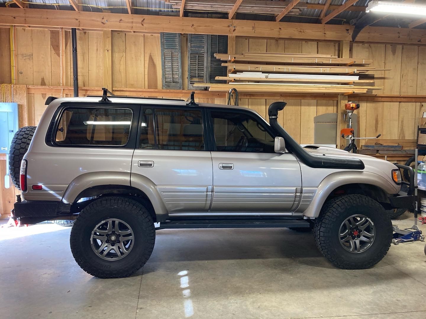

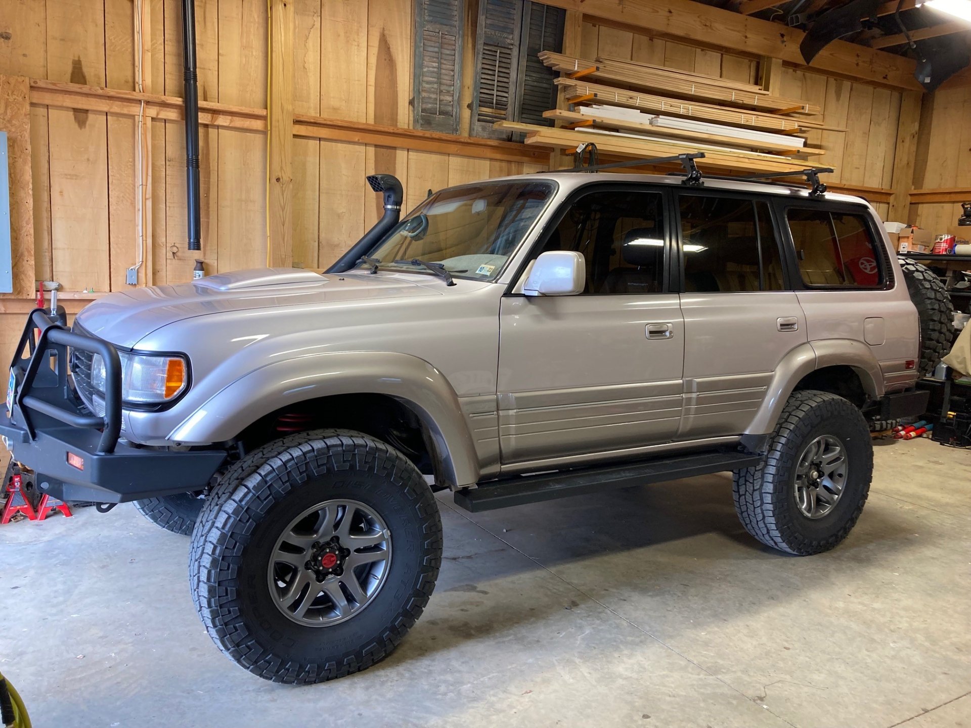

In an effort to preserve the STT's, I picked up a worn out set of Sequoia wheels, had them powder coated "argento" and had @OTRAMM mount some 37x12.5 Cooper Discoverer AT3's.
The MT's really ride great for what they are, but the AT's are crazy smooth and quiet. I commute 2-3 days/week (100 miles) in the truck so having this second set was justifiable...kinda.
note: the black steelies are FJCruiser wheels so using Sequoia wheels allowed me to keep my 1.25" trail gear wheel spacers for either set of wheels/tires.

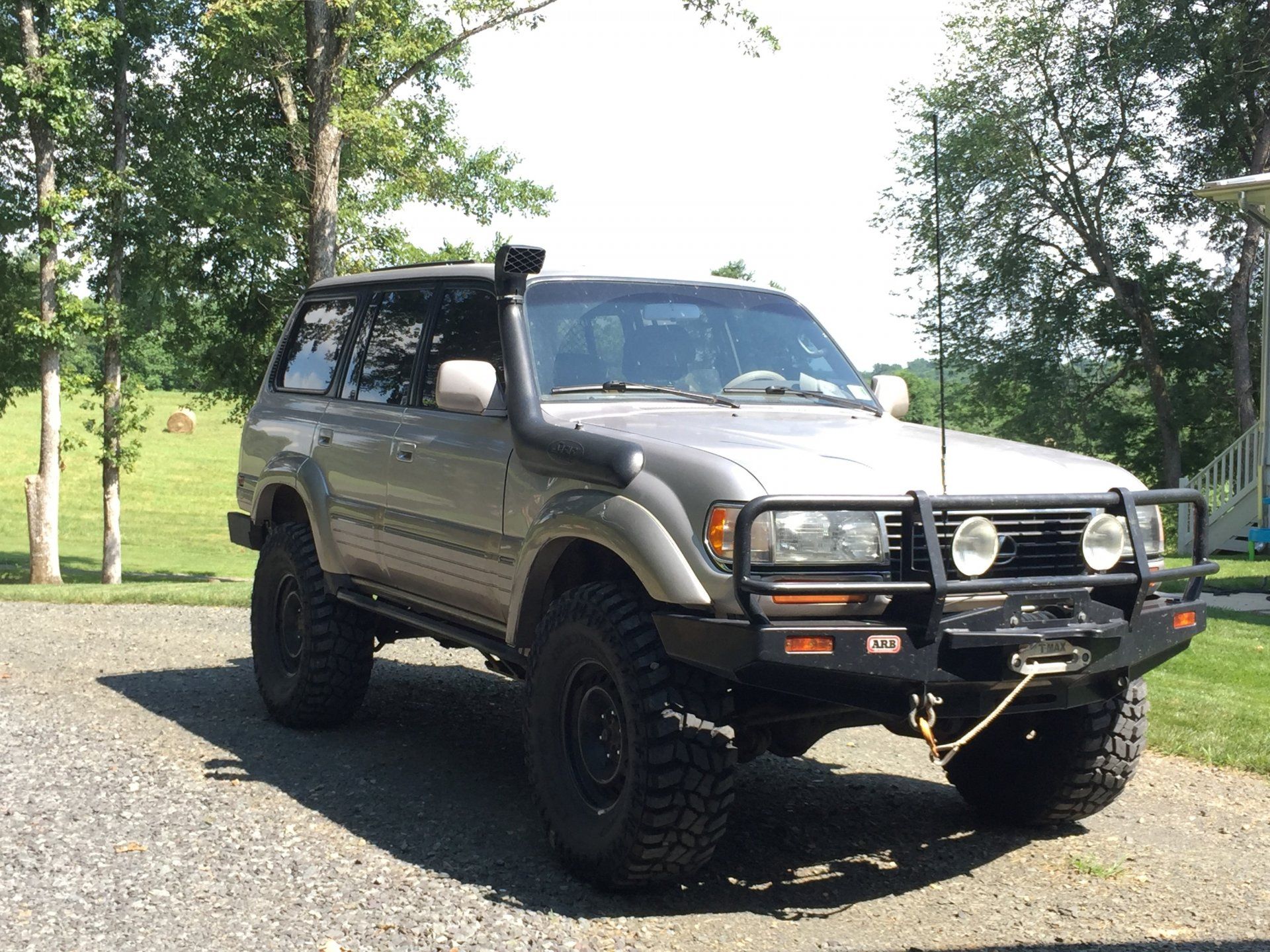

Not to be rude, but I'm curious as to why you mounted your hood scoop "backwards"?
No offense taken. This scoop is used by several folks here and both orientations have been used. I opted for backwards to reduce the amount of rainwater getting in and b/c the airflow seems to work well flowing from the radiator and out of the scoop at higher speeds.

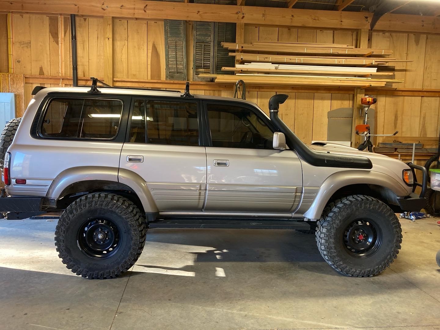

Setup shown is same OME J's all around, 1" Body lift, full armor, 17" FJC steelies and 1.5" wheel spacers.
Sadly, I've had this setup for about one year and not been able to truly wheel it. All test flexing shows little to no rub, but hopefully we can truly test it soon. Truck was down from May-October '20 (more to come on that) so didn't get to do any wheeling.

Quick question - What size are your wheel spacers? I see 1.5” and 1.25” mentioned in your thread.
Love your truck with the 37s! They just look like they’re supposed to fit an 80 series.
Good catch. they are 1.25". i need to go fix that typo.
