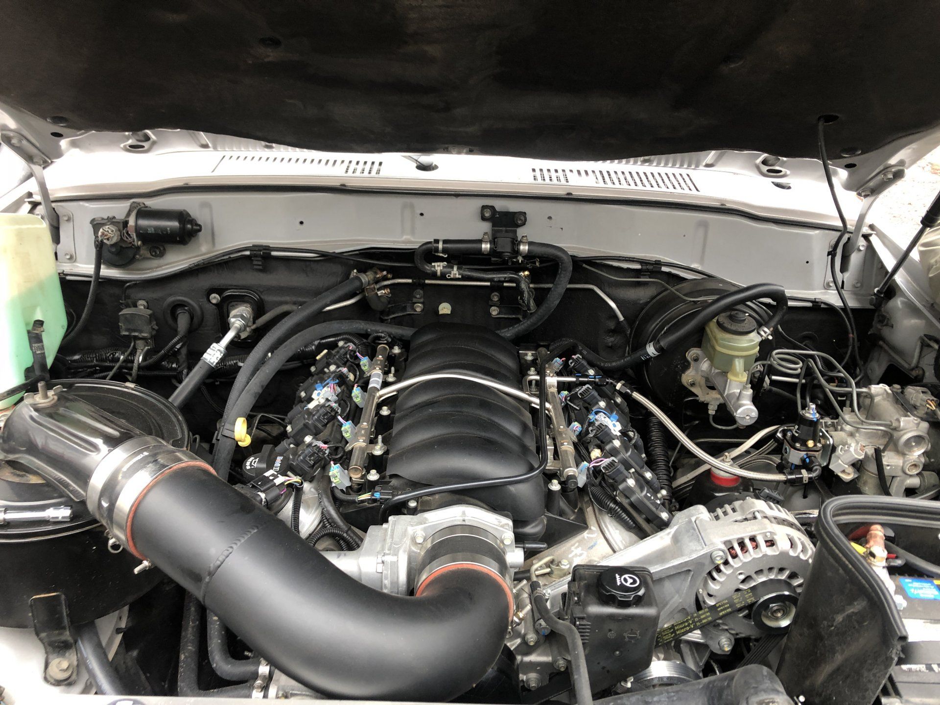

Haha. Most might be disappointed at how easy I am on the motor. It's amazing how little effort is needed to push an 80 on 37's to 80mph. I rarely see anything north of 3500 rpm's and it moves effortlessly. The 1FZ is great, but i do not think about it and the power curve of the 6.2L is very different than the turbo.
All in all, it's running great. I've clocked 3500 miles and drive it 3x a week. I had to do a crank relearn procedure one-time due to a check engine light but that's it. Only big question mark at this point will be to see how it does in summer heat with AC cranking. That's the final test for me.
