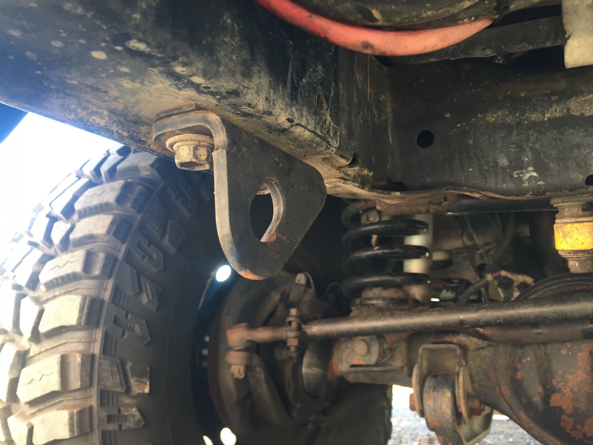

Perhaps I’m behind the times, but had a pair of old 100 or 200 front tow points and realized they work perfectly with the 80 and ARB bumper. Stock 80 recovery points won’t work due to ARB but these are plug and play.
