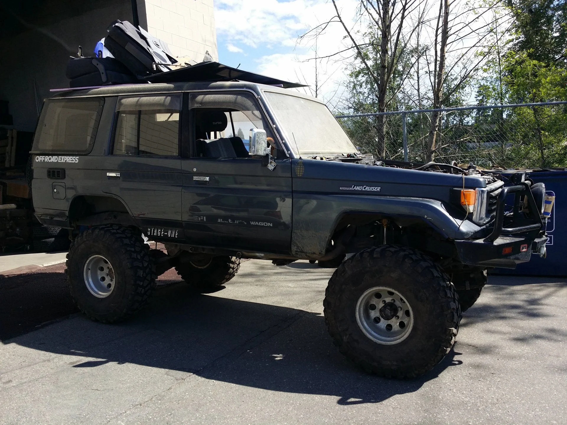

Well a long night in the shop has resulted in the bodies being face swapped over. at least in principal. There's some exhaust holes and a bit of body rust that i'm going to fix before i mate it all up again. in the mean time, the Prado looks a lot more... Prado. and my 77 looks more.. Non-Prado. excellent!
Beautiful... Here is a buddy of mine's. Same same but different. It's doable and awesom!

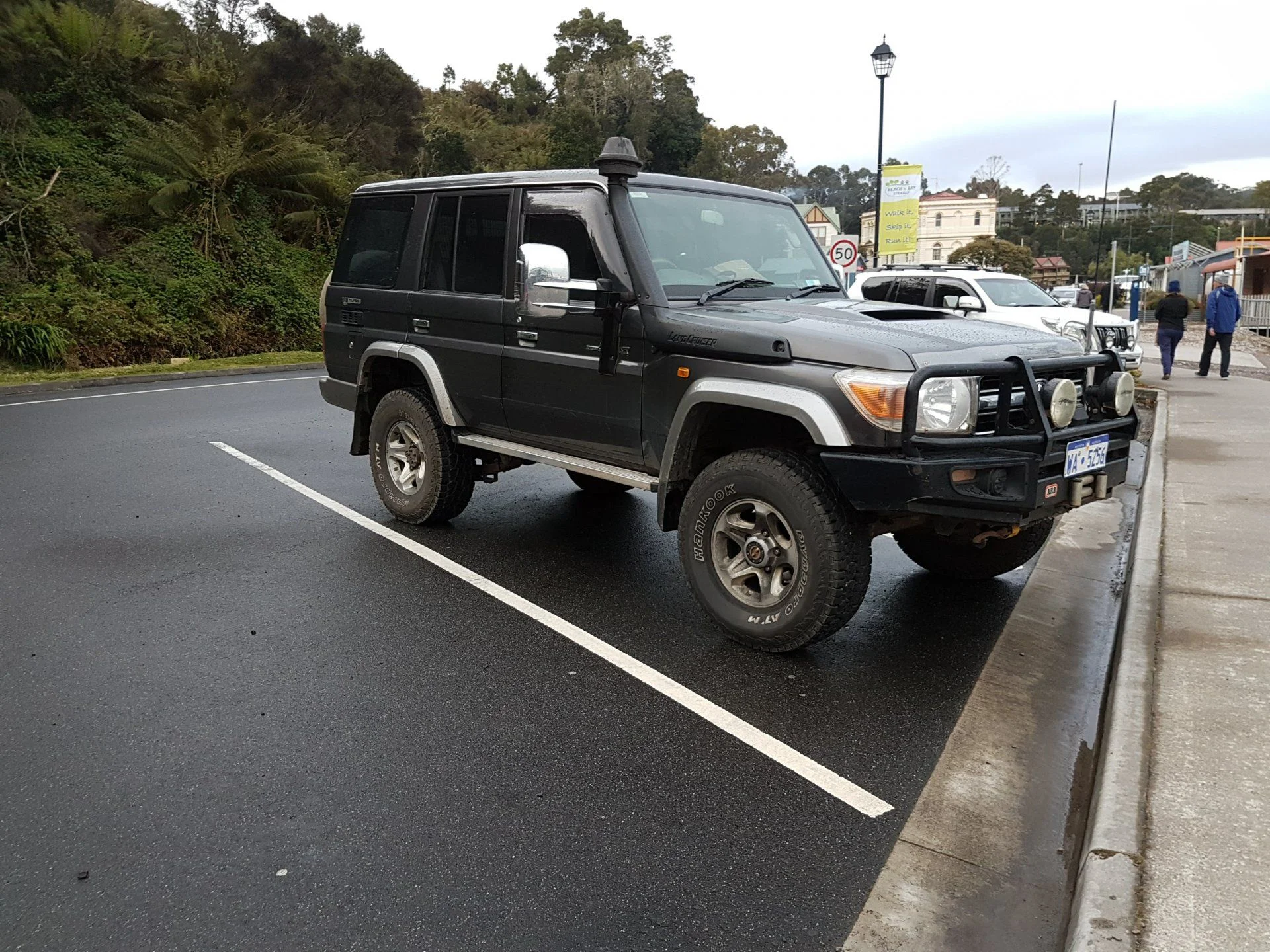

Truck looks good mate that vdj79 wagon is a 4.5L single turbo v8 the 200 series is the 4.5 twin turbo
Truck is looking good.
The truck is a VDJ76, 79 is the ute variants.
As for bumper directions, I cannot find the build thread for the life of me. There was one built in the 70 series section on an HZJ73.
Chris also built one out of the same kit.
That's it vdj76 I couldn't remember that
