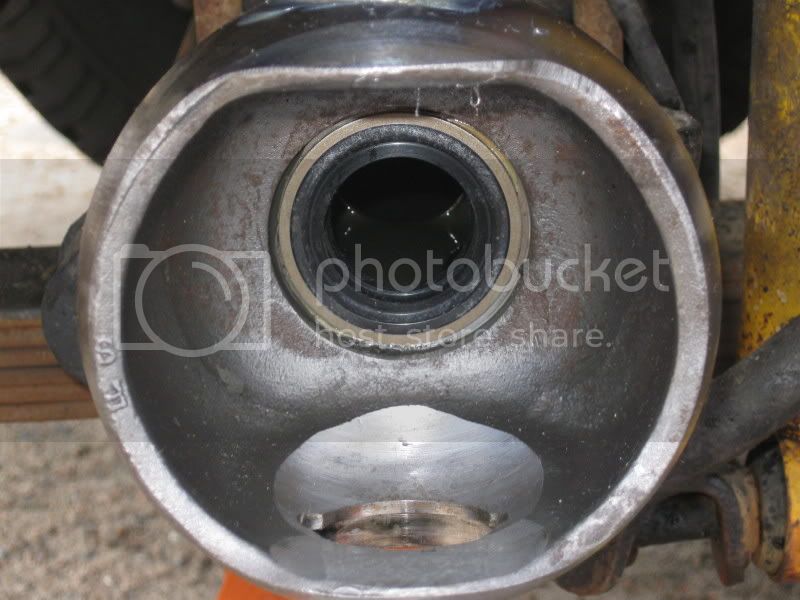

Decided to finally rebuild the knuckles....
Started around 9:00, on my day off. Then got a call from my irate boss - he fired me.
Everything is going well...so far the biggest batch was getting the bearing cap/shim plate off of the knuckle. Broke out the BFS (big fckn' screwdriver) and she popped right off.
I fingured that I'd check the Birf also - what's the size of the snap ring on the outer axle that's inside of the Birf.
I measured with my SAE calipers and came out with .90 " - 22 MM?
It's Friday night at 6:00 - I'm finished up for the night. Probably Vatozone or NAPA? for the snap rings (2) one for each side.
- jake

:flipoff2: Seriously though - what's the size of that snap ring.

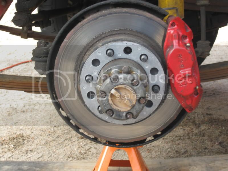

Old. Those red calipers gave me about 10 HP. EACH:flipoff2:

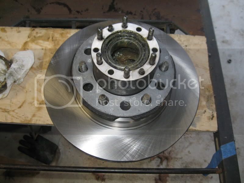

new
I'm hoping she'll stop a little better....
Don't know the size, but the Toyo part # is 90520-28036 & 90520- 27091 (outer)
Maybe they can cross-reference.
I'm not sure anyone is going to know the size of that snap ring. I think but am not certain, that it is the same size as the one on the other end of the axle...that goes thru the spindle. I think I would just take the axle with me to Napa It's prety important for it to be the correct size.
I love horsepower paint!! If you see any blue, with a 25HP rating let me know - I NEED some!!

The snap ring grenaded when I used the BFH to pop off the birf.
