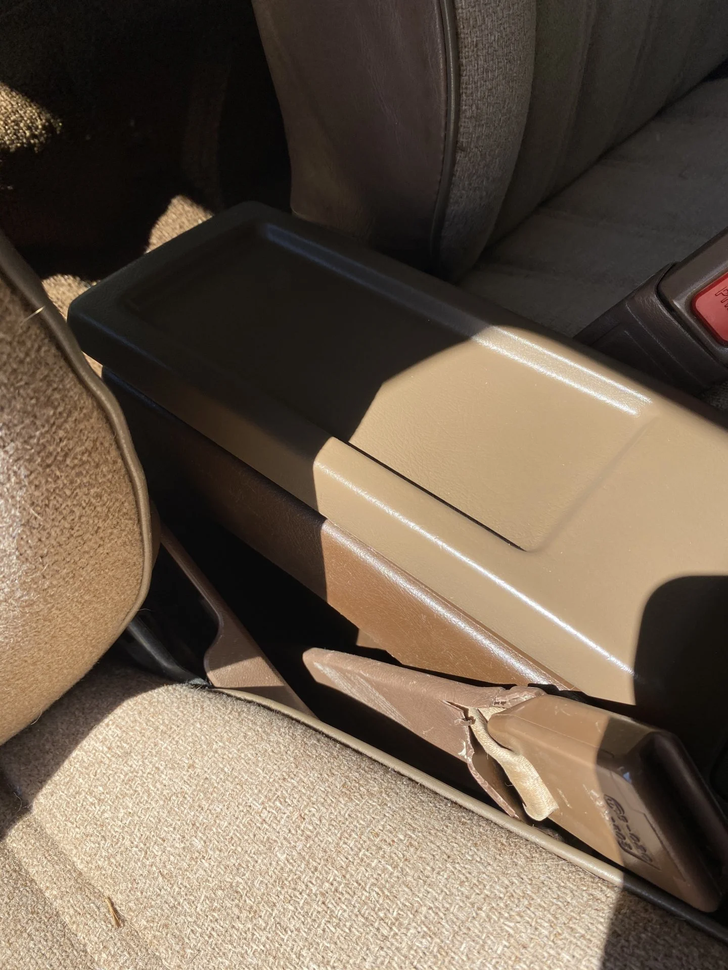

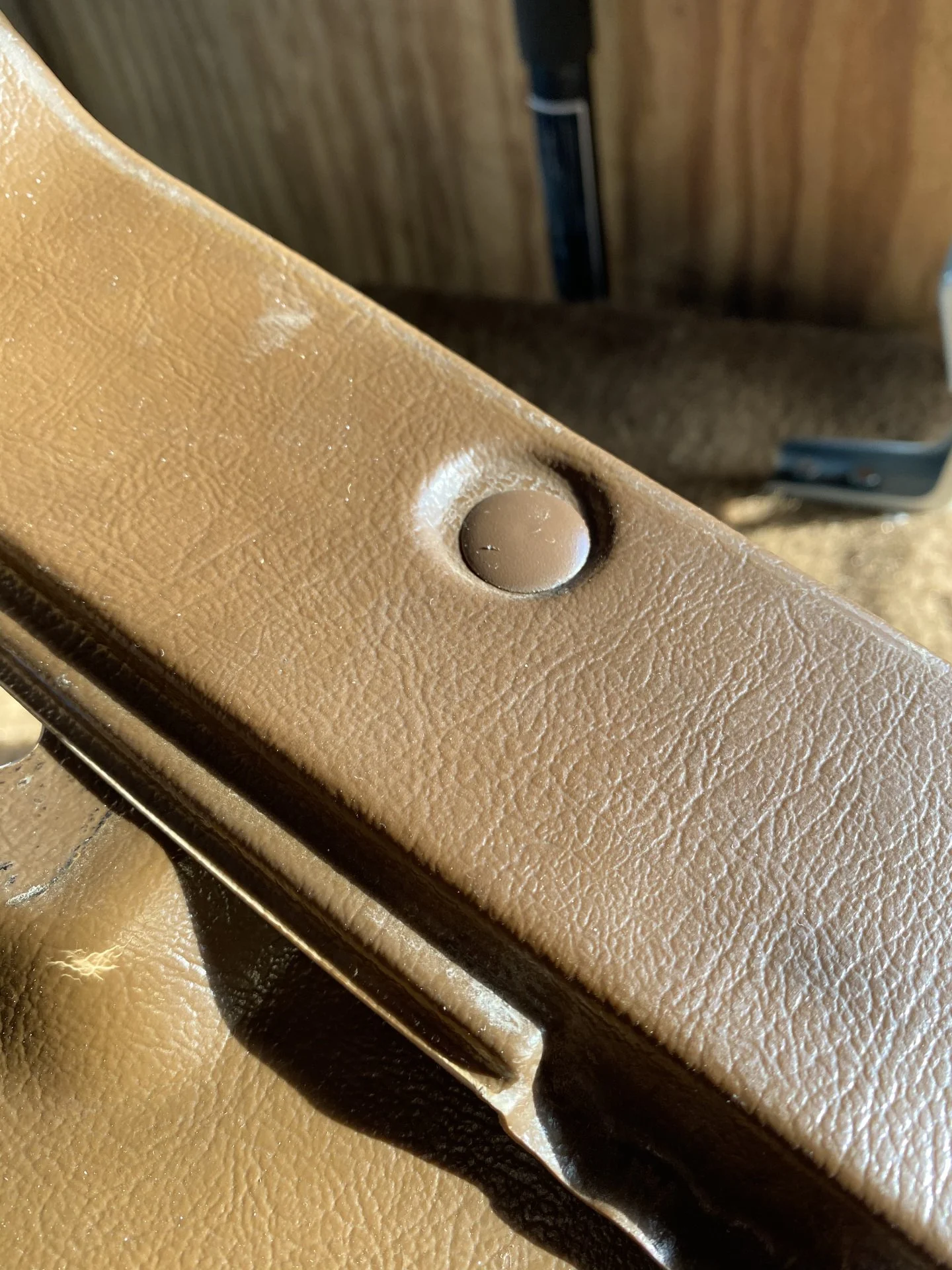

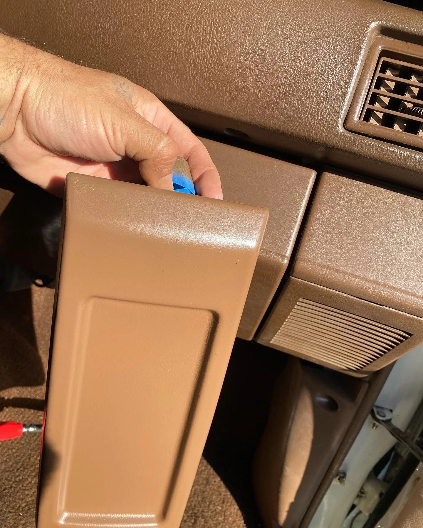

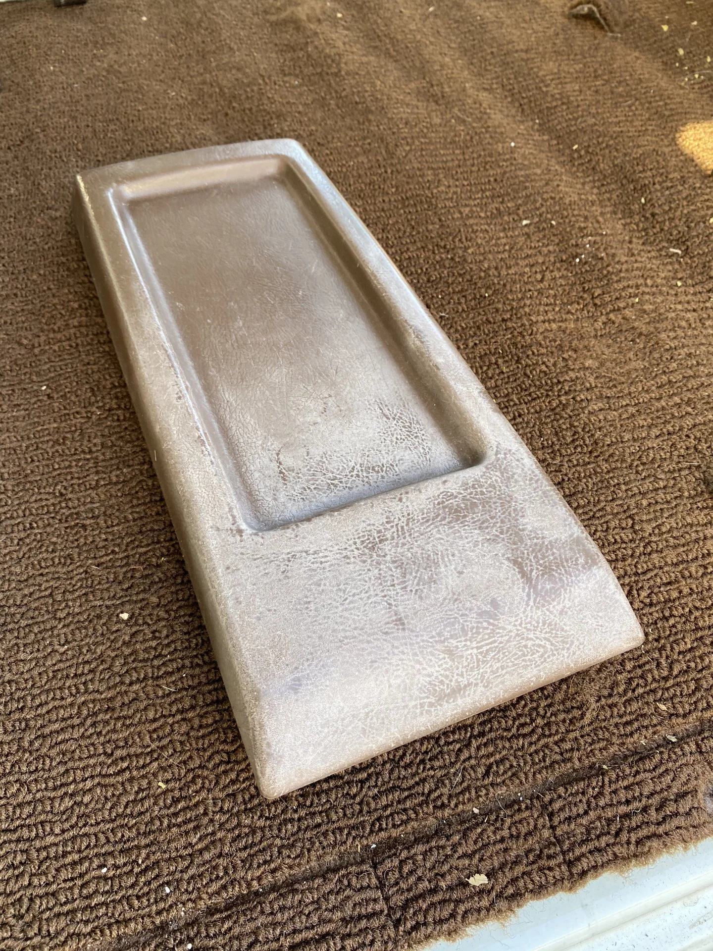

Getting my 1st gen ready for auction so now I’m doing everything I have wanted to do over the last two years. Just painted the center storage area with plastic promoter primer, SEM bluebird brown, and a satin finish. I like the result but not the color so much. Anyone else have suggestions that will match closer?
Turns out I found my answer at the local paint wizard den. He added red oxide vinyl pigment and a touch of black pigment.
The clips and center console cover are the only pieces painted. The others are for reference.
