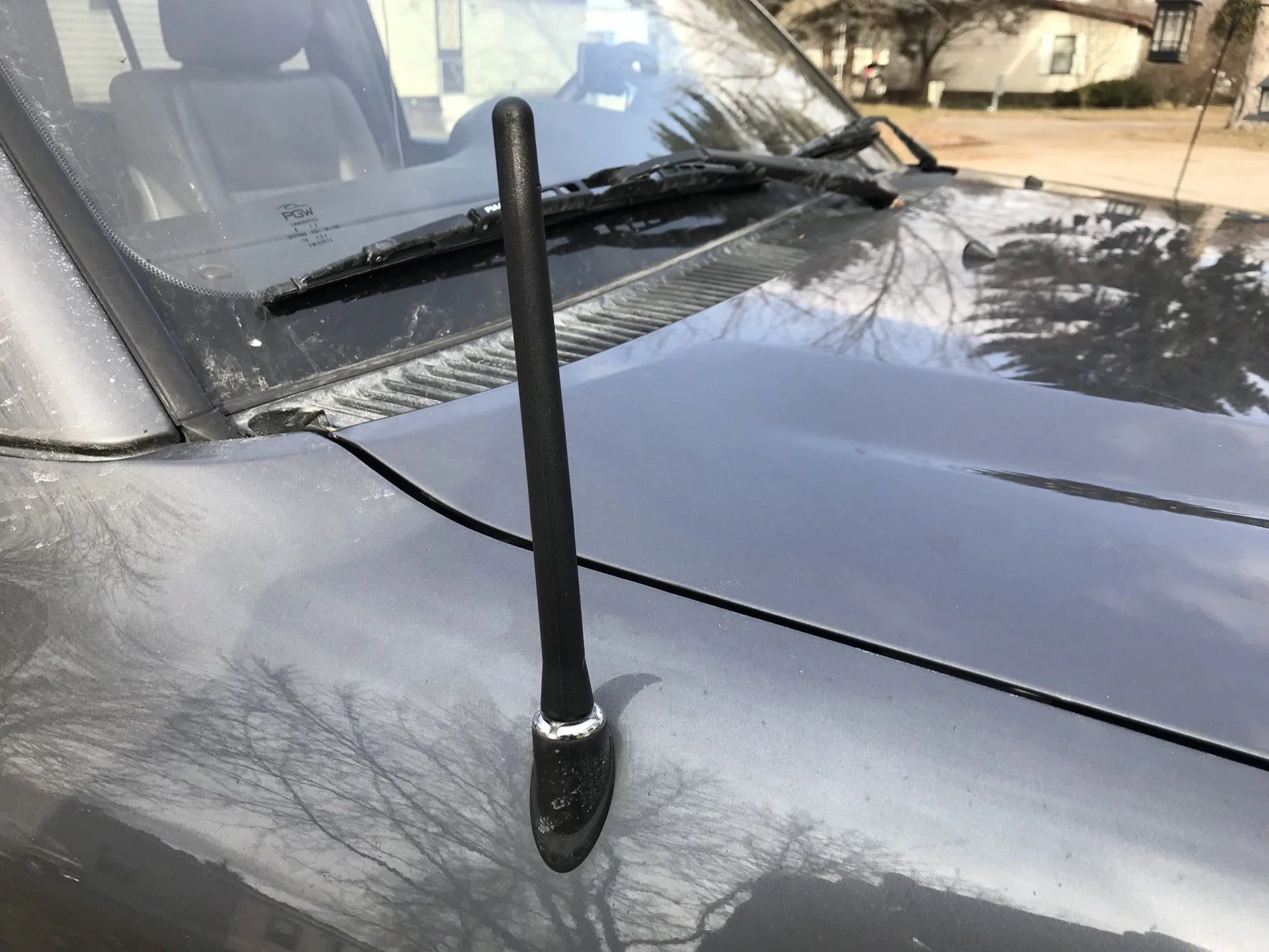

This took me literally 10min to do. Remove the power antenna the same way if you were going to replace a broken one with a new power antenna.

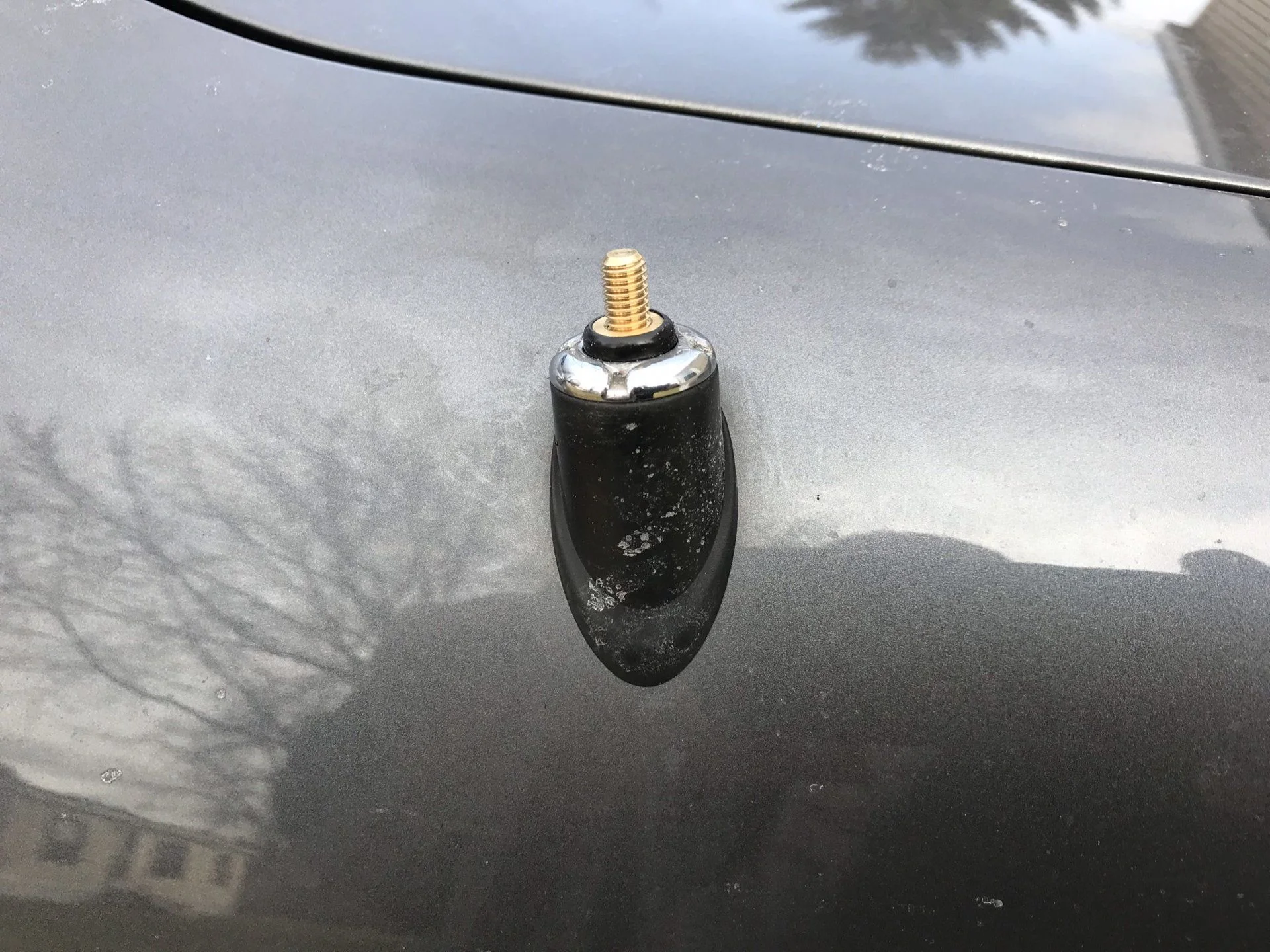

Then instead of installing a new power antenna you install their little adaptor base thing. Then you install the retaining ring.
Then you install the threaded stud, then the new antenna. Done.
You DO NOT need to unplug the antenna motor. It only runs for ~15sec and then shuts itself off.
THE POWER ANTENNA MOTOR DOES NOT RUN CONTINUOUSLY IN EITHER DIRECTION WITH NO ANTENNA TO RUN UP OR DOWN!!

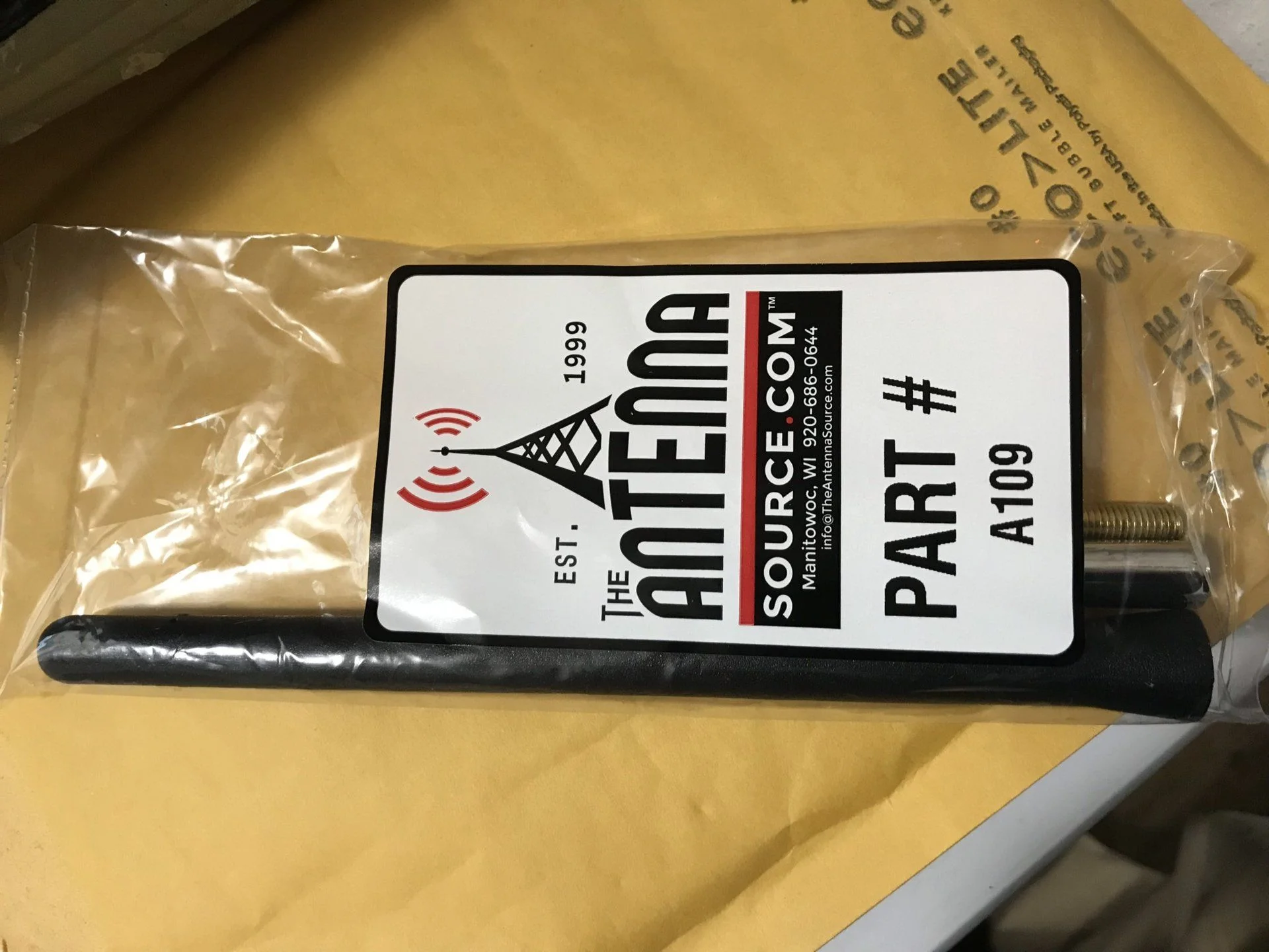

You can now install any antenna mast you want if you are not happy with the little one that is included. I installed a 14” fiberglass mast that I had bought from AutoZone as I was trying to make my own adaptor. I had spent 2hrs running around town trying to make one. No luck.
There is a threaded insert in the silver base, that’s what the stud screws into. Then you need a antenna with a female base if you do not want to use their’s.

The antenna that came with the kit is NOT flexible. It is solid and about 6” tall.
The antenna I installed IS flexible, I can bend it anyway I want. It will be carwashable. I am sure the short one that came with the kit is carwashable too.

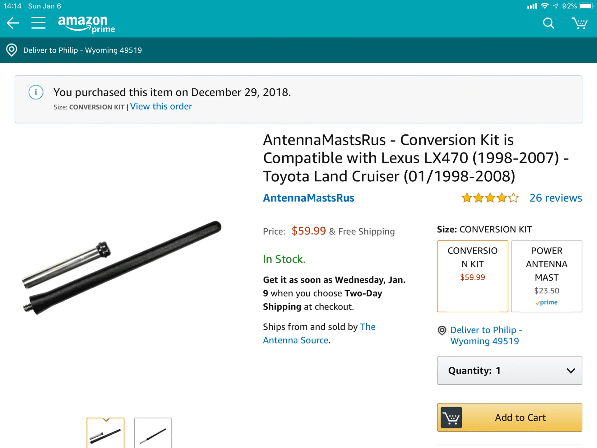

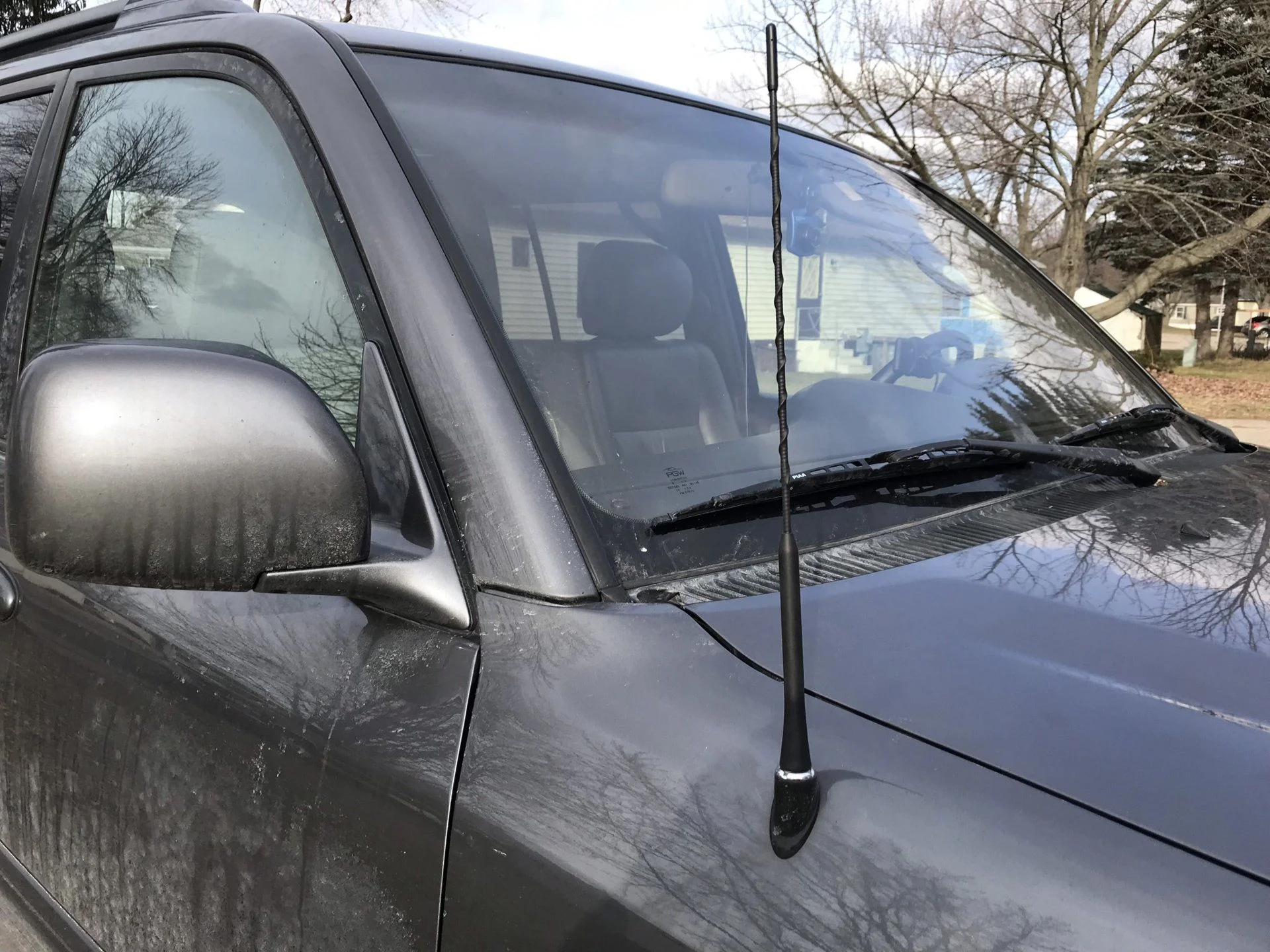

i'm a little slow here.. you purchased the kit from amazon (pic of the order & photos 1-3) and then added the 14" antenna (photo 4) from auto-zone.
The black plastic antenna (photo 3) went bye, bye, and the new 14" fiberglass was added (photo 4).
Where did the plastic piece of antenna below the 14" fiberglass antenna come from? OR is that part of the 14" fiberglass antenna?

The 14” antenna is from AutoZone, it is a universal antenna. The larger base is part of that antenna. You’d an use any antenna you want, if I notice any reception problems I will go with a standard length all metal antenna.

Yes. The ONLY way to convert from a power antenna to a fixed mast one is with this adaptor or using the Tundra modification.
With this adaptor you can use ANY fixed mast antenna you want. This adaptor kit comes with a stubby antenna.
