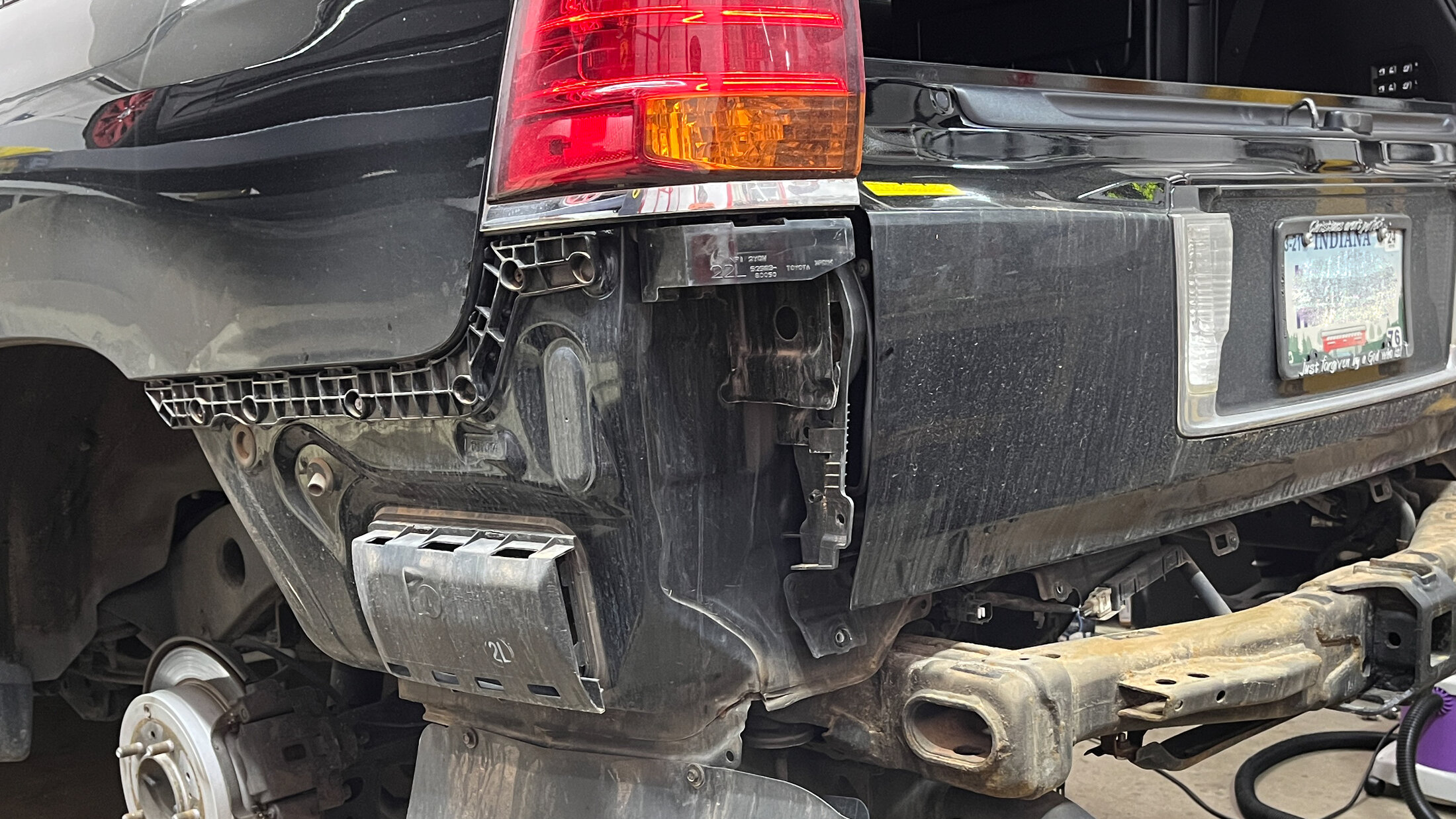

the driver side portion of my rear bumper is sagging and doesn't stay in the "clips" on the side.
I noticed that this portion of the bracket holding the bumper is broken:

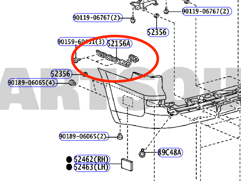

Is that part of this piece on the diagram?

Here's a pic of the rear 3/4 view with the rear fascia removed so you can see what's underneath.

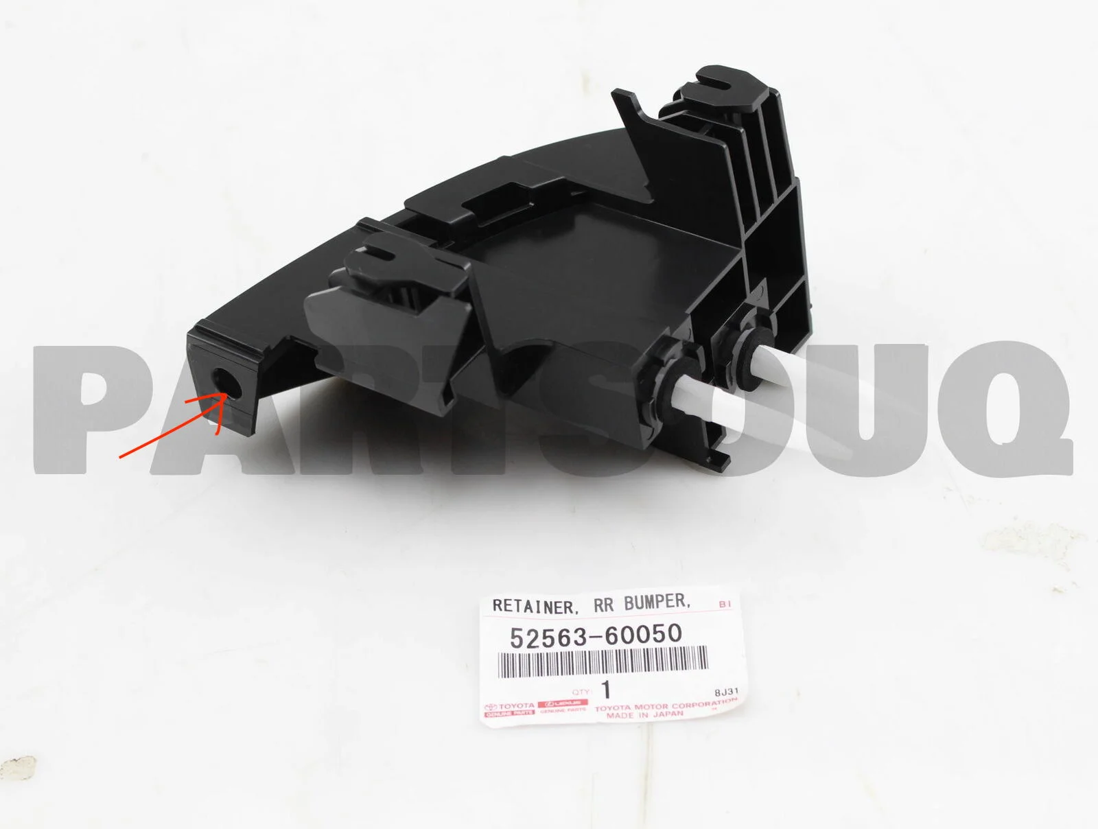

Looks like part number 52563-60050 and the clip you circled inserts into the hole marked by red arrow.
@urinalcake got you covered and I believe he's correct in regards to the actual part you need.
If you also need this bracket that's more along the side, it's 52156-60070
thank you both for the help!
the part was under the rear combination lamp diagram...i would've never figured that out
