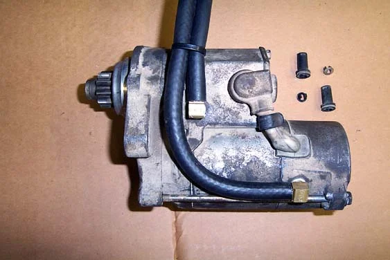

what I would do is wait for photoman to buy a FJ and then copy his work......
here are some links to his stuff - most of the pics no good anymore but I found one of the starter breathers-
breathers for the distributor,
https://forum.ih8mud.com/showthread.php?t=12110&highlight=starter+breather
starter & starter solenoid
https://forum.ih8mud.com/showthread.php?t=6631&highlight=starter+breather
attachment.php
also - here's a discussion of the dist vent system on a FJ40 (vacuum from the manifold, to the dist, and a breather from the dist to a small filter inside the cab)
https://forum.ih8mud.com/showthread.php?t=72827&highlight=breather
finally -
https://forum.ih8mud.com/showthread.php?t=29504&highlight=breather
little $3.50 ATV accordian style breather balloons
