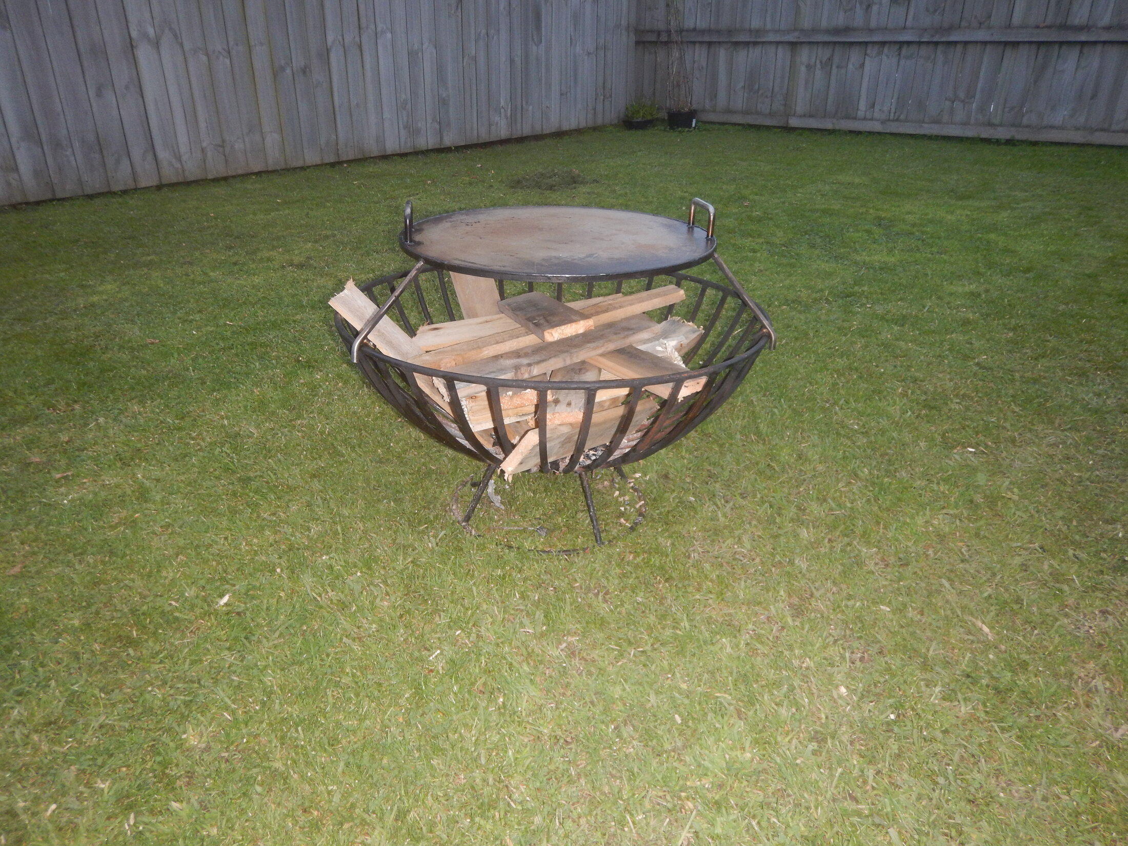

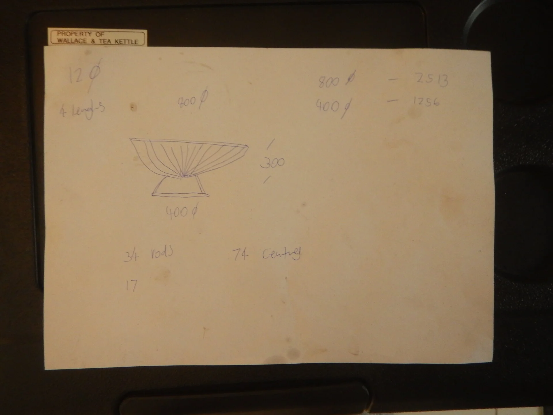

A Brazier I built , with dimensions.

nicely done! what kind of welding did you use?
is it going to be stable enough for large pieces of wood?

Hand bent tubes? Or tube roller? Or...?
I've got a pile of scrap pieces that I've been trying to think of a use for and may try something similar.
I would also make a large metal pan to fit underneath. Seems naked without it.

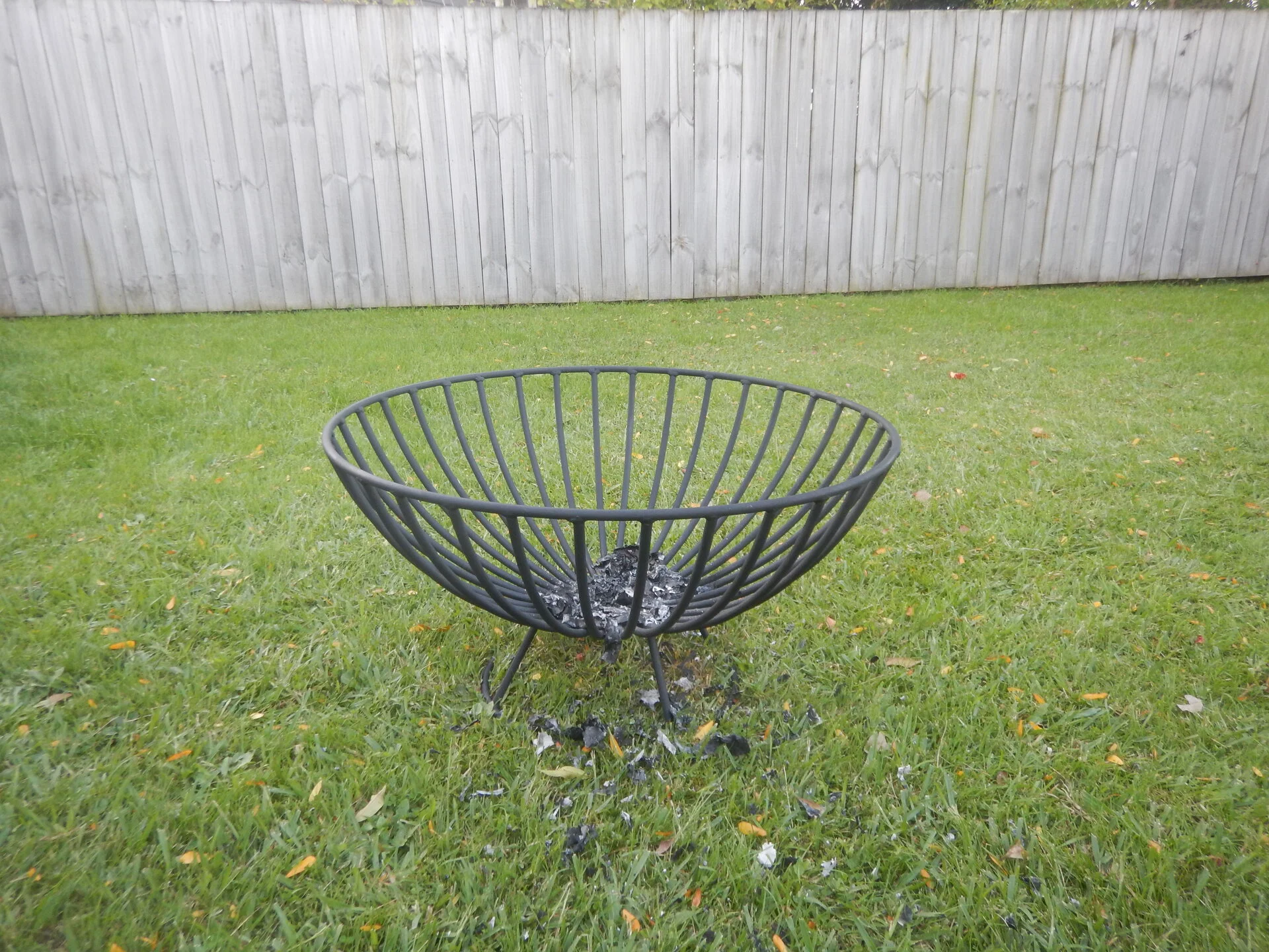

I was thinking because i want this to be a portable brazier, rather than having a tray underneath it ill cut a whole lot of narrow steel wedges that ill roll and weld in between the rods. and only have them come up about a third of the way up the dome. This way it will have a solid bottom.
Before i do that ill see how much the big embers falling out annoy me
Cheers
Try putting in one big log on one side and see if it tips over? Cuz you can't be sure somebody won't do that while it's on fire when you're not looking...
I like ya thinking. im often drunk when im standing around a brazier so you cant trust I wont do something silly like that. But it is made from 4, 20' lengths of 1/2" solid round bar (Or 4, 6 meter lengths of 12mm), so its certainly not light. But if it turns out it is too unstable, and i have to make a bigger base ring for it, i will post an update (I also don't have a big block of wood to test it with) haha

with the hot plate, the CoG is higher, meaning the thing is potentially more unstable. You like to live dangerously, maybe? Just put a couple of outriggers on the bottom ring and it'll be safer. Or a big disk/pan that will also catch the falling embers. But that's just me, of course.

The hot plate is 12mm 316 stainless, which is a more corrosion resistant stainless, but definitely able to deal with the temperature of a camp fire.
If you and I were standing around my brazier with the hot plate on it, I would be able to prove to you that its more than stable enough. even with heavy bits of timber getting thrown on. Even with the higher centre of gravity, it takes a lot of force to tip it over. And i figured it went without saying but i don't light it on a green lawn (that's where its stored) so I don't need a big tray to catch embers when i only light it on patches of dirt and gravel. Also interesting to see someone from the US so worried about health and safety issues. From what Ive heard OSHA is bugger all compared to the health and safety bulls*it we have to deal with in NZ. My take on it is, it might go wrong but it probably won't, just use your common sense.
