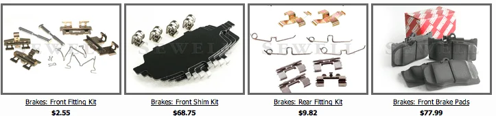

- anti-squeal brake shim kit (F/R): FRONTS: $51.56 (SPECIAL ORDER)/REARS: $28.56 (IN STOCK)
Before I finalize my order I'm wondering if someone can confirm what these brake shims look like, 'cuz I can't find a pic of them anywhere. And if in fact these shims are the plastic/delrin plate between the pads and support plate, why can't I re-use my old ones since they're fully intact? Is there more in the kit than those plates?
I saw THIS thread regarding shims and there was this pic in it and I don't recall any of the clips looking like these nor the shims looking like those pictured either:
