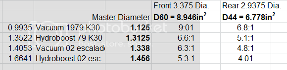

Here are some numbers I ran from one of my brain dumps...
Dont know what the size of the Ford calipers are, if I get them I can add them to the graph...

I dont have it on this pic but there is also a larger 3/4 Ton Dana 44 caliper, the one listed is the Dana 44 1/2 ton...
Only other thing to keep in mind is pedal ratio, that being said if your using factory cruiser pedals you should have options as those pedals are long and can be modified easily...
For reference I am going to use the vacuum operated 02 escalade master cylinder with GM Dana 60 front calipers and half ton calipers rear. With a Toyota dual diaphragm its 6.3:1, so it wont be cushy soft like a normal dual diaphragm...
After all this, the war pig just uses an FJ-80 master and it seems to stop ok without to much pedal effort. I think there is more braking power available with a larger master, and increased pedal effort...
