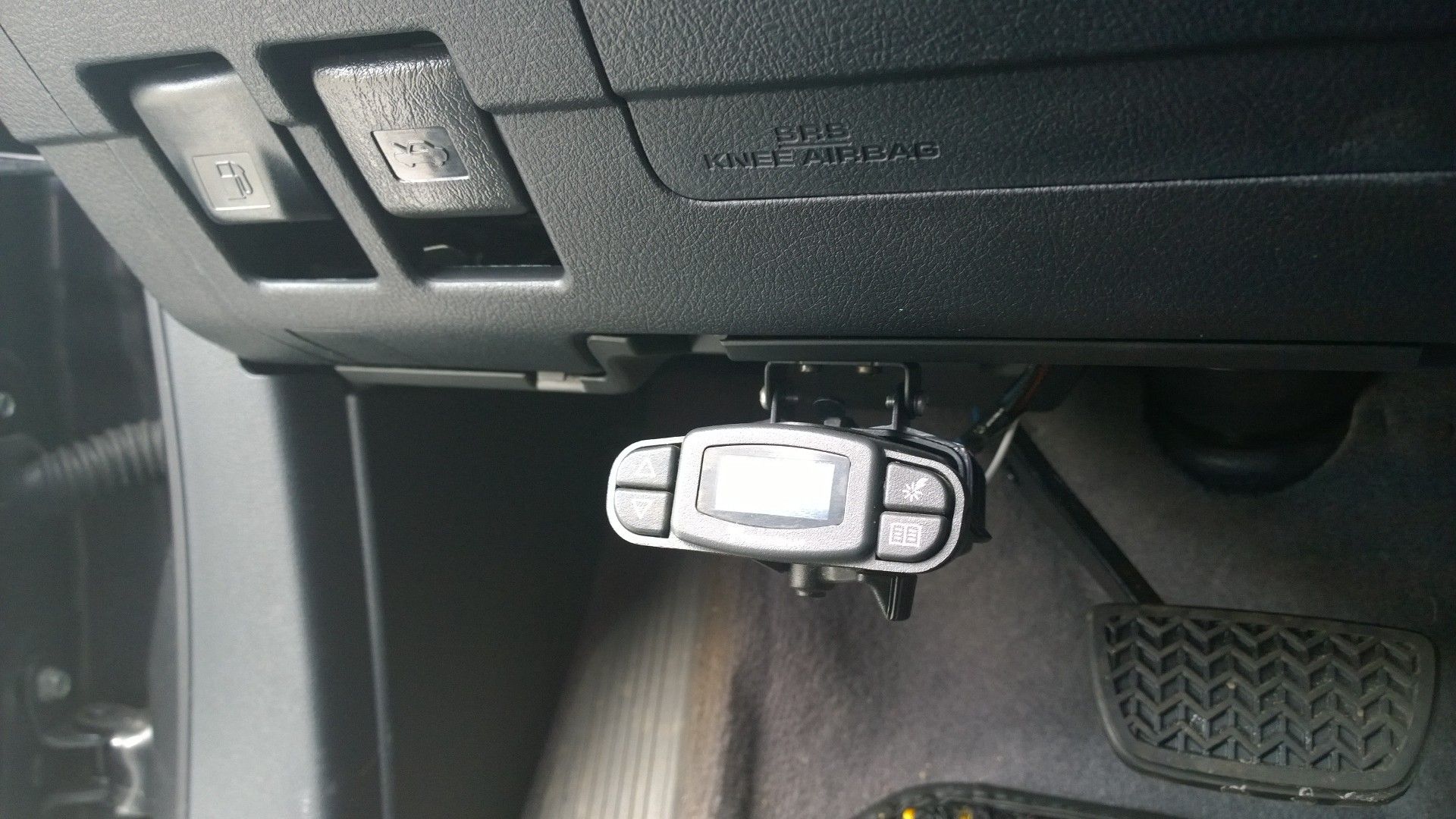

Here is where I mounted mine and so far so good.

Thanks for the replies. InkMing - For some reason, I cannot see the image that you posted.
Mtnracer - I was thinking of the same location (I think), but doesn't the controller need to be level and straight forward to back to allow it to control properly?
Jonathan
Ideally it is supposed to be level but it works fine at the slight angle. I think most people mount it at an angle because otherwise you would not be able to read the LCD screen. :-)
Now that is a great photo! I had not thought of mounting it that low. Can you reach it sitting in the driver's seat?
Yeah, can reach it. Just haven't gotten a chance to fully test it out yet. Keep running out of hours in the weekend.
The problem with mounting it that low may be that it will be difficult to find the "lever" at the bottom of the unit to manually apply brakes to the trailer in an emergency. If something happens you need to be able to very quickly get your hands on the lever to straighten your trailer back out and stop sway. It would be very unsafe to fumble around that low trying to reach the brake controller while steering your truck.
