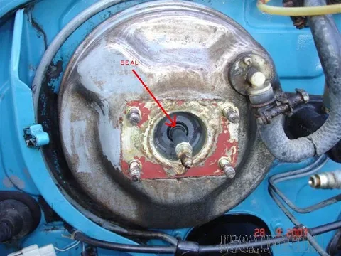

I guess it is possible that the vacuum leak could be just this seal here leaking........ and if so, perhaps just some fresh silicone grease on the rod my fix it.
.............Just an idea

Ok, so here's where I have to make it clear, as if it were not already, that I am dealing with a novel situation for me. In fact, a good 85% of the working mechanicals on this truck are foreign to me at this point in my wrenching career.
I do not know if my fluid levels drop at all as I suggest, the reservoir levels are not droping over time (no fluid loss, thus I must presume no leak between master and booster--no leak into booster or to anywhere). But, as I stated, there was definitely a brake fluid leak between the booster and master at some point in the past, based on the corrosion on the lower half of the booster's shell, but apparently repaired.
After shutting down, I attempt to locate the hissing sound (the vacuum leak) and to the best of my ability, with me crawling up into the engine bay (hey, I am small enough to do that), it sounds like the leak is inside the booster. Presumably a torn diaphragm, right?
My plan of action, and Mel Lowe agrees, is just replace the booster and see if that stops the leak. If so, great, done. If not, no harm other than loss of maybe 30 minutes or so.
No problem, we all have started at zero at some point.
As you said, if there is no drop in fluid levels you can eliminate the fluid leaks at this time.
Yes, changing the booster will fix the problem (if it resides in the booster), but calculate more than 30 minutes for that task. A lot more. You need to undo the brake pedal connections (very good if you are small) to the inside of the booster, then unbolt the 4 12 mm nuts on the inside of the firewall.
Then (or before) undo the 4 12 mm bolts that hold the brake master to the booster. At this point you might have to undo the brakelines from the master or not, depends on how far you can wiggle the thing to the side without kinking the brake lines. If you have to undo the brakelines you have to bleed the whole shebang in the end too. If not, things are much easier.
Then reverse the operation, while cursing about the little room you have under the dash for all of this.
