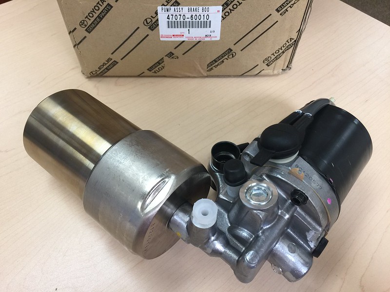

found the pic of the pump assembly

Seriously, not many are aware about this expensive brake pump. I pulled a pump of a 02 Montero (not sport) and the junk yard staff wondered what it was!
