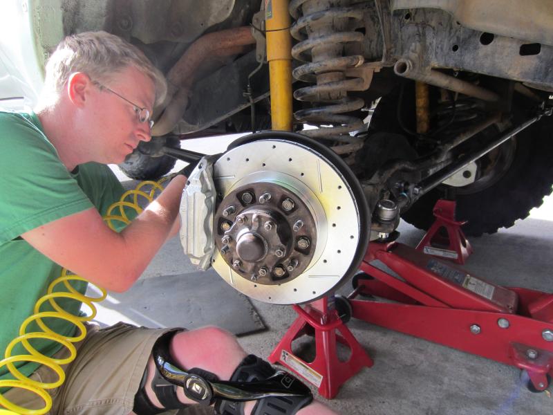

Well, not an 80 if it's a 65, but check your caliper bolts to make sure they are still in there and its not a caliper dropping and binding on a wheel.
Which one of these are causing the issue?
No calipers. All drums. Thanks for the input.
