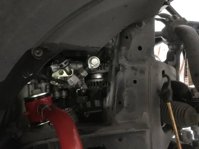

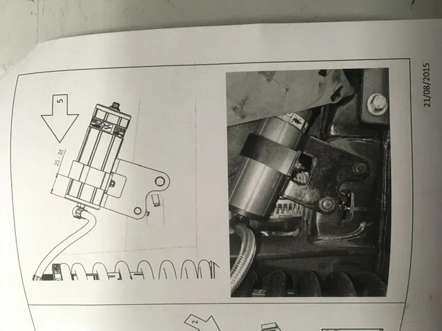

Here is a little problem, the right remote reservoir will not mount in the kits location due to an AC switch and hose. I will probably mount it above the strut but want to see how other people dealt with this.
I just flipped the bracket and drilled new holes, all good now.
