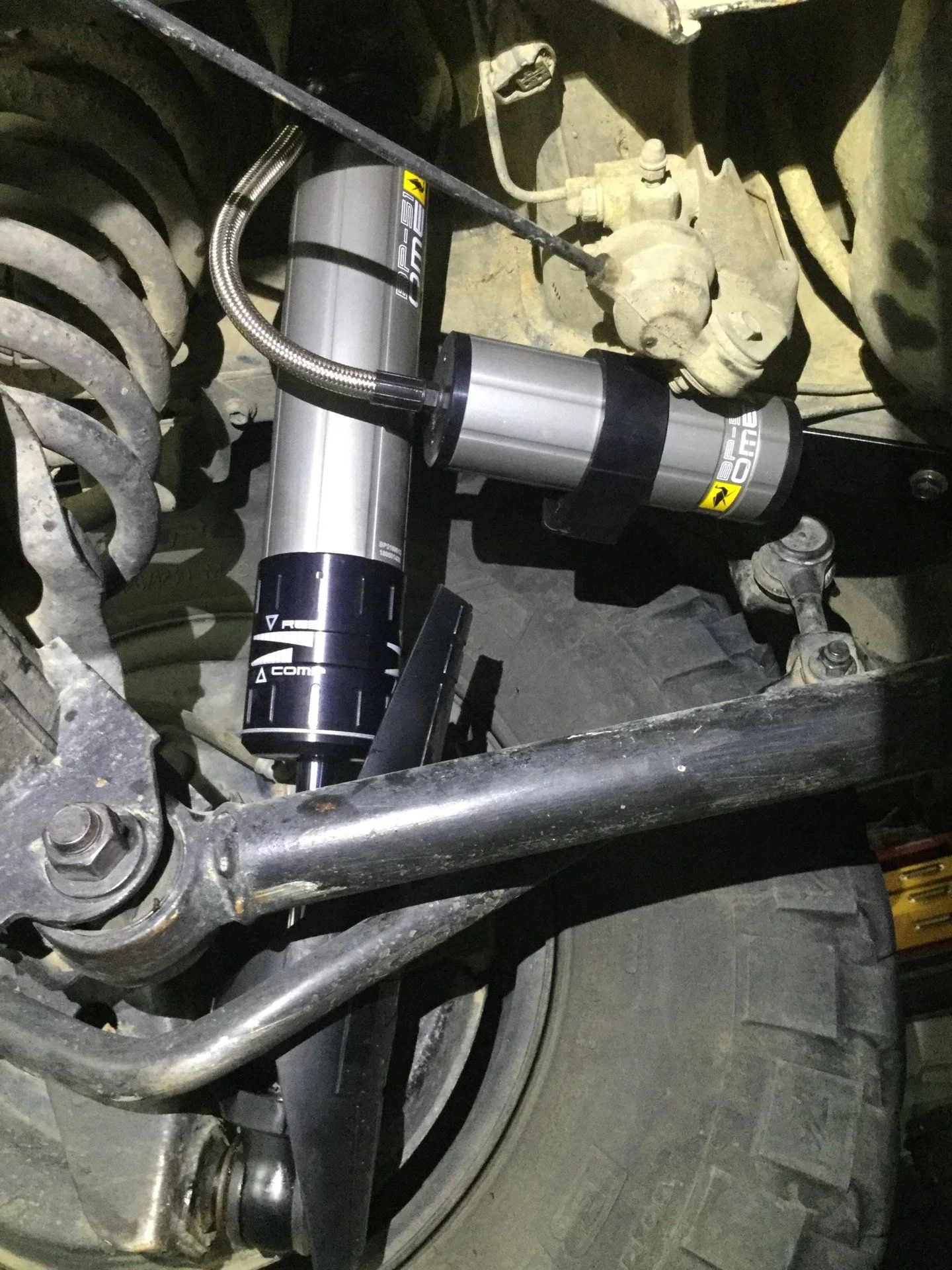

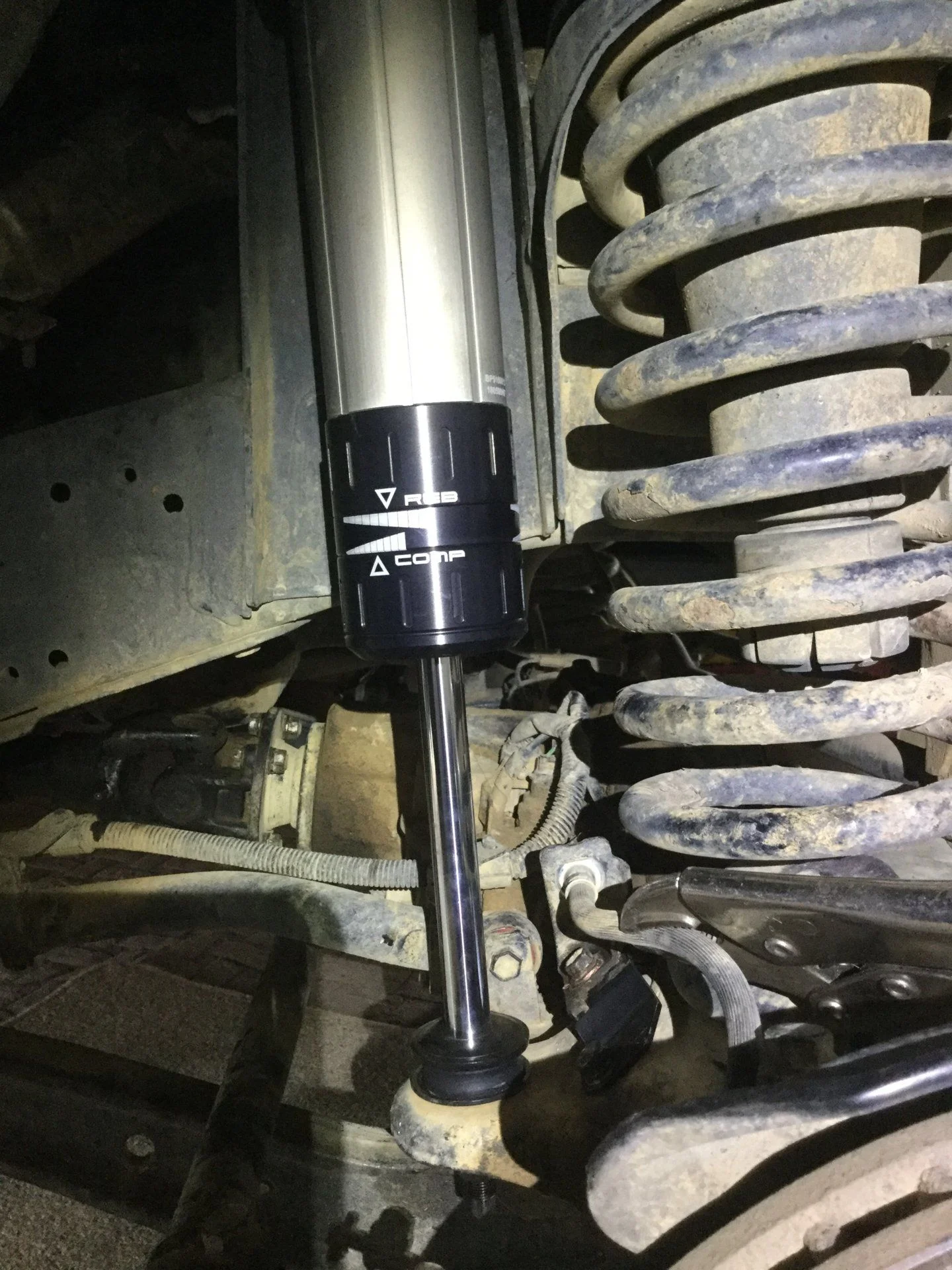

So I have now fitted the shocks to my truck. Fitting was a real easy job, but there were a few challenging things.
Even after disconnecting the front sway bar i had to use a small jack to push the front axle down to get the bottom shock mount into place. All of the parts supplied for the front mounting were perfect and fitted as expected. Relocating the connecting between the brake hard line and soft line was easy once I worked out which bracket was the left and which was the left. This moves the connection inboard an inch or so to get it out of the way of the shock body on full compression.
Installing the rears was also fairly straight forward but there were a couple of parts not / short supplied. No major drama as I already had OME shocks on the truck and could reuse one of the big washers. I have reported the issue to my supplier.
The instructions and pictures for the rear installation are a bit unclear but once you work put that the external reservoirs are mounted inside the frame rails forward of the shocks it all becomes a lot clearer.
The rear stone shields clipped in and feel reasonably firm. Time will tell if they are better than the bolted on ones.
I haven’t had a chance to try them out off road but have increased the compression and rebound front and rear.
Front is now 6 Comp, 6 Rebound
Rear is now 3 Comp, 4 Rebound
