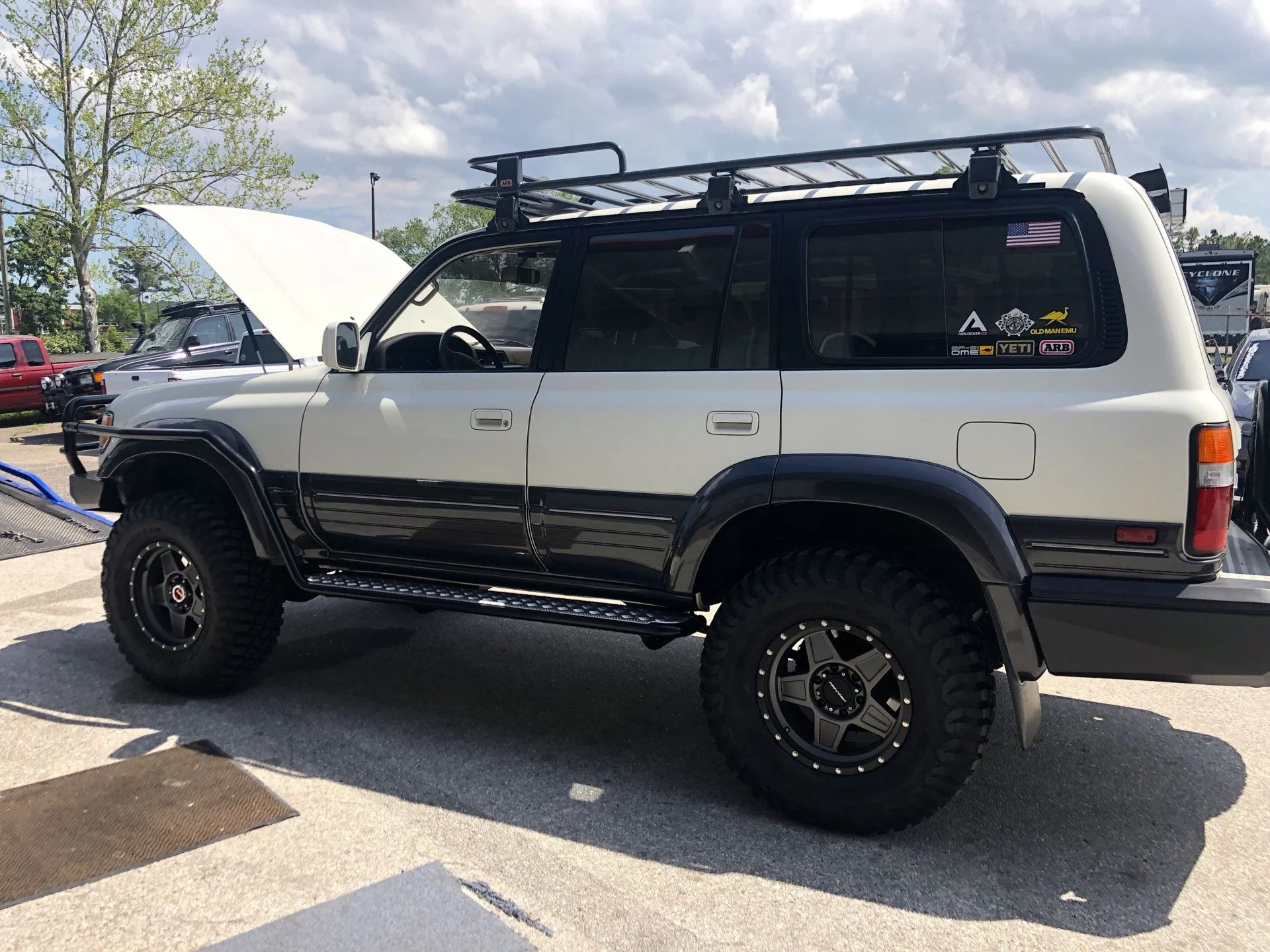

Have the BP51s with a J spring setup and 35s. I wont be doing any hardcore wheeling but I wanted what I thought was the best. I had the regular OME shocks on previous rigs. It think it is much improved. I did adjust both rebound and dampening to a much firmer setting. I thought they were too soft for DD at the soft setting it came set at. I want to get larger sway bars next.
Overall impressions of it? Js all around?
Have you been off road even just fire roads with them? Looking for any reviews and comparison I can find
Ive been offroad mostly sand and some steep dips and climbs. I love the ride off and on road. I don't see anyone taking the setup beyond its limitations. Im not a hardcore wheeler either. I just want to be able to get where Im going.

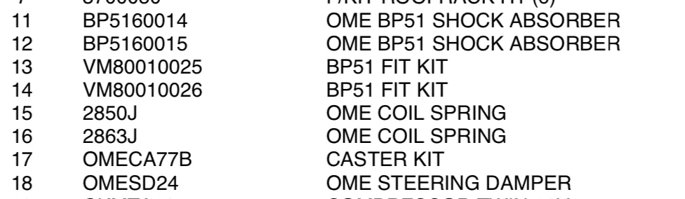

I’m on 850J up front and 863J rear with the longer version of the BP51 shocks. I’m happy with the springs and shocks. They seem to go really well together.
Just joined the bp-51 club! On 850J/863 springs. So much nicer than the tired nitro chargers that were on.
