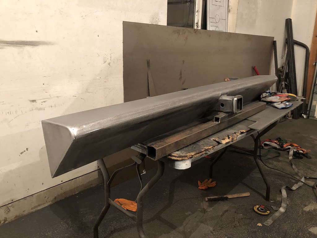

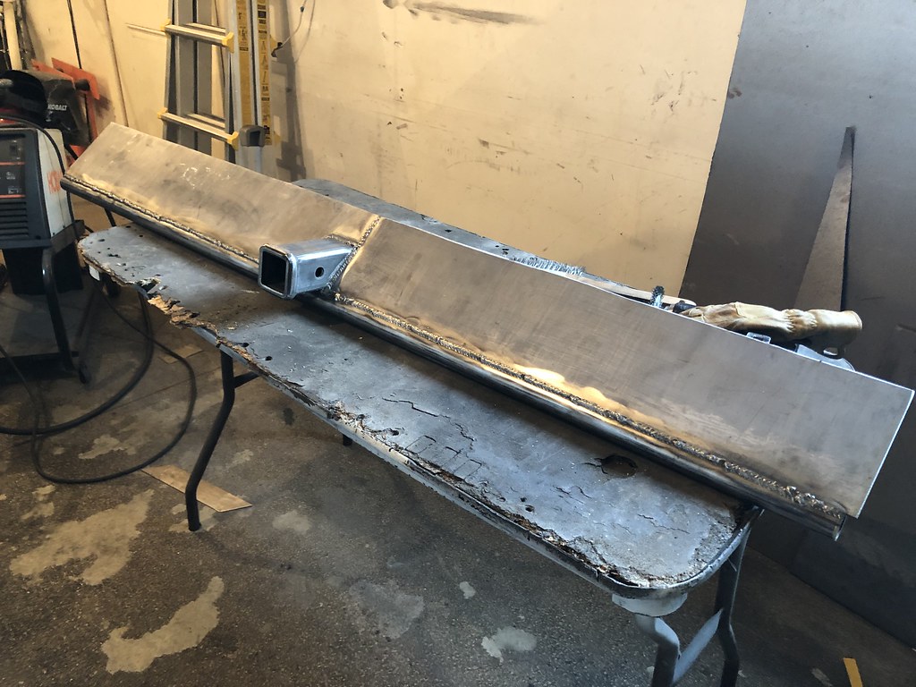

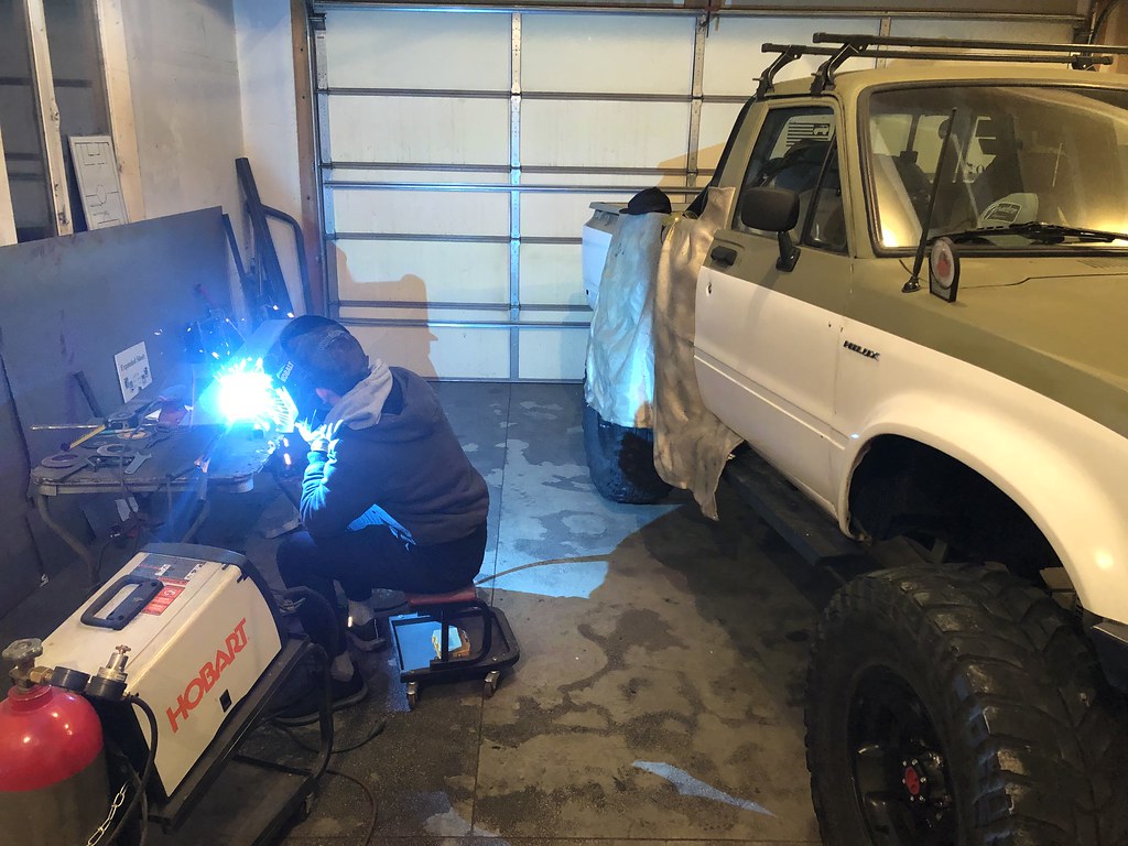

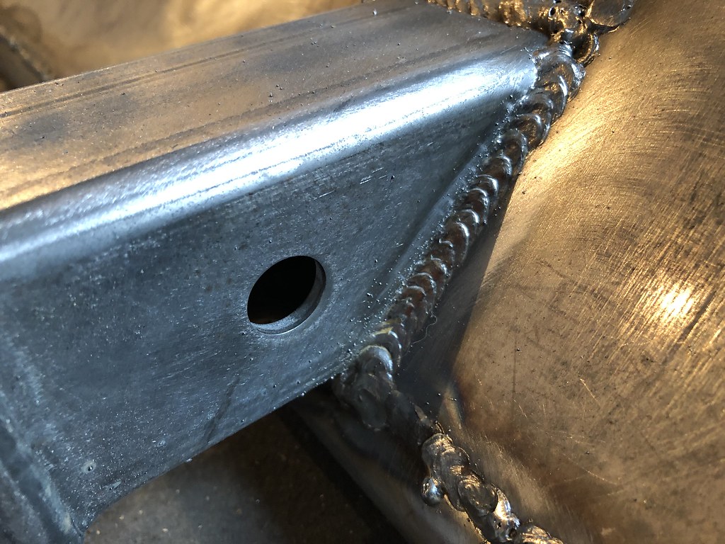

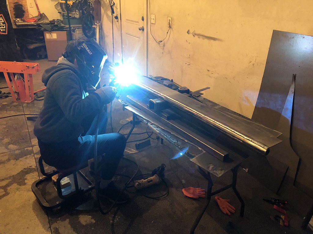

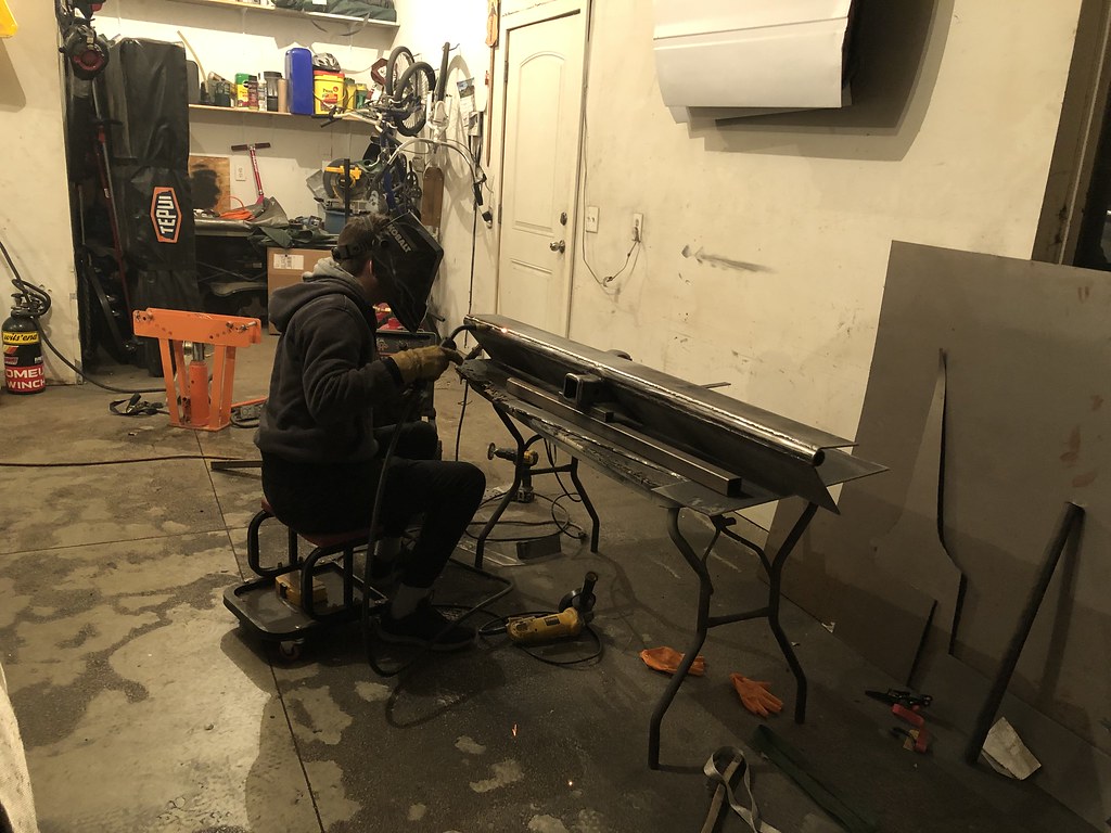

My son asked for materials to build a rear bumper for Christmas, so we worked up a design and I got him the stuff. He's been working on it this past weekend. The main center section of the bumper is more or less put together. I am impressed with my sons fab skills already. He took a welding class at the high school but it was all stick welding. I haven't seen him use a MIG for quite a while and last time I did it was a little rough. He's definitely improved and he's been doing a nice job on this bumper IMO.

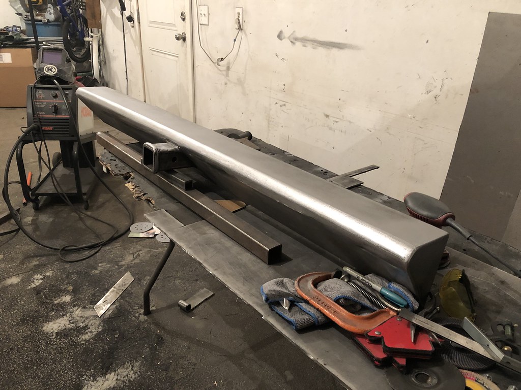

He wanted a design with good clearance, protection, would not get caught on rocks too much, had a hitch receiver and recovery points as well as some bedside protection. Main section is complete with the receiver incorporated. He's made templates for the frame mounting plates. Recovery points will be welded to the frame plates and pass through the face of the bumper for some shackles. Once that get completed and he can get it attached to the bumper, he'll work on the "sliders" for the bed protection. He's planning to make them look like the main sliders so that it looks like continuous protection that was all designed together. I'll share more when he makes more progress. But so far, not too shabby.
Holiday bumper by Adam Tolman, on Flickr
I see a nice roll of nickels.:)
A lot better than I could manage.:)
I'm impressed with the welding and design. Can't wait to see how it finishes out.
Nice truck @Box Rocket and how cool to have your son learn on it - and it seems he's picking up fast, I mean did you see those welds? I absolutely love that front bumper you designed.

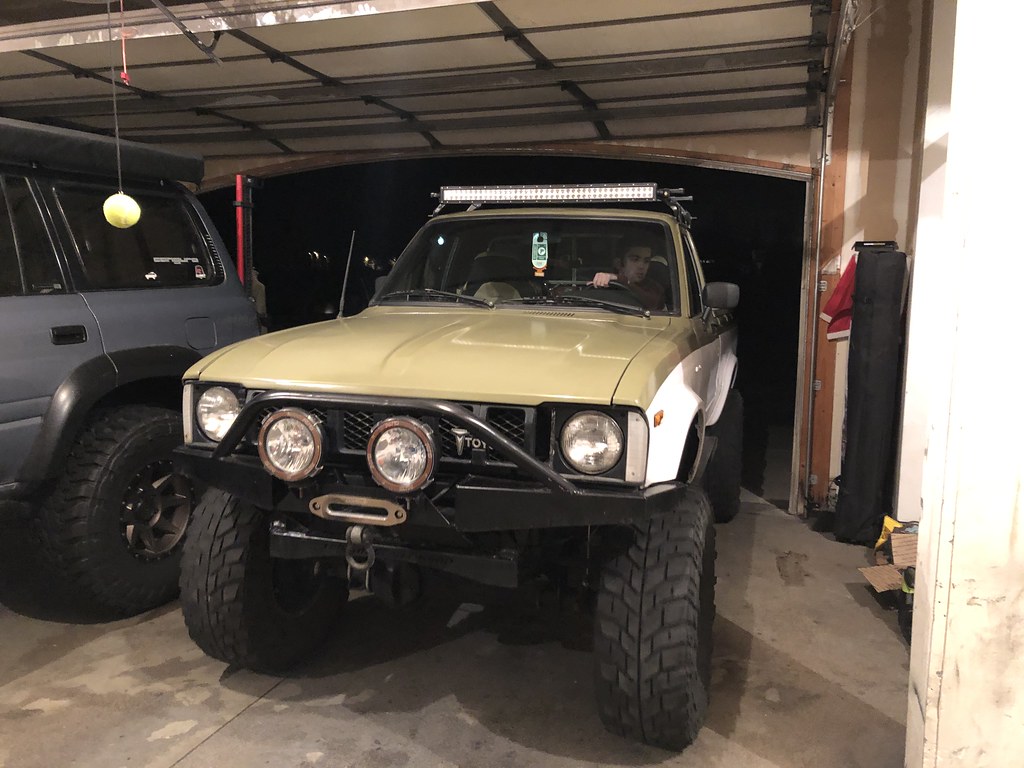

I replaced some lighting on my 80 series and in the process removed the 42" lightbar I had on my roof rack. My son wanted it, (you know lightbars before lockers, haha) so we put it on the pickup. I guess I can't hassle him since it was free. :) It's essentially set up like I have my 80 now with some HID spots for distance and some LEDs to fill in the area in front of the truck with light. I've really liked that kind of light arrangement on my 80 and it made a huge difference on the pickup since to stock headlights are poor at best.
