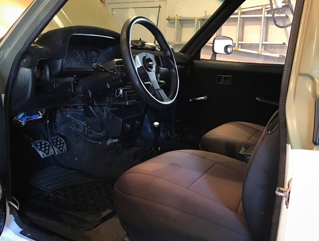

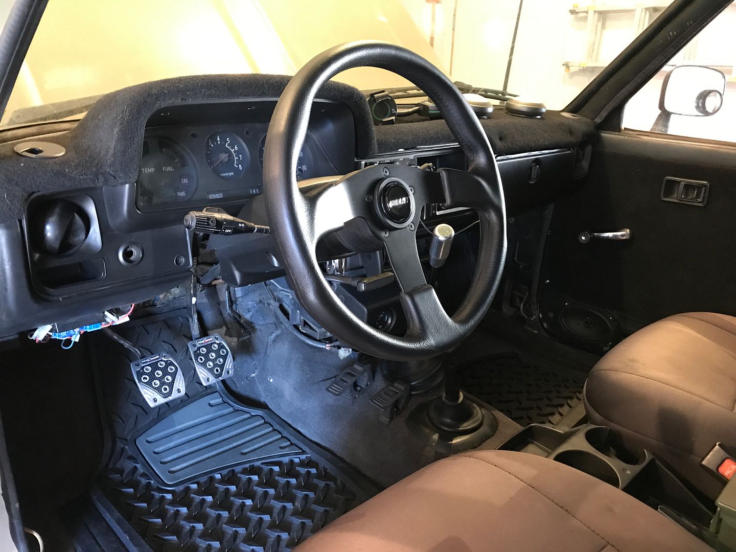

few more pics of stuff being worked on. Did a little interior cleanup and installed a new steering wheel. It already had an aftermarket wheel but it was falling apart.

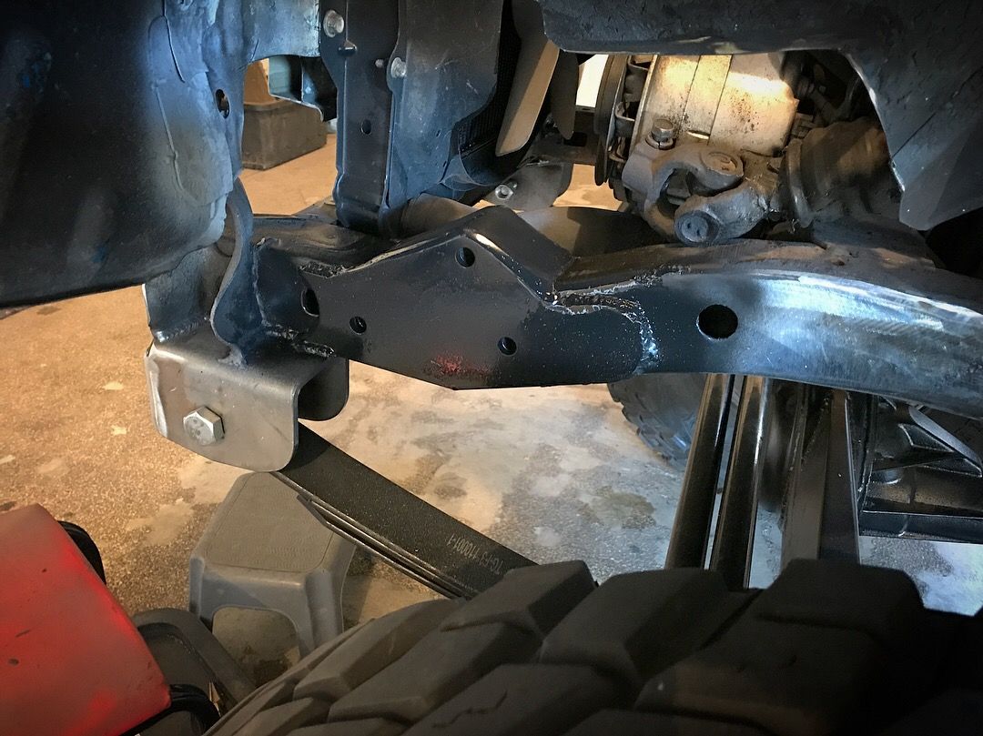

Finished up the steering box frame plates and sleeves.

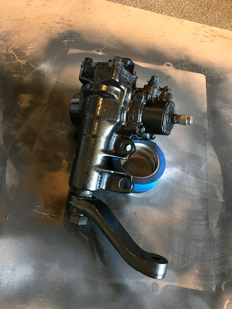

Cleaned up the steering box and got it painted. Should be buttoning up the power steering conversion tonight.

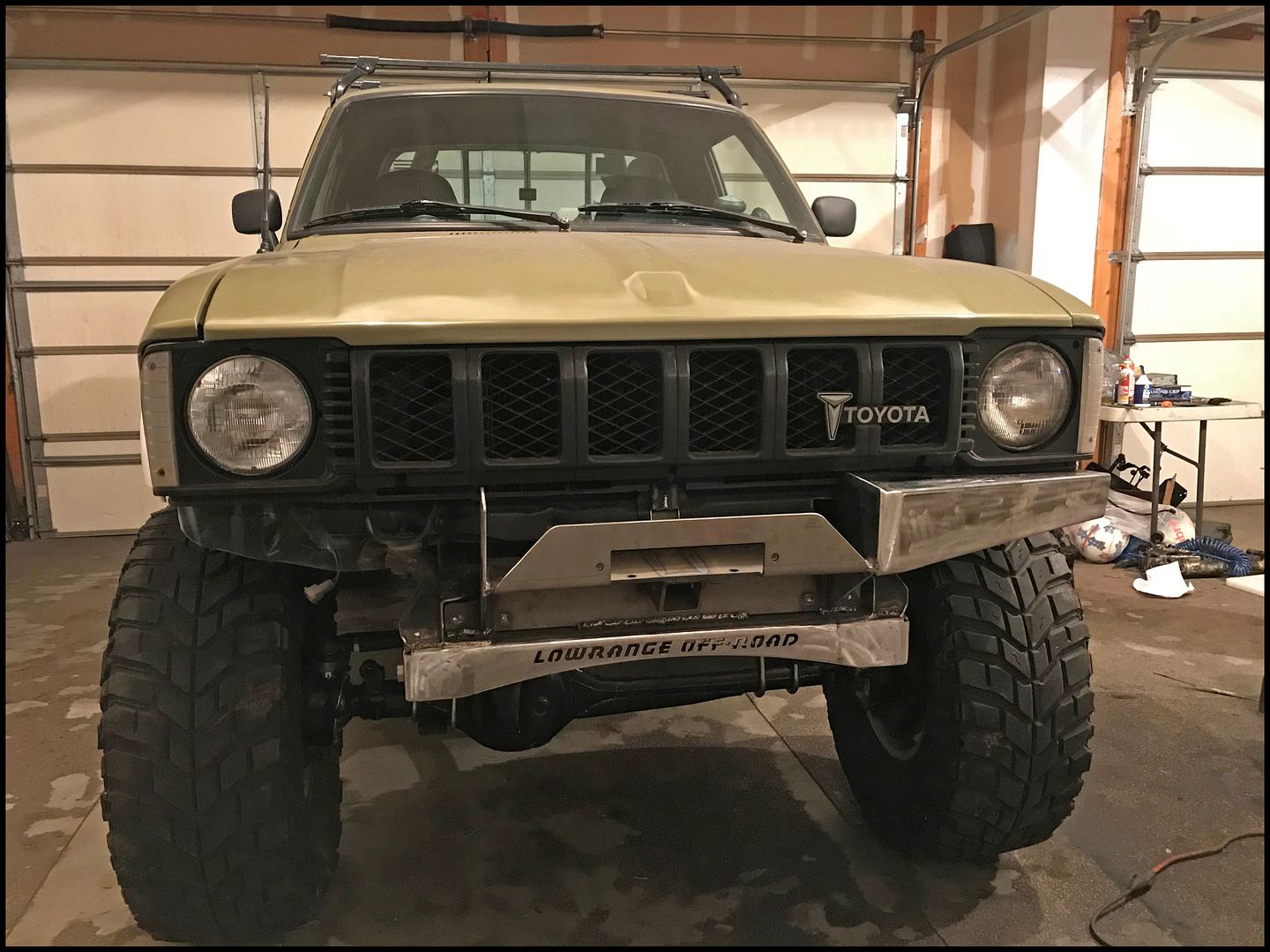

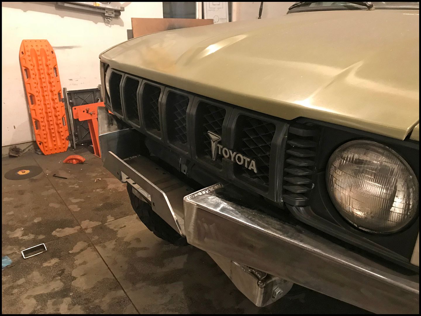

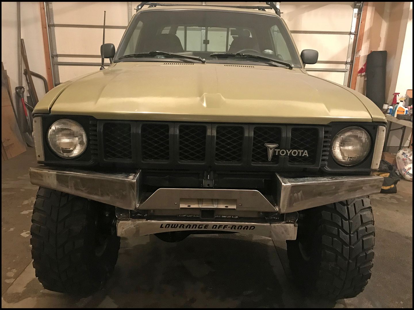

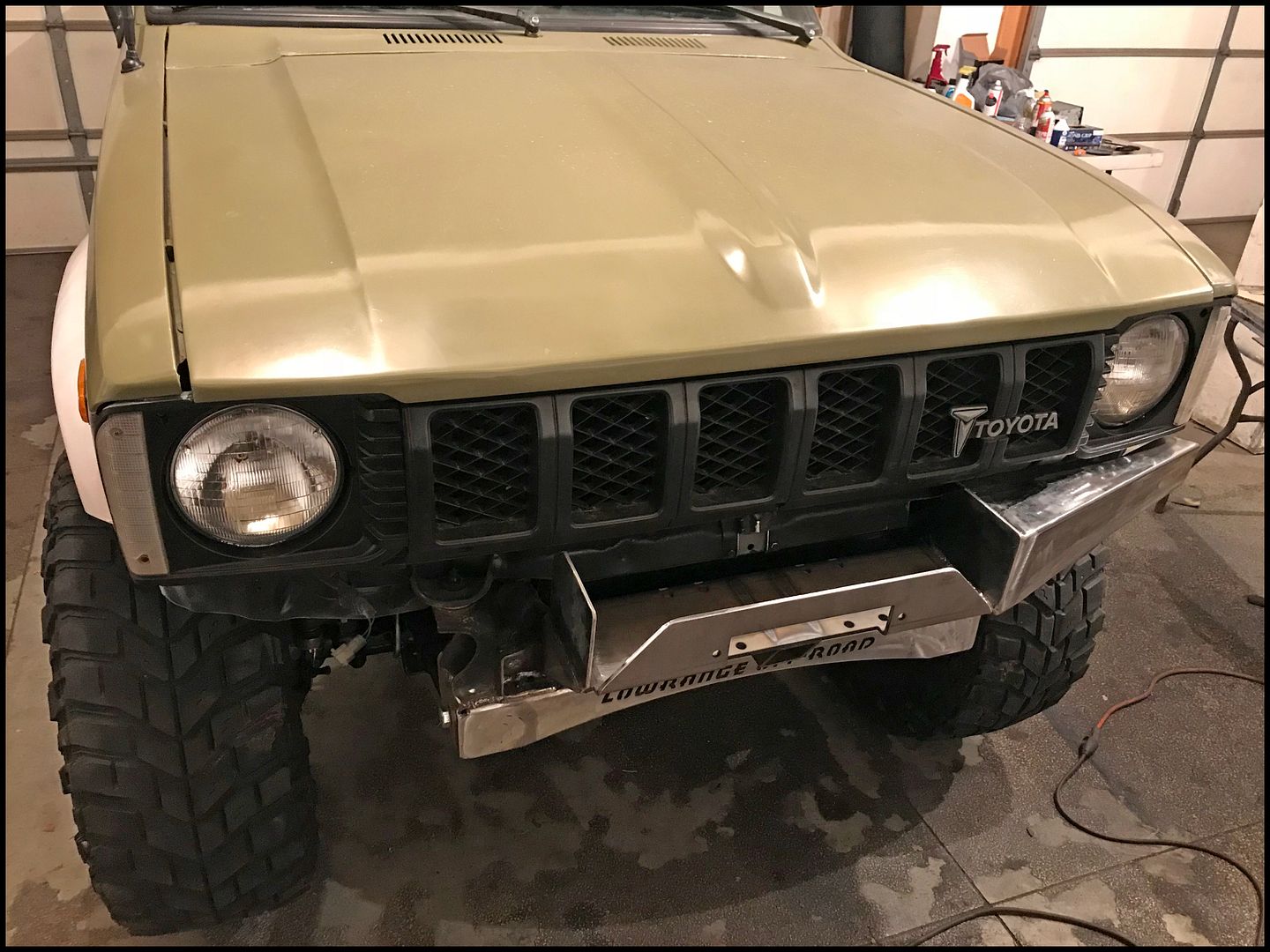

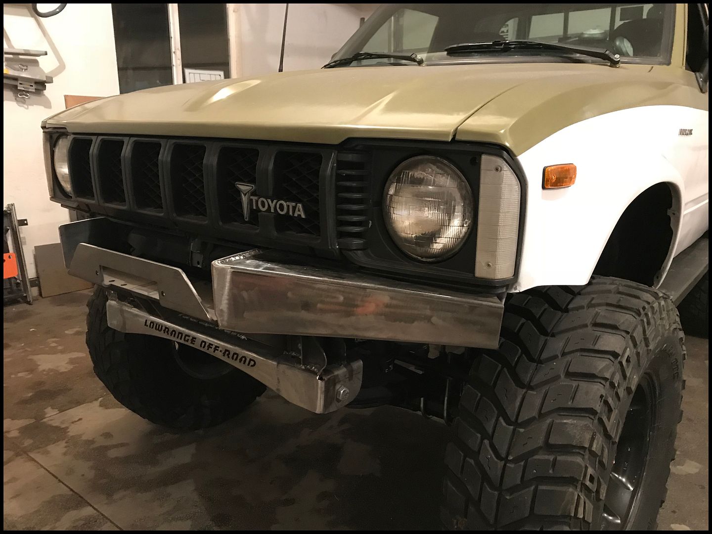

Since I moved away from the brakes my son and I whipped out a front bumper on Saturday as well. My son doesn't like the look of tube bumpers on these trucks so we built a "plate" style. Started with a Trail Gear winch plate and built off from there. We actually used some 2x5" rec tube for the front sides and added a bit of plate to the top to close up the gap to the grill. Really happy with the tight fit to the grill for good approach angle. I dislike a lot of the bumpers that stick out way to far in the front. Will be a tight fit for the winch (and require removing the grill to install the winch, but the grill will fit once the winch is in there). Still a few things to finish up. We've got a pair of 10" HIDs that will be going on under the hoop. Still need to cap the ends (or extend the wings back to the fender well), and add a bit more lateral support back to the frame and it should be good. Needs paint of course.
Except for the hoop that looks like the same general idea as the Front Range I have.

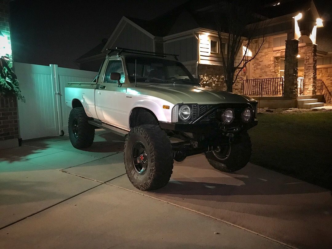

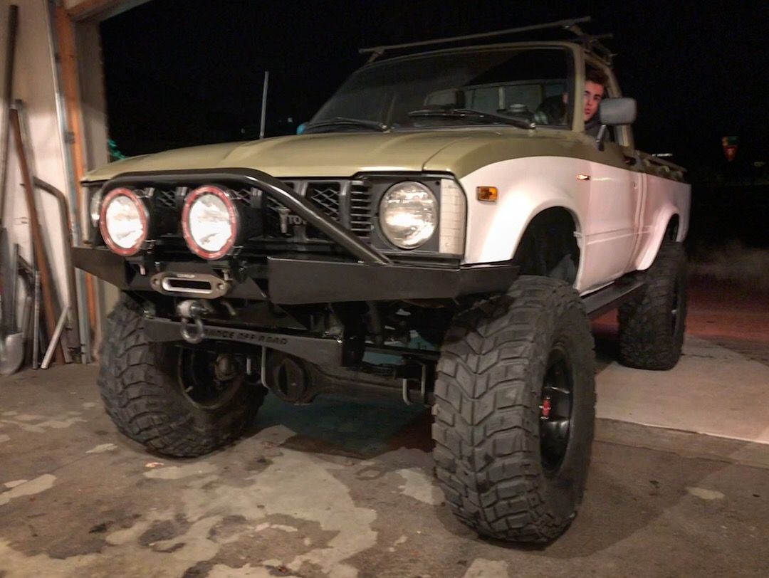

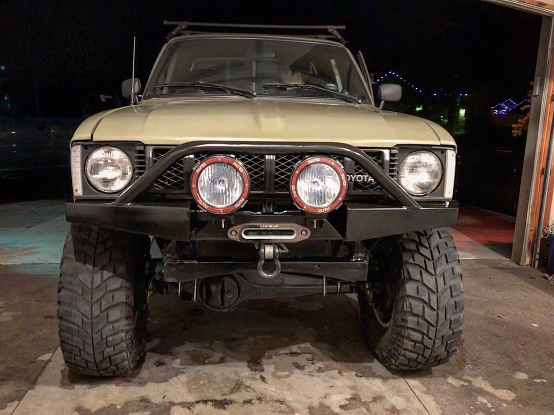

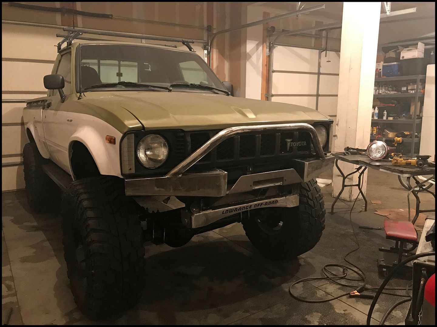

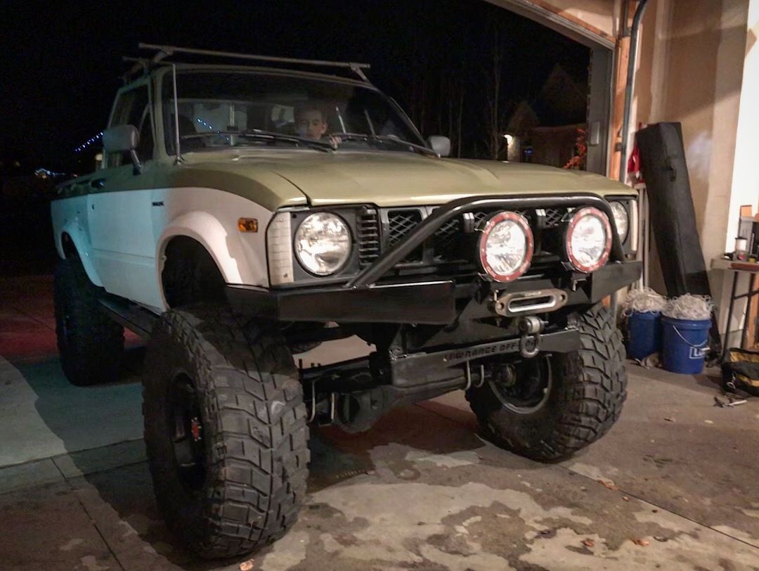

Was able to wrap up the front bumper over the weekend. Overall, pretty happy with the end result. Also installed new SS braided brake lines up front and in the rear. Gotta fix a dumb mistake with the calipers tonight and this thing is ready to drive. Still a bunch of mods planned but it's to a good useable state now.
