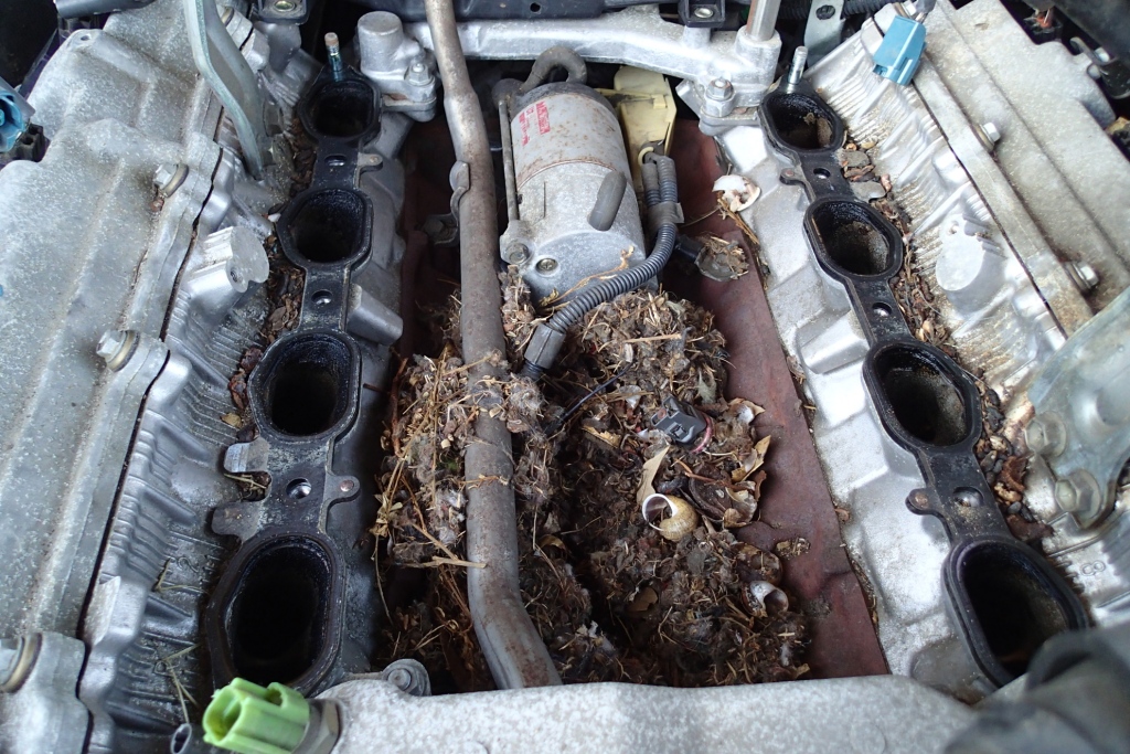

Yes, a rat can fit in there. And yes, while the truck sat unused for a few days, they made a nest.

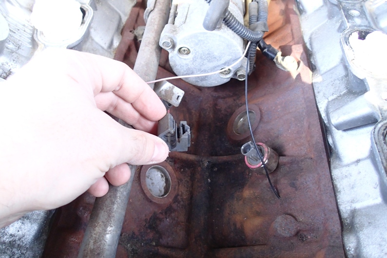

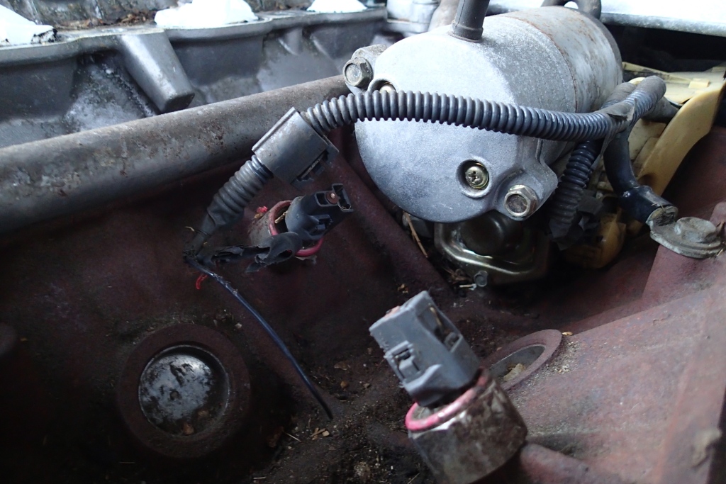

Here's a picture of the wires to both knock sensors chewed off right at the base. You can see that one wire is chewed back a ways.

Here's most of what I pulled out from the "V". Looks like they made a nice home for themselves and in classic french tradition the rats ate snails :D

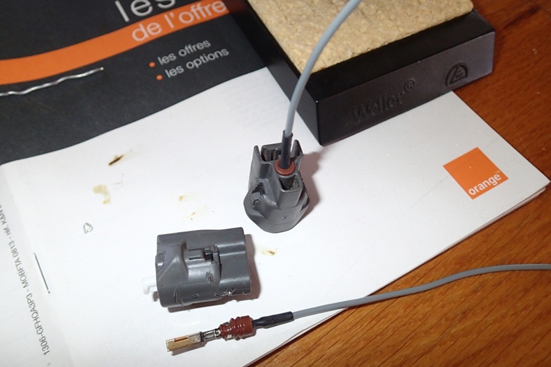

Everything is in working order now with the codes cleared and staying away. Here's a pic heavy write up on the surgery for anyone who has to do this. Thankfully the sensors were fine so the rats cost me nothing but some time and solder.

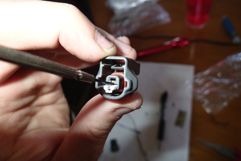

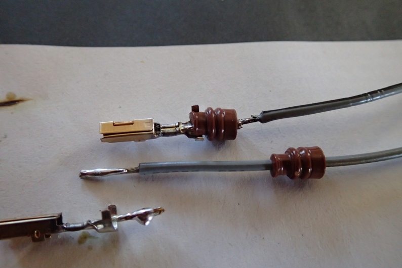

What we're starting with - The white part of the connector gives some resistance but comes right out without any tricks.

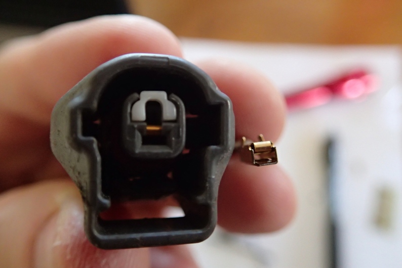

The orientation of the copper connector:

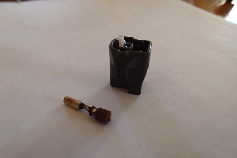

Once the white plastic bit is out, put the driver in the gap and push down on the tab while leveraging it up to get the female part sliding. Yes, I said that.

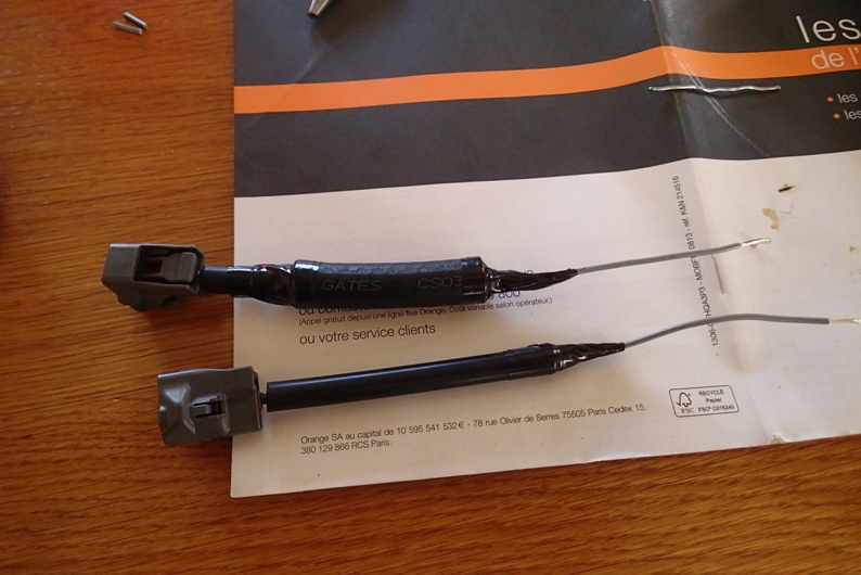

When you solder on the new wire, be sure to leave some room for the waterproof sleeve to fit back where the clamps hold it secure.
Here the shrink wrap is only butted up against the water proof plug. I should have done that before putting the plug in the clamps so now I don't have full waterproofing or the strain relief.
Before install - I wish I had some heat tube to use instead of this ghetto-rig. It ended up putting a little bit of strain on the connections.

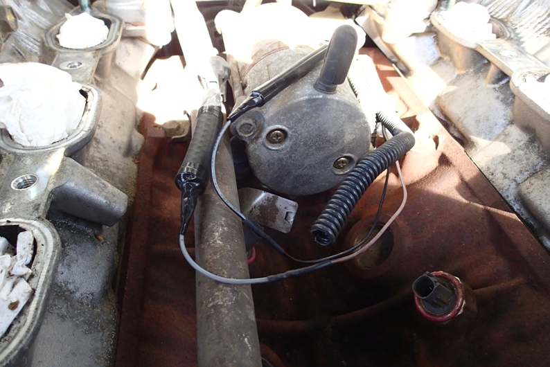

You'll have to take this connector off. It was a pita; just get it slid off the metal tab first and then fight with it. Note that the white wire is for the p.s. bank, black for d.s.
I made the wires too long. Measure so You don't have any exposed wire. I had to stuff it in the feed pipe to keep it from possibly melting.

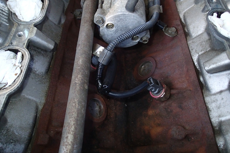

How it looked right before putting everything back together:
