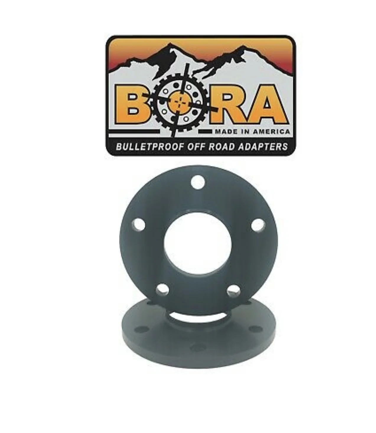

Bora .375” or .5” spacers
Didn't know these existed!? Are they real spacers, used with perhaps longer studs? Rather than the .75", 1", and 1.25" adapters?
Rather than bolt on they just use the vehicles existing lugs. They are however still hub centric.
I would not use those. You should use the 3/4" spacers that look like this.

This is actually a pretty cool option. For a couple reasons. A .375" (~10mm) and .5" (13mm") put stock wheels at pretty optimal offsets for common upsized 33" tires that people run. Netting effectively 50mm off and 47mm offset respectively when used with stock 60mm offset wheels.
It's not by chance that the factory Rock Warrior wheel has a 50mm offset for the recommended 285/70R17 (32.7" diameter) wheels. This is optimal for suspension geometry scrub radius, and will allow larger tire fitments to work and feel most like stock. Without subtle untoward behaviors that compromise handling and traction.
Provided the studs are long enough and engage enough threads on the lug nuts, these may be more desirable than using adapters.
1" spacers are more appropriate for 34-35" tires.
I believe that's the hiccup with using traditional spacers on stock length studs. I know someone had 10mm spacers made up for them and they found they did not get adequate tread engagement because our studs are fairly short. I believe our studs are M14x1.5 (correct me if I'm wrong), which would require 9.5 turns for proper thread engagement. So if someone wants to try, please report back with what you find, but I'd suggest starting small.
Agreed. Does Borla supply or sell longer M14 studs?
Travis said whatever they sent him didn't work, issue with knurling so stud wouldn't seat in the hub properly. So that piece of the puzzle needs to be figured out, I guess. If someone is up for the task, that'd be awesome.
M14 x 2 is a common stud size, but I am not sure if that is he's desired length? That would be approx. 12.5mm longer
Largest selection of extended length metric studs found here. You'll have to figure shipping from Australia.
when you say 3/4" bora spacers work with stock LC wheels, please state the year of the stock LC wheels. They do not fit without stud trimming on 2016+ Base LC rims. I have not tried them with the 08-15 rims.
