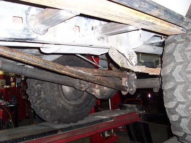

I wonder how much a frame tie in like Kling-on's would reduce force to the body?
Honestly I'm at a point where I have some rust coming through on the bottom of one rocker and I'm weighing fixing it vs cutting it out and going with the slider. I'm leaning to the slider route. It seems pretty straight forward and it going to be tougher then the original rockers.
