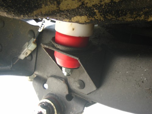

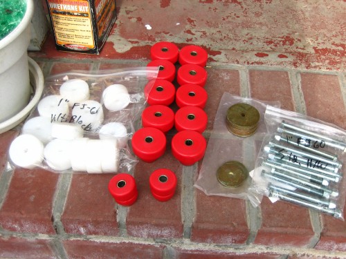

I also did the one inch body lift along with the Poly bushings. Only thing I had to modify was the fan shroud. Here's a few pics of what I got and of what it looks like on.
It is easy to install a body lift. It does take longer than it would seem since is not easy access to all the bolts and the original bolts can be hard to loosen and get out. I think it is worth it to atleast replace the bushing with poly if you plan on keeping it for awhile.
