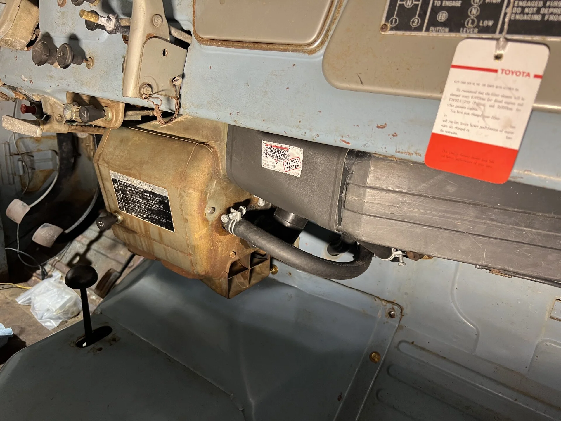

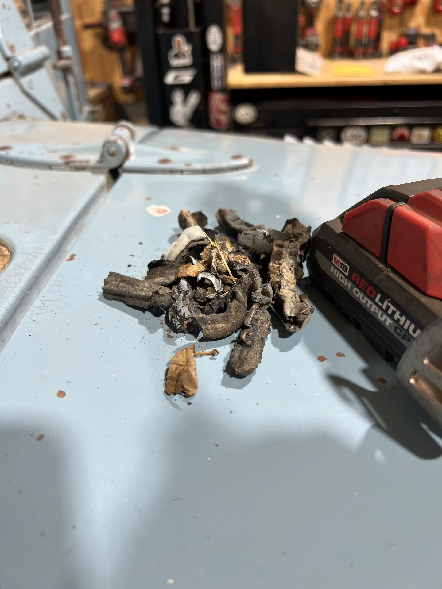

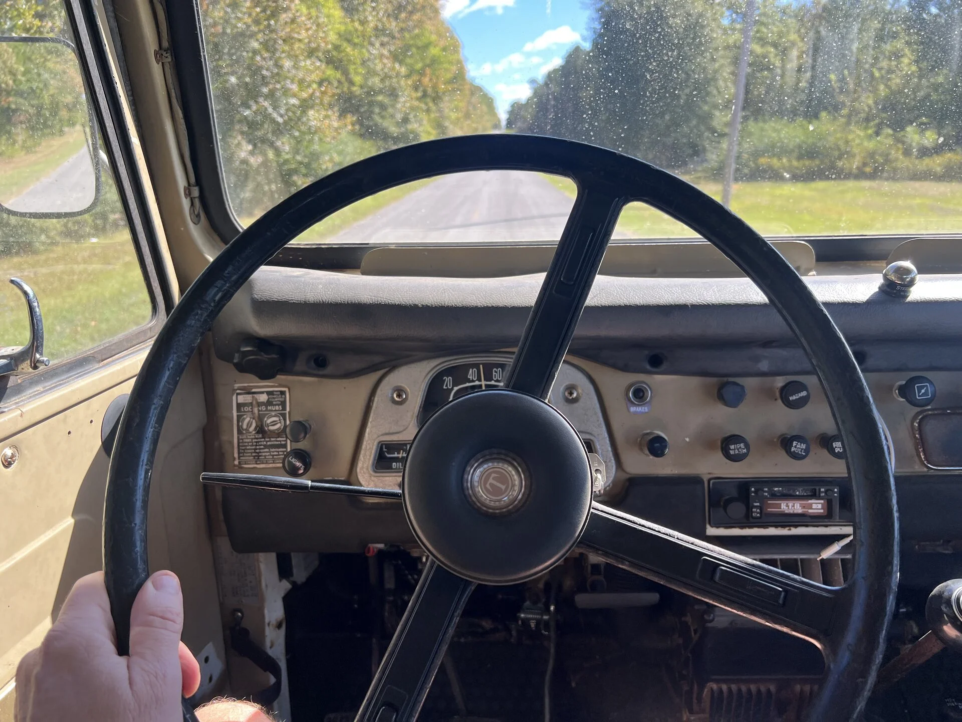

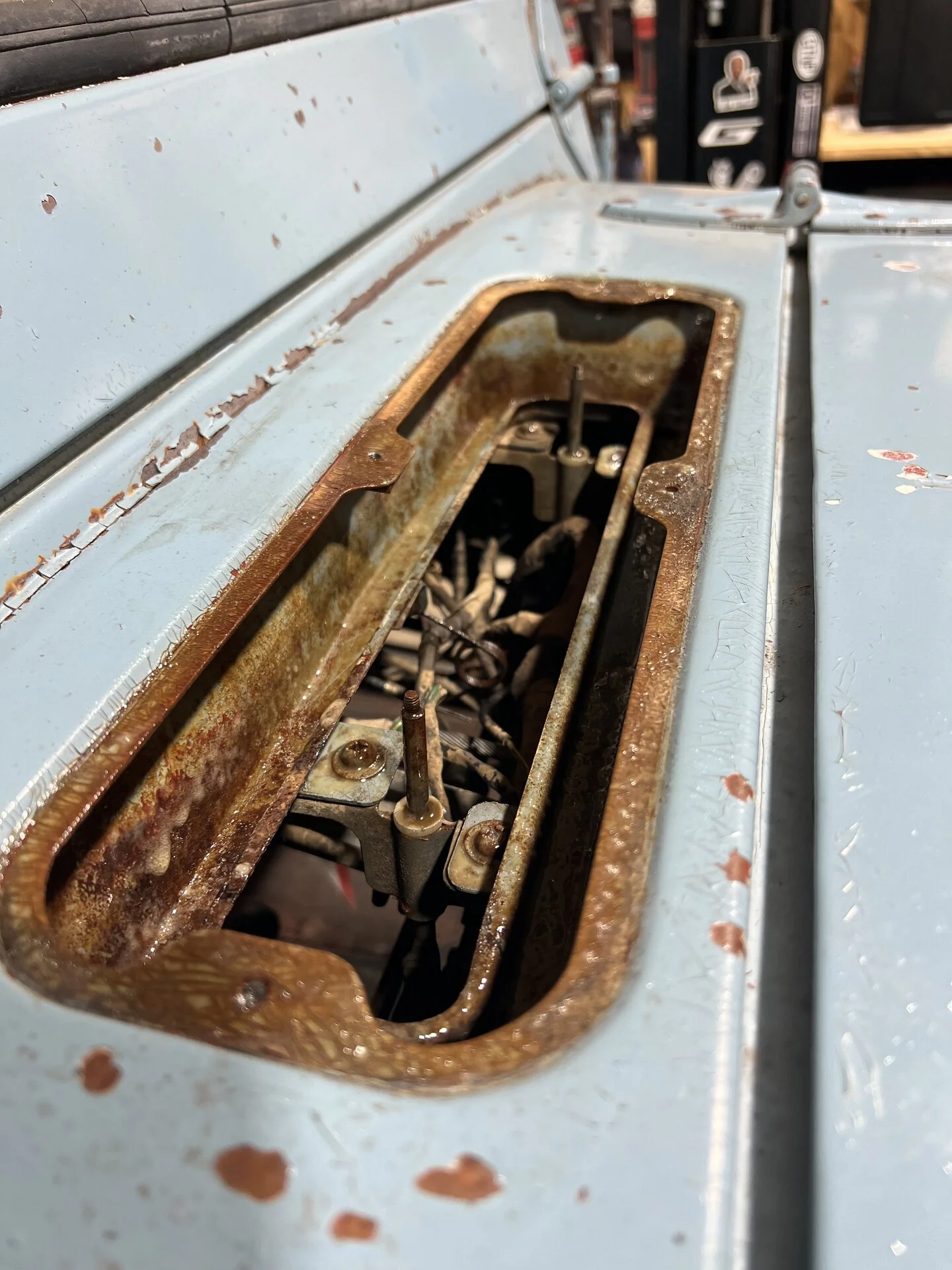

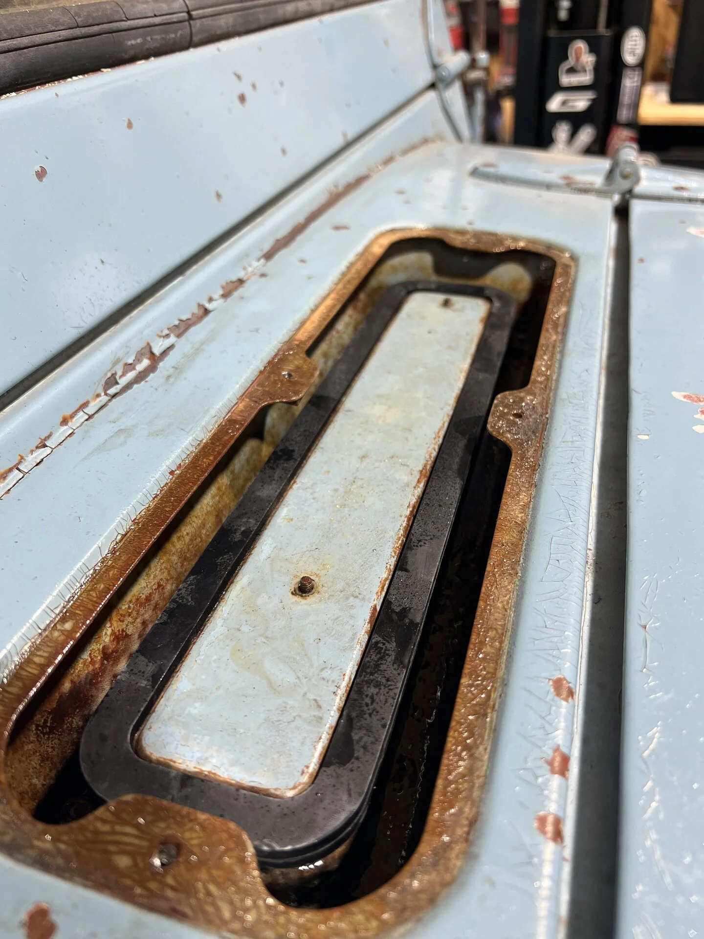

We have a working dash vent now. Snapped 3 of 4 bolts. Cleaned it out. New gasket and hoses via City Racer. Lubed it all up. Forced it free and now it’s working great.

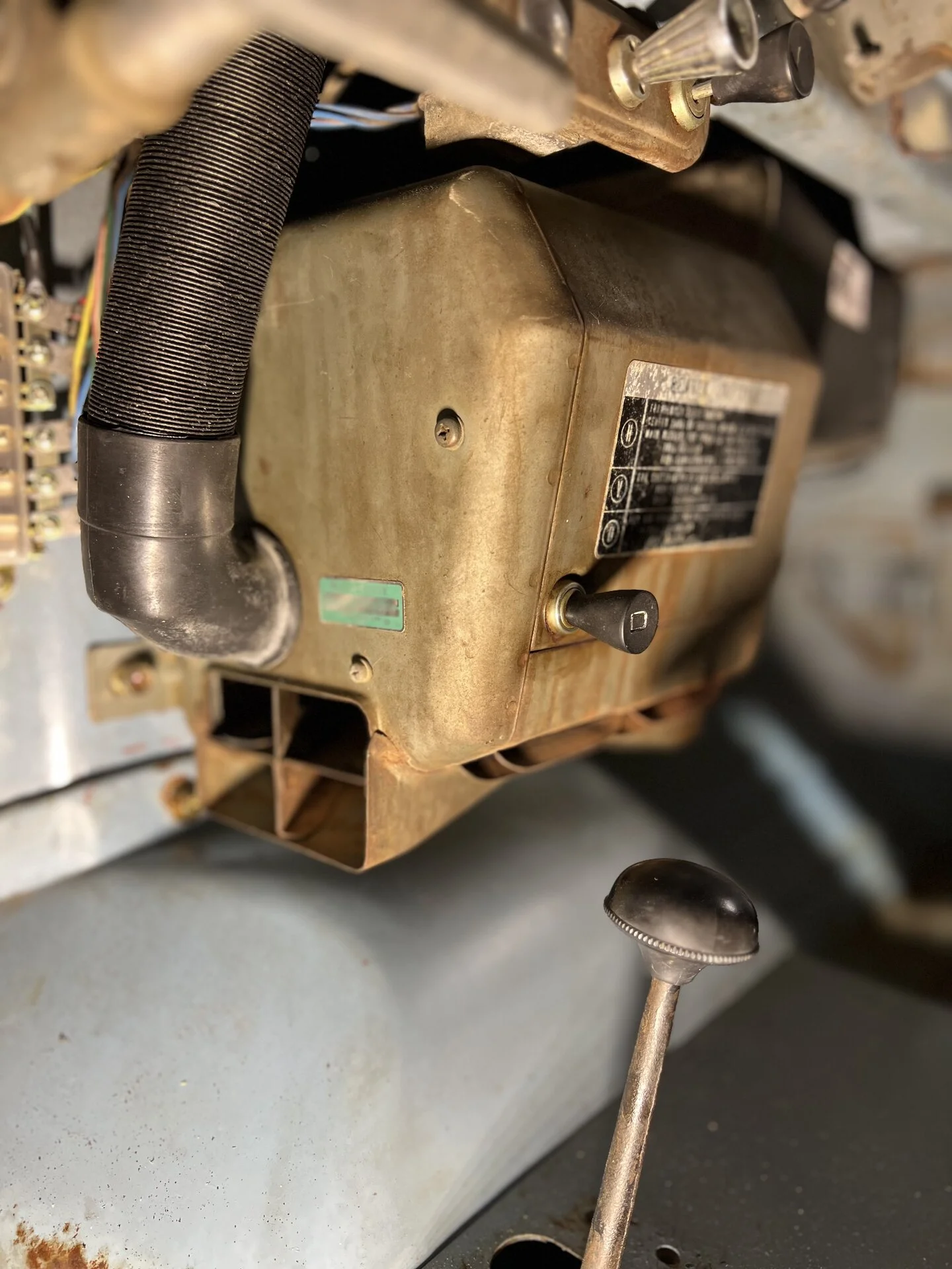

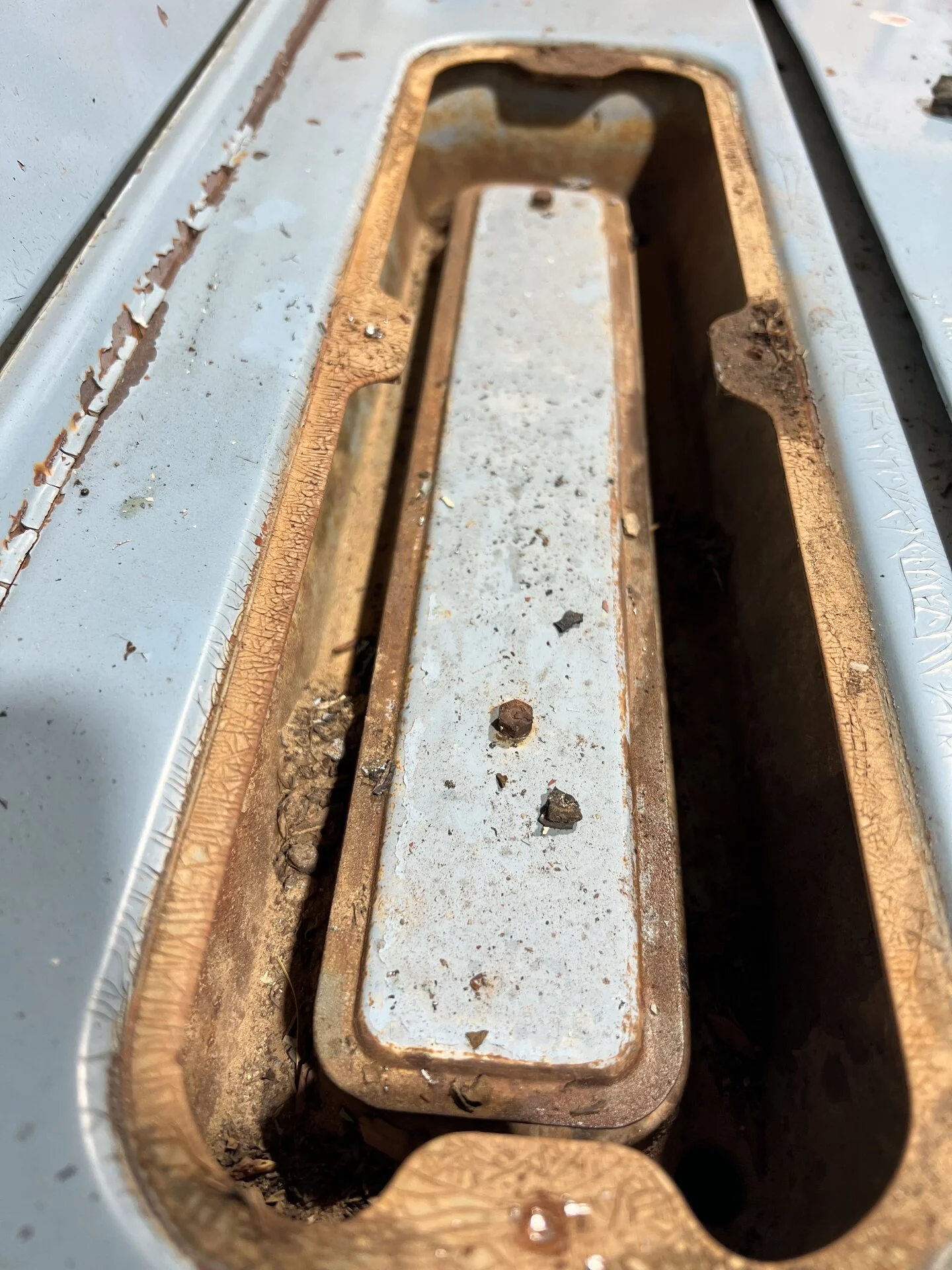

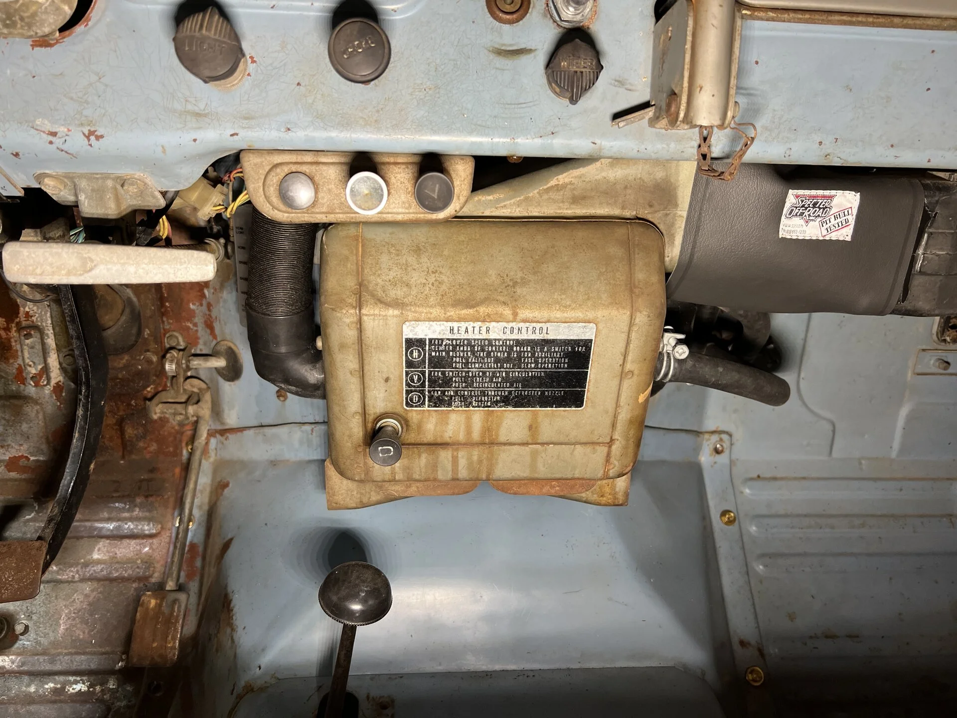

Got the Defrost pull on the heater box freed up and added the SOR defrost elbows and tubes. They are pretty s***ty quality but they look ok from afar. Also wrestled with the heat duct boot until it finally went into place

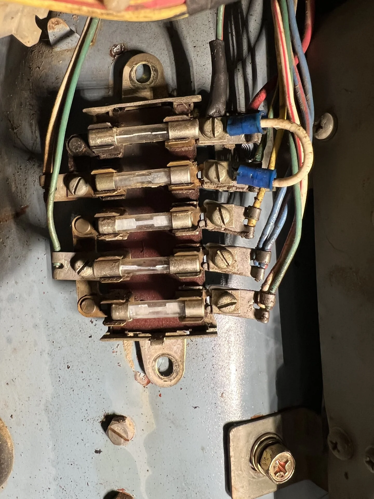

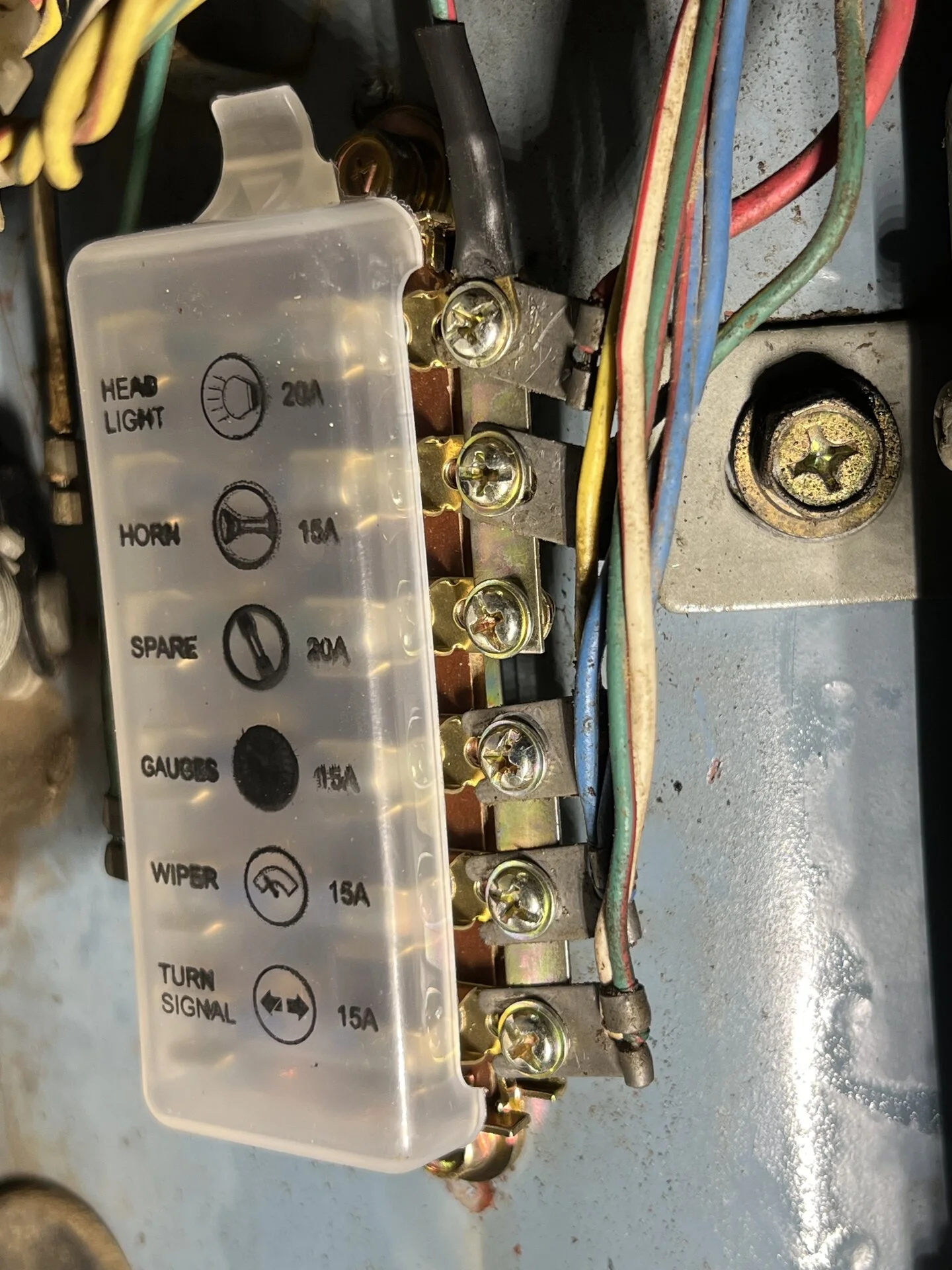

Added a @ToyotaMatt fusebox and cut out all the extra wires

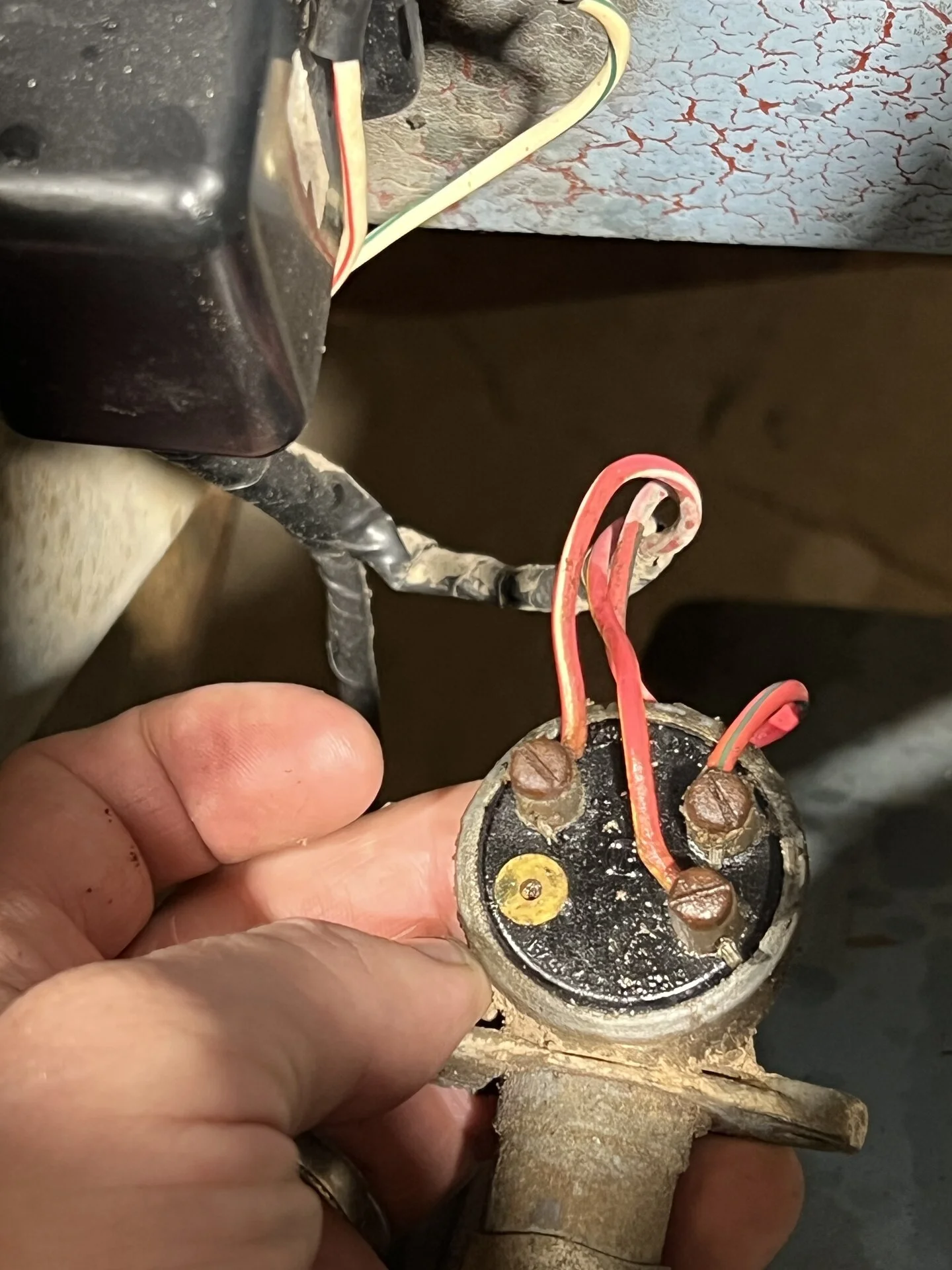

Cleaned up all the contacts and got the heater blower working too.
How’d you do that? Mine’s stuck…
Soaked all the joints in Kroil and then used my hand through the side to push and pull with the other hand pulling and pushing the knob

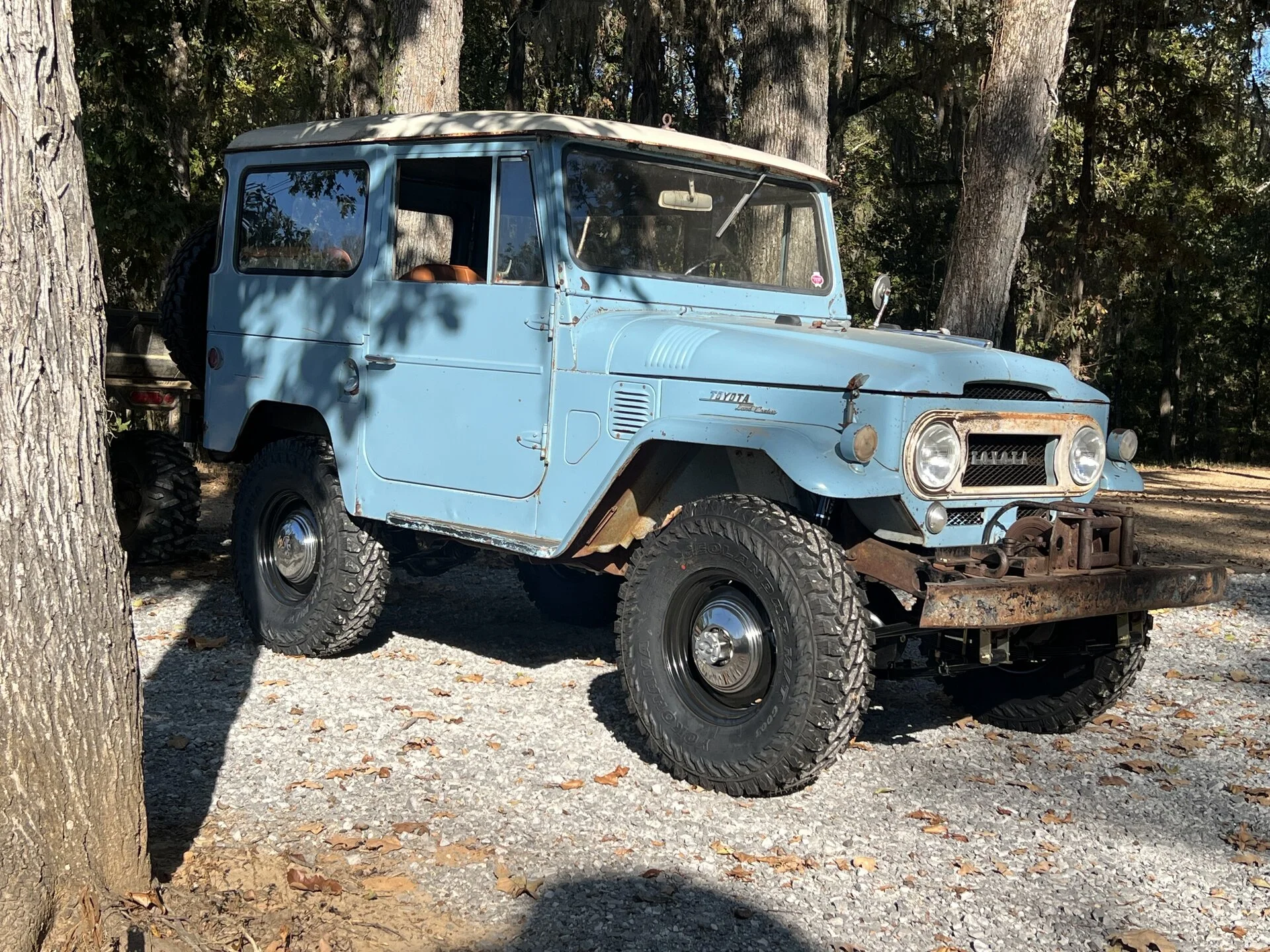

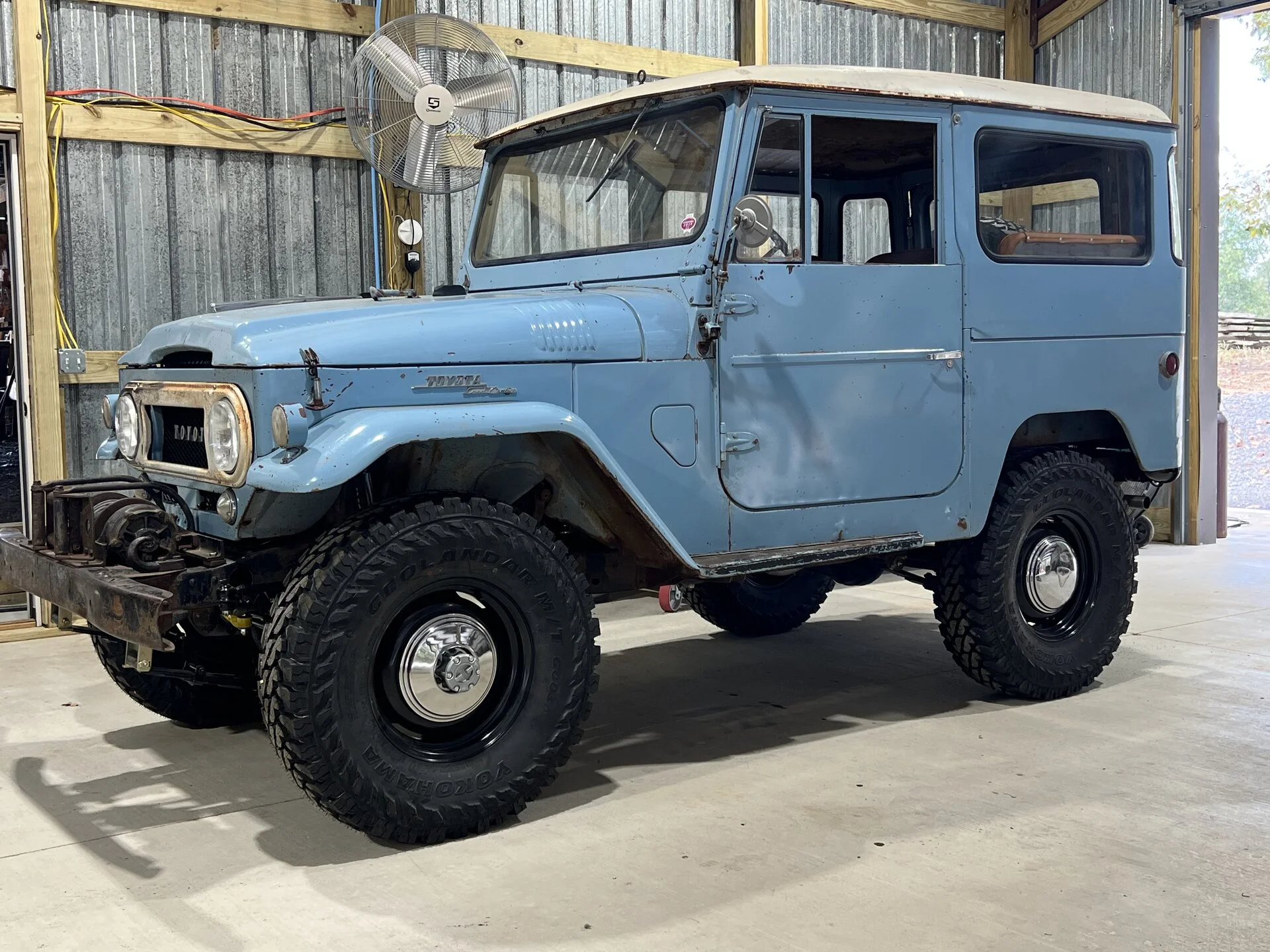

I think this might be my favorite build of yours. Good mix of keeping it old school and adding a few updates and repairs. Hope new owner appreciates it. 👍
This one is cool to me because when I got here in January I basically considered it a parts car and tried to dissuade @Sweet Water from spending money on it.
When he came to visit I actually looked close and saw how unmolested and whole it was and changed my tune
Even a month ago when I started in on it I did not believe it would end up this great

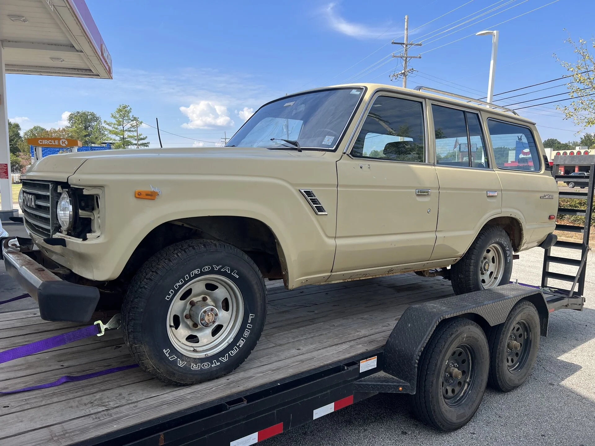

Had to make a pilgrimage to @FJ60Cam and crew’s HQ this morning and then I swung a bit north and grabbed a forlorn FJ60 in need of love

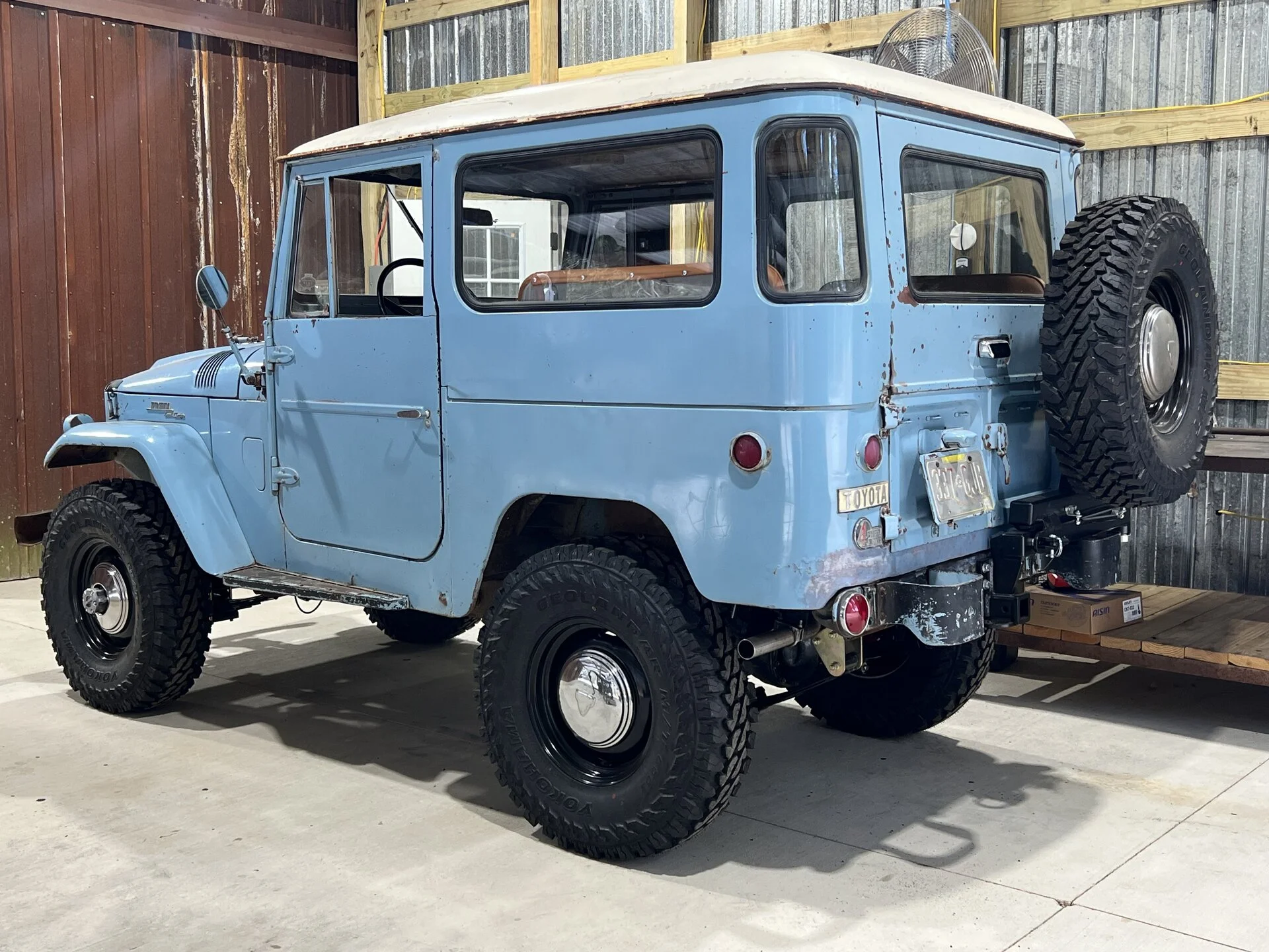

Got home and drug Blue Bird out of the shop. I’m kinda stalled out on it so I’m going to knock out some other projects I’ve been ignoring

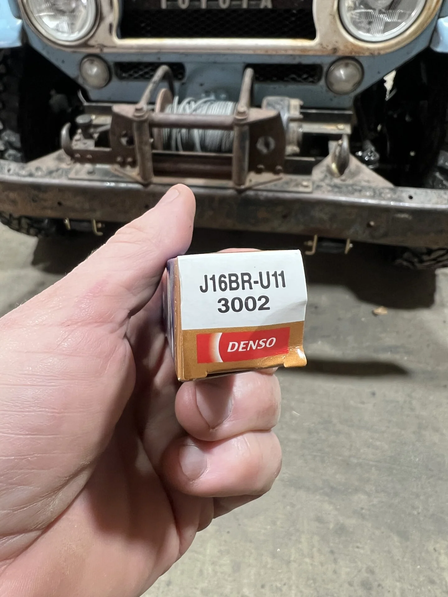

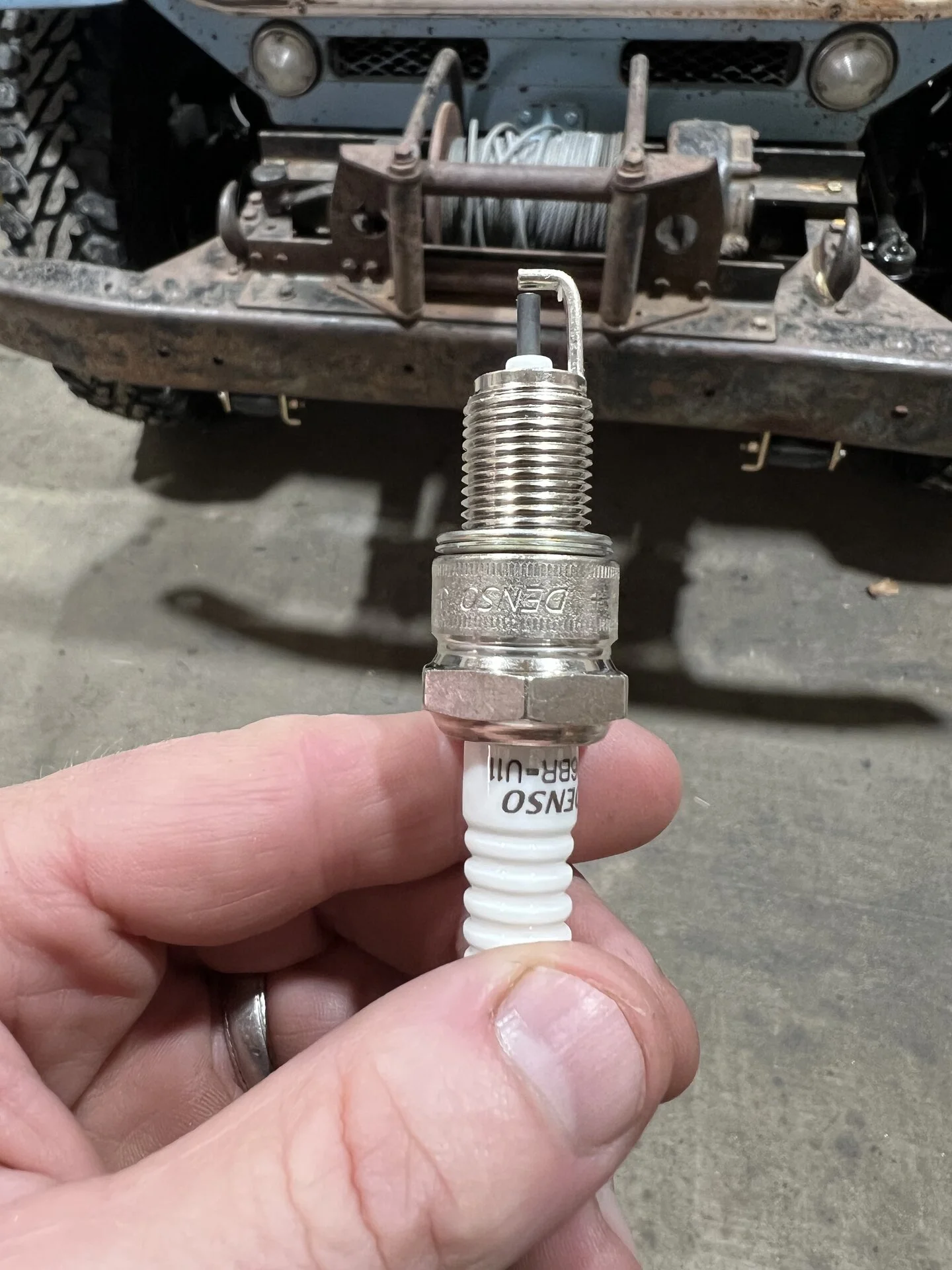

Got the goofball spark plugs in for the F135
