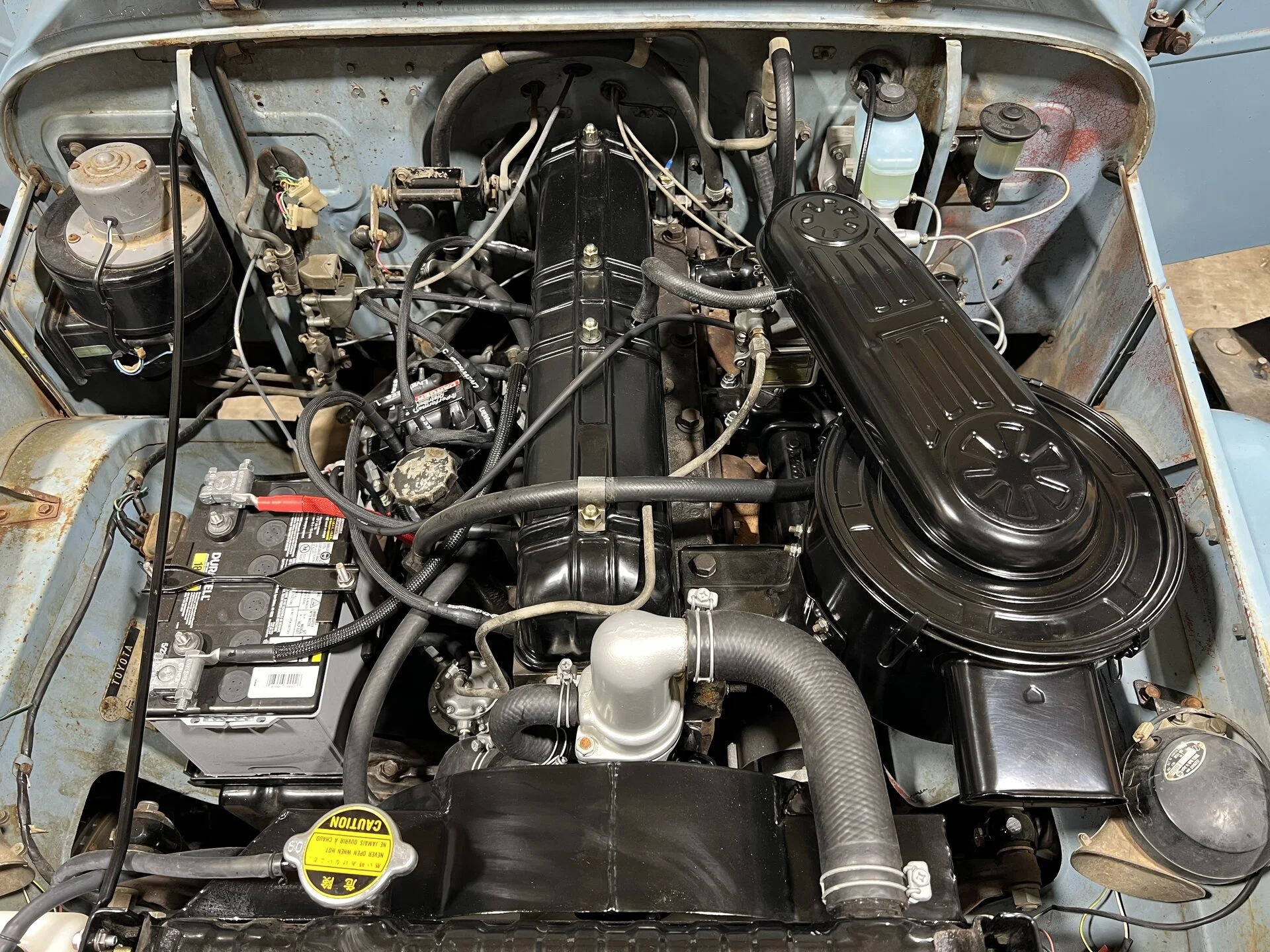

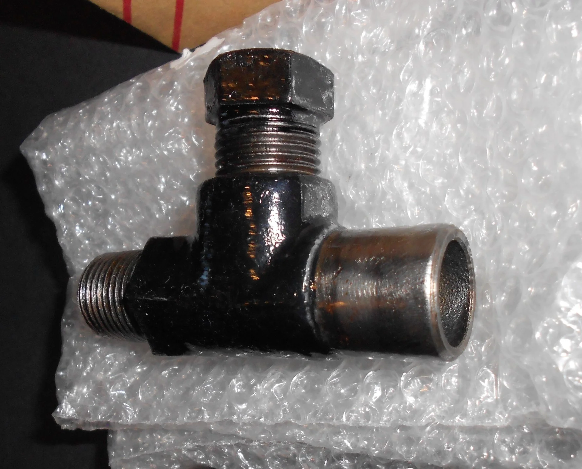

Filled up the coolant and this doodad is leaking. I was scared it was going to hence the JB weld I tried.
The Siamese head does not have but one spot for heater and temp sensor to share.
Bummer. I’m sure these are not easy to find.

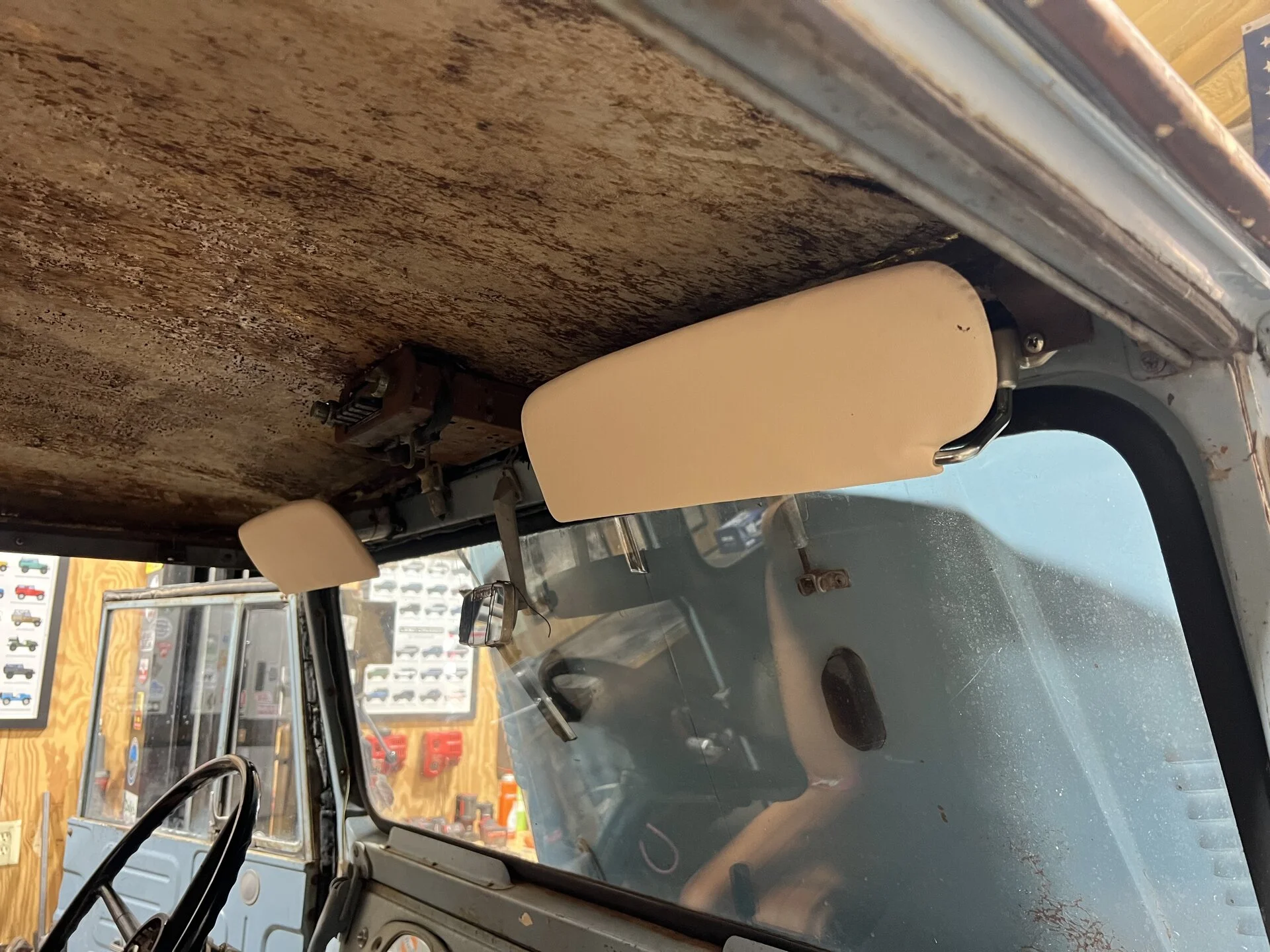

Some new visors

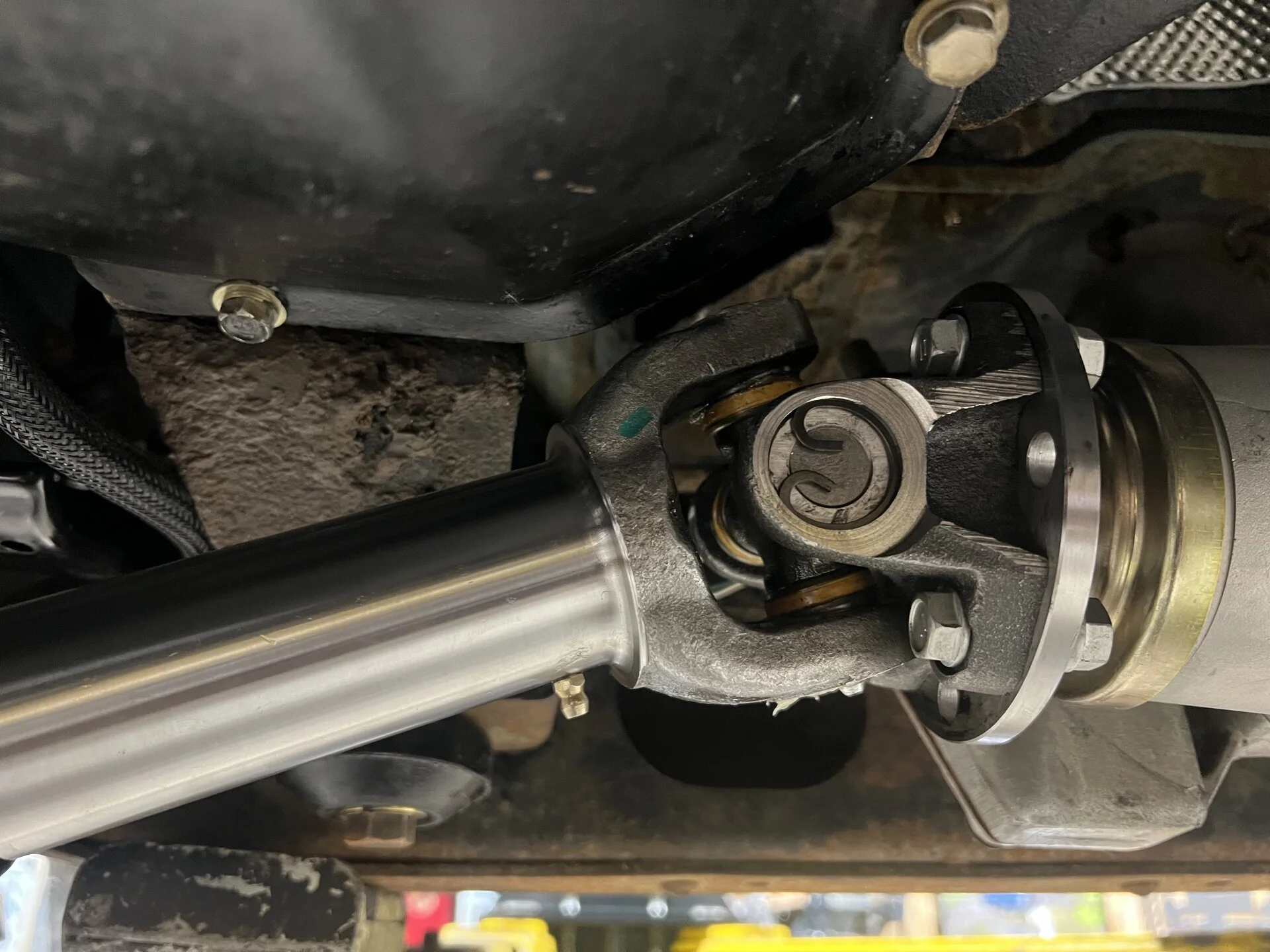

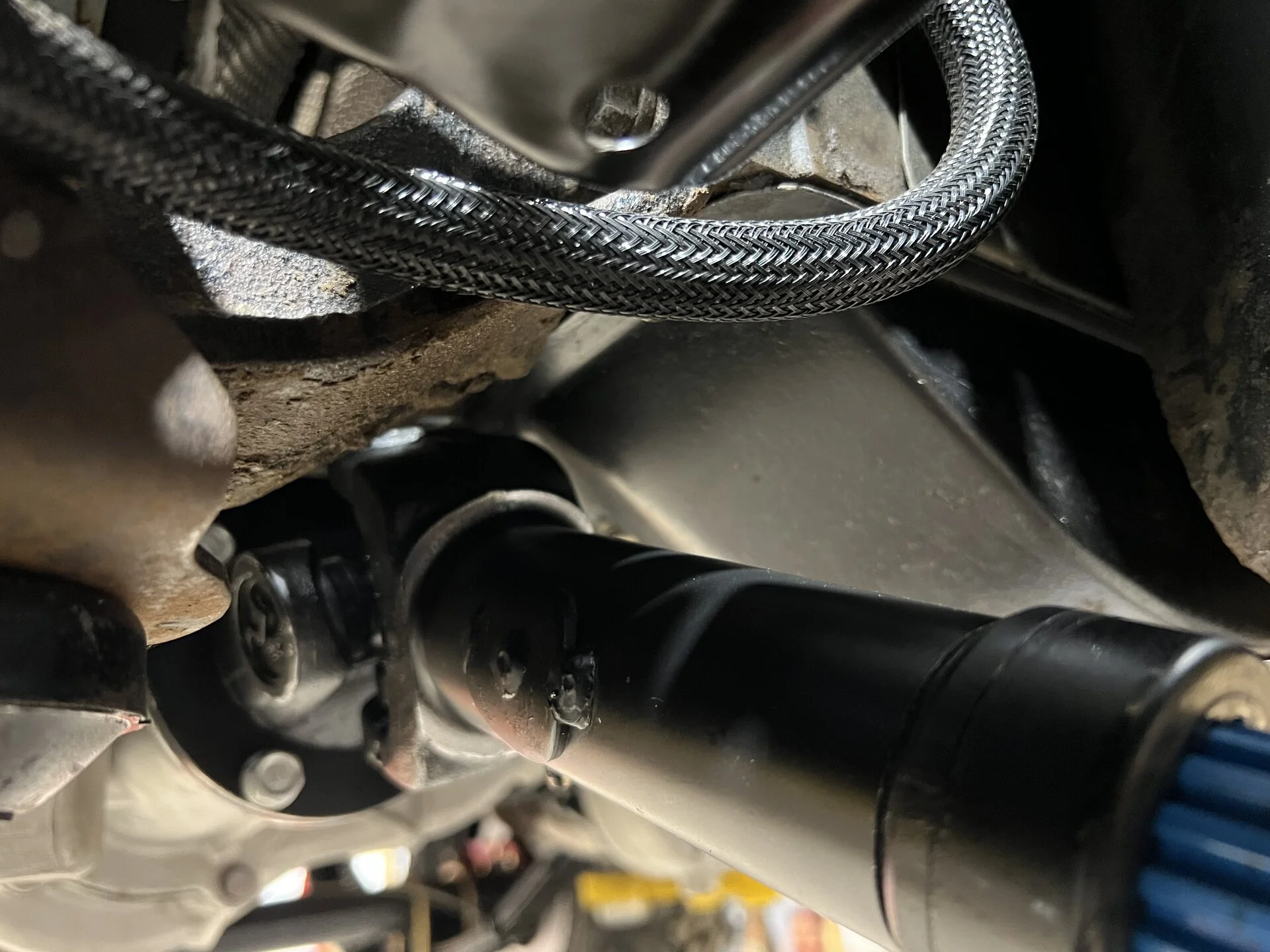

Bolted in the Tom Woods driveshafts.
They bolted up perfectly but for some reason the front Tcase end is hitting the bellhousing.
Same exact setup I used on the Rosie truck. Not sure why. I’ll have to send pics to them Monday to see if they have a smaller slip yoke they can send me

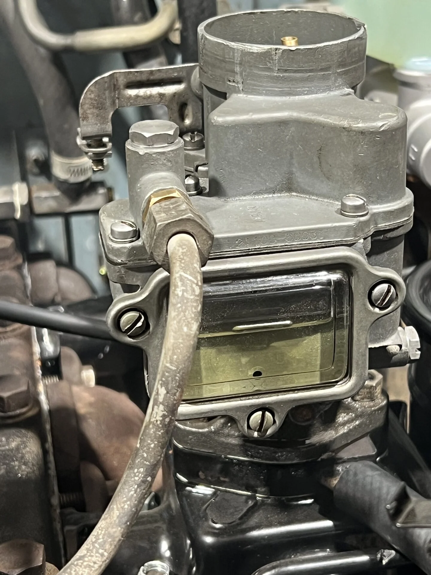

I’ve had a few things I needed to do in prep of the carb arrival so I pulled it in this morning.

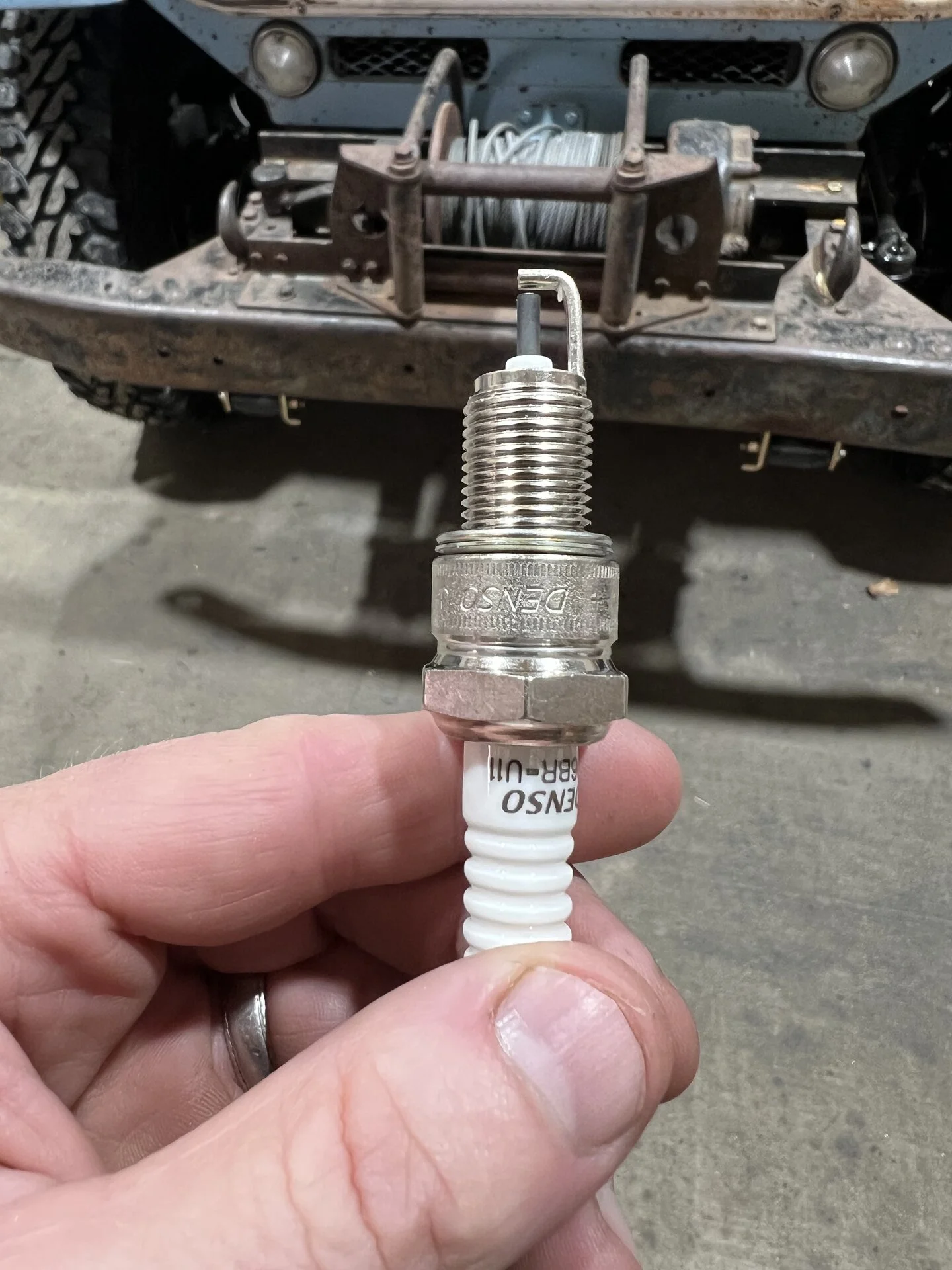

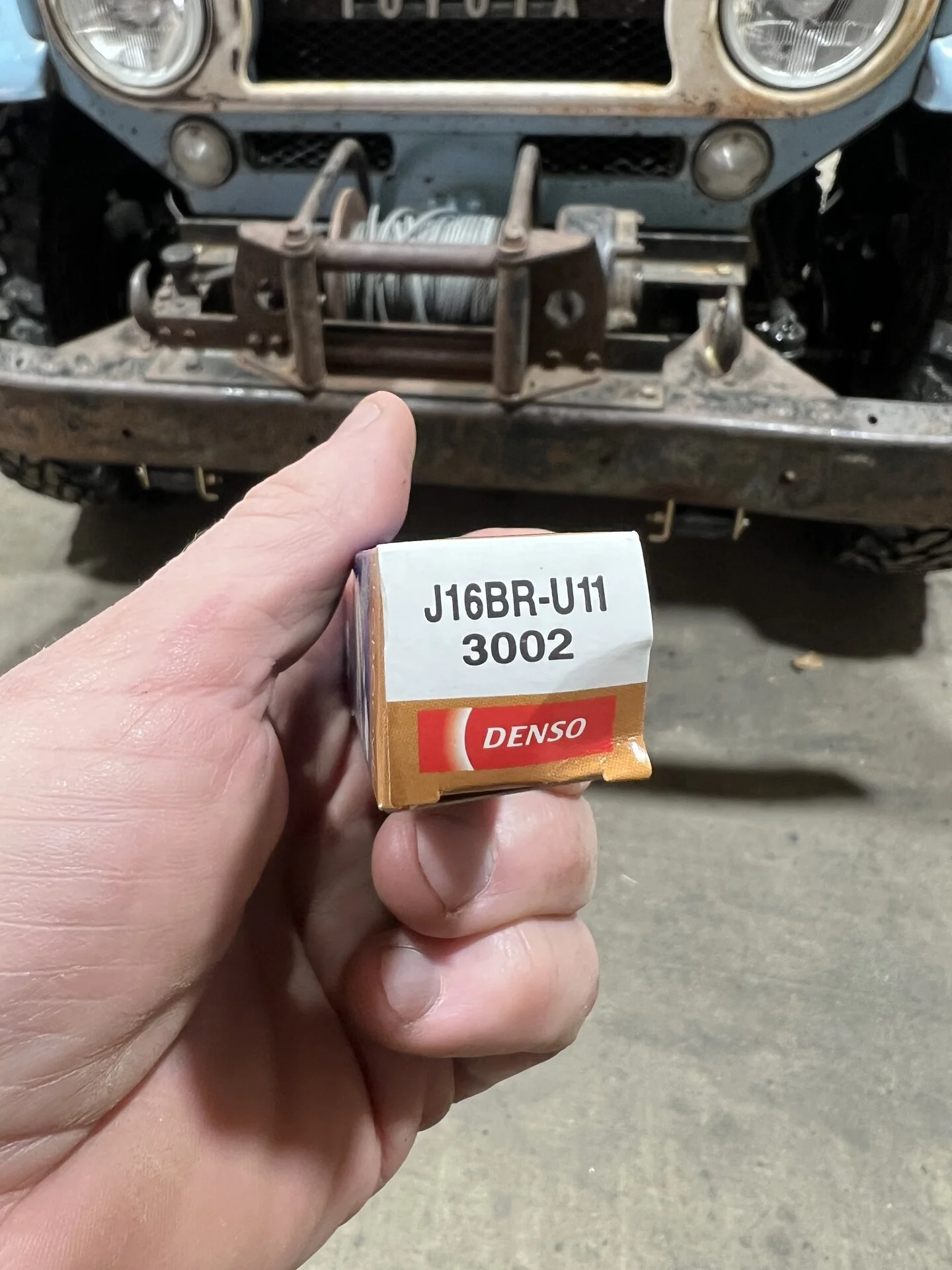

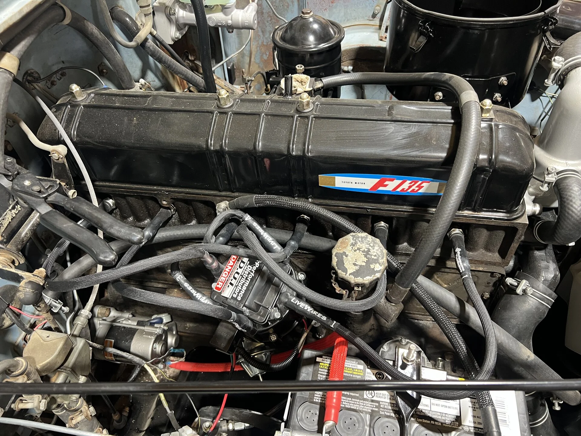

Got the goofball spark plugs in for the F135
I believe the F135 uses 14mm plugs with a short 3/8" thread reach. Current NGK part number is B6S / 3510. Denso Part number from the owner's manual is W14. These seem to work very well in my 135 powered '64 -

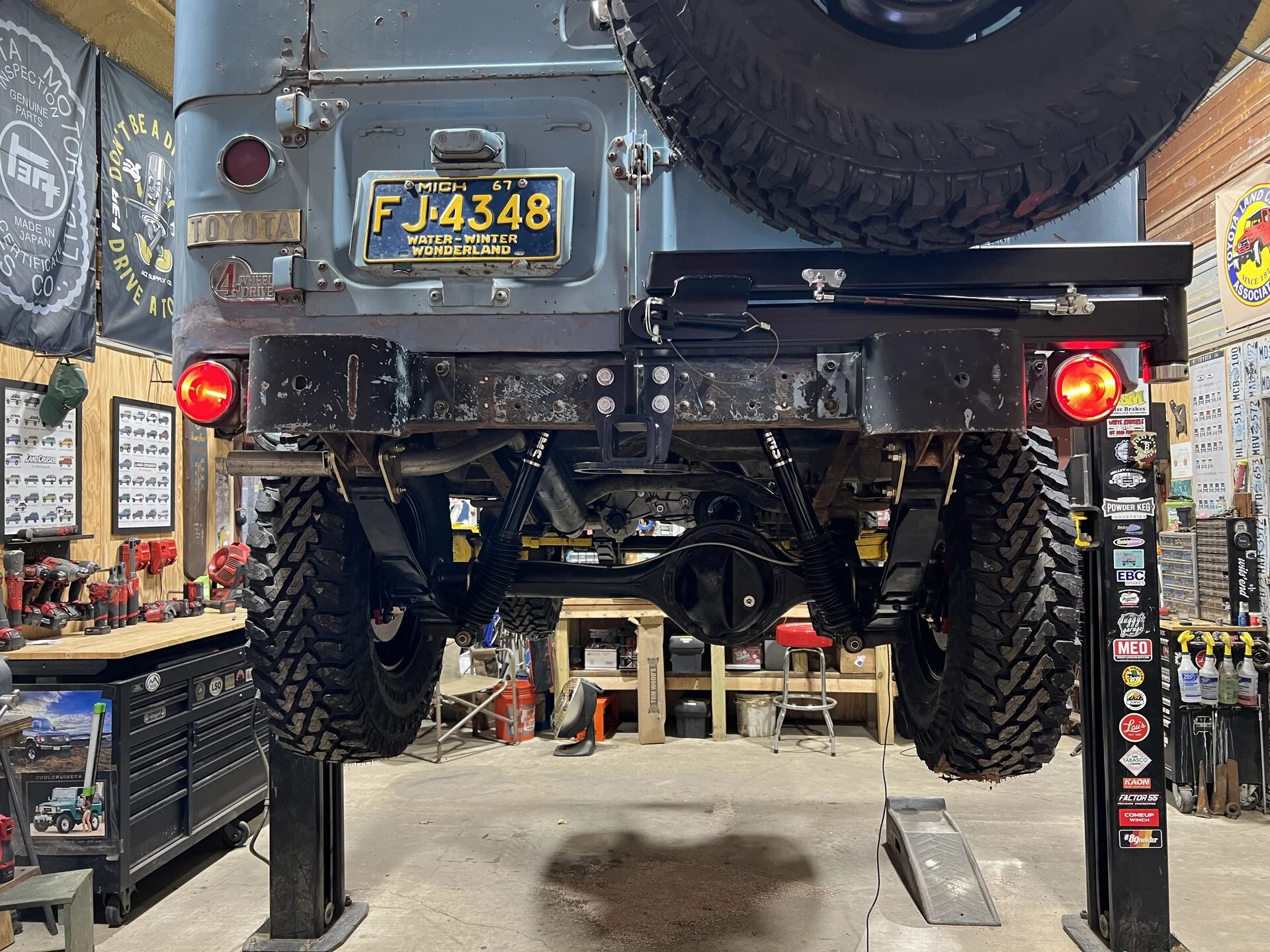

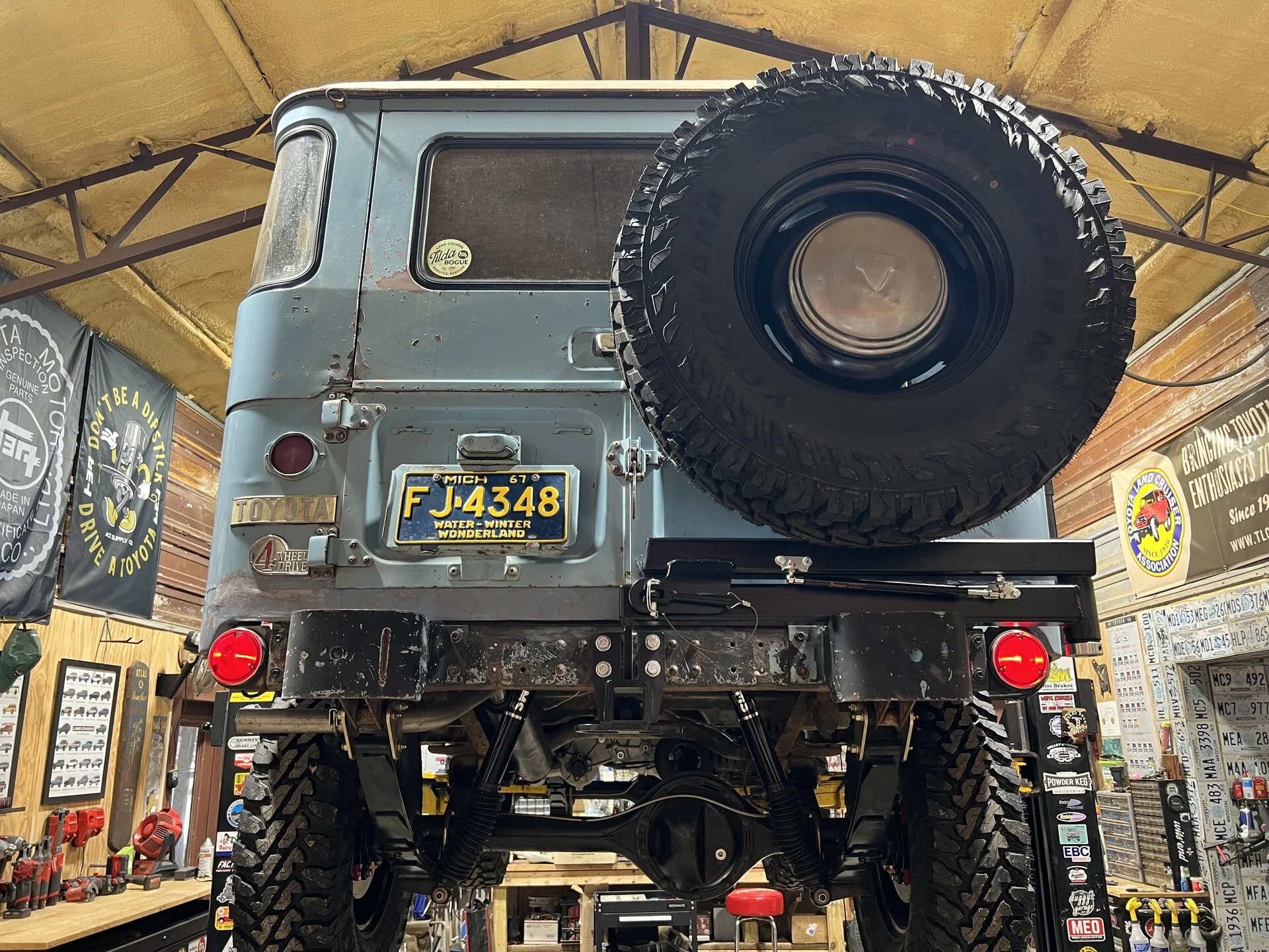

Got my tail lights working.
Brake lights

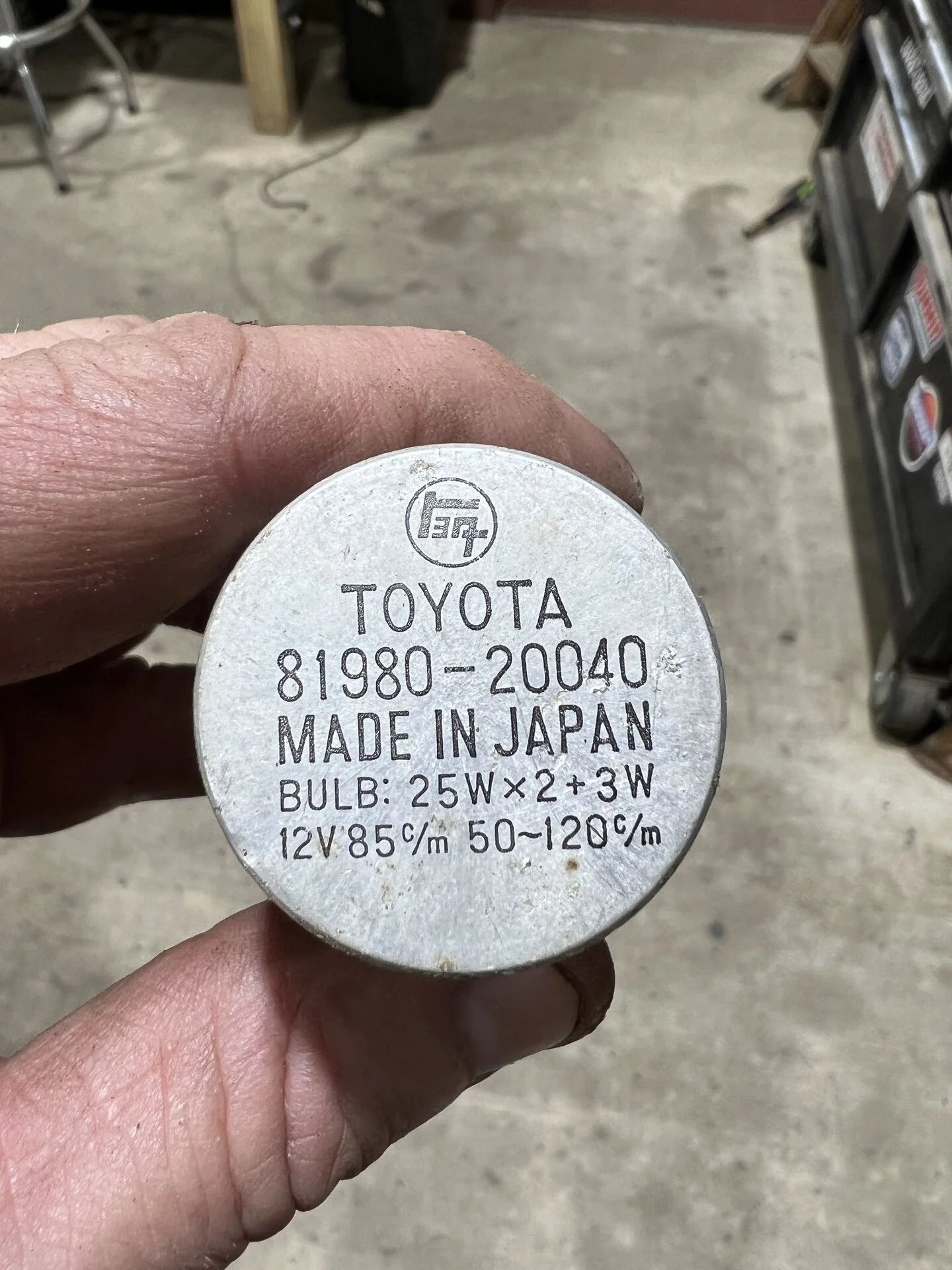

This harness has two relays for blinker. The one on the drivers side works and the flashers all work. The one on the passenger side buzzes and won’t run the blinkers. Gotta email Coolerman

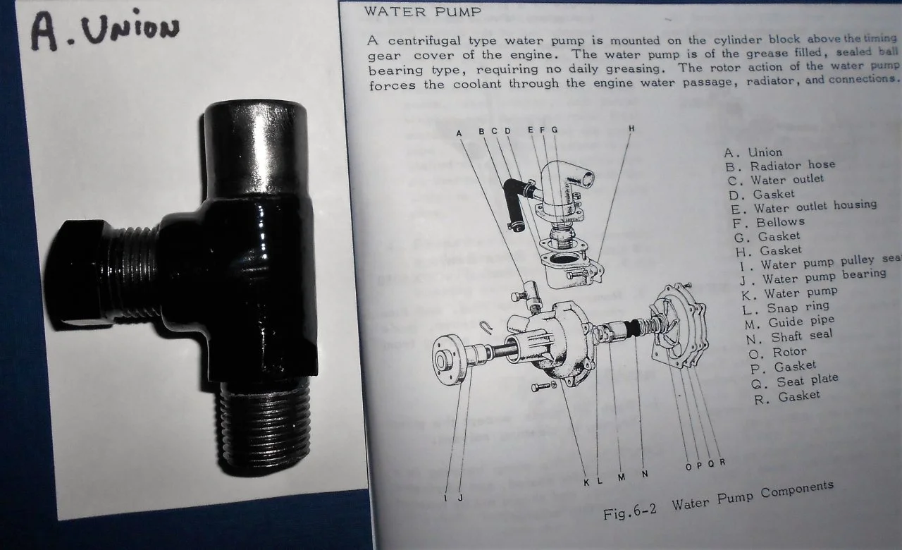

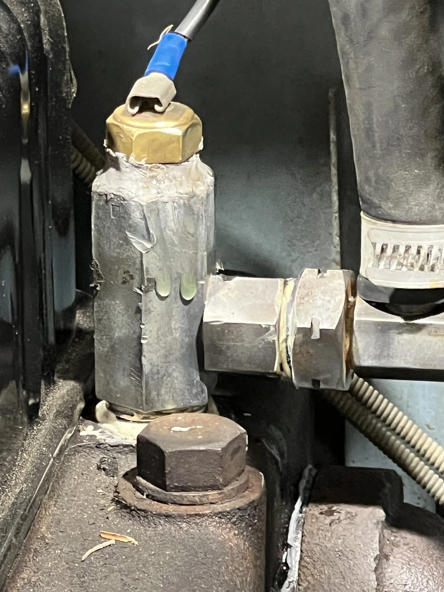

That looks like the “union” (figure A) from an FJ25 Water pump.
Brake lights
View attachment 3473035View attachment 3473036
I struggled with mine, installed a new flasher, still nothing. Checked bulbs, grounds. Finally realized my turn signal/brake and running light leads were swapped at one light. Corrected that and all is well. My old flasher is probably fine 😬

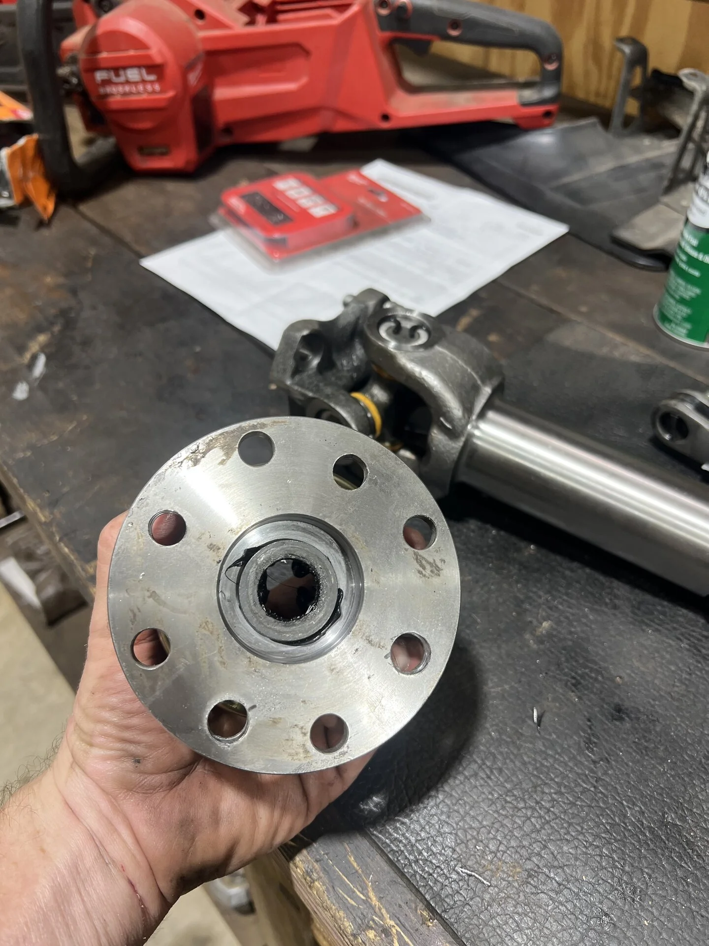

First thing first. Got the front shaft sorted. Had to get a 60x60 slip yoke and drill the flange since they don’t make that size in 10 spline.

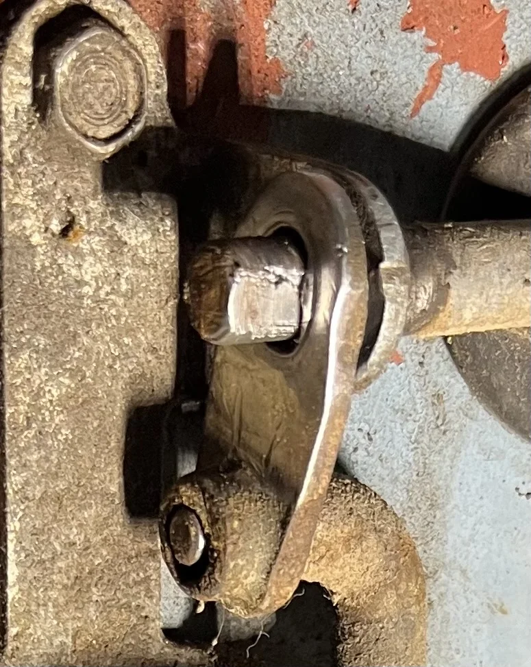

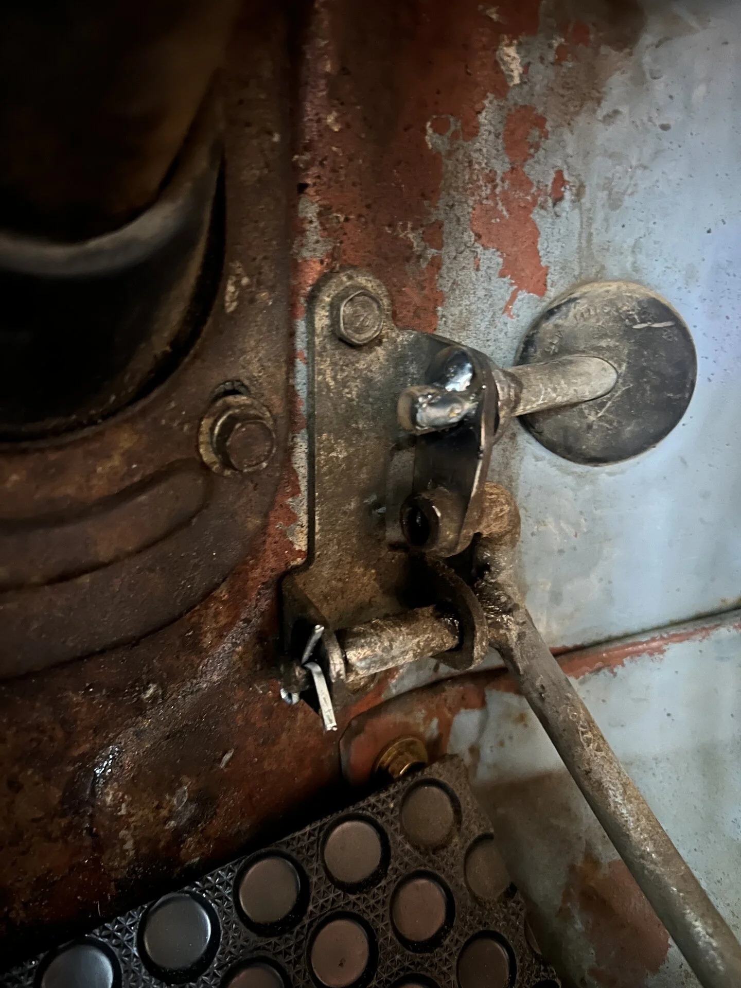

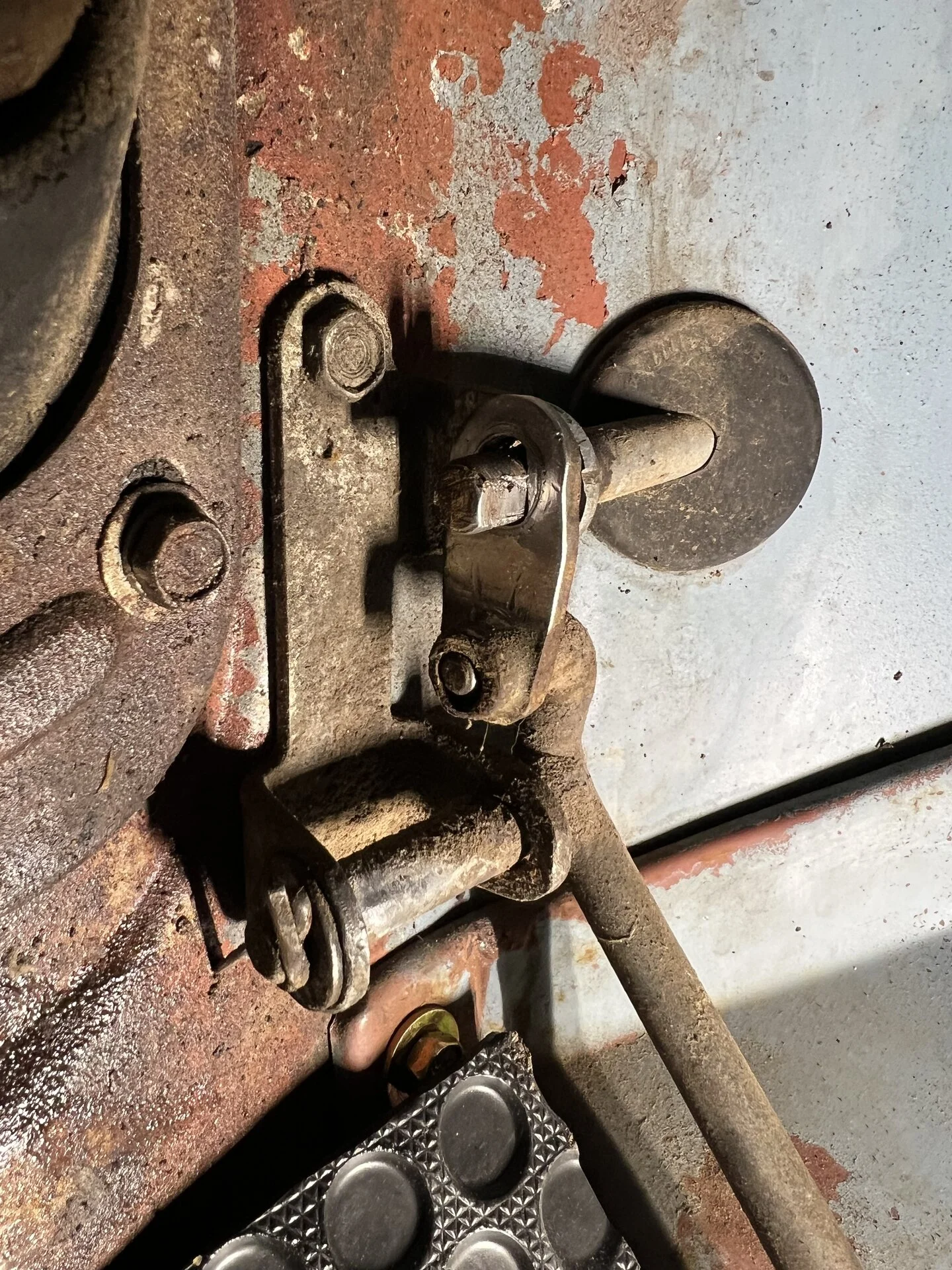

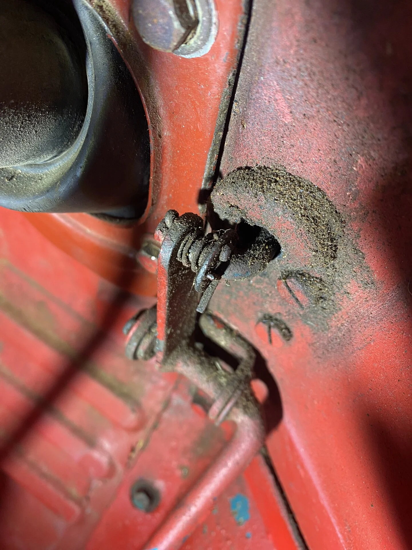

The pedal linkage on this thing is in bad shape. I tack welded these two together then the pedal “cammed” over and locked in place.
I really don’t know what this was supposed to look like but it’s got no threads and the groove that goes on the pin from the firewall is egged out.
Need to take a break and maybe tomorrow it will make more sense

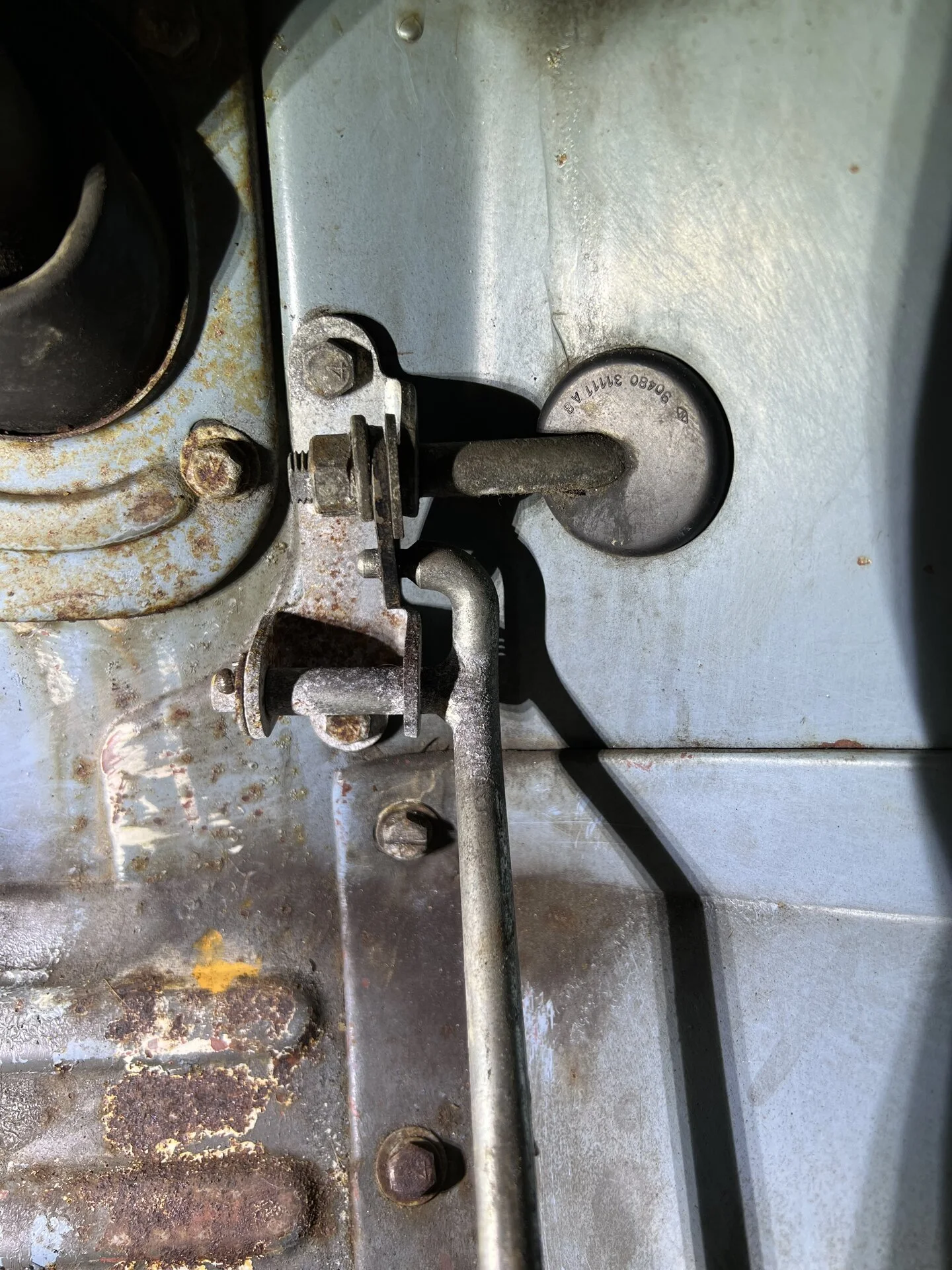

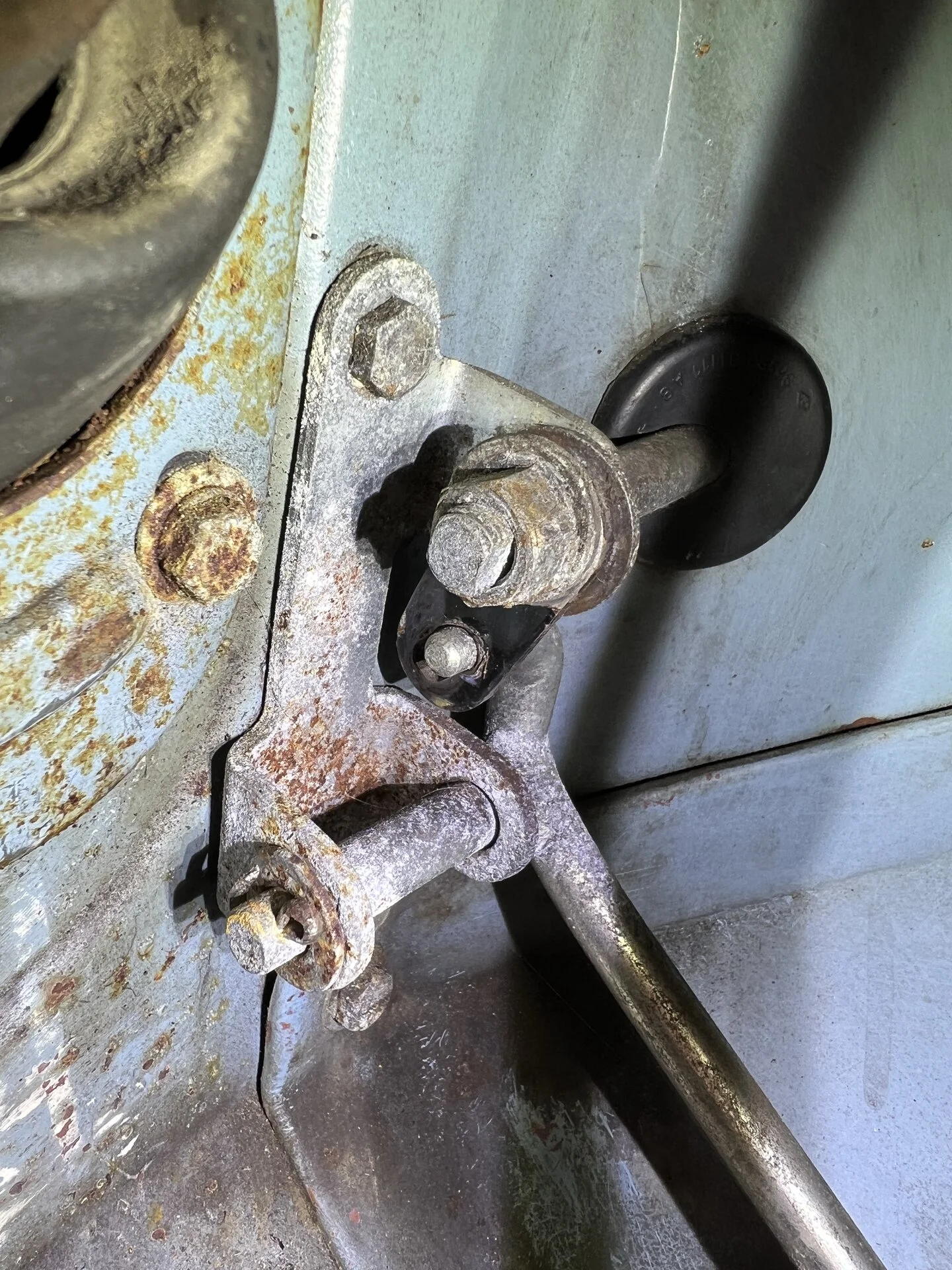

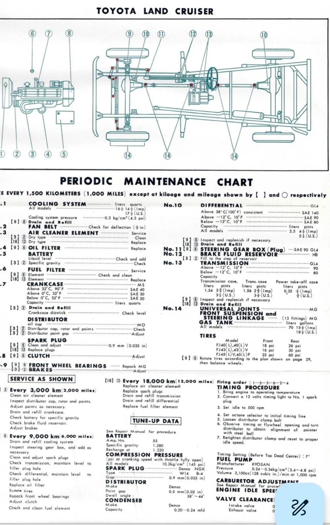

I can snap a pic of my 65’s linkages in a bit if that would be helpful. We also have some good parts diagrams on the CC literature page.
I did some searching. Seems that piece gets egged out.
It’s also different on this 67 fj40 than it was on the 67 fj45 I built for his dad because I removed all of that stuff and it’s different.
Just gonna have to figure out the right arc and weld it.
Hope this helps.

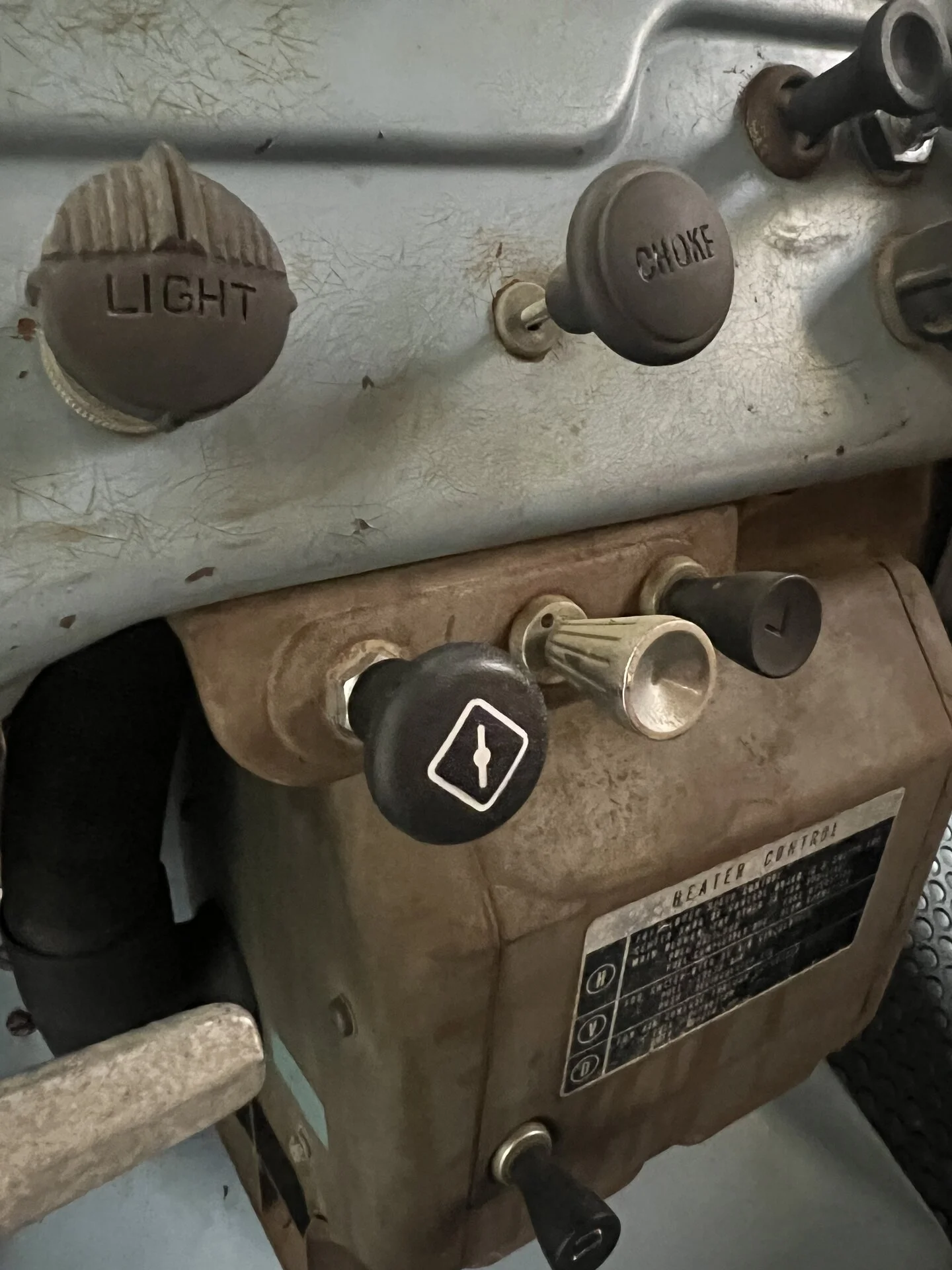

Both the hand throttle and choke cables were hopelessly frozen so I got a generic choke cable from Vintage TEQ
@thecrazygreek made us a proper FD knob. Thank you sir!

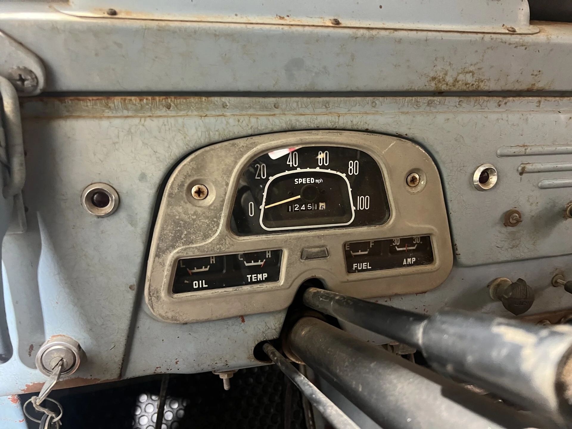

I found a used speedo to fit in the original cluster. All of the gauges seem to work. Fingers crossed there.

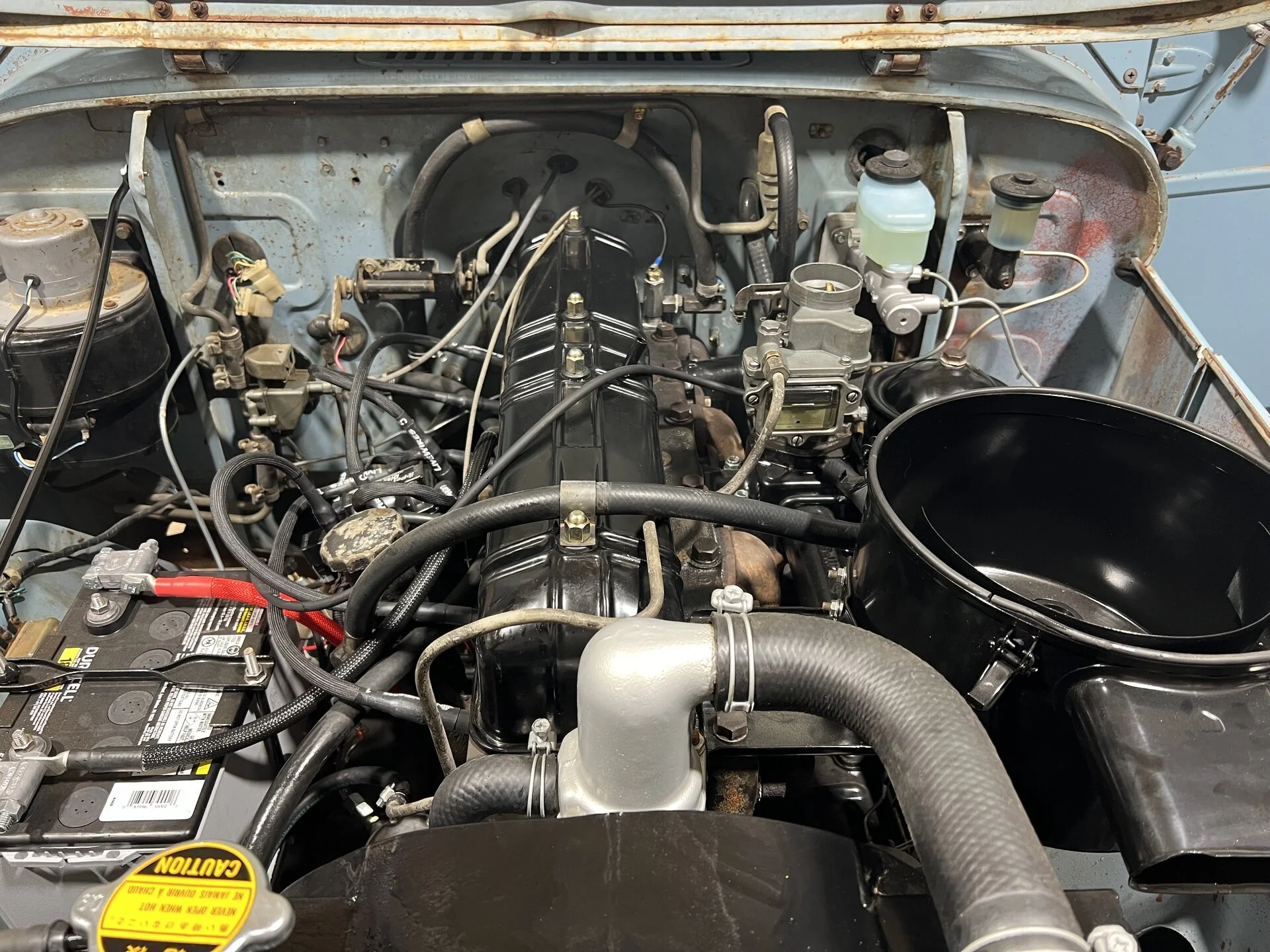

Got the timing set. I’m about to take it for a test run. Wish me luck.
