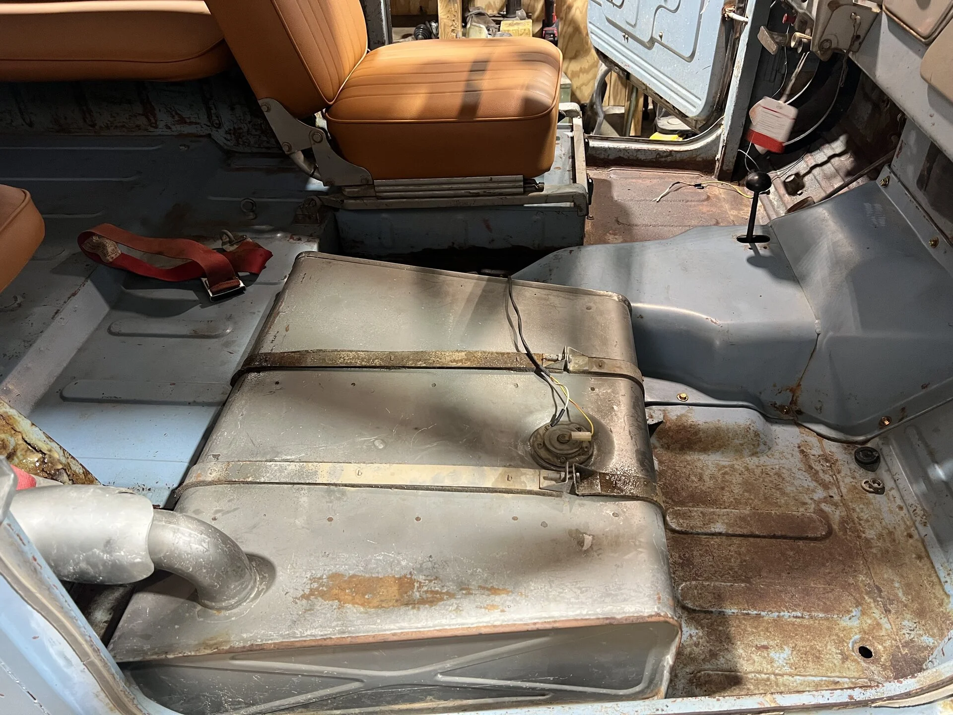

Got the interior built back in. It’s amazing how rust free this cockpit is.

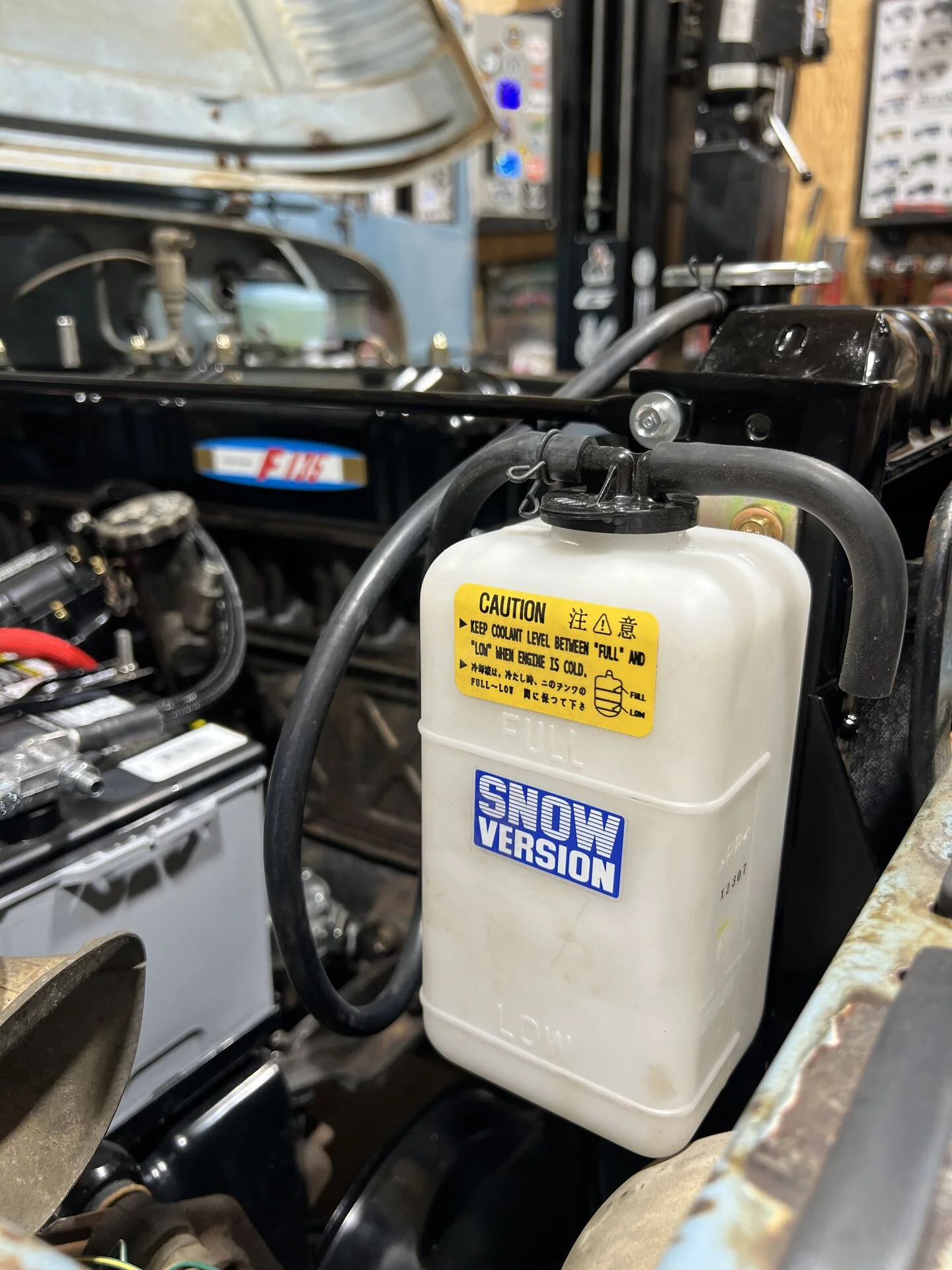

Overflow mounted

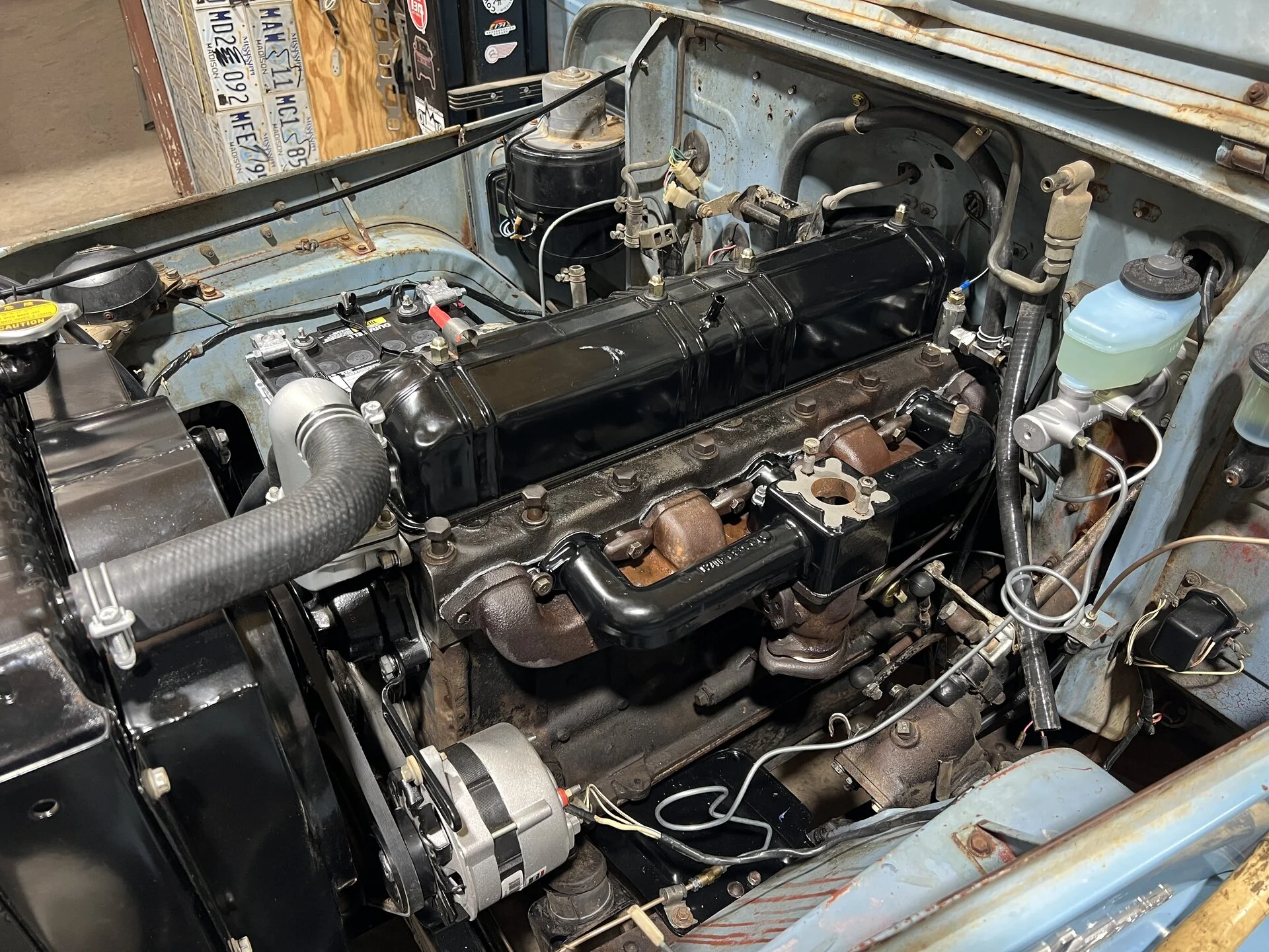

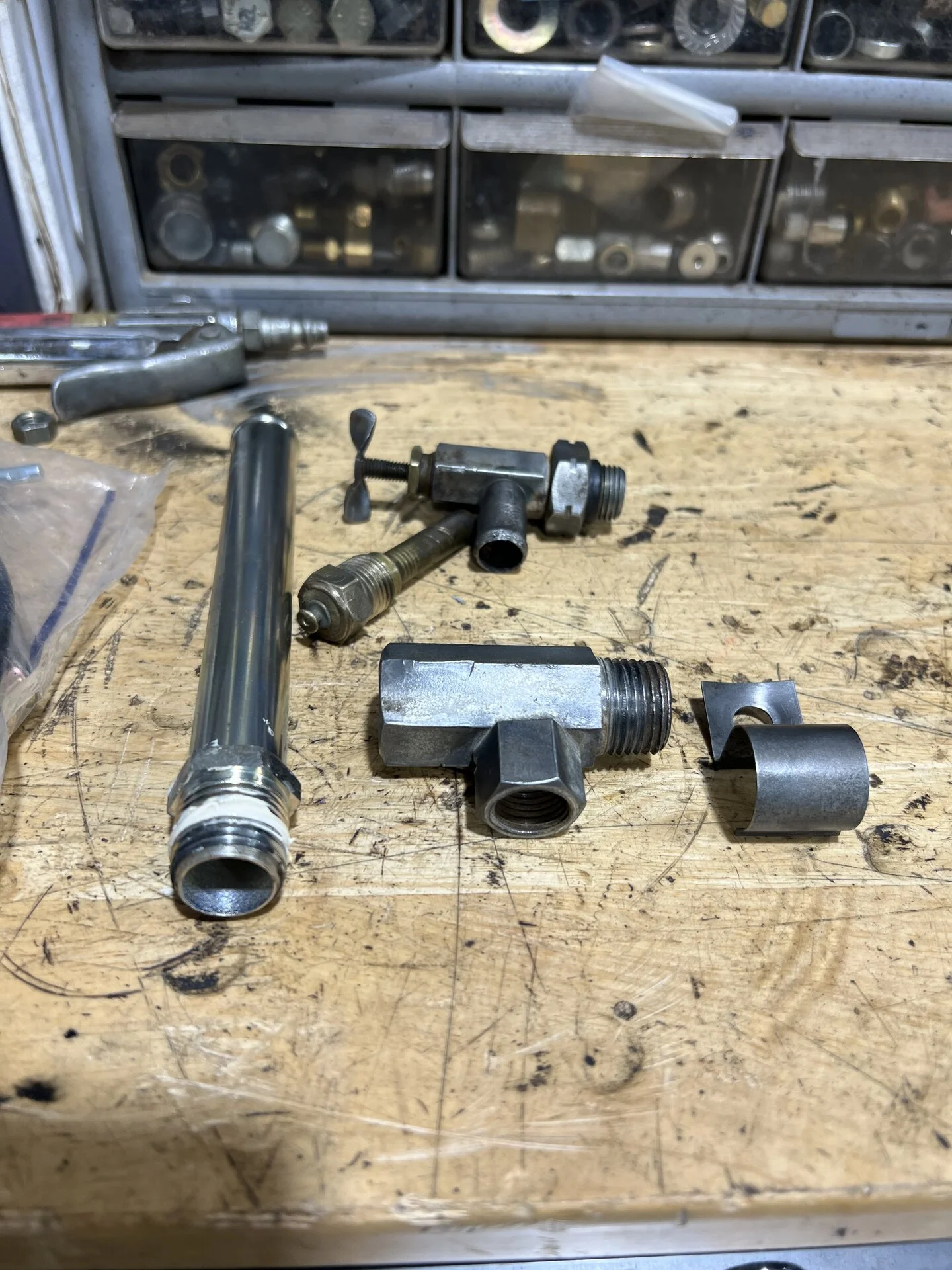

Realized that there is only one port in this head so I had to go get this old coolant tube that had a temp sensor in the top. I got the valve soaked last night and it works now.

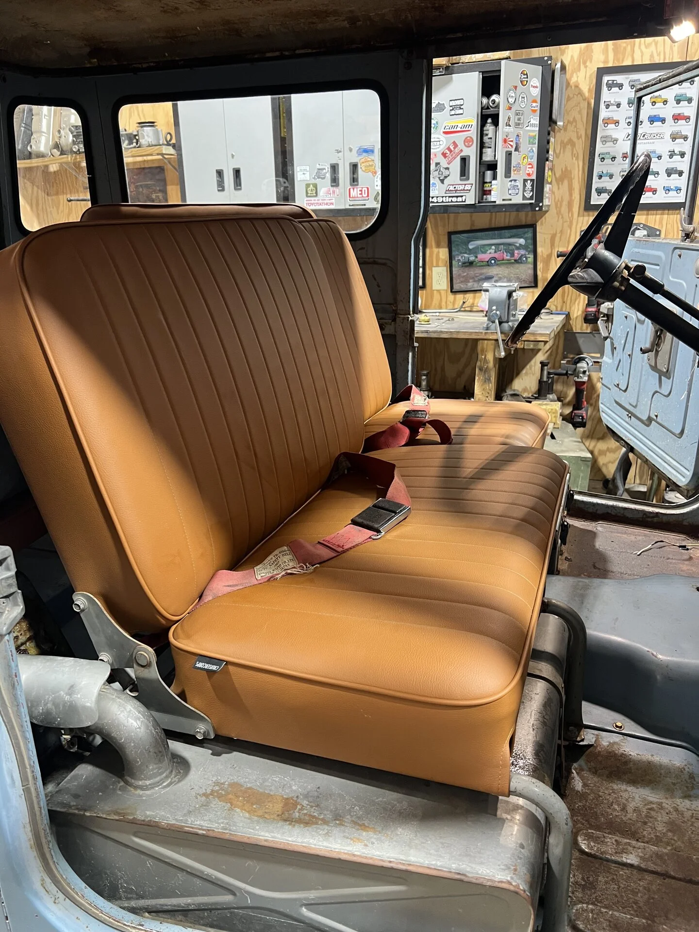

Can you give an idea of how much $$$ it takes, minus your effort of removing and putting everything back together, to get your bench/jump seats looking so svelt? I know you have someone local to you that does your upholstery so all things may not be the same, but a ballpark would be helpful... about to do the same thing is why I'm asking... Cheers and it looks fantastic
My guy charged me $600 in labor and they provided the foam. Covers were cruiser corps.
I did not have to paint the frames because they were in amazingly great shape
That’s a sweet deal. Foam from cruise corp for the jump seats alone will run you $180 plus shipping.

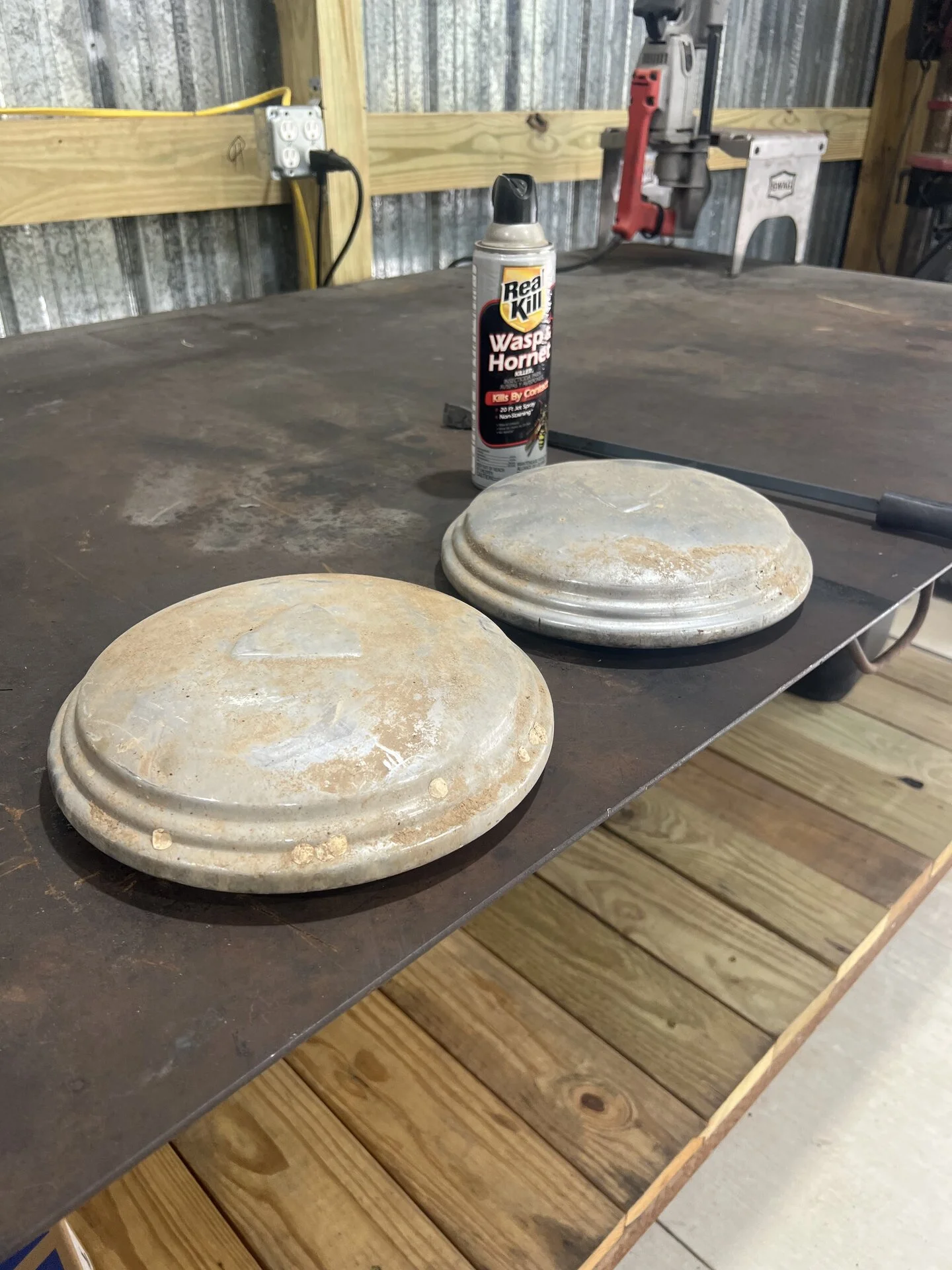

I was about to clean up and install the used acorns that came with the truck when I realized the ones on my trailer are better so I went out to swap them.

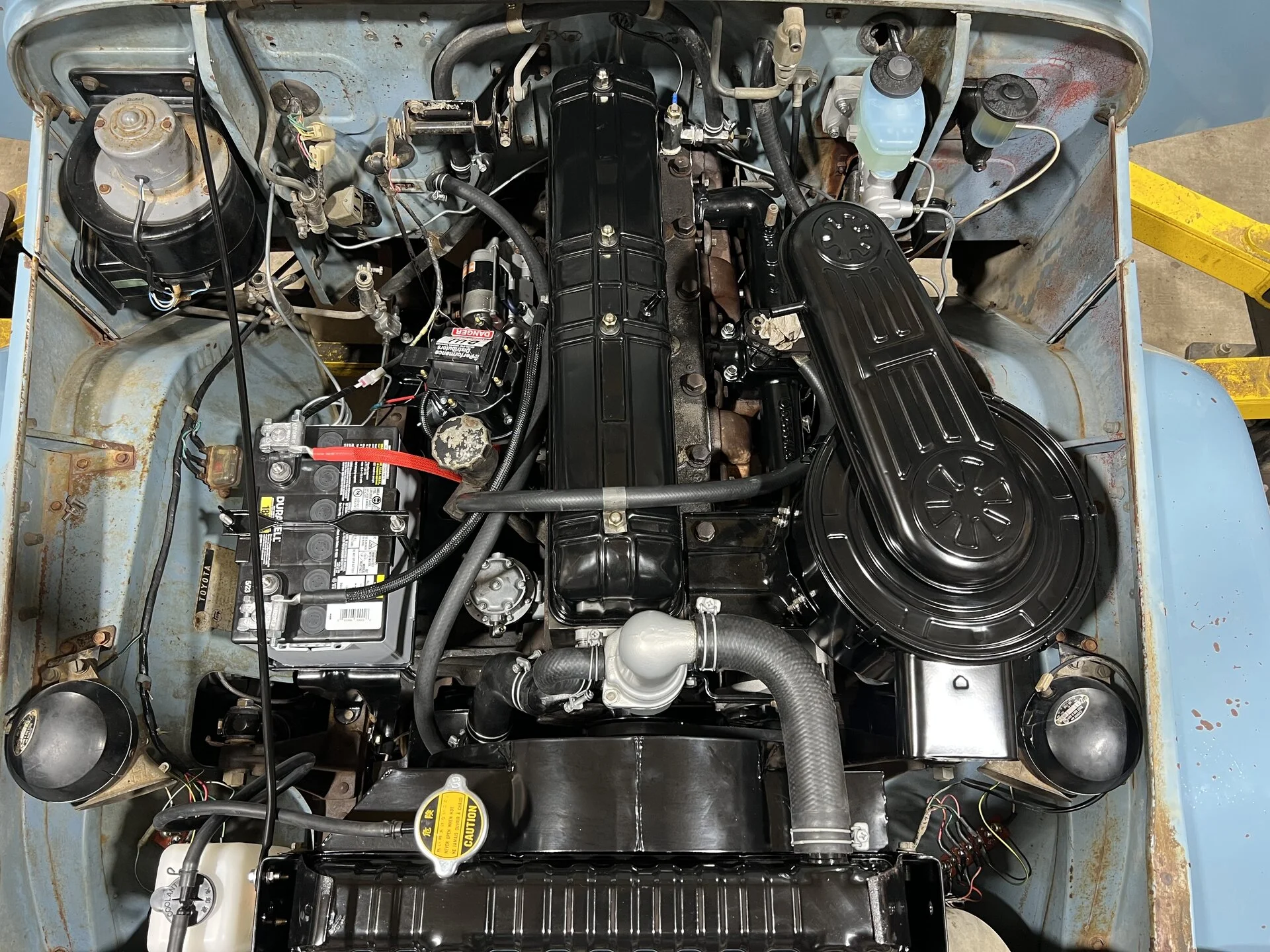

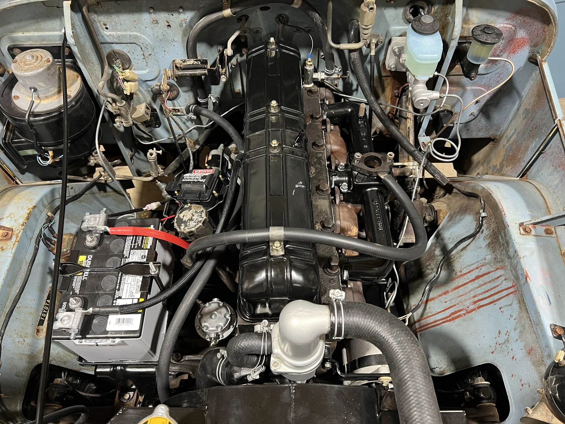

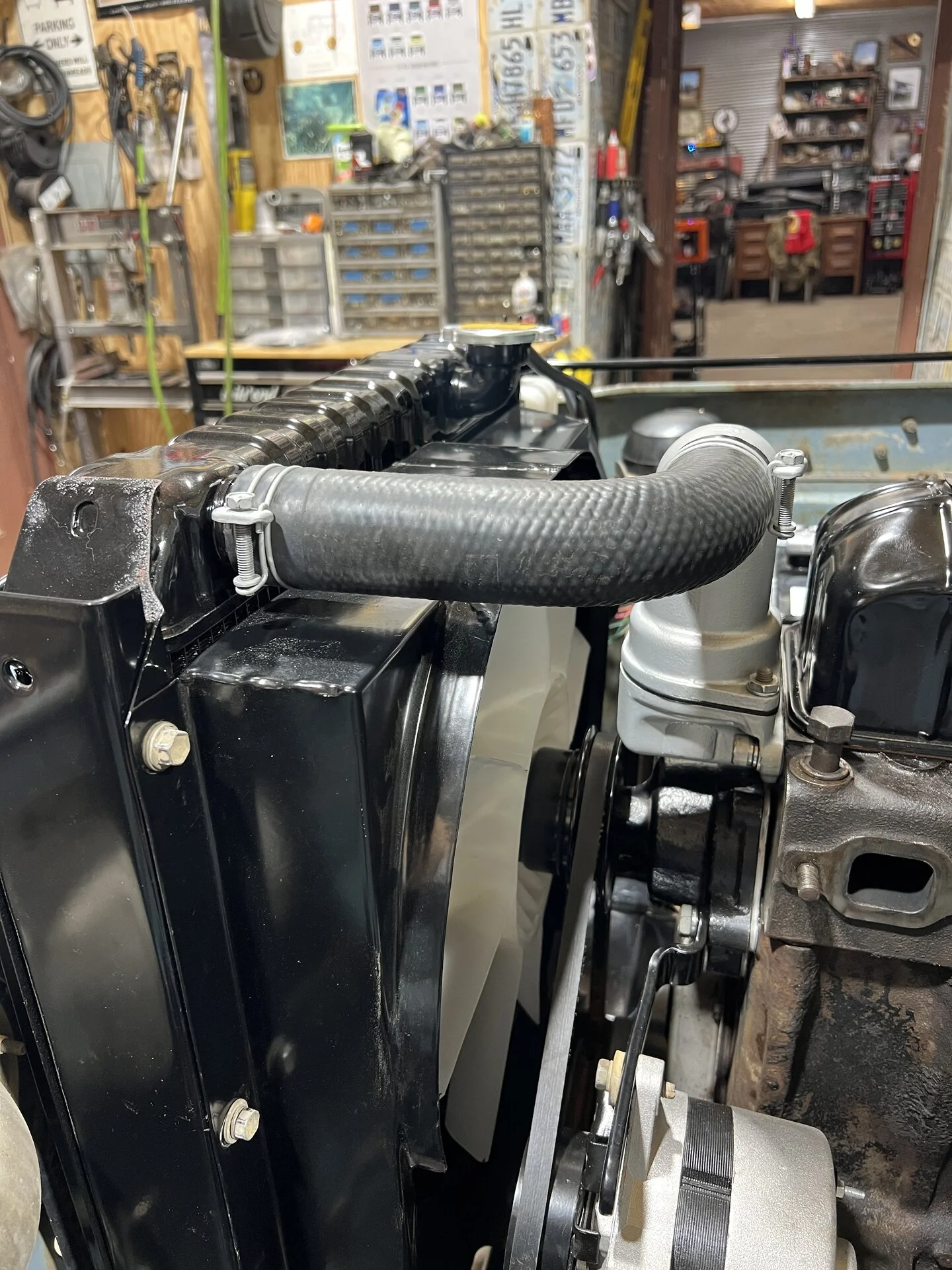

Water system build next. Used a 79 upper radiator hose and a standard 40 setup from the water pump to the radiator using a 2F style bypass pipe.

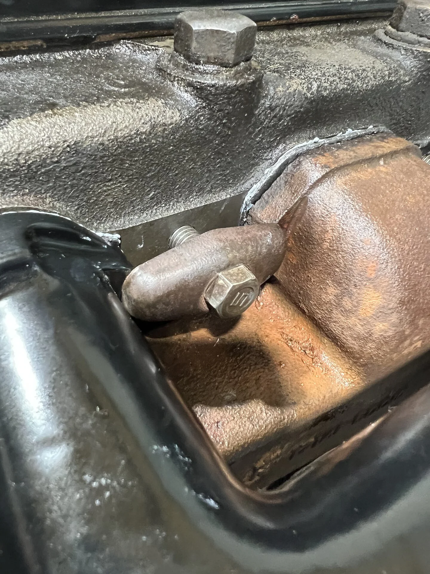

OK. That was a TOTAL pain in the ass. The gasket is in 3 parts and there are some dopey round things that go in the intake ports.
I finally had to use some extreme heat RTV to hold the gaskets in place.

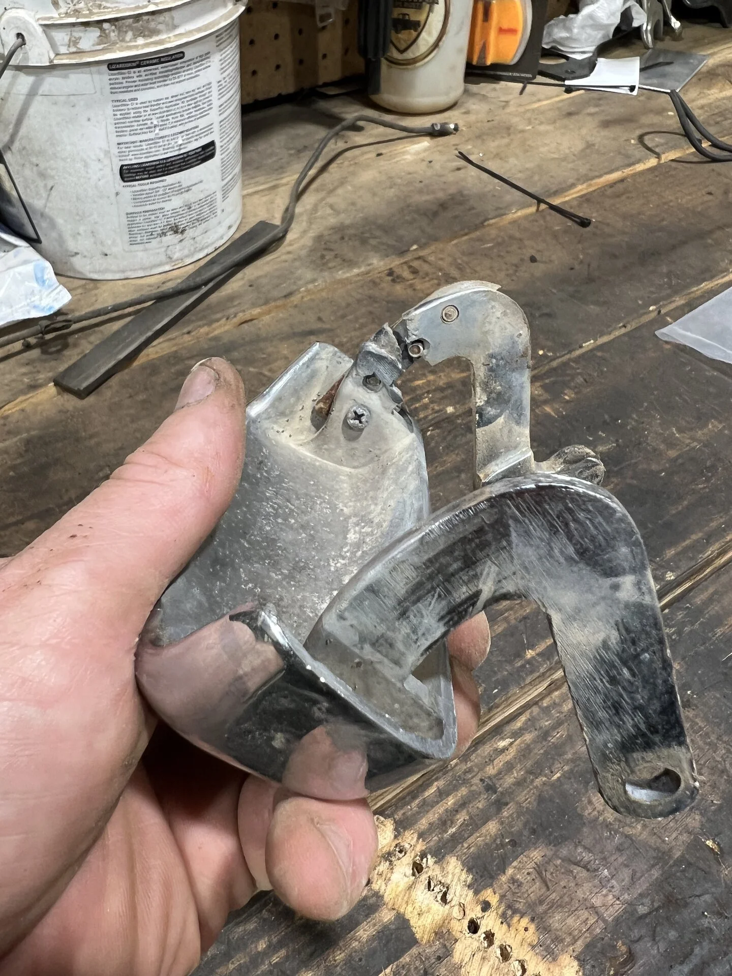

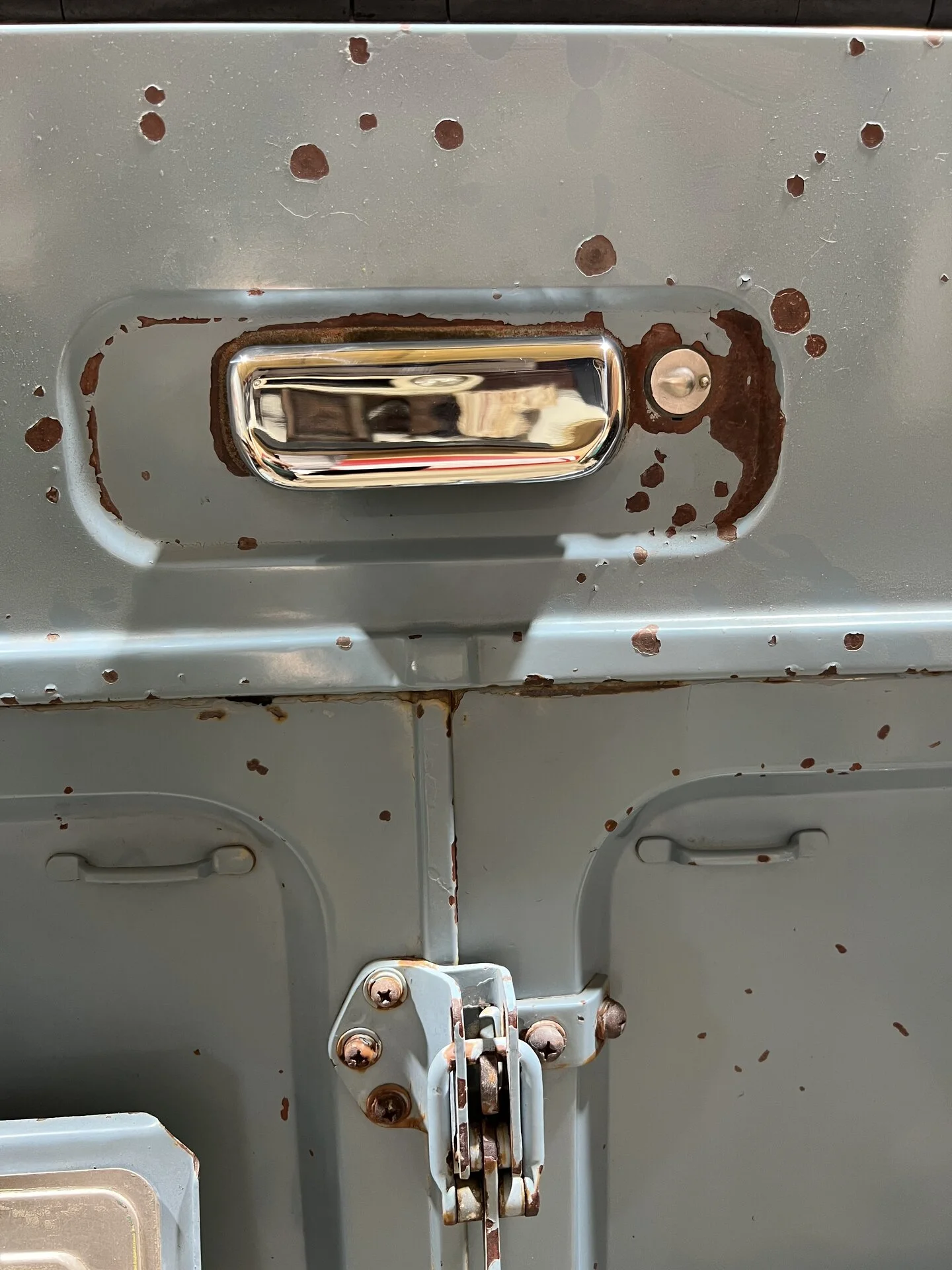

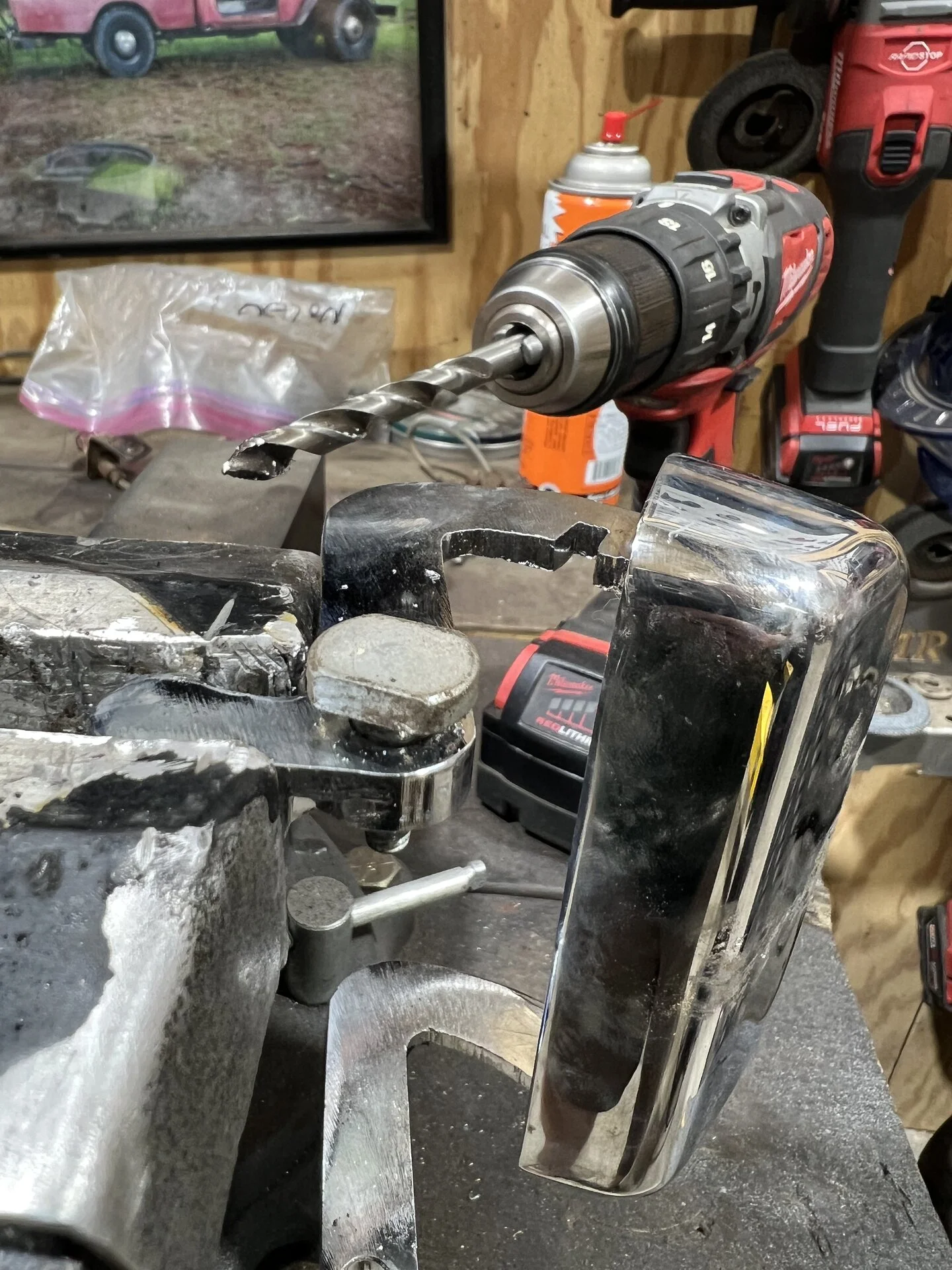

The rear outside latch was busted. The attempted repair.
It’s a tight fit getting the pins and M8 nuts off the pins only to find the new handle holes are too small. Take it back out and drill em…
Works like a charm and even has the interior T handle

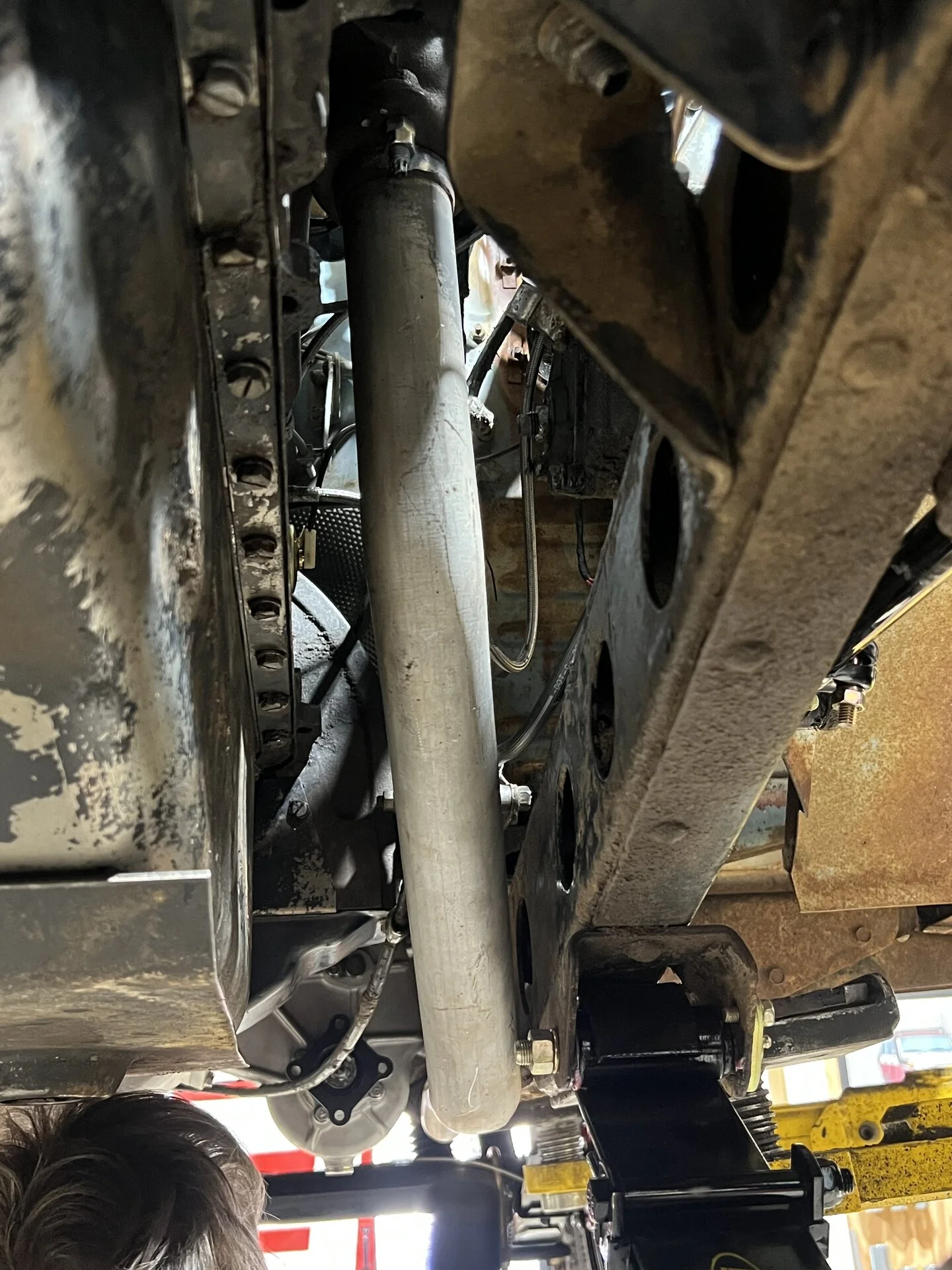

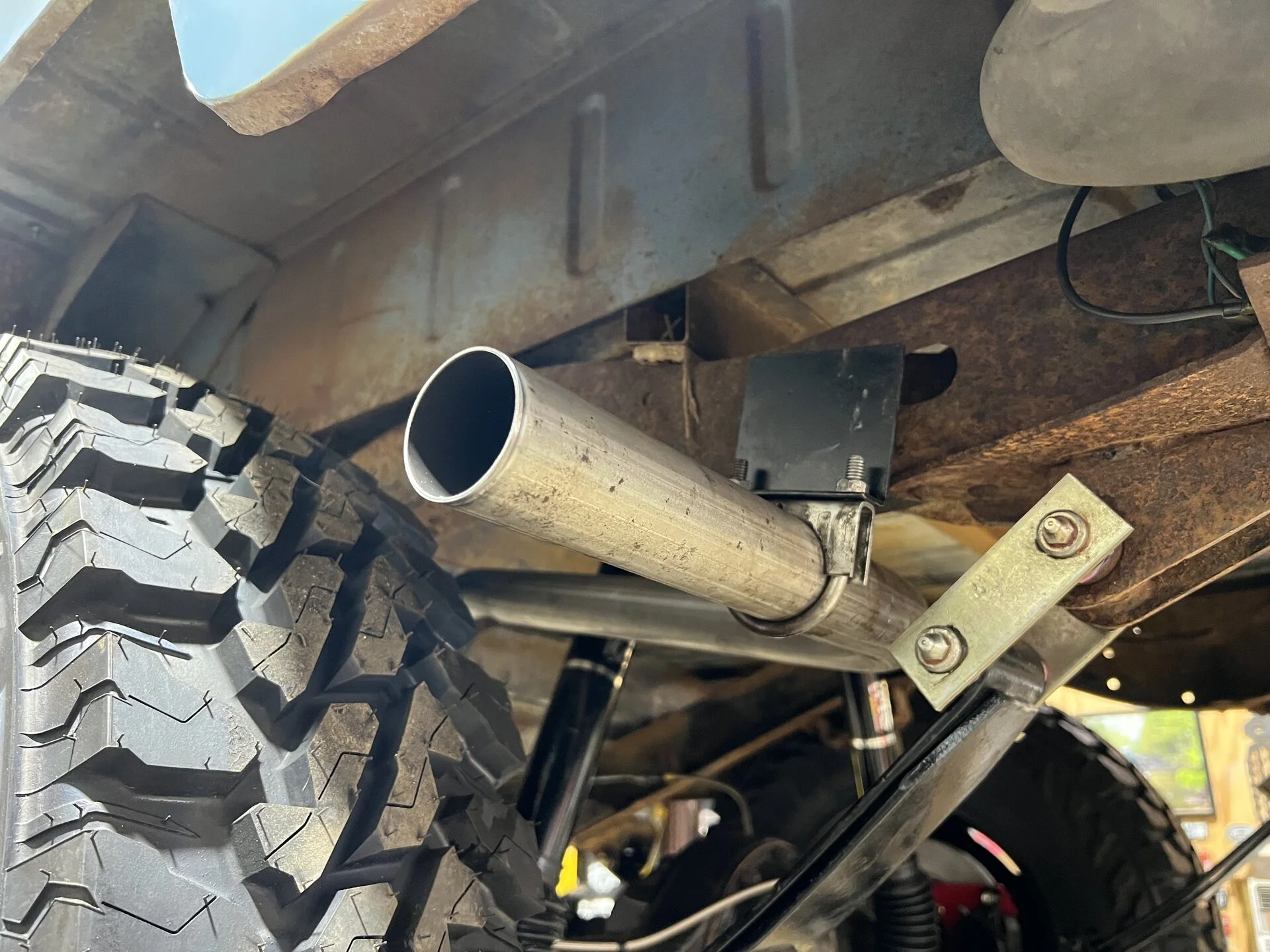

I found this like new SOR exhaust on Marketplace and drove an hour to pick it up this morning. Bolted right in. HUGE timesaver /labor saver. Probably not worth what SOR charges ($800 plus whatever monster shipping) but I got it for $400
Clears the PTO perfectly.

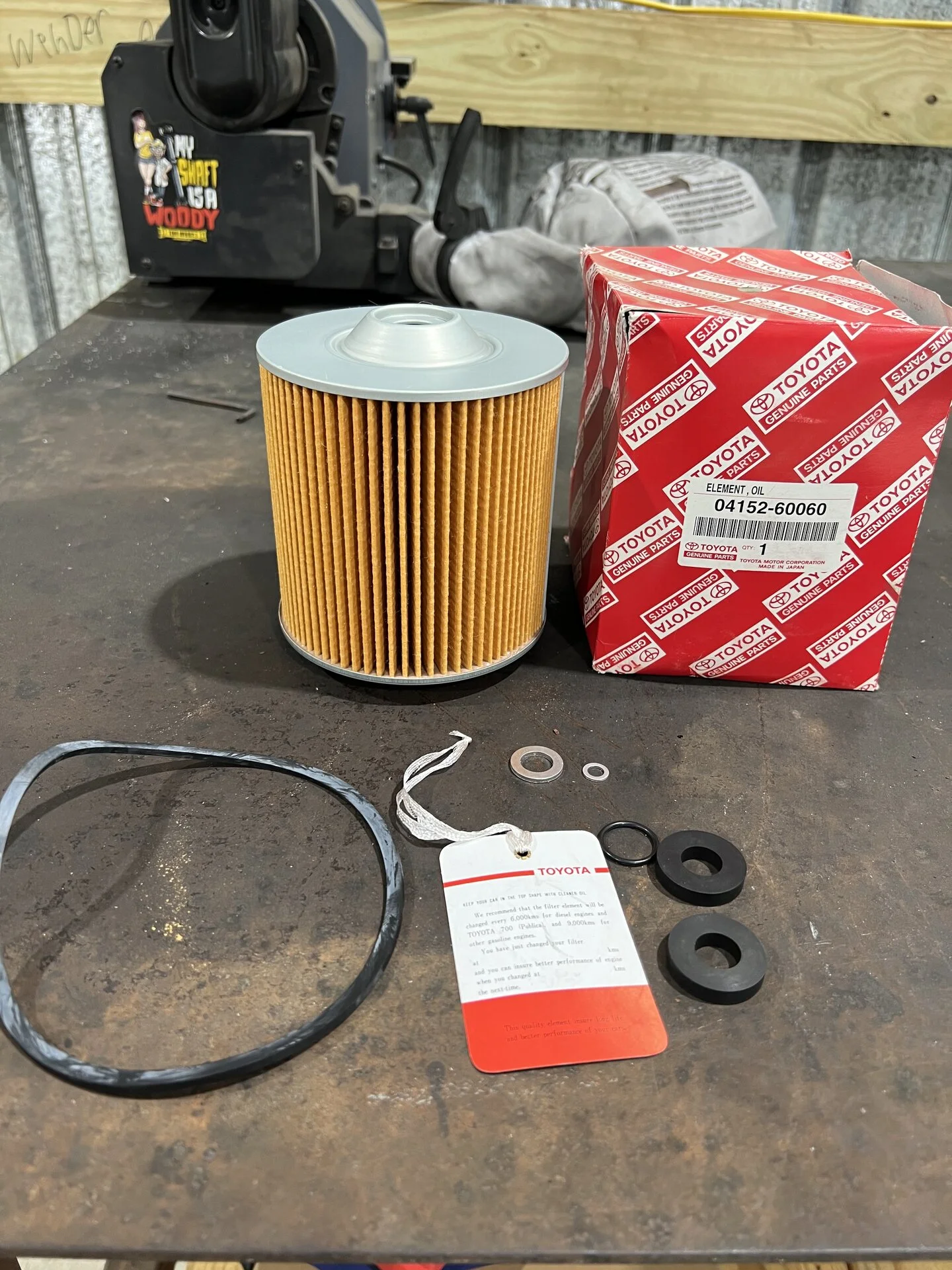

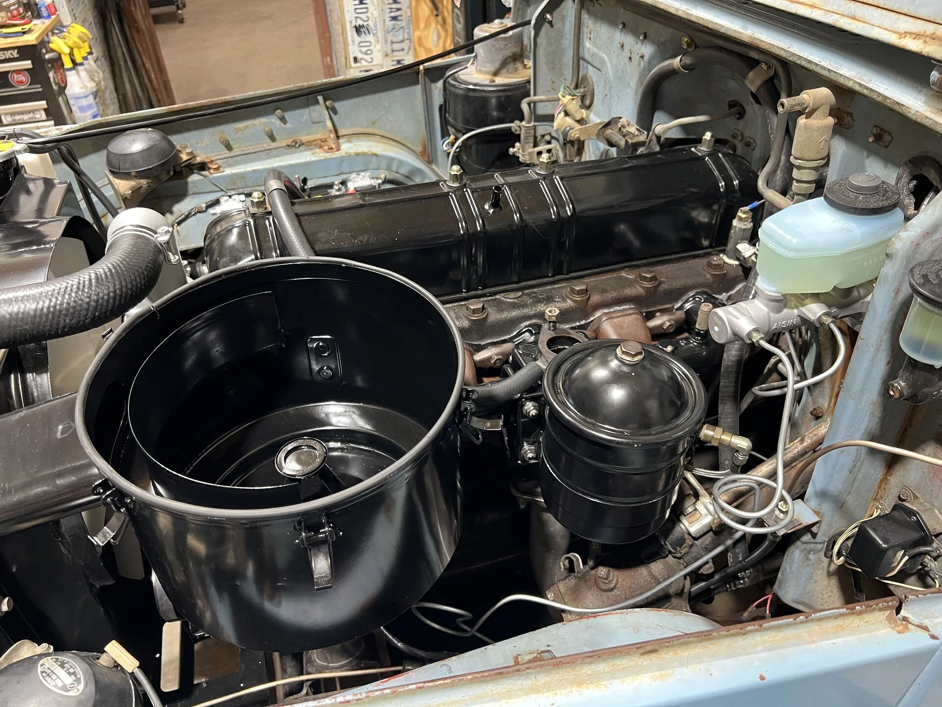

Amazing Toyota still makes this filter kit
Got it all tucked inside the beautifully coated housing and got the housing bolted back on and hooked to the regulator and block

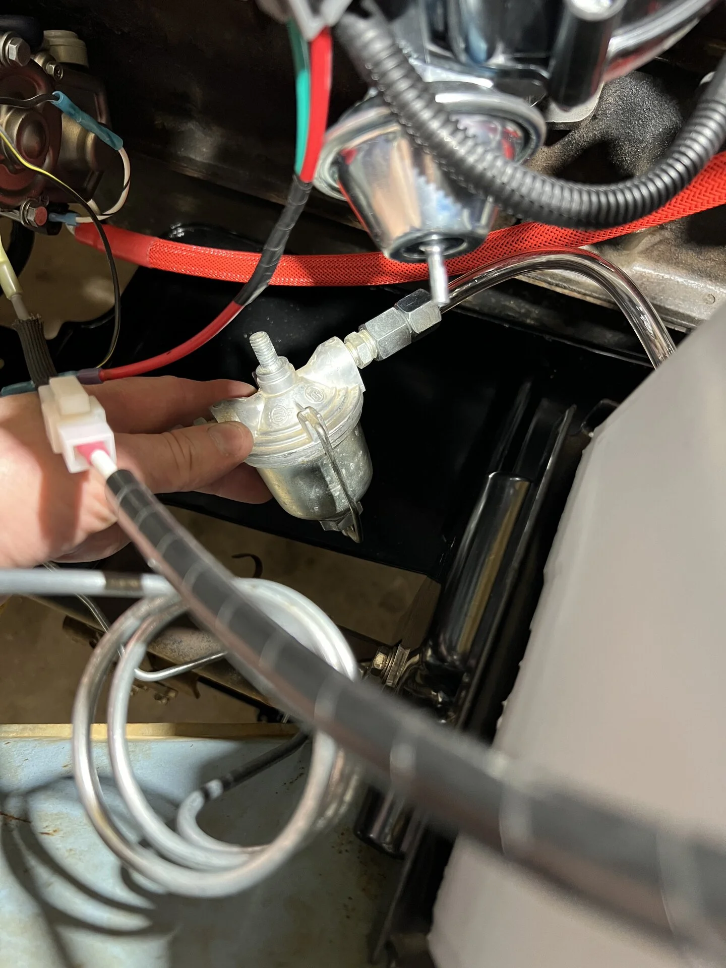

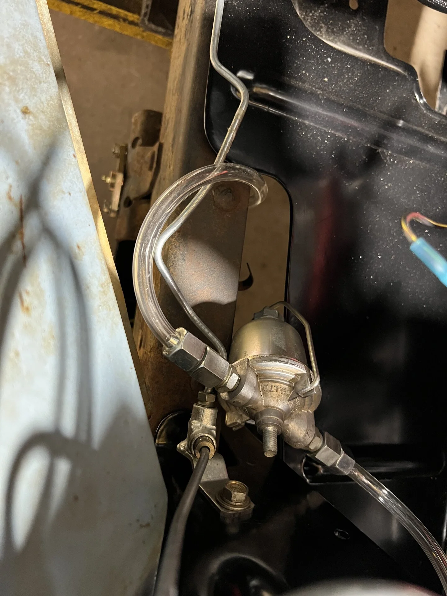

I also picked up this really sweet OEM style fuel like from Redline. It’s all hooked up from the tank to the pump but I can’t find my bracket to hang it correctly. I took it off for powder and it’s MIA. If anyone watching this has a spare please let me know

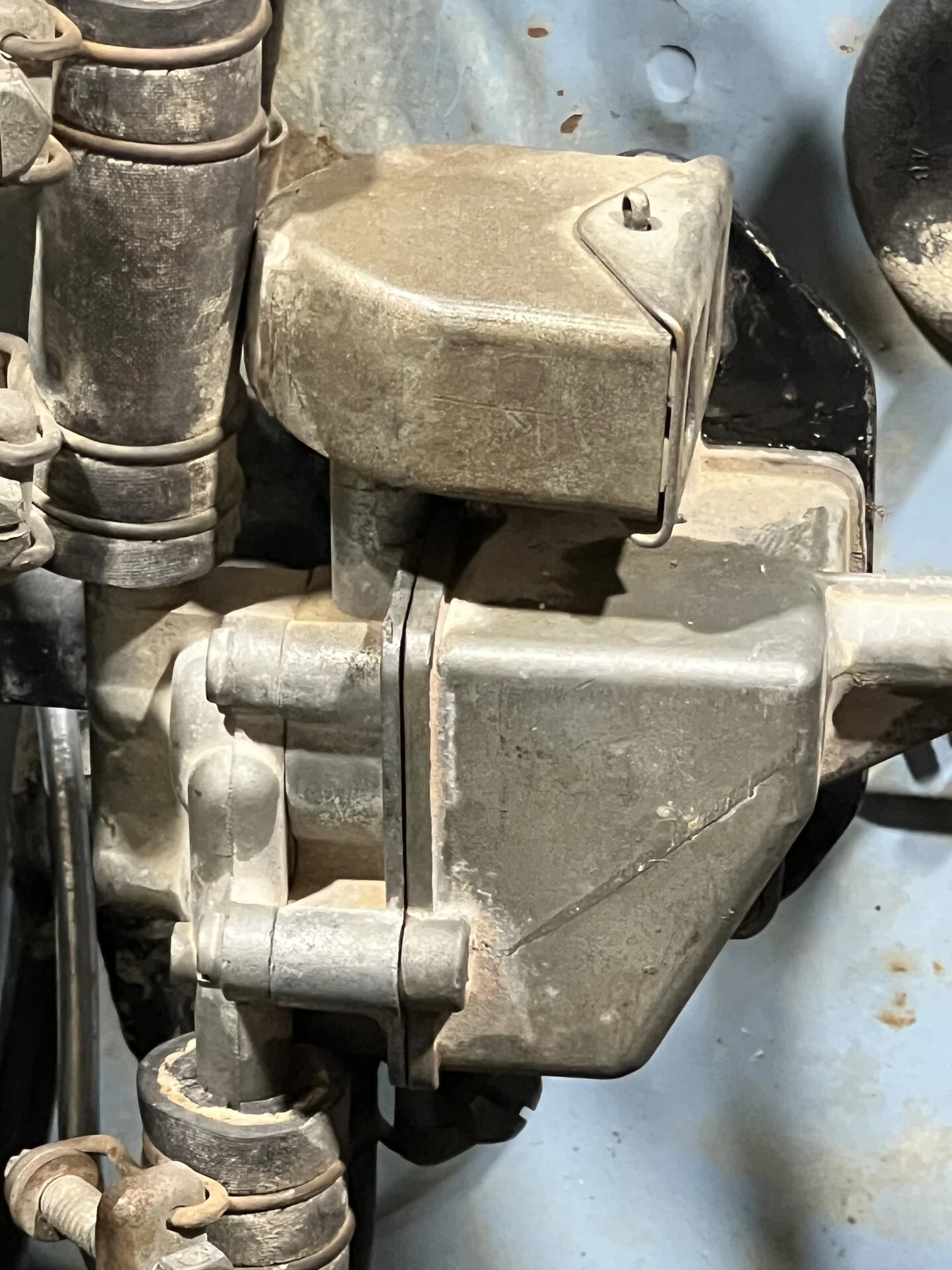

@Ratboy at Classic Cruisers dug up the proper actuator and cable for this truck to make the vacuum shift Tcase work. I got it reinstalled before I quit for the day.
