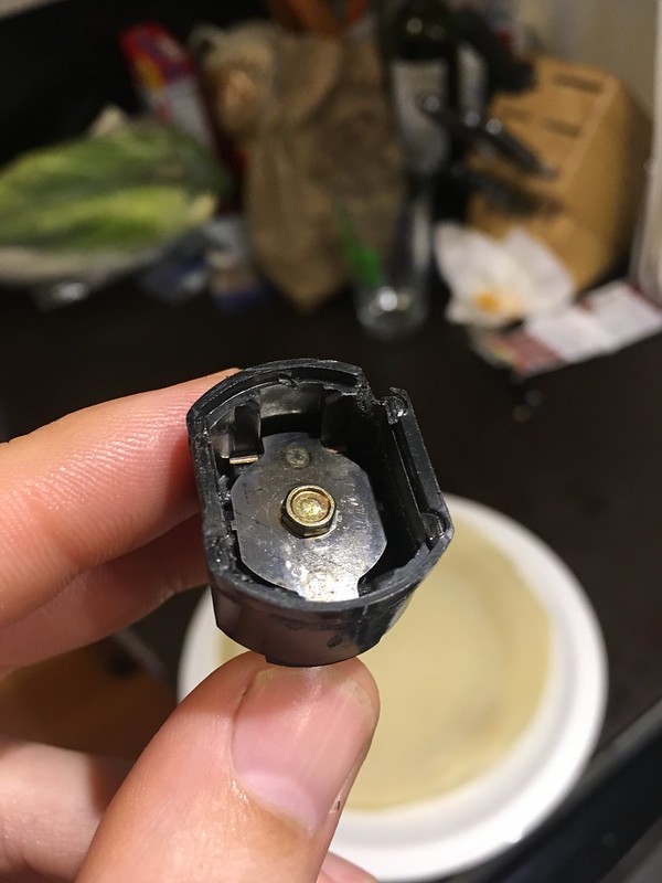

However, looking at the old circuit breaker, I am guessing the PO took some frustration out on it :confused:

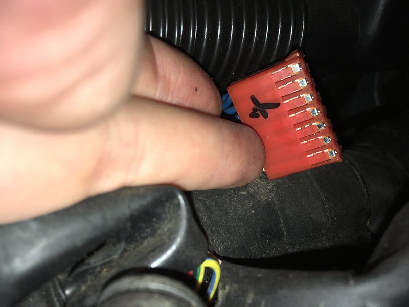

Well..... I swapped the CBs between the heater circuit and the power window circuits to see if the CB was defective. The CB tripped after 13min of the fan being on Hi and the AC on. Seems oddly long. It took about 5-10 before so essentially the same. So then I went hunting for the infamous ground junction behind the gauges:
Ground junction looks perfect to me:
Kind of at a loss for ideas at this point. Anyone have an idea?

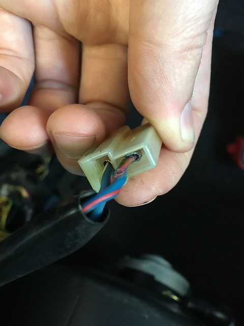

Noticed this small tear this evening at the blower motor terminal. I can also see some corrosion in there. Measured 3.8ohms resistance from this terminal to the battery ground. Going to try and get the metal terminal out and rebuild it. Hopefully this helps.
Replaced the terminal and still blowing the CB. Time to move to other areas I guess. I am wondering if I am getting a lot of resistance to ground through the speed switch. I am going to try and yank it out and clean it up. Deeper and deeper down the rabbit hole I go! :worms:
