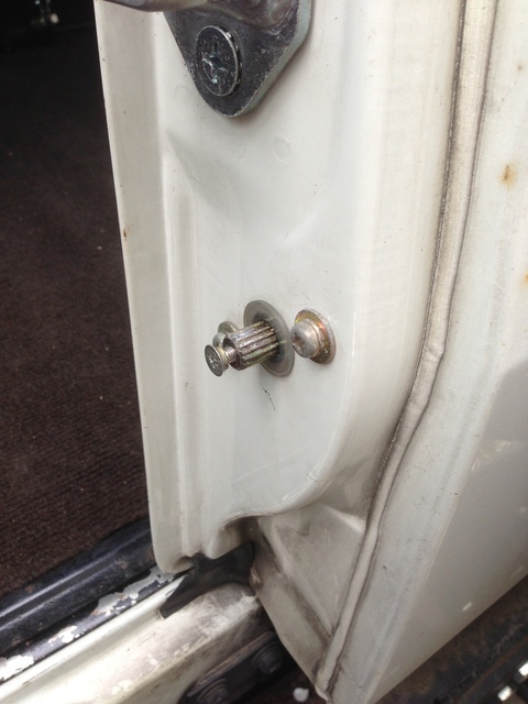

My BJ74 came with the right rear inside door handle in 4 pieces in a plastic bag when I bought the truck. I was told “good luck” finding it State side. The parts look to have been glued a number of times, yet failed each time. At first I thought I would have to machine one for it. However the more I looked at it, I realized it looked familiar. I opened the rear hatch of my LX450 and looked at the inside rear door handle looks a match. I took it off an it fits the 70 door dead on, even the keyway matches up.

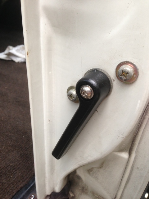

The 70 door handle used a counter sunk screw, whereas the FZJ80 used a small bolt. The 80 bolt transfers the 70. I used a new 5mm x 0.80mm button head stainless steel bolt along with a #10 stainless washer. Just looks nicer.

Ready for the new part:
Installed:
Score! Thanks, the PO on my 70 replaced it with a small vise-grip. This is much better.
